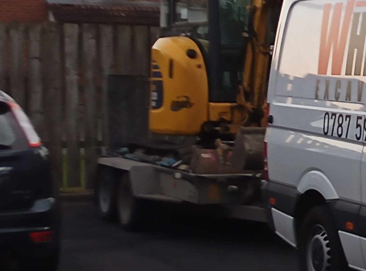

Careful with those trailers- can't remember the model but I had the same one and it nearly snapped in two. A nasty split worked it way where the drawbar meets the axle. The sheet metal of the body tore right up the sides of the trailer on both sides

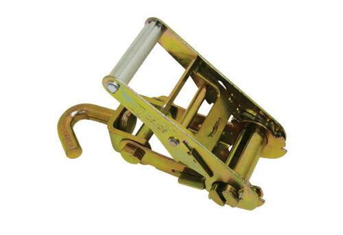

These are the ones we use along with a short strap. DMC Supplies Ltd in Aberdeen sourced them for us, can't remember the price off the top of my head.

This - strap the opposite lashing point on the machine to give you more strap to work with.
Not sure what you mean Tom , can you explain
Sounds similar to what I do, straps off the blade eyes pulling back, and straps off the eyes by the sprocket pulling forward, the straps cross over each other in the middle.
When not using them, don't roll them up, just unhook them off the digger and hook them on the nearest lashing point on the trailer, and nip them up.

Can you not undo the bottom bolt on the rachet that attaches the strap to the short hook and just then put that bolt through the eye. Rachets would be permanent on trailer though. Or get those ones with the fixed hooks

Personally, fixed chains to front of trailer to connect to towing eye/U/C of machine. Track rearwards until tight.
Then a fixed chain and Binder to secure it backwards.
Some utter prick will be along to say that it's not safe/correct/compliant having only one chain and binder, reality is it's about as safe as your going to get a mini digger on a trailer, and that is all that matters.... compliance is in the eyes of the beholder.
I've got to weld some now lashings to the lorry now I know how the machine sits best, and this is what I will be doing with 2x chains to the U/C towing Eye - Front headboard and then two binders from the blade to the lorry deck.
The 1.9t diggers tend to get a 10t strap over the Blade or Kingpost and a 10t strap from towing point to the back of the trailer.
