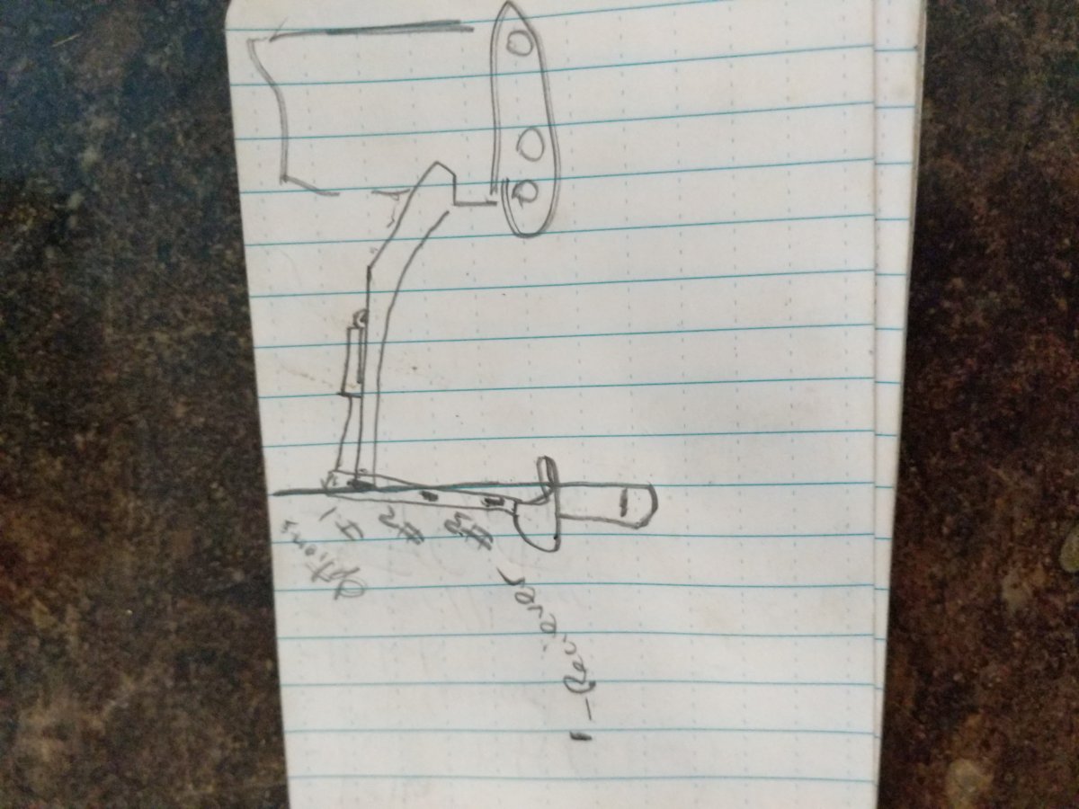

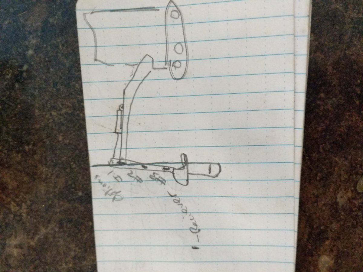

I have a cr600 and have been wondering if its better(more accurate) to mount it higher or lower on the dipper/bucket? I've run it everywhere from the side of grading bucket to the top of dipper....

There is no right or wrong location as long as it has a good line of sight to the laser. It obviously entirely depends on the plant you are using and that particular job in terms of where it is best positioned. Although because of the magnet position it can only be mounted on the left side and then has a 270° pickup.
In terms of accuracy, this is determined by the laser not the detector and so it will just pick up and display the datum you are working to, although the unobstructed line of site is critical.
Some of it also comes down to the individual operator in terms of what works best. As I say to all customers, lasers levels / detectors etc... are there to support your existing method of working but just speed up the process. Not replace the years of expertise and the methods you use to get the job done.
There are a number of youtube videos that shows the various setup positions people run the CR600 in which may also help. Just search spectra cr600.

I liked it on the bucket because you could reach and grade and just worry about keeping bucket level.
I understand the reciever and laser will have the same accuracy if your dipper is always perfect vertical, but if your off a little and its at the top reciever is still inline with vertical, if it's down lower it's moved more.

I understand the receiver and laser will have the same accuracy and if your dipper is always perfect vertical.
As I say it depends on the exact project you are doing as to what is required... and how the operator is working. The CR600 will cover most projects for varying size plant.
However, for more complicated projects (requiring significantly more budget) the reason models like the LR50 and LR60 exist is to allow the operator to also have a plumb indicator in the case of the LR50 and on the LR60 a Plumb Indicator as well as Angle Compensation.

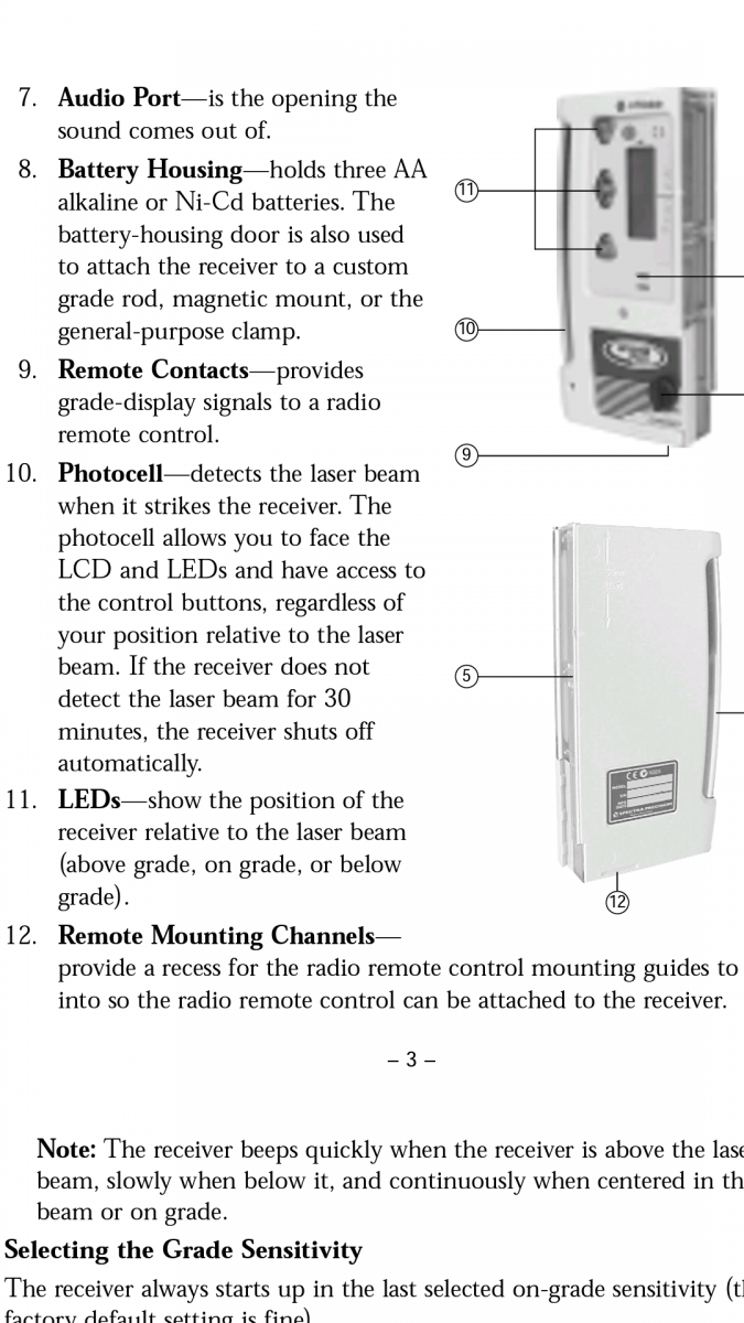

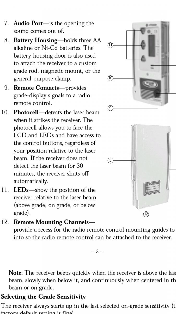

I've been trying to figure out what radio remote display setup works with #9 and haven't had any luck.
