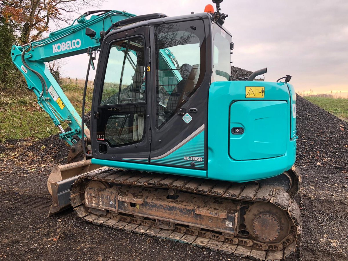

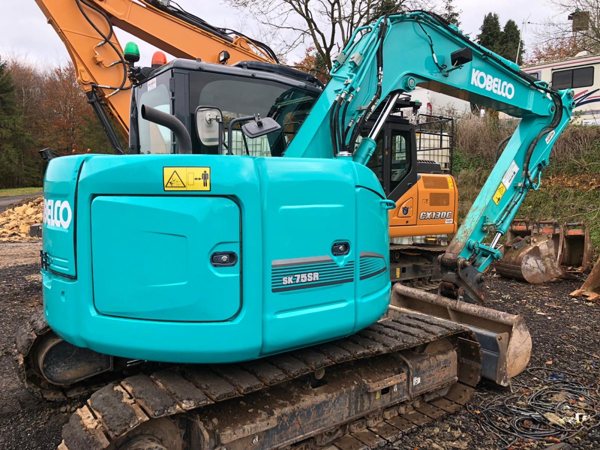

What happens when a 6 year old names you digger.....
Welcome to the fleet Rainbow Dash!!
so are we gonna see any "Rainbow Dash " decals on it anytime soon then Shaun :giggle:
The decals haven’t made it out to site today so hopefully weather permitting they will be going on tomorrow.
Photos to follow!!

Well pics will follow when I get time to slap the decals on!!! Been very busy preparing site for the pilling rig due next week. Braking news is I am going idig before Tilty!
Early impression of machine is good. Loading lorries with the 3ft bucket and it is well balanced. With grading bucket on it is finding the heavy clay hard going. So quick switch to the smaller bucket to rough it down then just trim with the grader. Most annoy thing is not much gap between the blade and cab. Been caught out a few times with spoil over the blade catching as you slew. Trouble is operator rather than machine I guess! Seems to be reasonable on fuel with the different modes making a difference when you need the extra power. Getting used to lifting the tracks again to turn as again, in the sticky stuff!!
