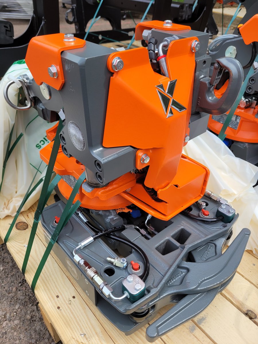

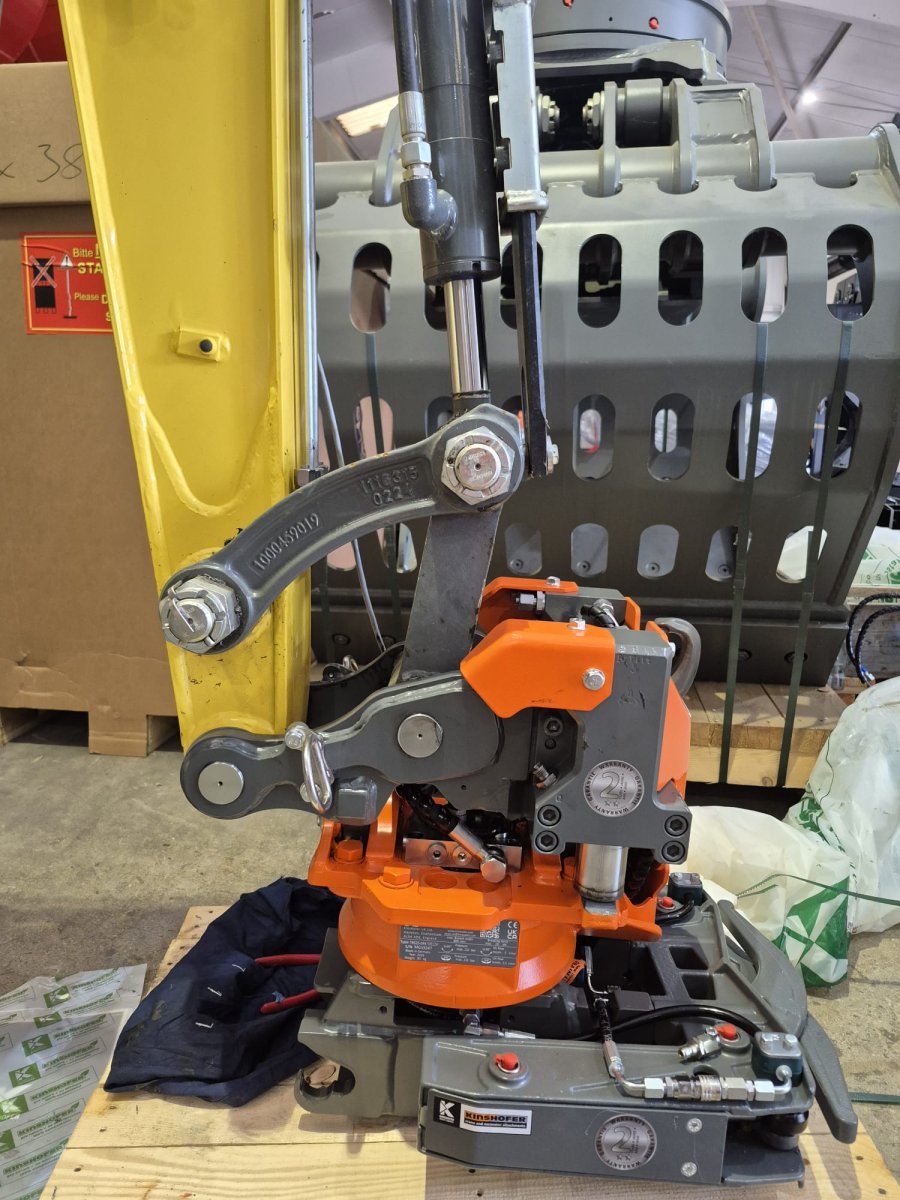

It's arrived and getting installed!
Maxus
Yes gripper is removable by undoing two bolts, I don't think it's available to buy yet, I've been selected as a guinea pig, which I'm very happy about. The pipe work you see on top of the gripper is a work around so I can manually switch between gripper and any attachment i need to run... my understanding is the final product will have a better way to connect attachments.
Looking at the incredibly small size of the hoses running the gripper, I don’t think I will be running much in the way of attachments though- which is not a huge deal for me, the gripper will more than make up for that I hope - but we will see.
The engineer also seemed quite surprised by the size of the auxiliary pipes and connectors on the EZ26, to couple with the tilt rotator, pipe diameter will need to be reduced significantly. The EZ26 is definitely in the biggest category of machine for this particular unit, looking at it I wouldn't hesitate to put it on something smaller.

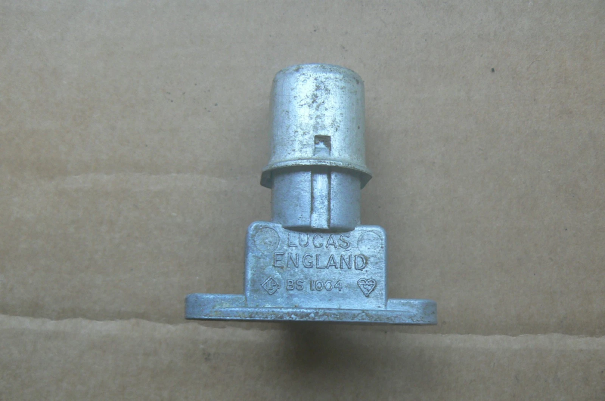

Anyone got any ideas about where to put the switch to toggle between tilt and grab? Apparently the button on the joystick can't be used (encased in resin apparently).... they've put one on the control panel, meaning I'll have to take my hand off the joystick to activate... would a foot pedal be better?
Surely they can drill a hole in the joystick and fit another button.
Maxus
Yea we did this for @Thomas7740 on his EZ26
Good to know.... If I could get some basic advice on how to do it and proof that its possible, I'd have thought they'll have pull there finger out and get it done, i was pretty specific in saying it needed to be switchable while my hands are on the joystick! Even if it's a foot pedal....
can get Lucas, steel, floor mounted, momentary (for horn), or latching (for dip/dazzle) switches.
