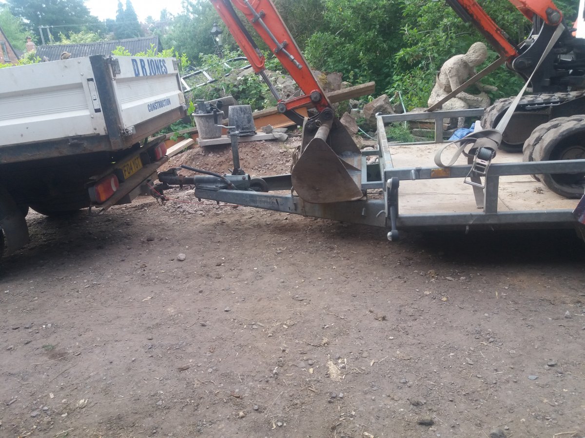

If, as stated, the springs still have the stickers on them and the back plates are mint, I wonder if it’s had new axles slung under it? Which would then have auto reversing brakes? I don't think Ifor have used Bradley hitches for quite some time, so something doesn’t quite add up?
... Hydratow HU 12, which they did use and are still available ... Think I have one here :unsure: ..... quite poss it's had axles but as it came from Dylan's mate, I'd have thought he'd have told him :rolleyes::unsure:

It dose'nt look like its been messed with. I would say its the original floor😨.
Everything seems original . Cost up to now. Break away cable £5. Hook up cable vehicle to front of trailer £16. 1 bulb 10p.

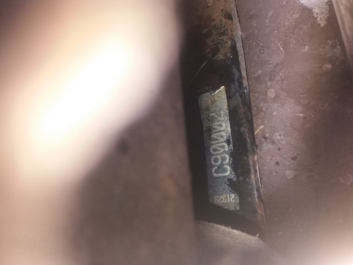

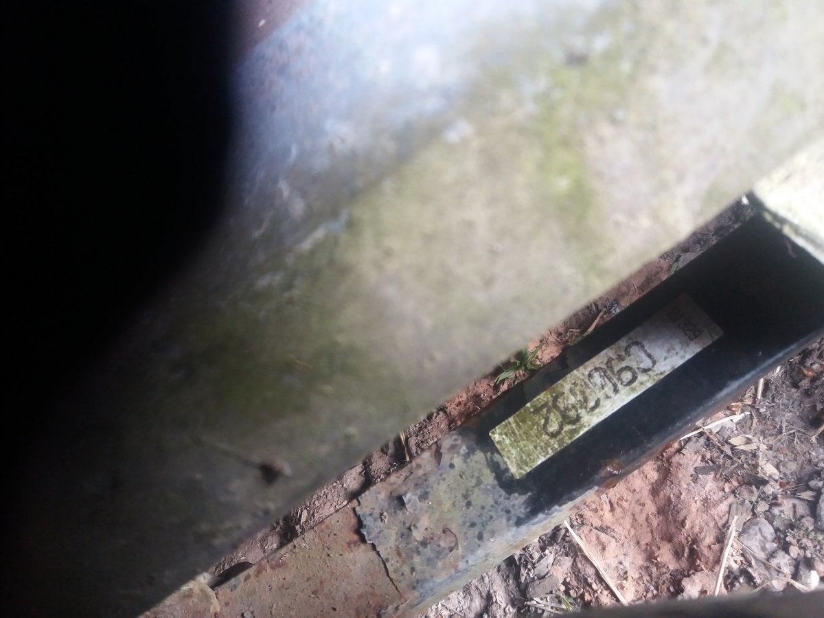

Technically a 3.2t max load, is there any part numbers on the axles to check they can take 3.5t between them
I’d give Ifor a ring. Always found them helpful in the past.
apparently the labels are still on the springs and axles ... google time ;)

The plate is stamped 3.5t so it definitely started life as 3.5 ton.

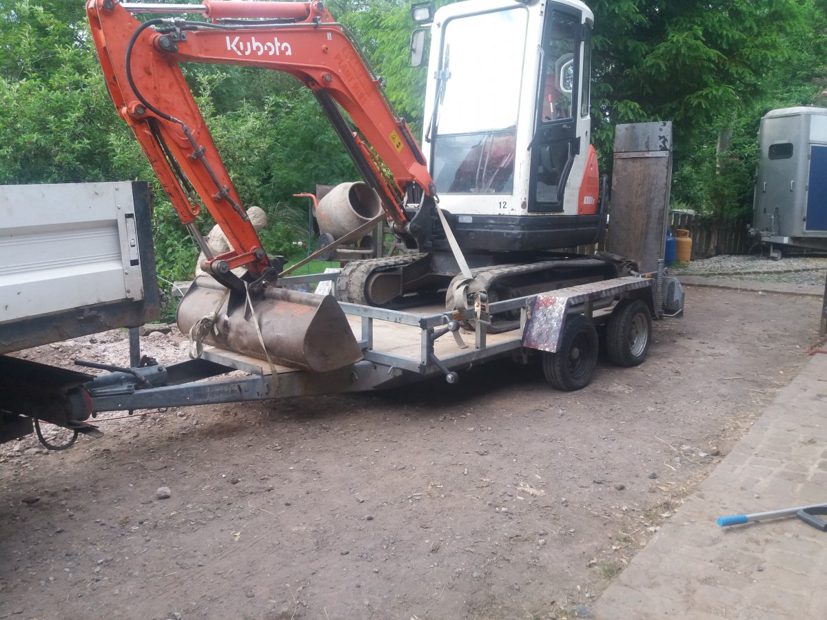

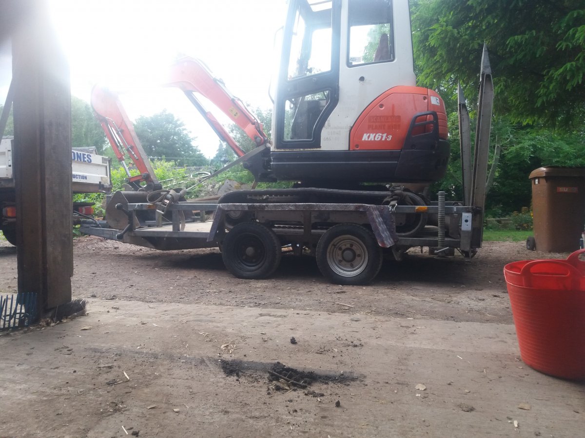

Just took some more pictures before it goes off tomorrow.
Going by the hitch it'll be old enough to have needed tyres (possibly more than once) so they'll deffo not be the original. That size actually look more like what the 10x5 dropsides used to have. Could have been swapping a few bits between trailers to make a good one to keep and get rid of the other.
some one's fitted cheaper tyres then Dyl

I would of thought someone has put those mud flaps on afterwards, most of the ifor stuff I've had/seen has been placi mud flaps

Would the tow bar on the truck have to be lifted if bigger wheels/tyres fitted. It sits rides well at the moment
