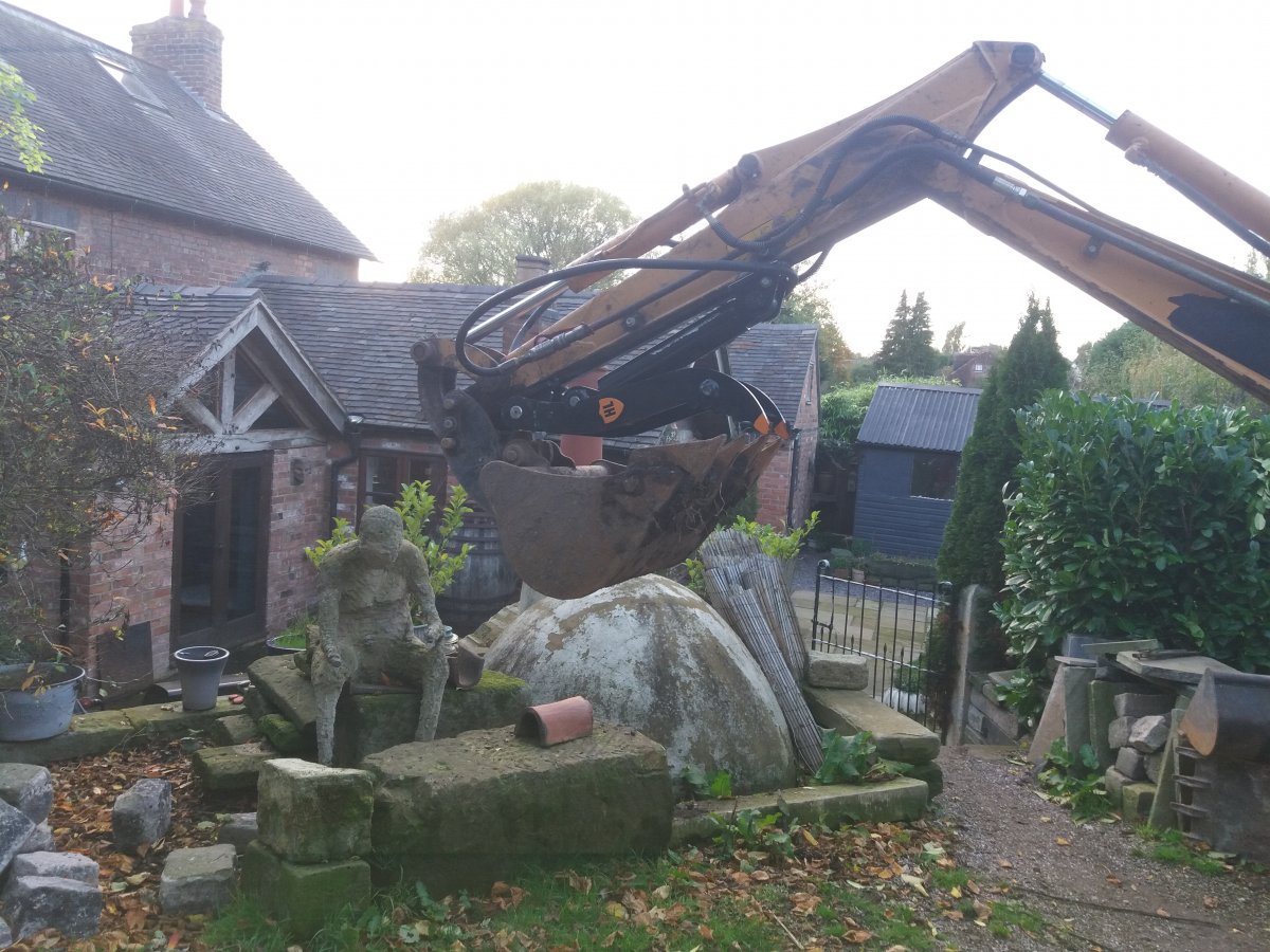

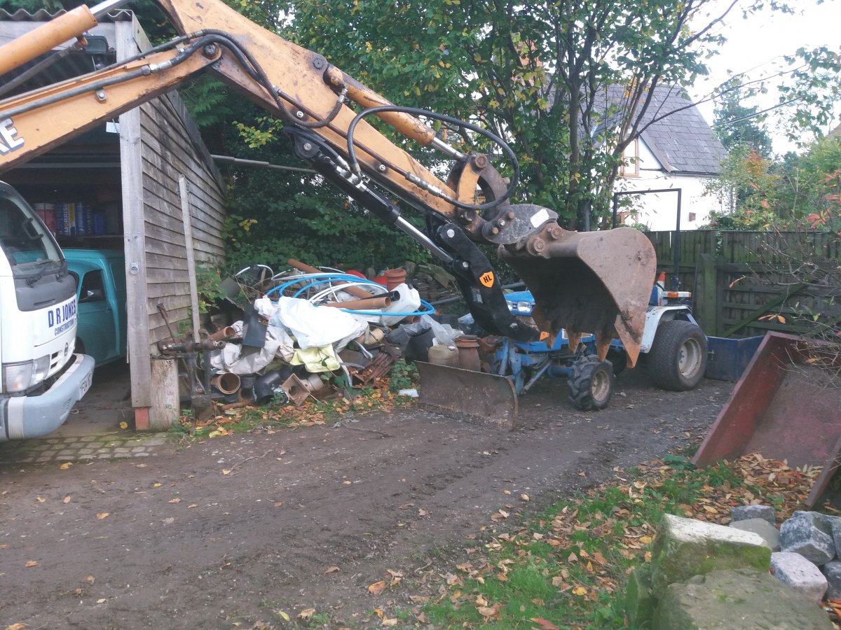

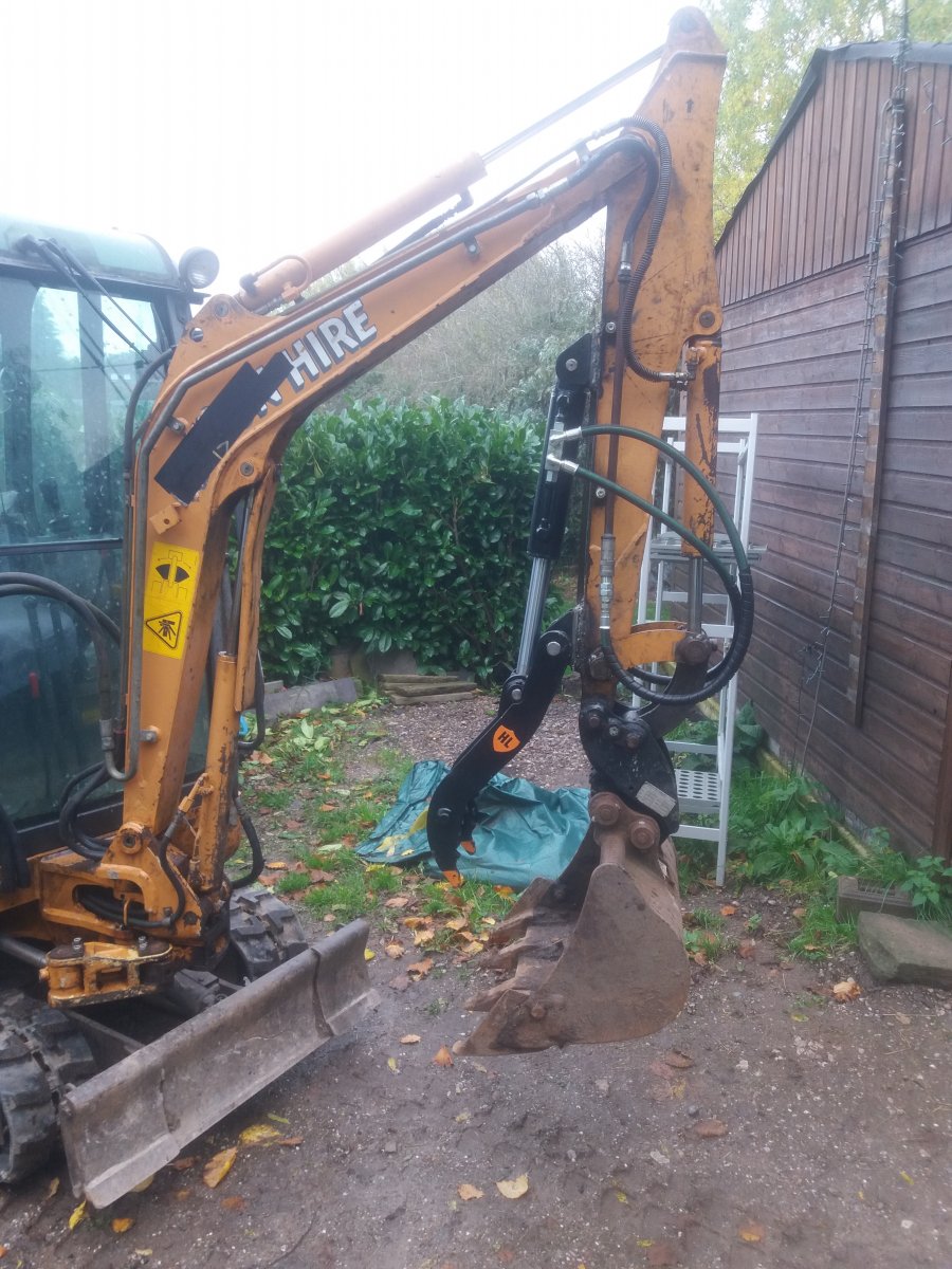

Temporary fitted on the case today. Seems to work ok. I haven't used it in anger as only tacked on.

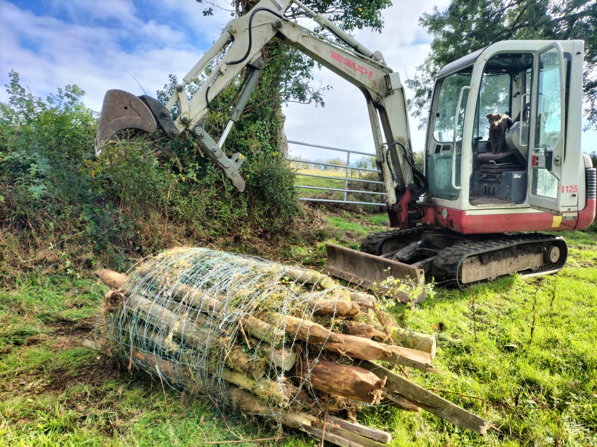

Here's a typical example of thumb usage This was 100meters of stock fencing. I pulled all the posts out with the thumb netting and all. Laid it all out on the field then sitting the digger at one end I rolled up a bit with the digger, grabbed the roll and pulled it all towards me until the whole lot was rolled up in one tightly bound bundle. An otherwise nasty job by hand all done quickly and neatly with out getting out of the machine once.

Looks good. That one swings quite far out by the looks. I had to take mine off today- felt disabled!
What machine is yours on ? What’s sort of tasks are you using it for ?
Why did you have to take it off ?
I have it fitted to my 2.8tonner. had one on the 5 tonner too before I sold it. Use it for everything. Handling timber , brash, lots of rock handling (probably its main use) general clearance/piles of vegetation etc, plucking detritus out from heaps of muck, scrap, loading trailers where it's easier to neatly place items. Even use it to hang dumpy bags off as it brings the weight closer into the machine. I took it off today as had the post knocker on steep ground so wanted to relieve a little weight but usually just leave it on. In fact it's the first time I've taken it off in 2 years of having it.

I'd imagine it'd be a bit small on the 2.7t wouldn't meet the bucket teeth etc?
Might try it on the kx61 before i weld it on 1.5t.
I could bolt extra onto thumb if not quite reach bucket. I'm sure it would be man enough. I don't use my machines much so have a bit more time to mess about inbetween jobs
could you not get that a couple of inches lower Dylan or is it there to clear alternate buckets?
