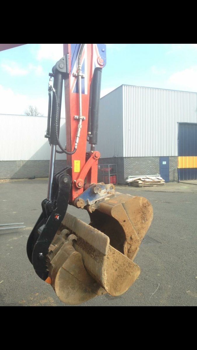

I haven't had a problem with any of mine. Keeps the grip pretty good too. You can always curl the bucket a bit to keep it. Actually the thumb ram is stronger than the bucket so I find it's best to get the thumb roughly where you need it to be and use the bucket to do the precision adjustments- more controlled and not forcing the bucket out the way

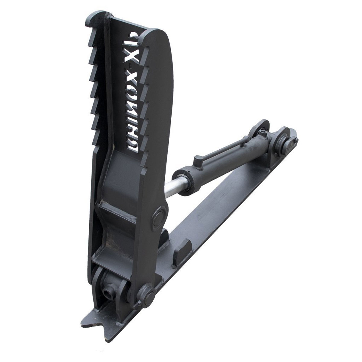

I had Geith one on 5 ton mounted on bucket pin, bought this rhinox one for 5-9 ton dirt cheap at auction is brand new in packing crate

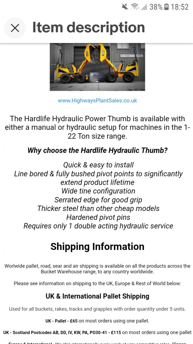

Think I'm going to be ordering one of these, called Hardlife i believe
It's a good design as same width as dipper which would be a real pain if it wasn't, strong design. Does it say on the website whether it's made of hardox or not. I had to get RSL to make me one specially out of hardox for my 5 tonner. The one on the 3 tonner is normal steel and 2 years old. Heavy use to be fair but definitely wearing the tips flat
There was a bloke from hardlife flogging stuff on here - see if he can help with price!
(Or also speak to Scott’s in Ireland as they make a lot of hardlife stuff….)

Just watched the video on the hardlife website of it on a Kubota 080-4 loading a bonfire. Two things that stand out is that they don't fold back as well as the RSL and they look quite a bit wider than the dipper. I'll be keen to know how you get of with it for future reference. The RSL one has taken some abuse I must say. Wrestling with rocks far too big for the machine🤣

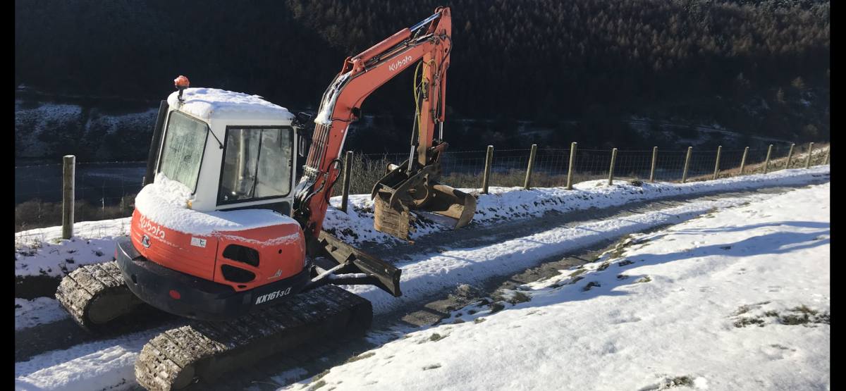

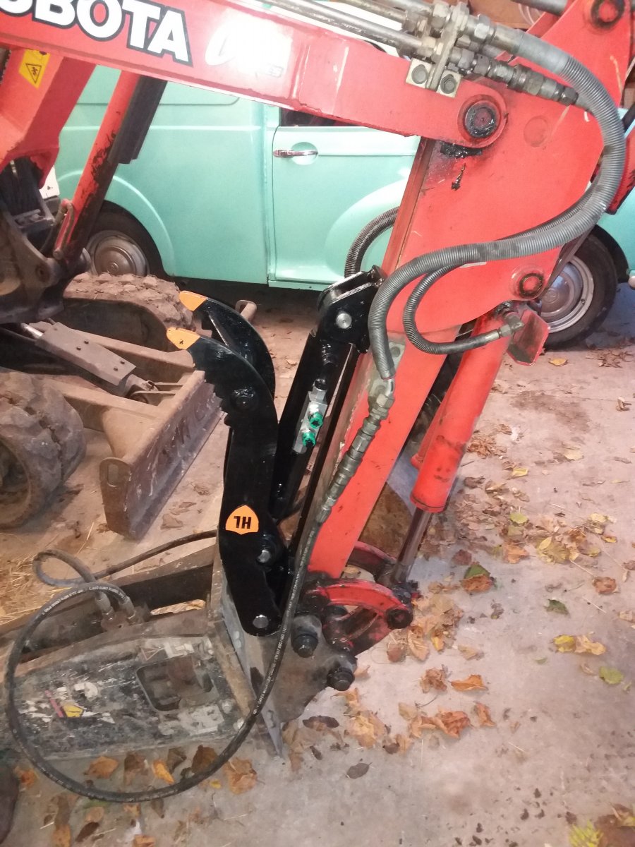

Well it arrived today. Just tried it on my kubota, its going on my case digger but they are very similar. Both have quickhitchs.
Looks ok. Paint is crap. But see how it preforms.

We have fitted them to K008’s and TB 210r’s but some of the SWL’s went into minus amounts
