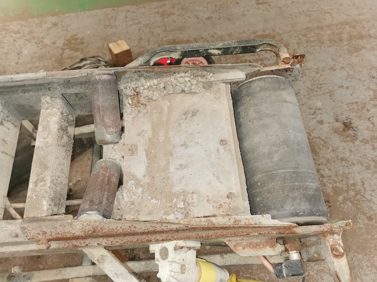

Would be a real ball ache to do a motor swap on the belts graham is using as the motor is built in to the roller drum so would need to change the frame around to accept the external motor then add a new drive drum and then there is the fact it would throw the balance out as all the extra weight on one side. The large roller in this picture is where the motor is housed so swapping it out is a no no really

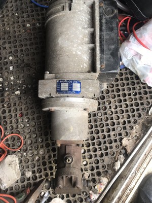

Or better still this second hand one to test the water!...... you would be taking a change though i guess
gonna need a case drain line with that one and doesn't state voltage ... cheap though ..... if it works
now that puts a whole different complexion on the job :oops: leccy it is .... hyd or diesel is the only decision really

That looks a good idea to me, nice and compact. Petrol/ diesel generators are awkward back destroying bastard's to move about. A Honda gx 160 is heavy and awkward enough by its self. I would like something like that on my dumper but doubt I will have the space now it's got twice as much engine.
I bet it costs about 3 times as much as a normal genny though.
