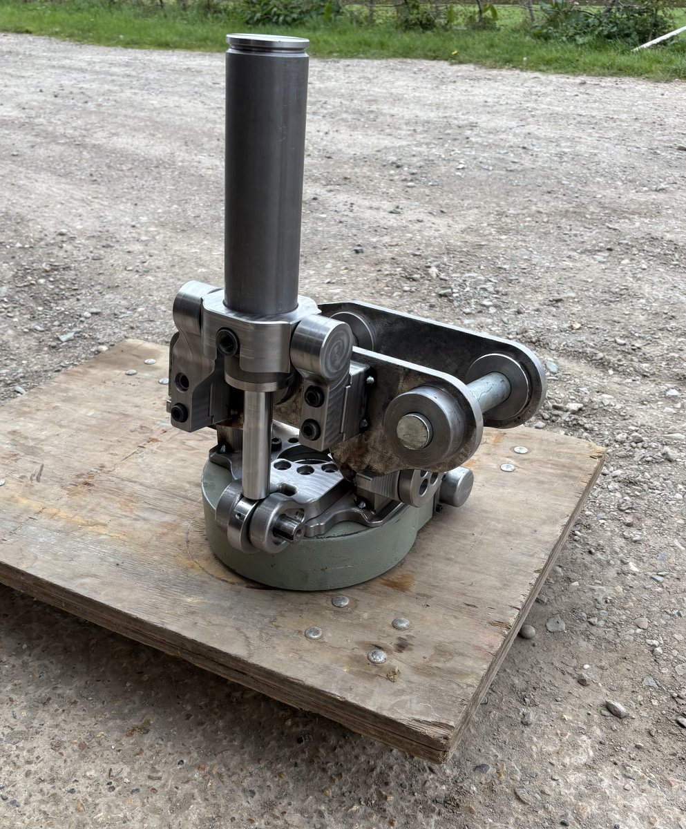

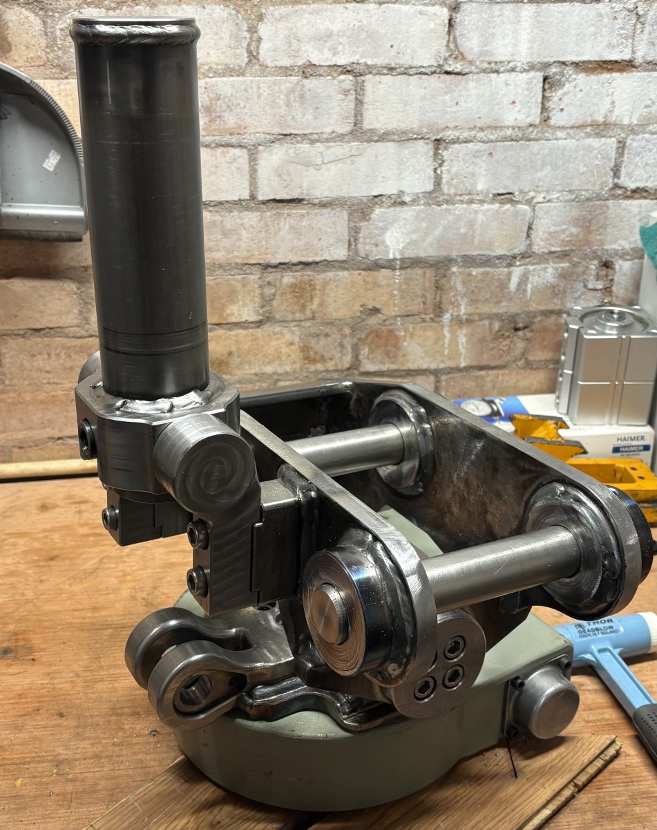

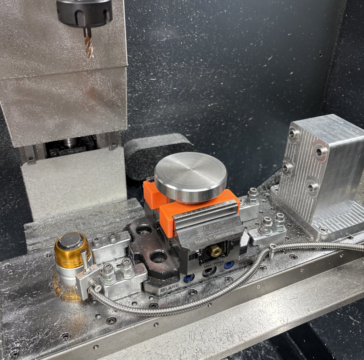

I’ve been working through a few of the smaller jobs — drilling through-holes, tapping threads for grease nipples, and machining the trunnion mount brackets to suit the bronze bushings.
The cylinder is a standard kit from Steerforth. To achieve the correct stroke length, I’ve shortened both the rod and the cylinder by 30mm. To help with alignment of the rod eye during welding , I left a 10mm stub on the rod, which locates into a machined recess in the rod eye to give a nice snug fit .
I’ve also tacked the main components together to trial-fit everything on the machine and check for any potential collisions just using a set of bucket pins temporarily — everything looks good so far.
It’s starting to take shape now. I just need to finalise the position of the rotation drive motor and decide where to mount a cross-line relief valve. I’m thinking of making a bracket to mount it on the side of the tilt ram, similar to the setup used on Engcon units.

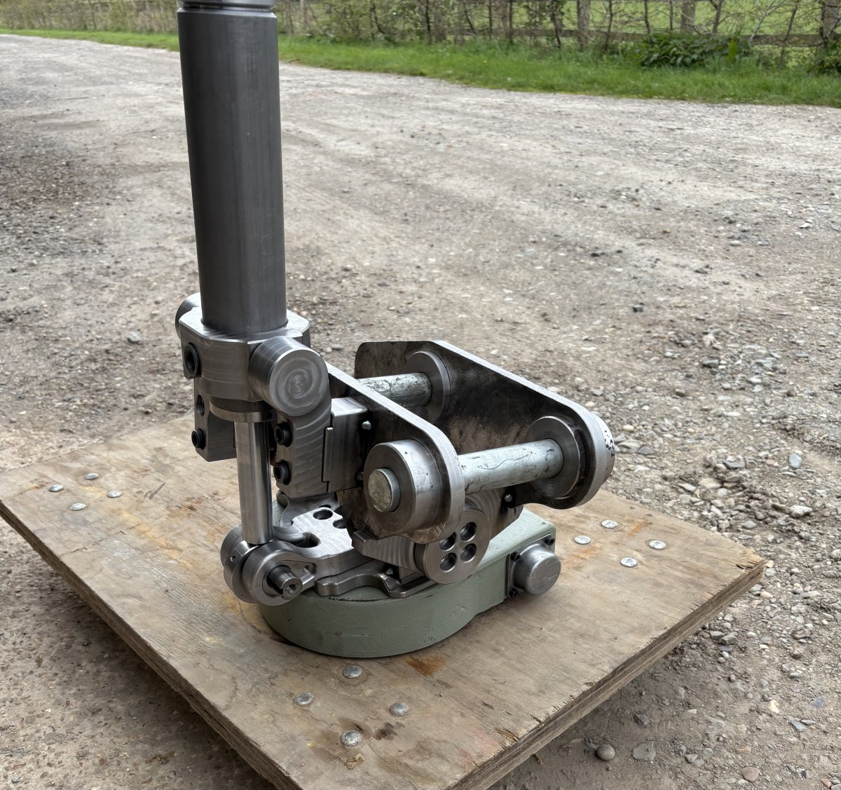

Well member-known
View attachment 80988View attachment 80987View attachment 80989View attachment 80990
Looking good, needs a bit more welding before you try it too hard

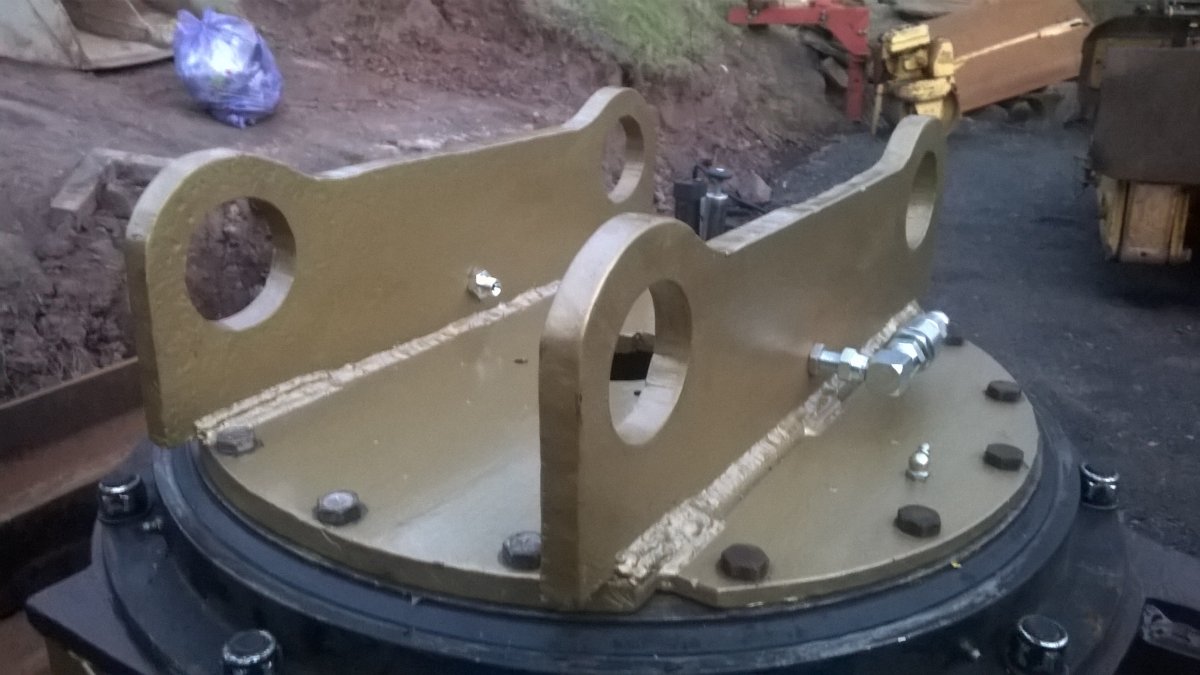

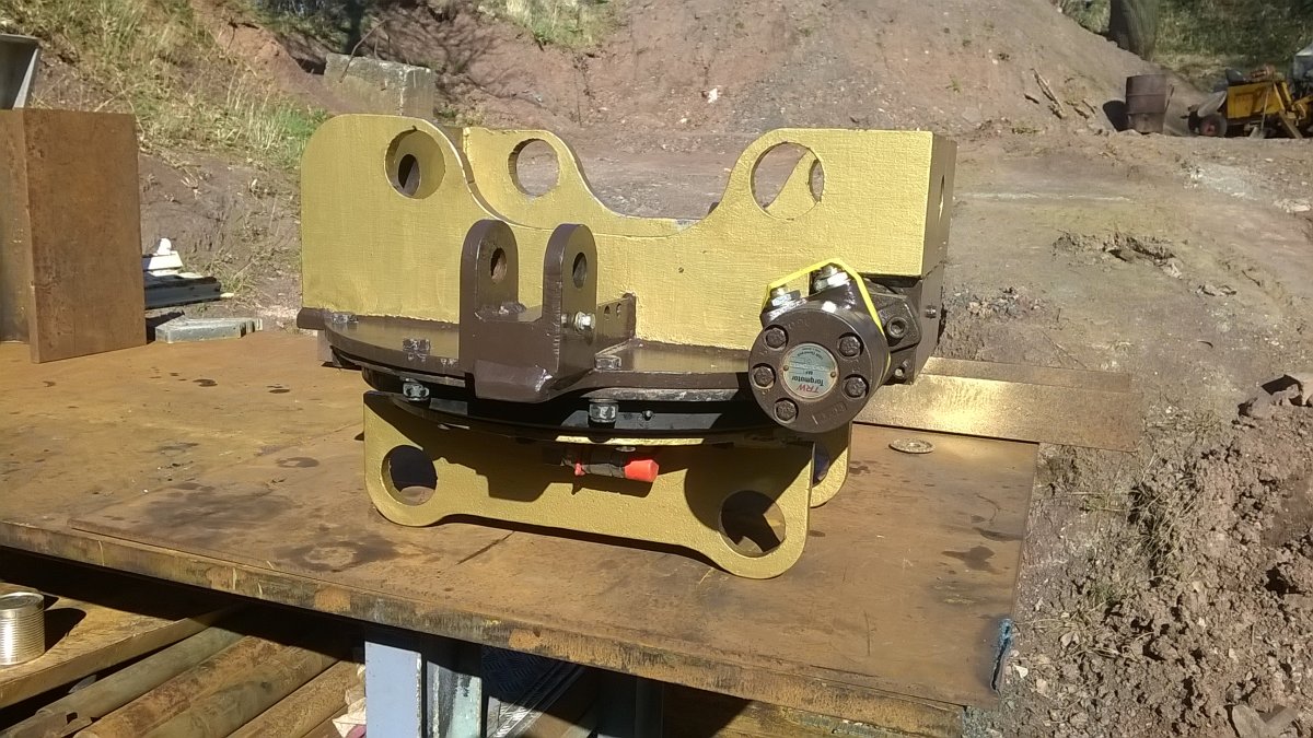

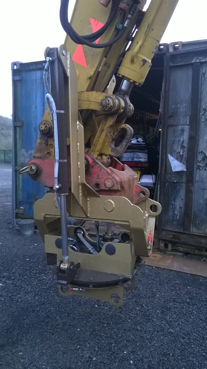

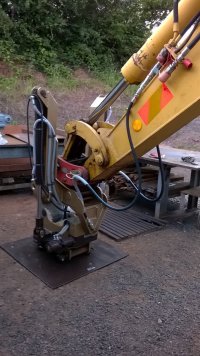

:oops::( .. you won't enjoy that ... my VA-r I originally made two cheeks to pin buckets on (but had a limited selection of buckets, then)
then acquired a Hill hitch and bucket set -modified the Hill to mount under the VA-r

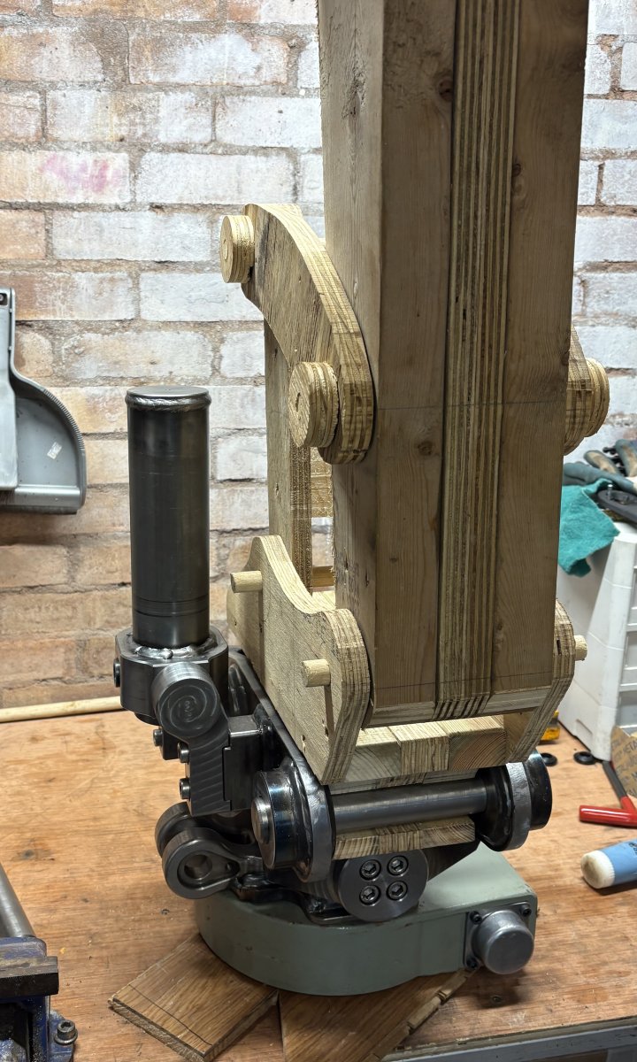

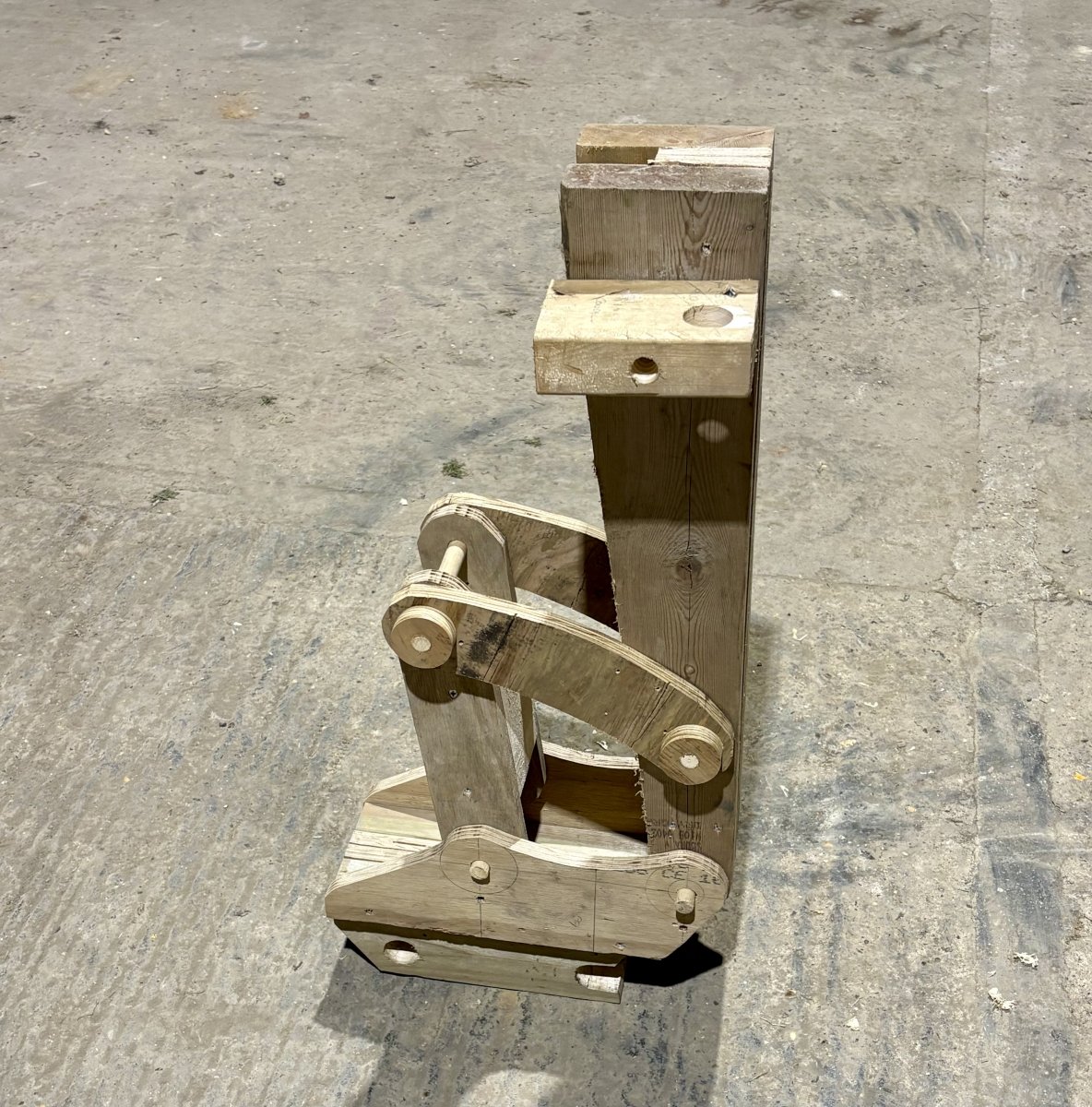

Build update:
I’ve started looking at the hydraulic hose routing to figure out the best configuration.
Getting the hose lengths right is always a bit of a challenge, especially allowing for movement and rotation.
To help with this, I’ve made a very rough dipper jig that I can take with me when getting the hoses made. It should allow me to mock everything up properly and account for the rotation on the bucket.
Diggerdavey
Build update:
I’m liking the depth of thought going in to this

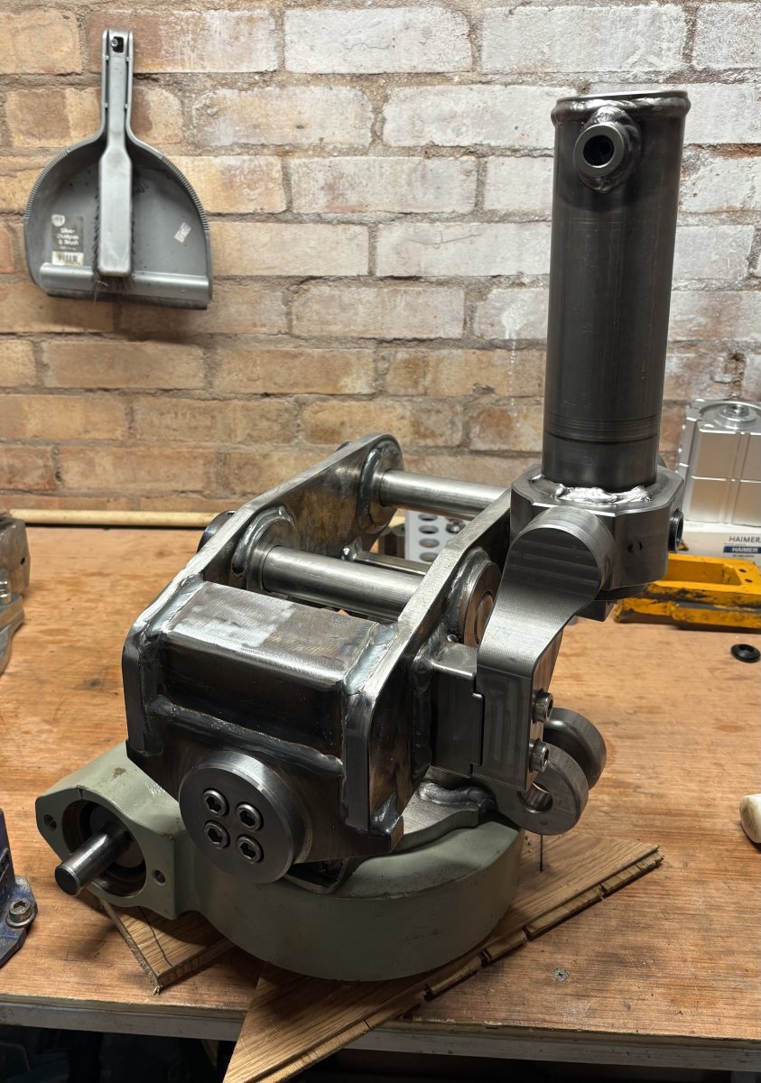

Everything is now fully welded together.
I’m planning to get the hoses made up next week, and after that it should be just about ready for testing.
It’s definitely satisfying seeing everything finally coming together.

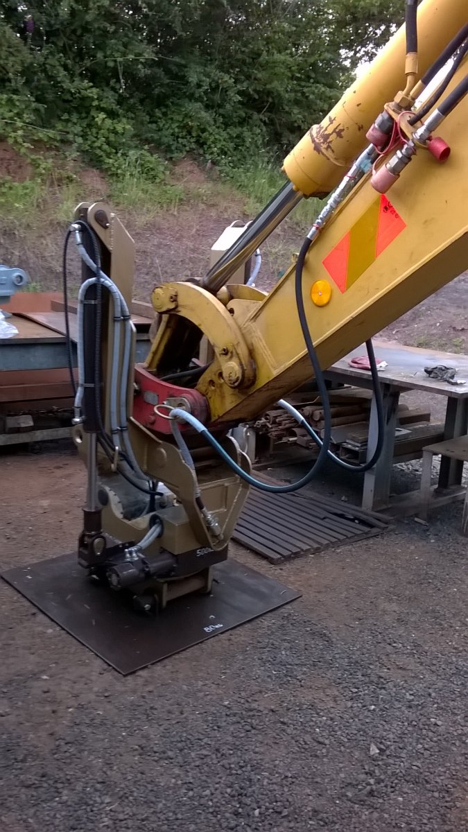

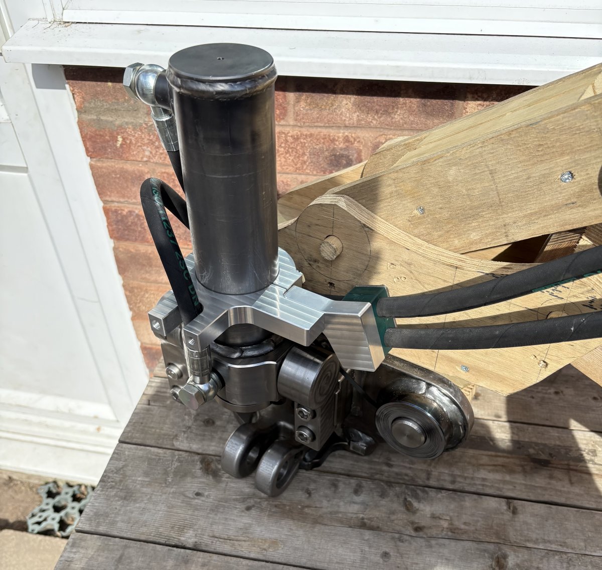

Went in the evening this week to get the hydraulic hoses made up .
Made a bracket on the cylinder to hold a stauff clamp with hoses in the correct position.
A similar smaller bracket will be used higher up to allow a cover to be placed around the cylinder
