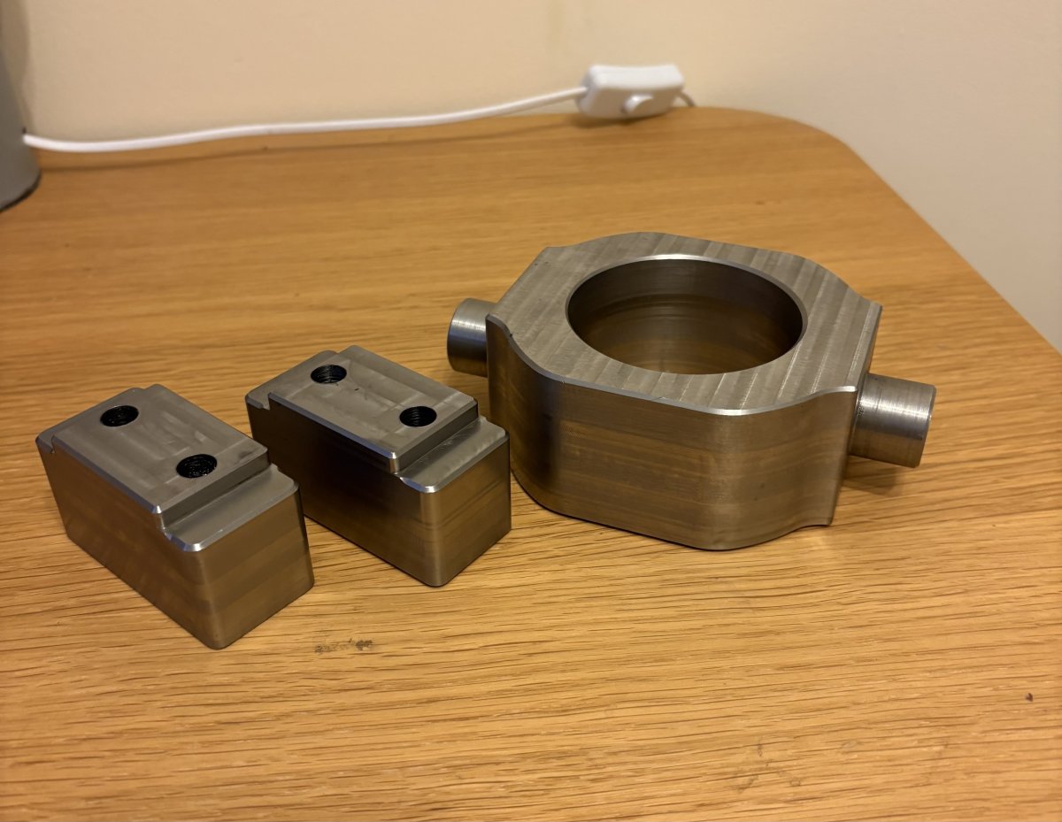

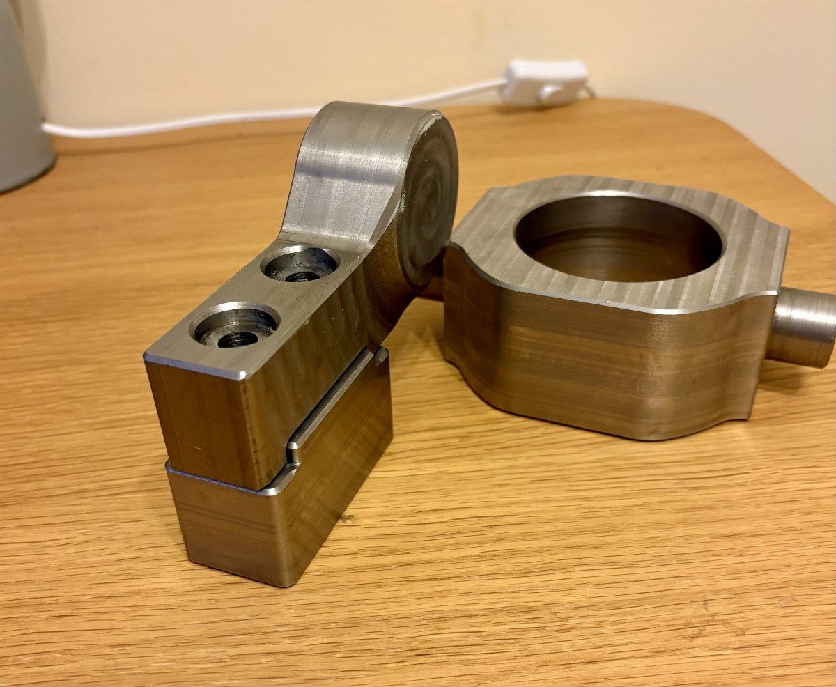

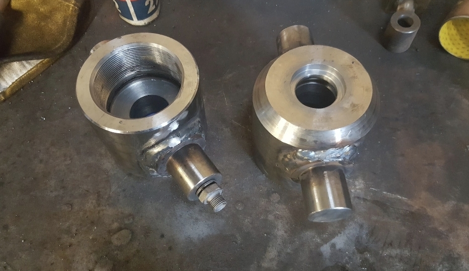

Not sure I have the facilities at uni to be able to machine the threads into the cylinder ?

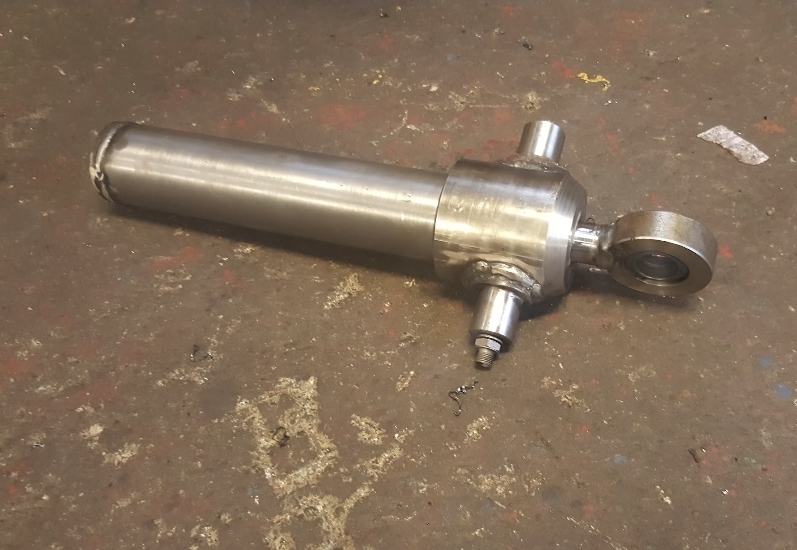

@CPS You said you normally use a sacrificial head gland when welding trunnions on ? - Where do you source your cylinders from-is it the same with the oring below the threads ?
Of course the head gland doesn’t necessarily have to be threaded on you could do a flanged head gland like most excavator cylinders . You take your grunion block and drill and tap holes for bolting on the head gland on the front then socket the cylinder into the back of it and weld it in.

Any recommendations on suppliers for this sort of custom cylinder?
Never had any problems, weld it on and let it cool.
We normally get the rams local, or buy them in kit form and build to suit.
Some engcon rams we built from scratch a few years ago.
