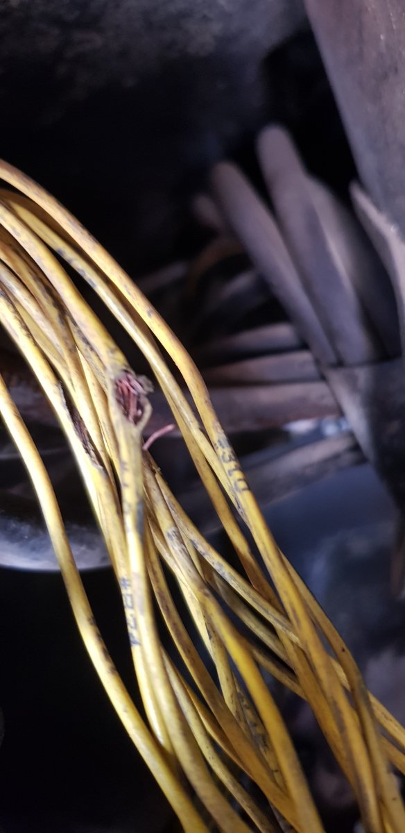

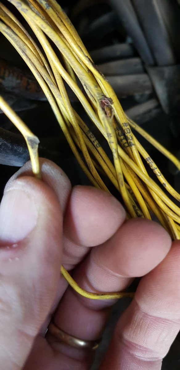

Hi all
Just a little update. I went out to the digger yesterday after a week or so , turned the key and all fine. Then after about 3 minutes it just cut out and blew the fuse again
For sum reason I went to under the pull up arm and decided to look at the not used accessory plugs , I decided to pull them through from under the arm and into the little lockable tool box in the side. And look at what I found ? Hopefully this is the cause and end of the problems.
