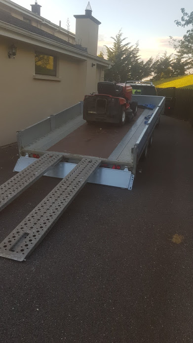

interesting drop stands for ramp loading, but can't see many folks crawling under to set them ... that'd load the back axle beam significantly if not used
Don’t need to crawl under it as you can lower the drop stands from the side. Having said that, I agree with you that they won’t be used often if fitted.

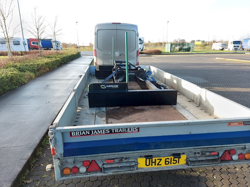

Crikey those Brian James are some money. £6900 plus the vat with sides and ramps.
Think I'll stick with the plant trailer.

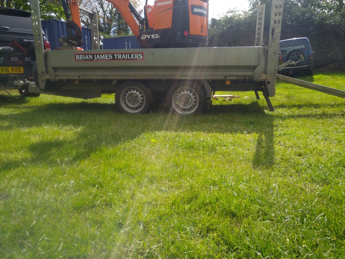

Got drop down stands on mine but completely pointless, easy enough to get at and drop down but probably about 100-150mm short of the ground.
Doesn’t surprise me with Brian James, in my experience they are crap.
My plant trailer has cracked across the tub many times, and it is largely because the ramp supports are nowhere near the ground (and cannot be adjusted). You’d have to load a 13 tonne machine to squash the suspension enough for the supports to take any weight and remove all the loading from the bed.
Look good, are well finished, cost plenty but are badly designed unfortunately.

I'll take a pic of them tomorrow but the loading legs are pathetic, even if you tip it all the way up I doubt they would touch the floor

It pivots at the drawbar, but the weight is not on the axle, it rests the chassis on the ground
(not the best pic)
I sincerely hope they'm bidding you serious bucks on the trade in Aiden :unsure:..... nice looking trailer that ... look good in Wales :giggle:;)(y)
It's closer to 75-100mm but either way never use them as its just more crap having to carry multiple wooden blocks on the trailer to suit
