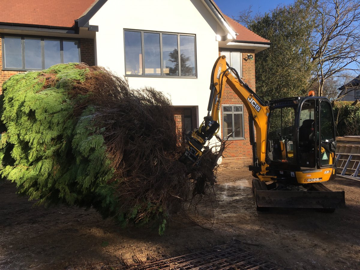

Well here's a photo for you all. I've been using the grab in anger for the first time and its a dead handy bit of kit. Cleared a decent sized garden of bushes and shrubs and fed the chipper with it, you have to be careful of branches getting hold of the pipes out the back of the tilty to the grab but I'm learning to be a little bit more cautious with it since my episode in the yard on the first day:rolleyes:.
Its developed a couple of leaks which Engcon are aware of and we are nearly there on getting the install 100%. After a conversation this evening with Engcon, they are going to replace the tilty to save on downtime and I've got someone out Saturday morning to install it and fine tune it. Cant complain with that service and I understand these things happen. I am after all a JCB owner :p

Looks great, does it take long to hook the grab up?
What sort of weight can you pick up with the tilty on?

................. and we are nearly there on getting the install 100%. After a conversation this evening with Engcon, they are going to replace the tilty to save on downtime and I've got someone out Saturday morning to install it and fine tune it. Cant complain with that service and I understand these things happen.
Anything can break irrespective of colour or manufacturer, be it a kettle, car, machine or attachment. Its the speed and type of response from the supplier that makes it a
"these things happen" type of reply or makes one go off like a bottle of pop. ;) I'm pleased to hear Engcon are getting it sorted for you.
MMMmm, if that was last week, you should have been sorted at weekend. :confused:

True to their word I did have an engineer out Saturday who spend 4 hours stripping it down, fitting new seals and improving the hose routing. He has managed to fix 90% of the leaks but there is still a weep from the tilt ram. Engcon are aware and are still getting a new tilty out to me. There were no 2019 ones in stock so one is currently being made for me. This will then be modified at Engcon HQ to accommodate the perfect hose route and should be a doddle to fit on site.
Brendan it takes under a minute to hook the grab up. I've gained a hydraulic hitch under the tilty so drop bucket off, pick up grab, turn machine off, de-pressurise the aux line it connects onto, get out and plug her in. Weight wise I haven't really been picking up much and the grab, tilty and top hitch weigh in the region of 180kg I reckon (more like 240kg if you go by the labels but I think its lighter than the plaque says) And I'd say it will pick up around 500kg comfortably. To lift tonne bags again I must put a hook on my top hitch (should of spec'd one) and drop the tilty off which again isn't very hard to do. Exactly the same process as a hammer but one added plug to remove. I always knew there would be some form of compromise especially on a small machine but what has surprised me is how few compromises I'm having to make so far. She handles it really well.
