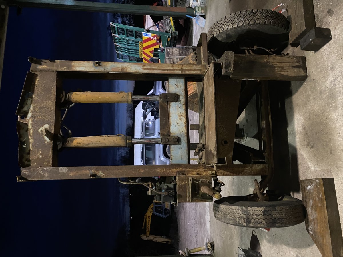

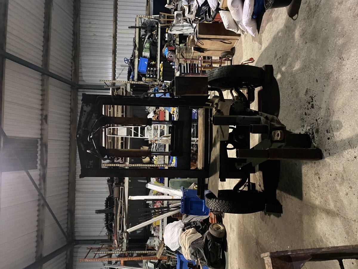

Bit of a Facebook marketplace impulse purchase, got up to Oldham and it was lot bigger than I thought haha. Will give it some Tlc get it painted and up and running.
currently setup to run off pto
might adapt to skid and machine mount or wild idea but it on tracked dumper instead of tipping bed and make it lower able for transport haha

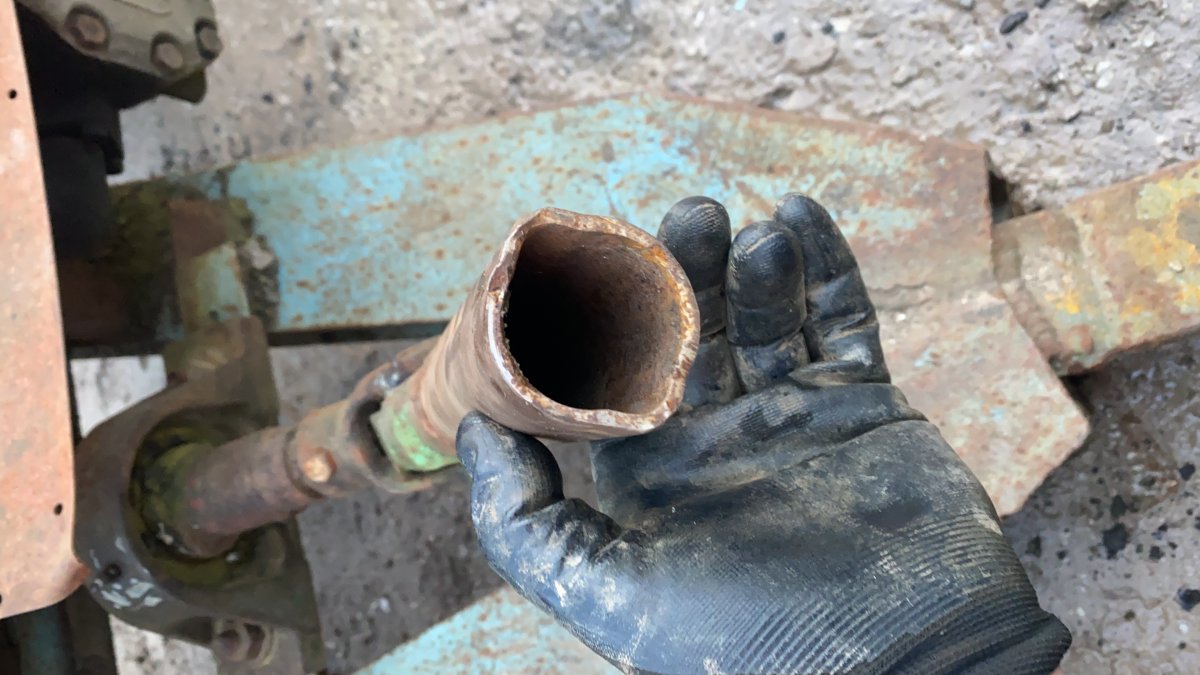

Anyone know if this has a name/style etc need the tractor end
Lemon profile PTO shaft. Measure it up and compare against charts to see what you have, you will need either an outer or an inner plus PTO joint to make a pair that fit together..
Need an inner, got 5 spare or old shafts and 6 shafts on kit and not 1 is this profile lol
Lemon tube as above just take the whole lot off and take into your nearest agri dealer and they should have everything off the shelf if they are any good as the tube has to then match the yoke on the end as well
Or just forget pto drive and convert to straight hydraulic you'd only need a log splitter valve and a few hoses altered.
Thought about it but in the yard running of tractor pto will be better unless I purge all the oil out of it, put some quick connectors on it then could run off spools off tractor or machine. Think beaver pack wouldn’t be quick enough.
