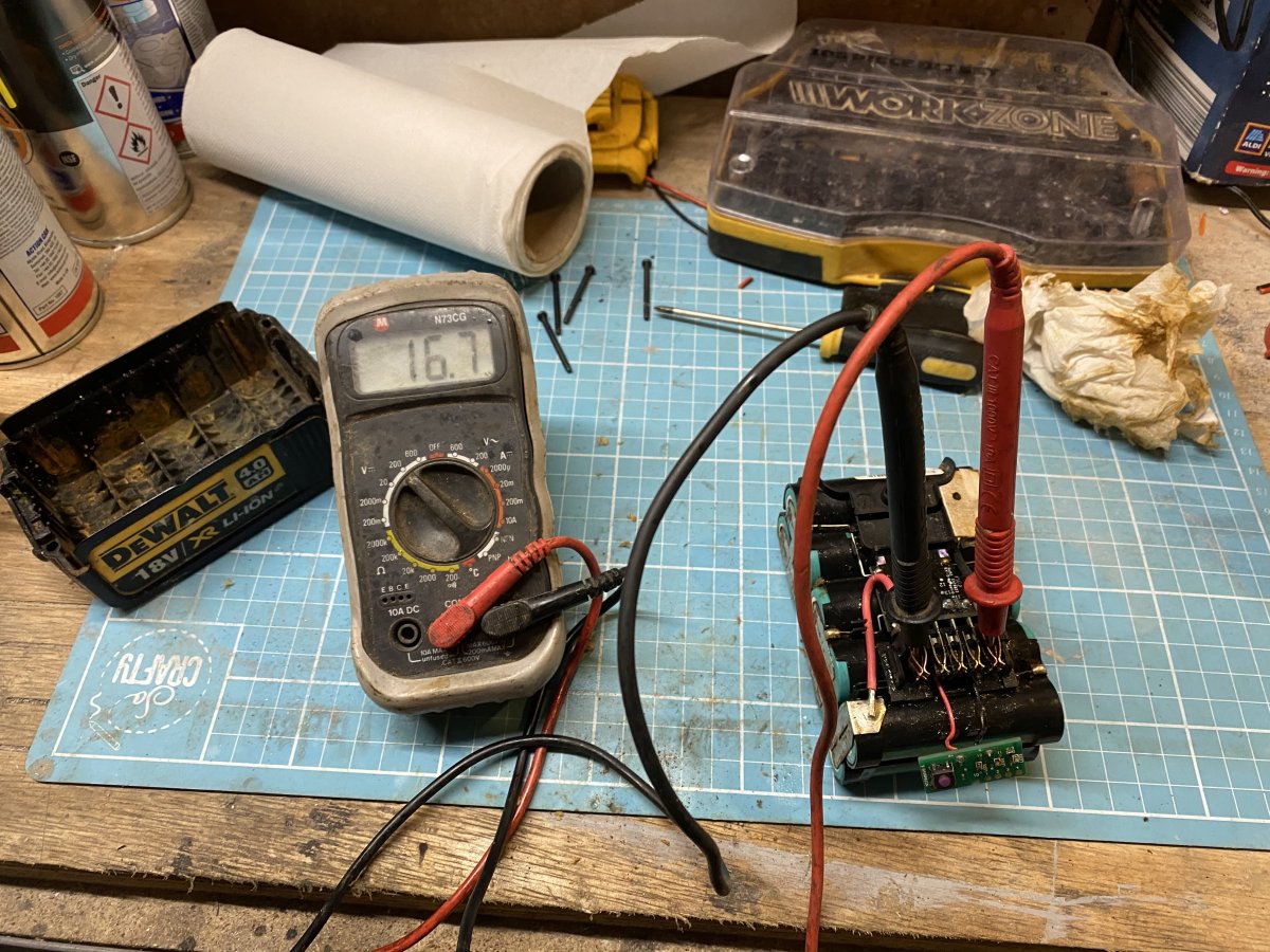

battery protection circuit :-

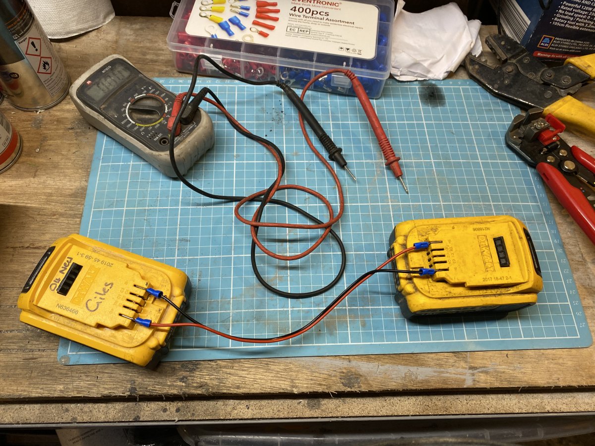

Trying the jump
Getting 16.7 volts no dead cells, power indicator doesn’t work and won’t charge throws up yellow overheat light
If its like makita chip in battery will be telling charger battery is knackered and charger won't charge it.
anyway of fooling the chip? ........ or removing it from circuit?
knowing these companies, that little chip probably has a counter in it ... reach the target and off it goes ... planned obsolescence ... continued sales strategy .......... chips replaceable????
last chance then. put it in the freezer overnight, take it out and let it thaw then try one last time ....
it is a 2017 battery
should work for the light build though
Interesting stuff, had a decent Unilite 1000 Lumen little worklight that died (must have let it go dead) , they replaced foc under warranty but in chatting to their tech guy he was adament once the li on batts gone "dead" it's beyond help....🤔 No way or "recovering" it.
Supposedly the makita batteries are monitored by the charger. When you put the battery on charge the charger checks battery condition temperature etc. If its picks a fault up the charger flashes to tell you and you unplug and plug the battery on again. Now so I'm told if the charger picks a fault up 3 times in a row on a battery it will tell the chip in the battery is faulty and thats it no makita charger will charge that battery again. Possibly aftermarket chargers might charge them. I don't know if dewalt is the same.

Freezer test failed, going to try get a non dewalt lithium charger and use my 2 knackered batteries for my light I’m building
You buy the Chinese knockoff charger that ignores the makita chip....

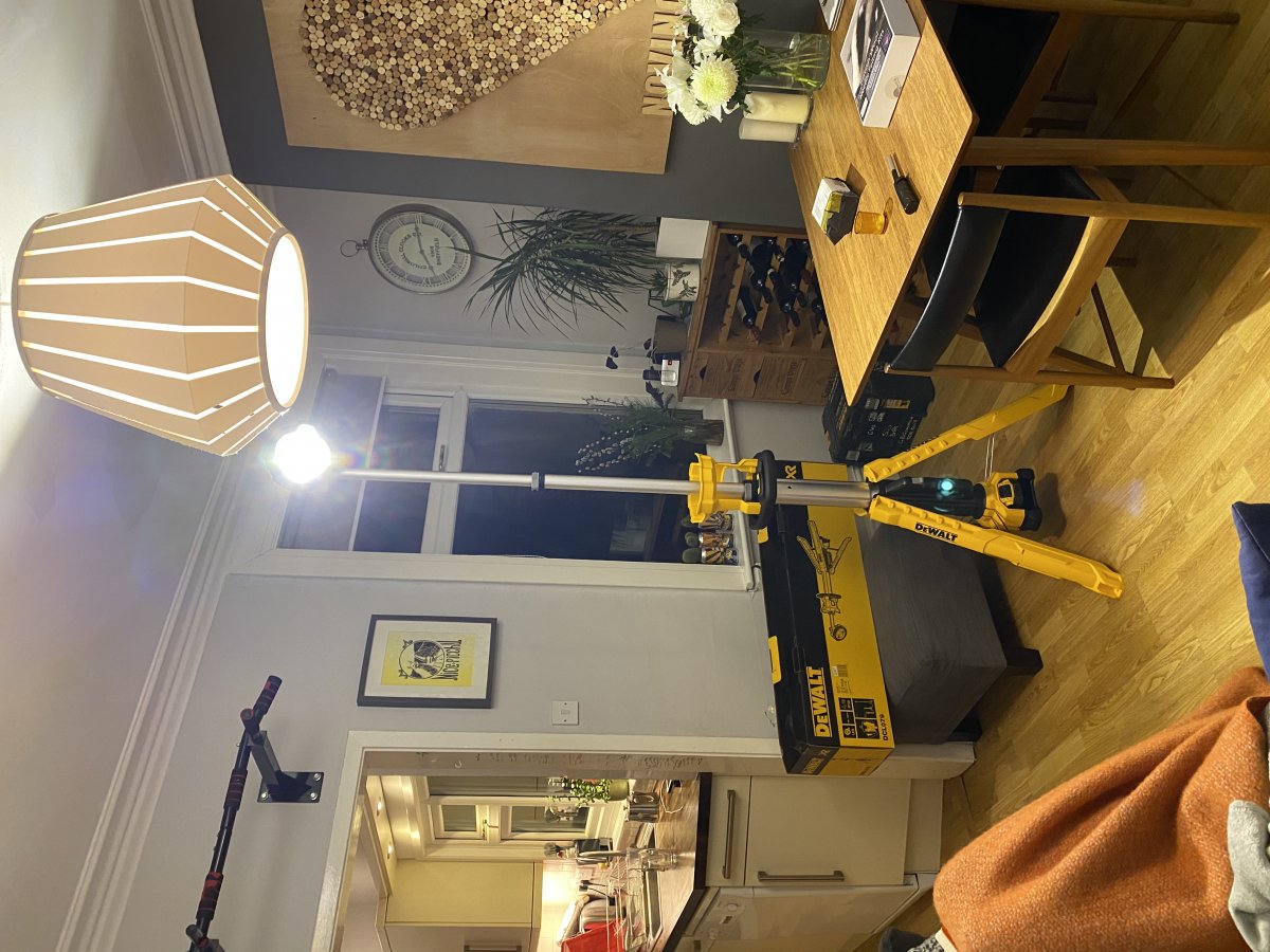

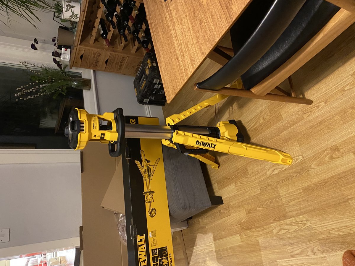

Battery development, Bought the dewalt work light tripod and the two knackered batteries work in it...
