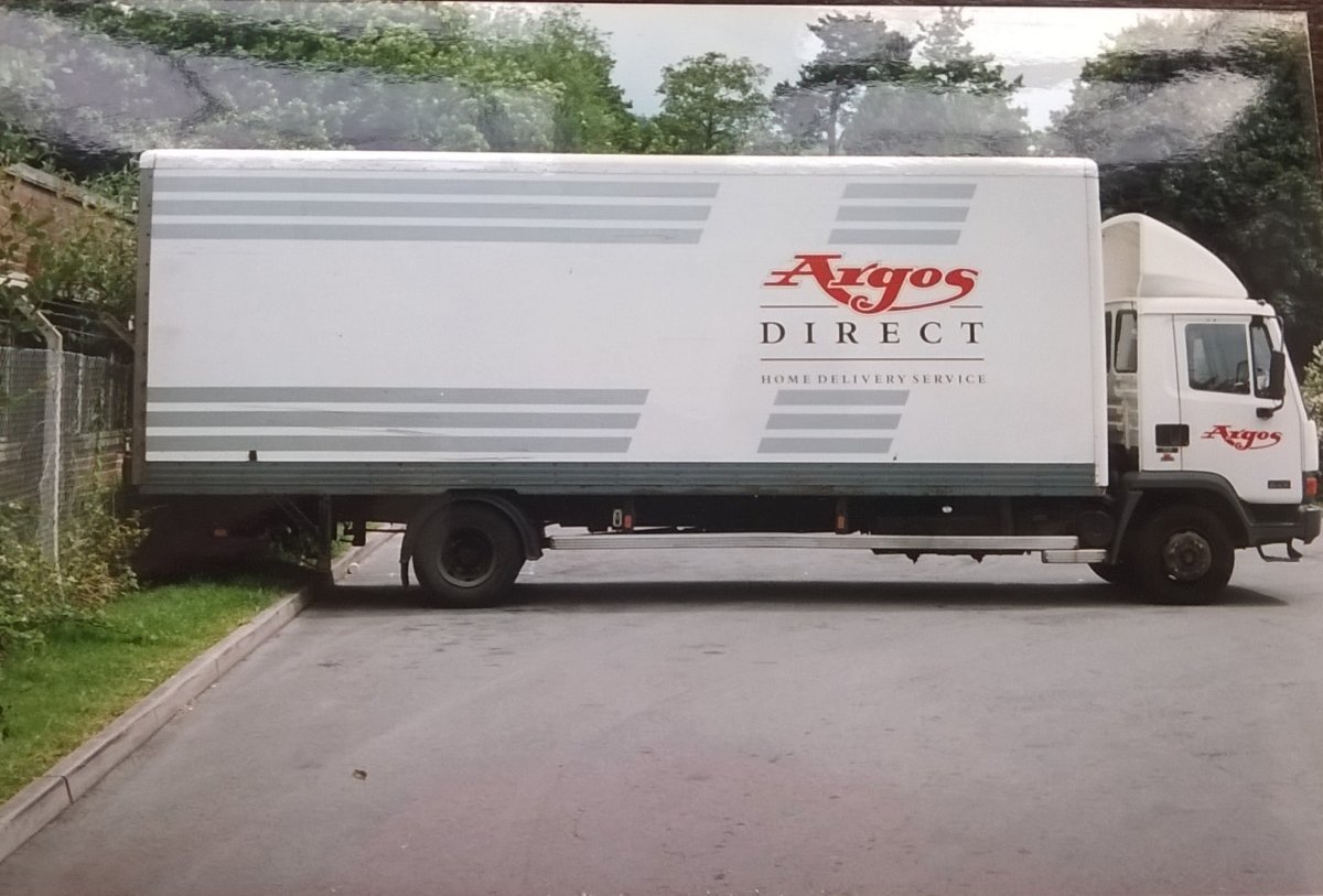

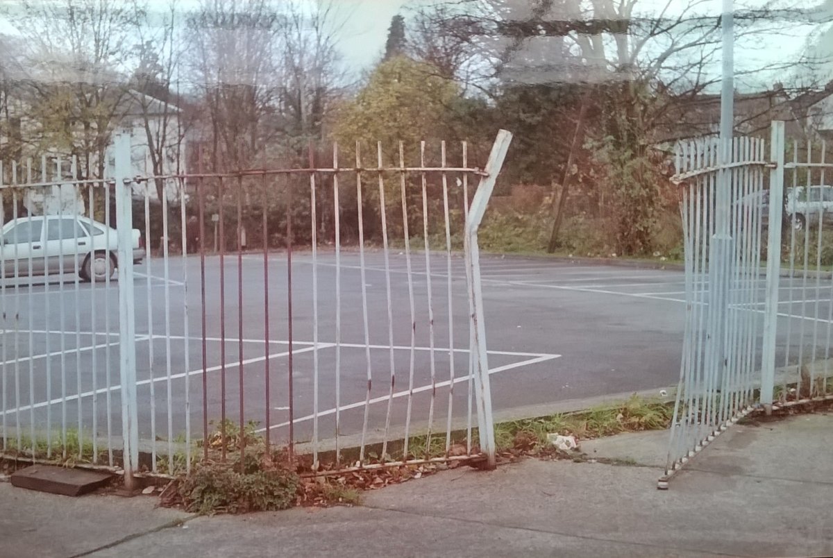

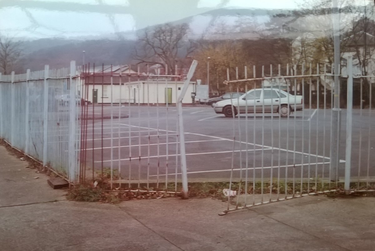

regularly came in to this sort of scene ...

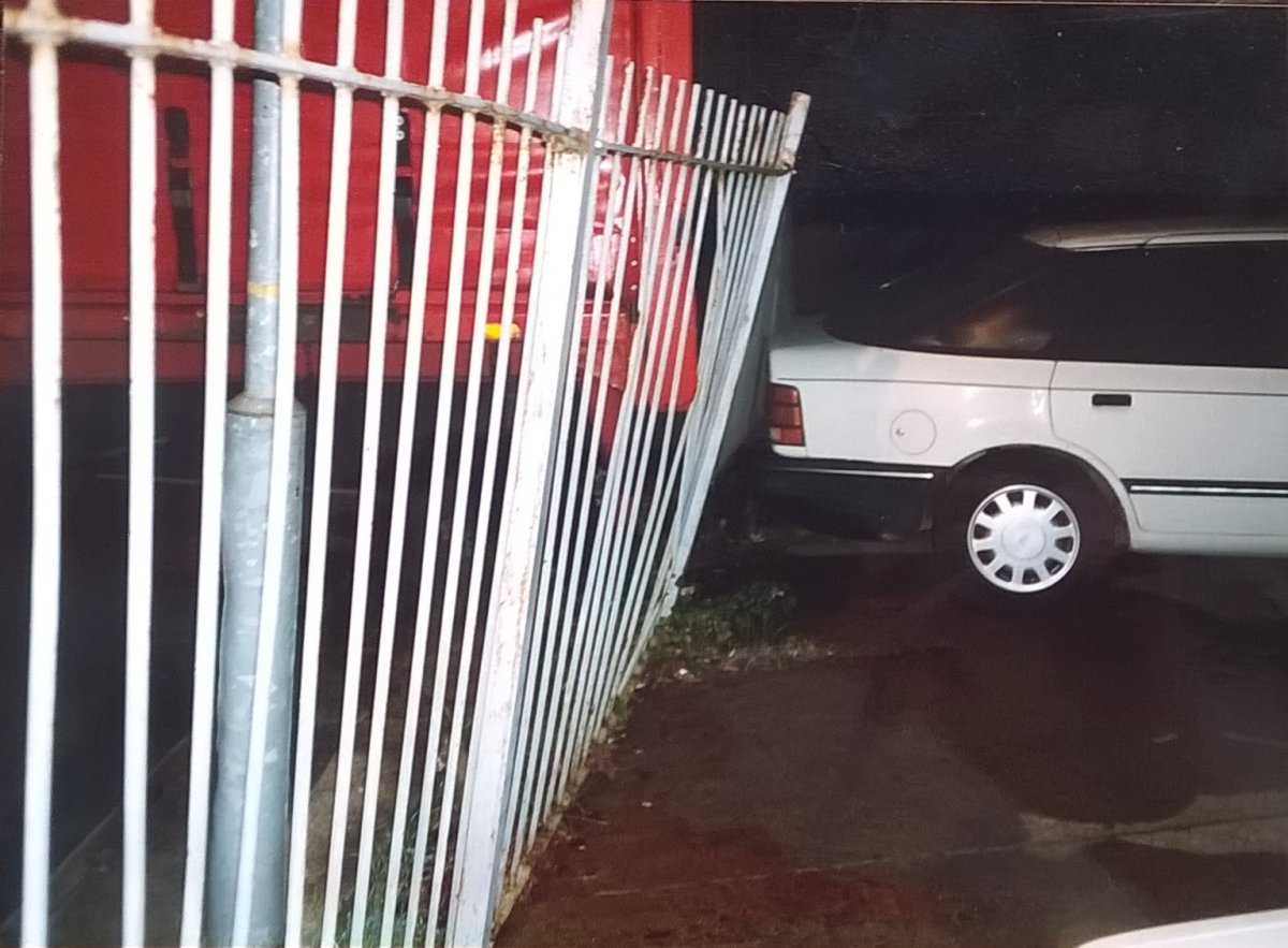

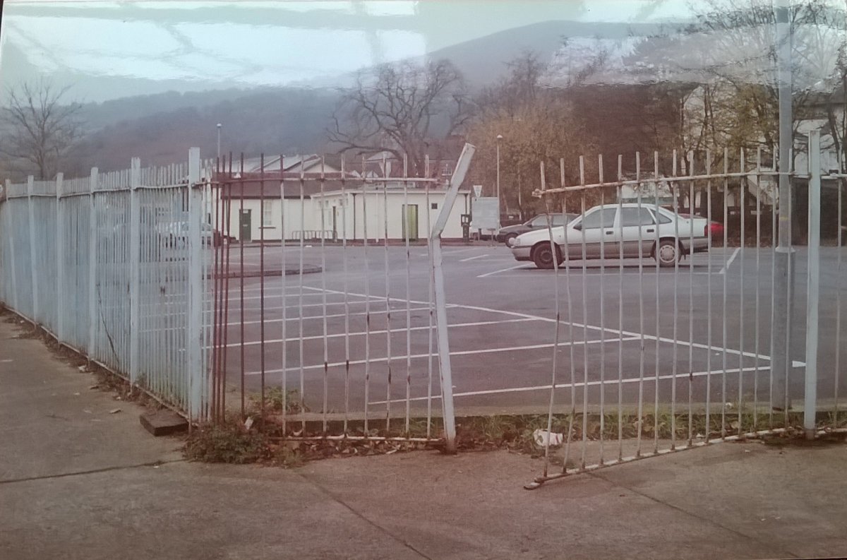

truck drivers bump stop parking
ba***rds used to cost me a lot in time repairing the boundaries .... 'til I parked a load of concrete test weights along the boundaries out side in the car park, when I replaced the fence with 8ft palisade ..
Council were always on at me to move them ..
" you pay for the repairs, or stop the trucks parking there, other wise the concrete blocks stay "
were one of the last things I moved when I cleared the yard :rolleyes:
View attachment 71304 View attachment 71305 View attachment 71306 View attachment 71307 View attachment 71308

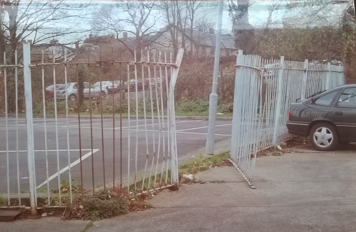

and this one was as I was coming out one evening to get in the run around Granny .. would've clobbered the car and been in the yard if I hadn't been yelling at him to stop -- tosser!! :mad:
had one one night, was 8ft into the yard, had gone up over the kerb and was parked on top of the fence panels he'd just mowed down and run over - absolute w⚓ .. not fit to be driving a roller skate 🤬🤬🤬

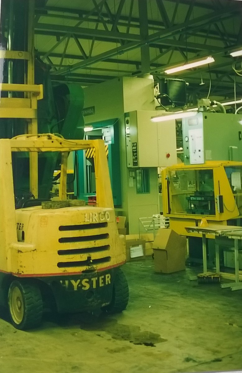

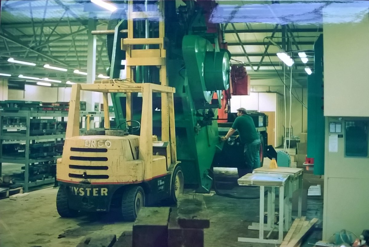

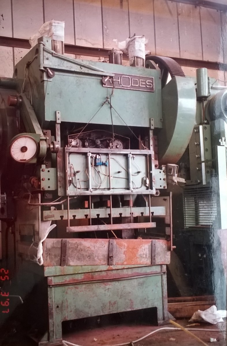

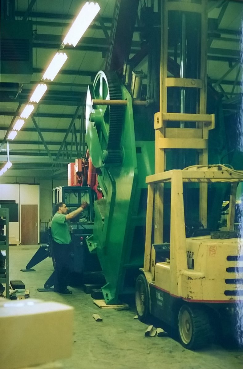

mentioned this lump somewhere earlier .. the press shop we regularly installed gear in sent me this pic and asked if I thought we could get it into their shop (was taller than the roof structure's internal bracings) ...
so after it'd had a bit of a refurb and tidy up, it duly arrived for installing ... after we'd pulled several bracings out, to upright it and then re-installed them around the Rhodes, once we had it in its final position

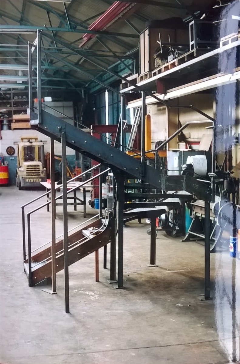

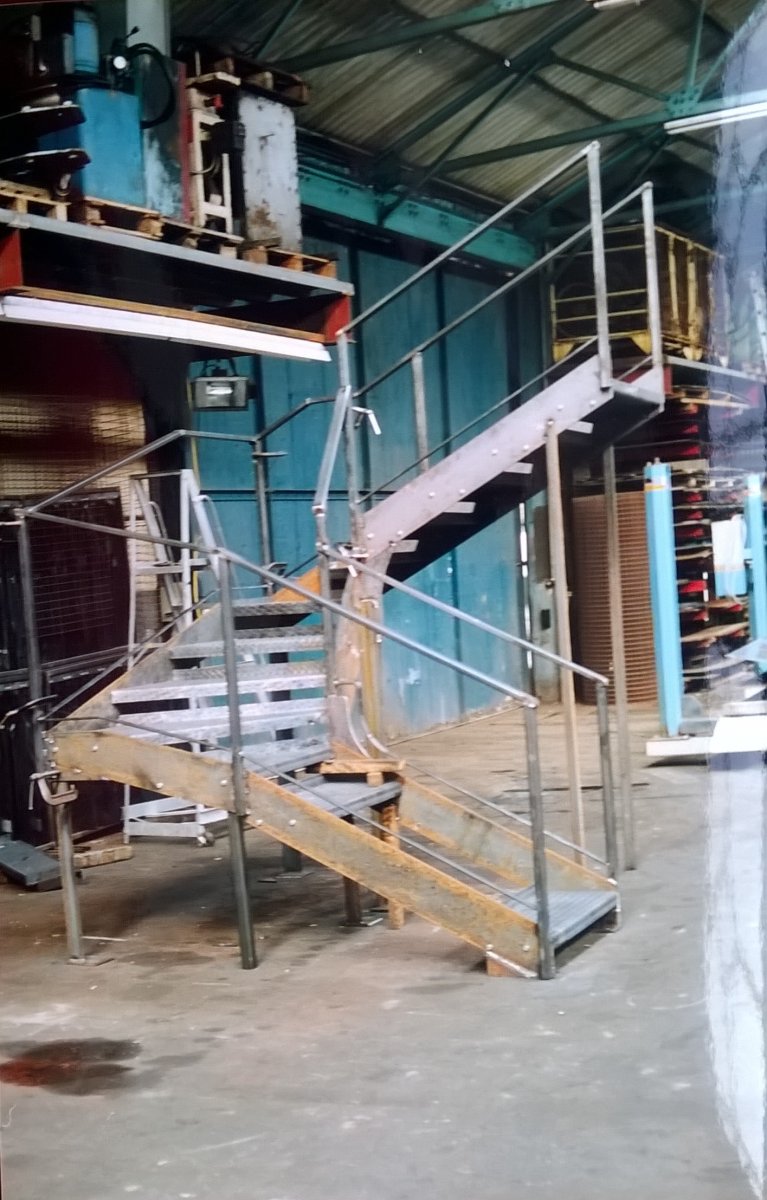

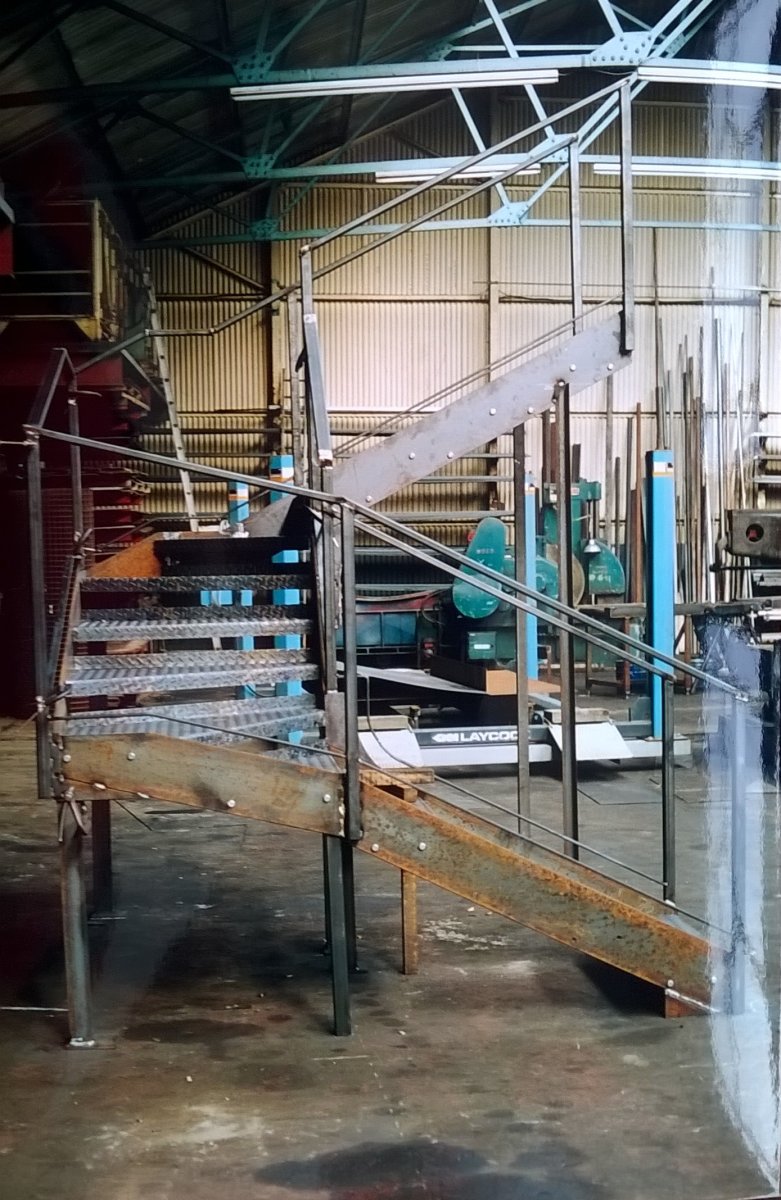

and --- a little bit of a head scratcher ...
had to be completely CKD as access was 'difficult' round the back of a very nice house for a balcony to garden access .. handrail infill was all decorative and the customer wanted 'larger than normal' treads, hence the shallow pitch, so was easier to 'mock it up' in the shop and be sure of it all being 'cock on', rather than spend hours drawing it all ... looked great installed having lugged all the bits into place and assembled it all .. I'm hoping I have some pix, but not come across them yet :(

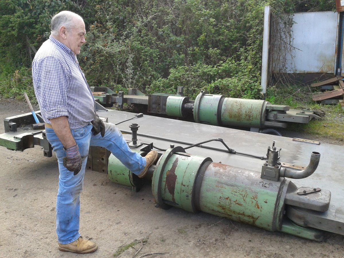

just tripped over a vid from the w/shop strip out, that me mate Doug, Monaro man, took - thought it might be of interest to some .. and a few pix .
as you may be able to tell I'm struggling with 'sitting about - doing sod all' :rolleyes:
h ttps://www.facebook.com/carol.griffithshiley/videos/10202385805024391 ( remove the gap between the h at the start of this - wouldn't show up in this post, without altering the addy :unsure::unsure::unsure:)

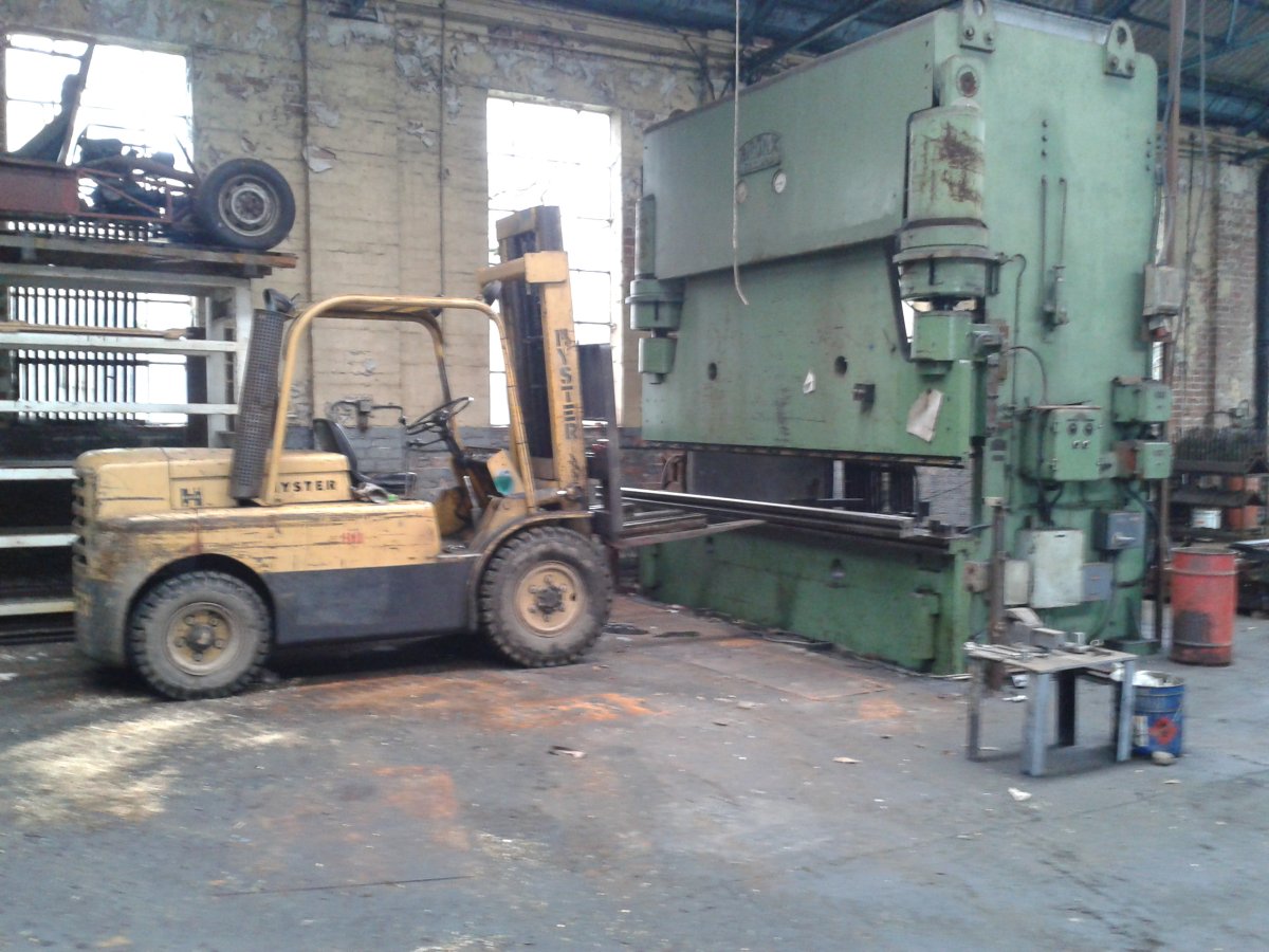

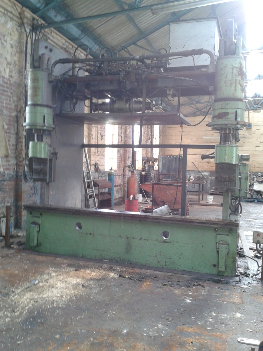

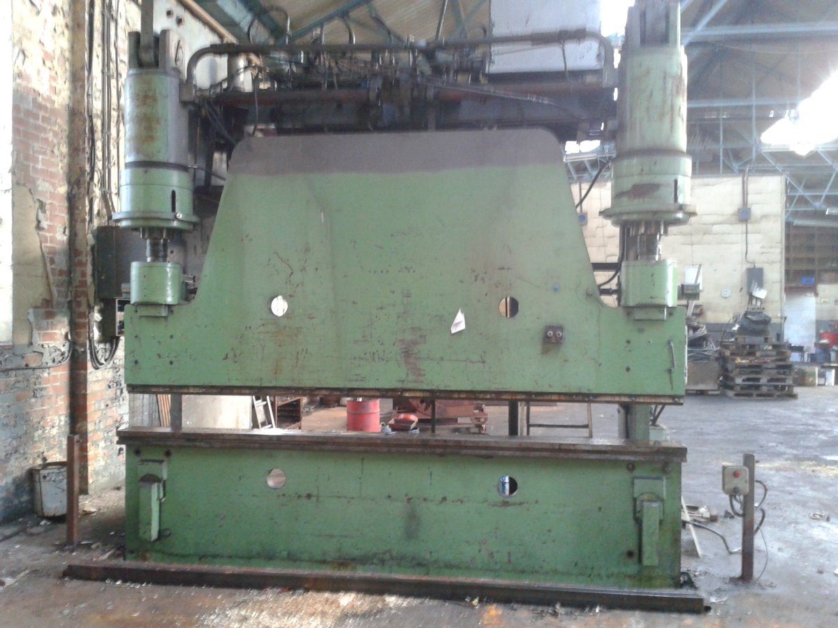

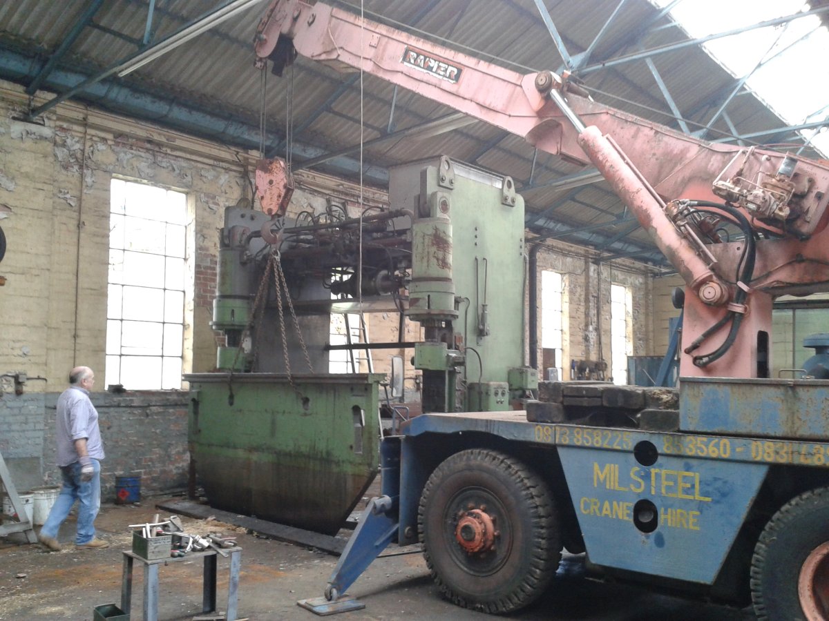

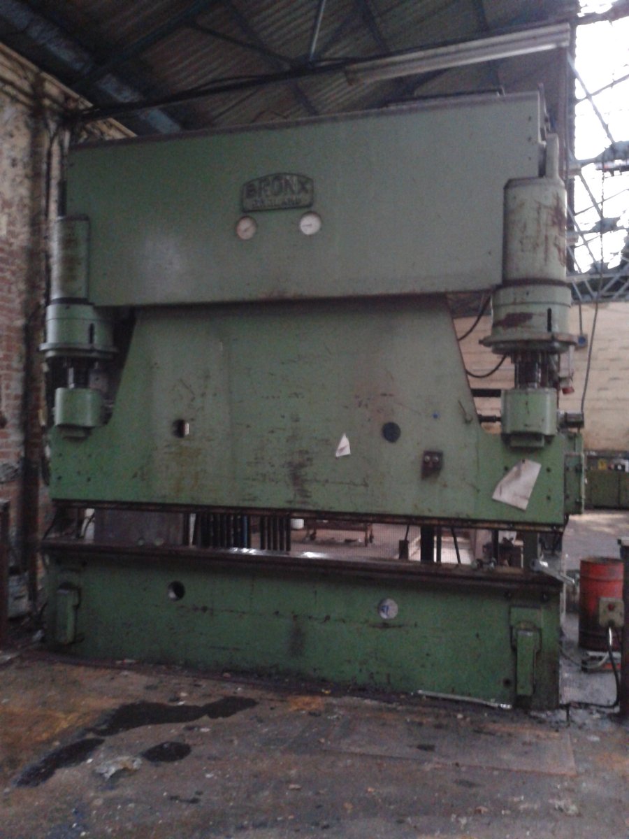

32t of 320t cap. press brake - it went in in one piece 2 cranes, skates and several pairs of hands .. worth more in scrap than I'd been bid on it, so came out in bits for the skip :cry:

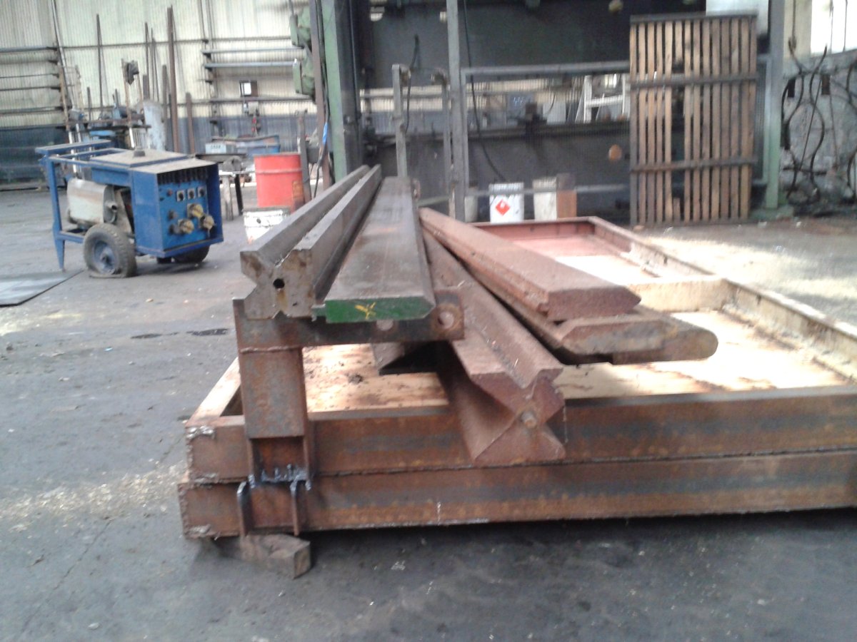

stripping the tooling out - that multi vee bottom was 150 quid a foot when I bought it (12 footer)
couldn't find a buyer for any of the tooling - sadly went in't skip -- 'bout 8-9k's worth to buy - should've put the saw through the shiny ones into 4 foots and kept 'em :(:mad:

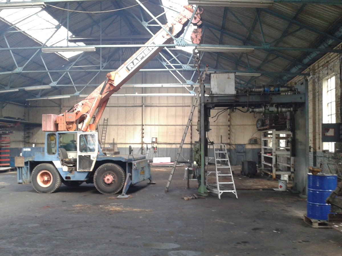

top cover plate off ready to start stripping

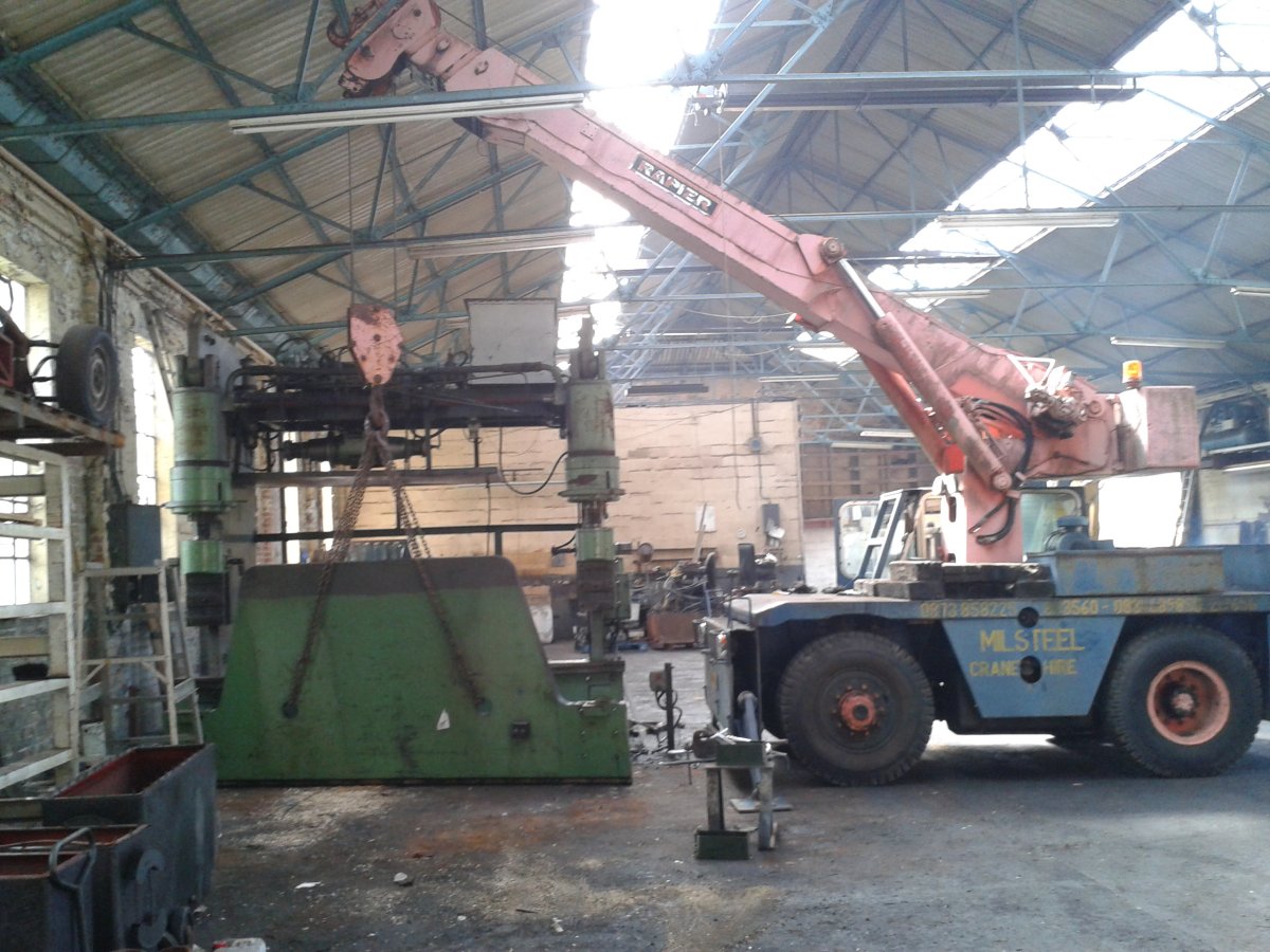

top beam off
lower apron coming out of its 3 ft pit, I'd had to dig out and cast into the floor when I bought the Bronx

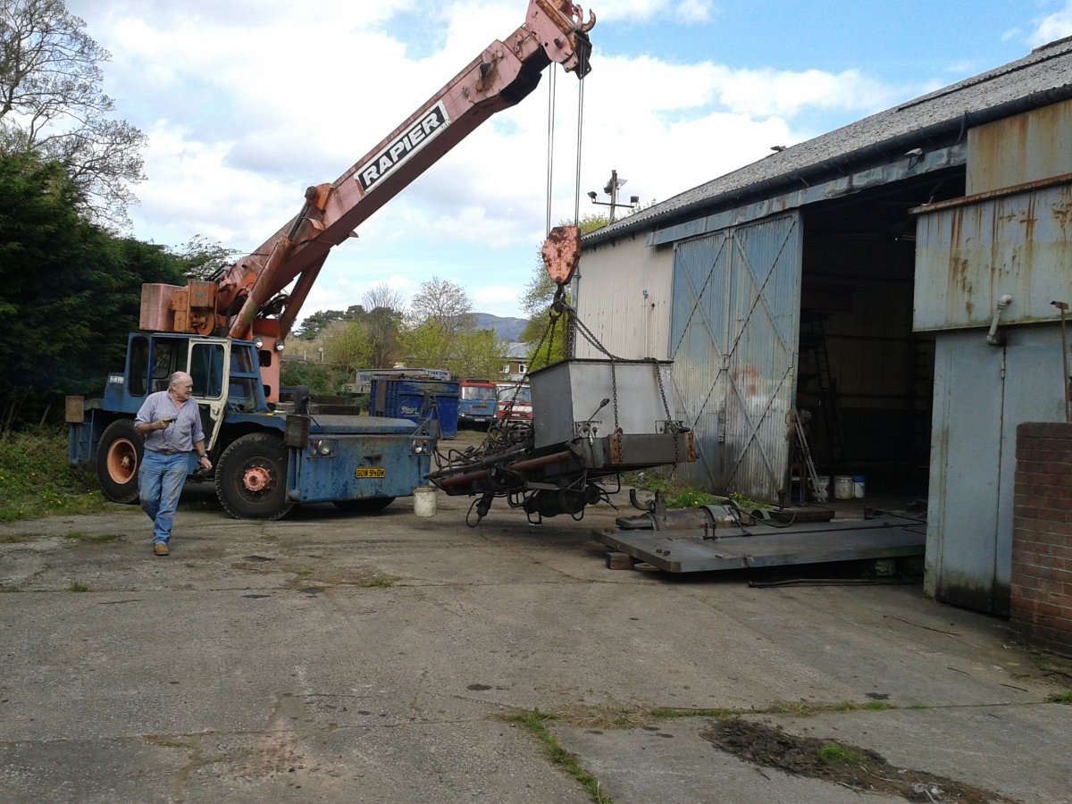

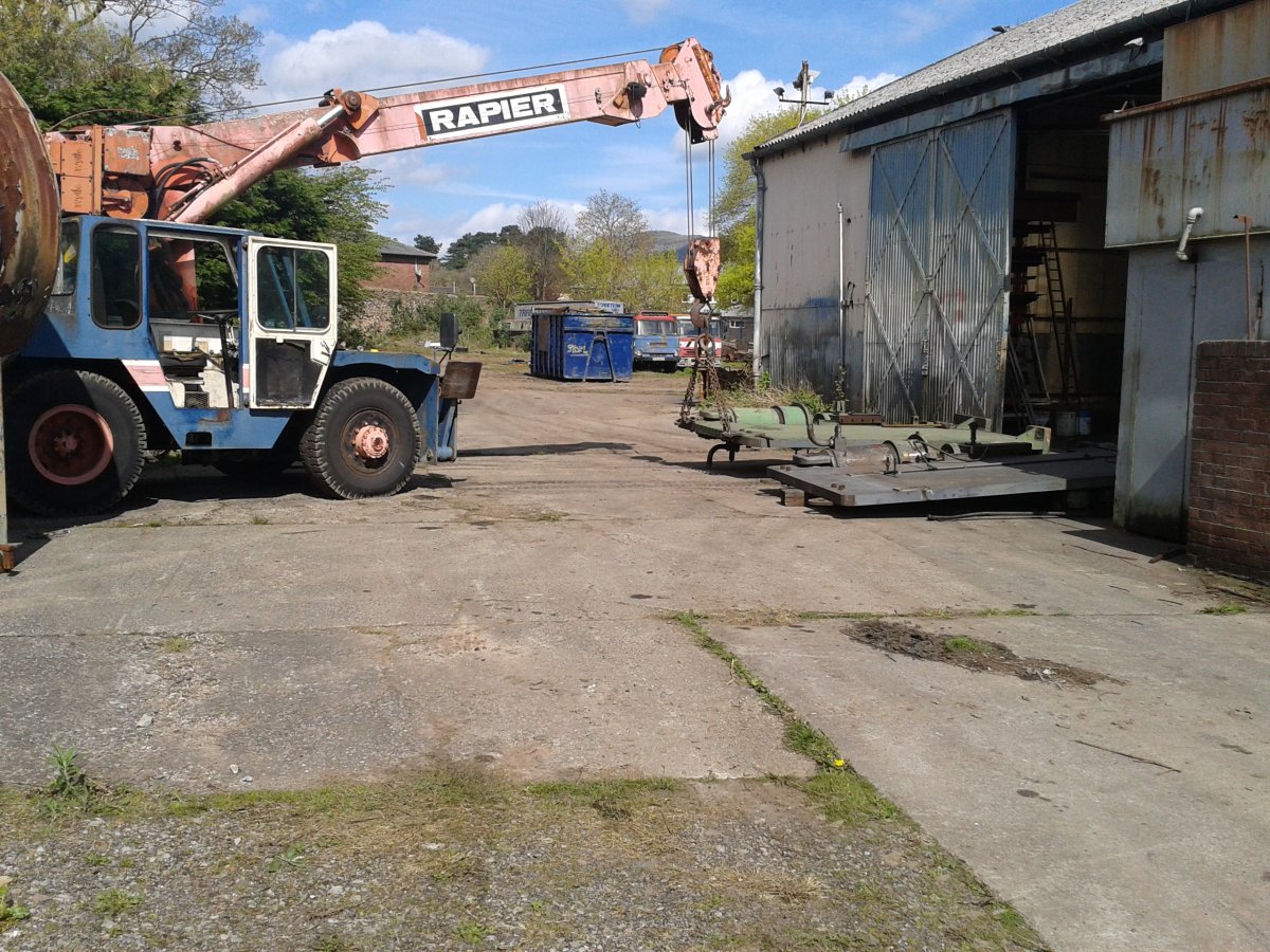

took the machinery deck/platform's weight with the 4t Hyster and unbolted an end frame, laid it down and skated it out the door
machinery deck
and up the yard to lift into 40 yarders
took some getting in :rolleyes: and getting off the deck after :ROFLMAO:

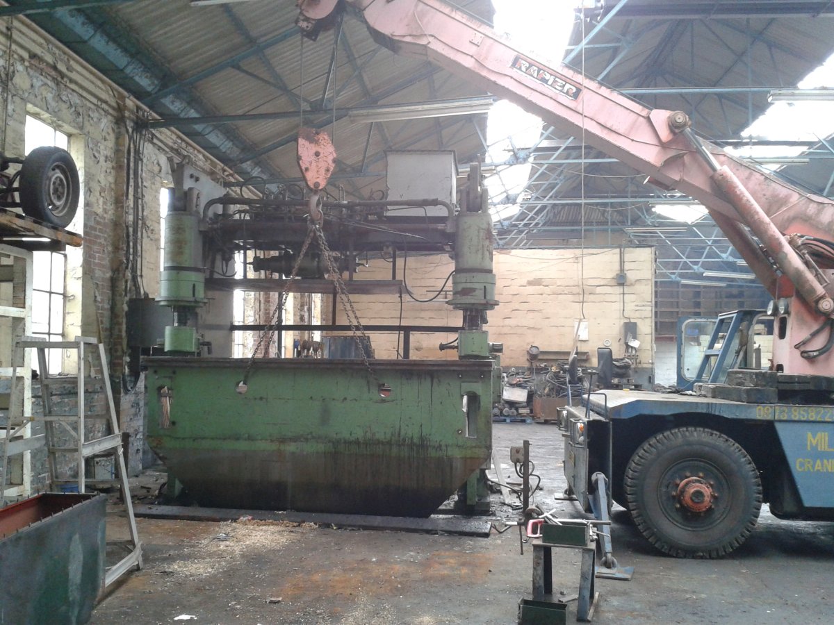

top beam off

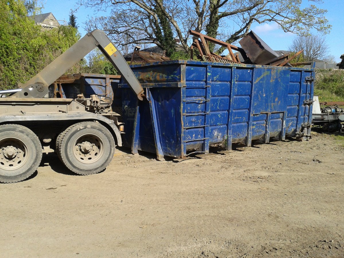

Gosh i wish yiu had kept that tooling in 4ft lenghs 🫣
