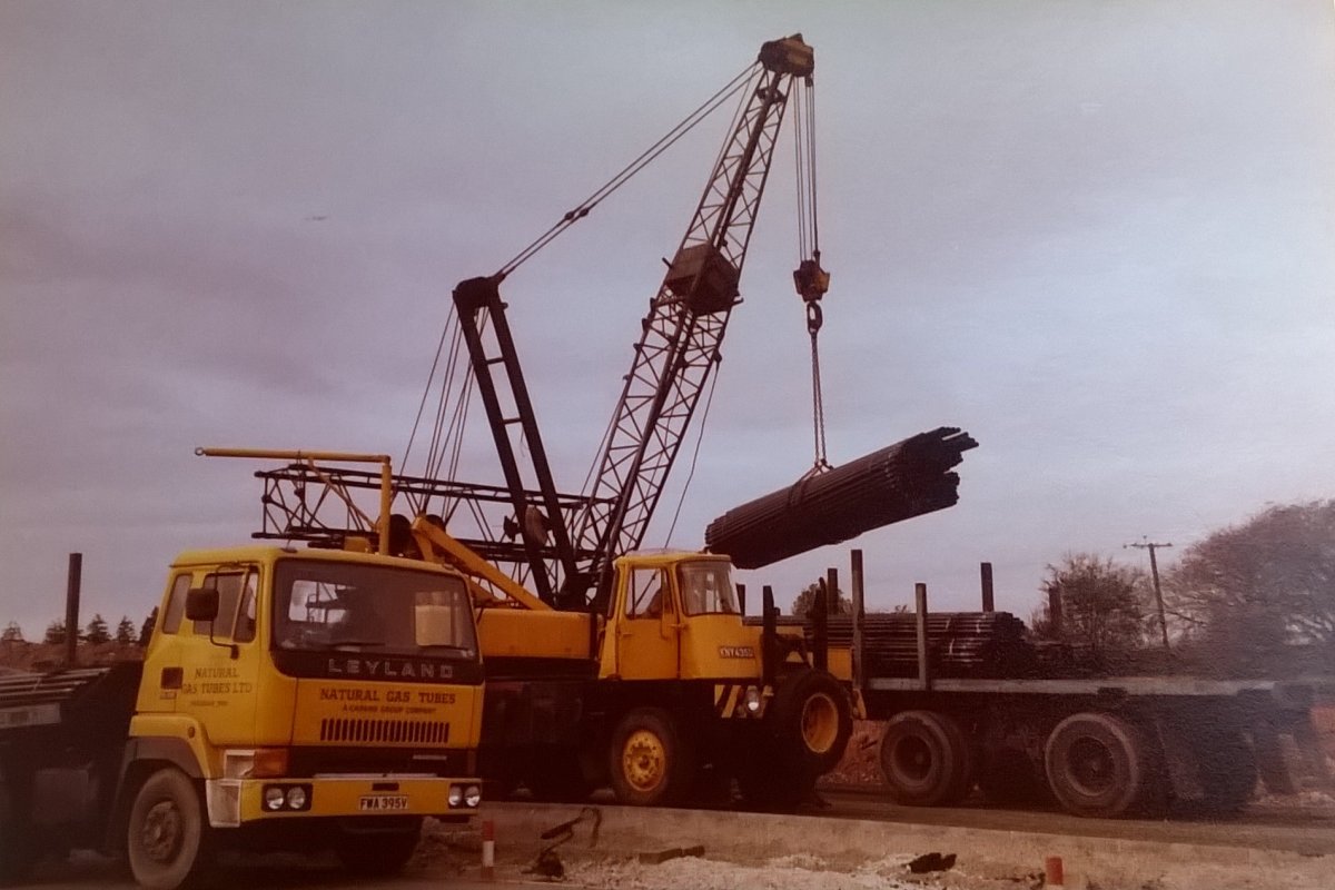

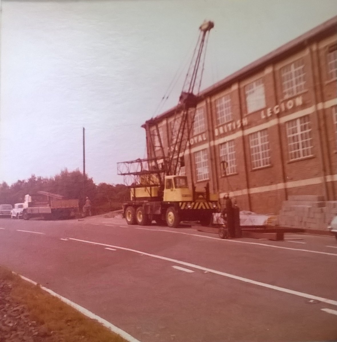

I'd also been trying in vain to find a Demag HC130 - 50 tonner, but not as big as the Grove's 45 offering (quite) -- couple of nice examples off the 'net for illustration -- the HC75 had come from Sweden originally and I could not find a single 130 in the UK for sale - did not want the faff of importing so eventually bought the TMS475 from GWS in their Alfreton depot. had looked at a couple of Coles Hydratruck 45/50s, but more of a lump that the Groves and a bit 'old hat' ... were some lifters though
HC130s
demag hc 130..50t.jpg demag hc 130-.jpg demag hc 130--50t-.jpg demag HC-130 bender.jpg
as said before ... ran the 45 for a couple of years, 'fore it took two trips to Paraguay :ROFLMAO:, where it ended up, after replacing it with the 825
this was the day I went up to Derbyshire for a gander and a deal - privateer running it and giving up ..

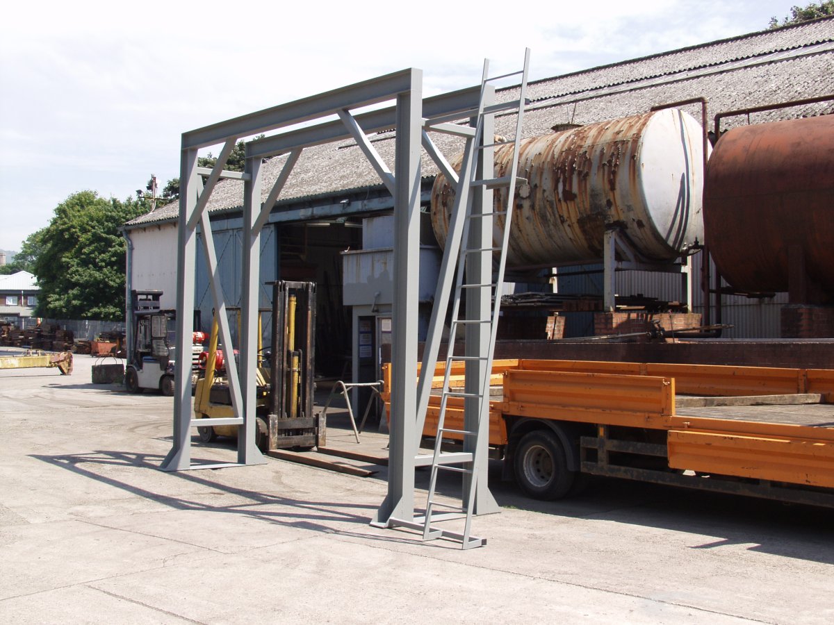

a work platform to go around/access a machine ready to depart for craning in ....

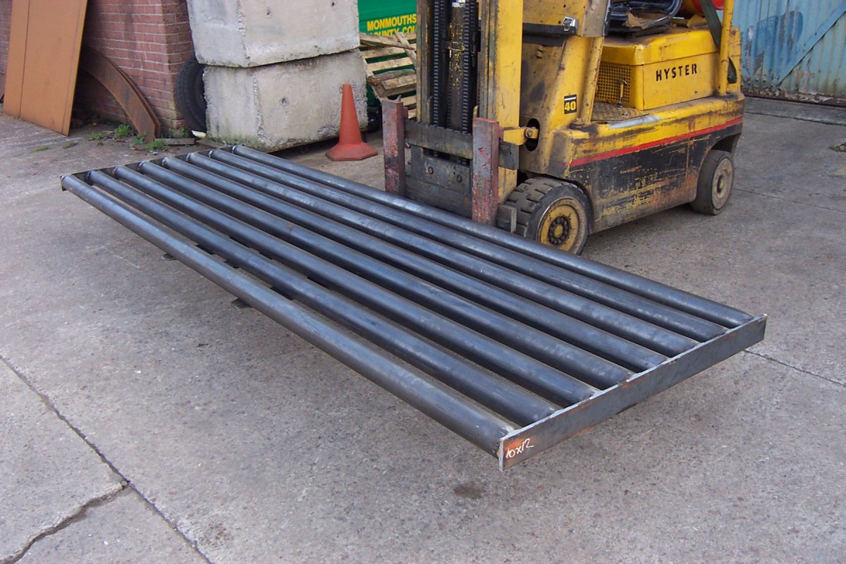

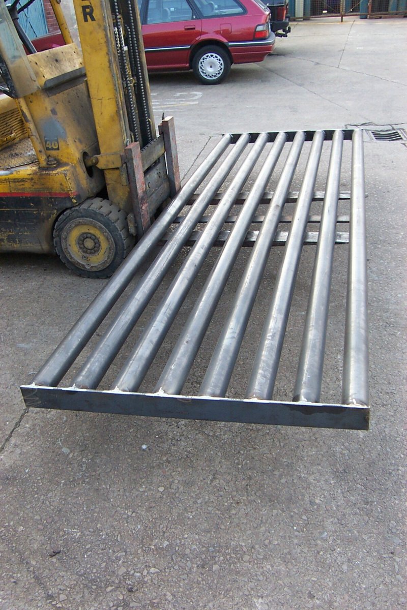

A sharp animal will cross one made with flat tops.
mountain ponies here will lie down on a grid and roll over to stand up the other side - seen 'em do it - even an 8 footer .. that one from memory, was a private drive way to keep the sheep out - as said they struggle to walk a round tube grid
That would make a good video clip :ROFLMAO:
used to make a lot of these for the timber frame guys - Cala homes seemed to like using these curved roof lintels

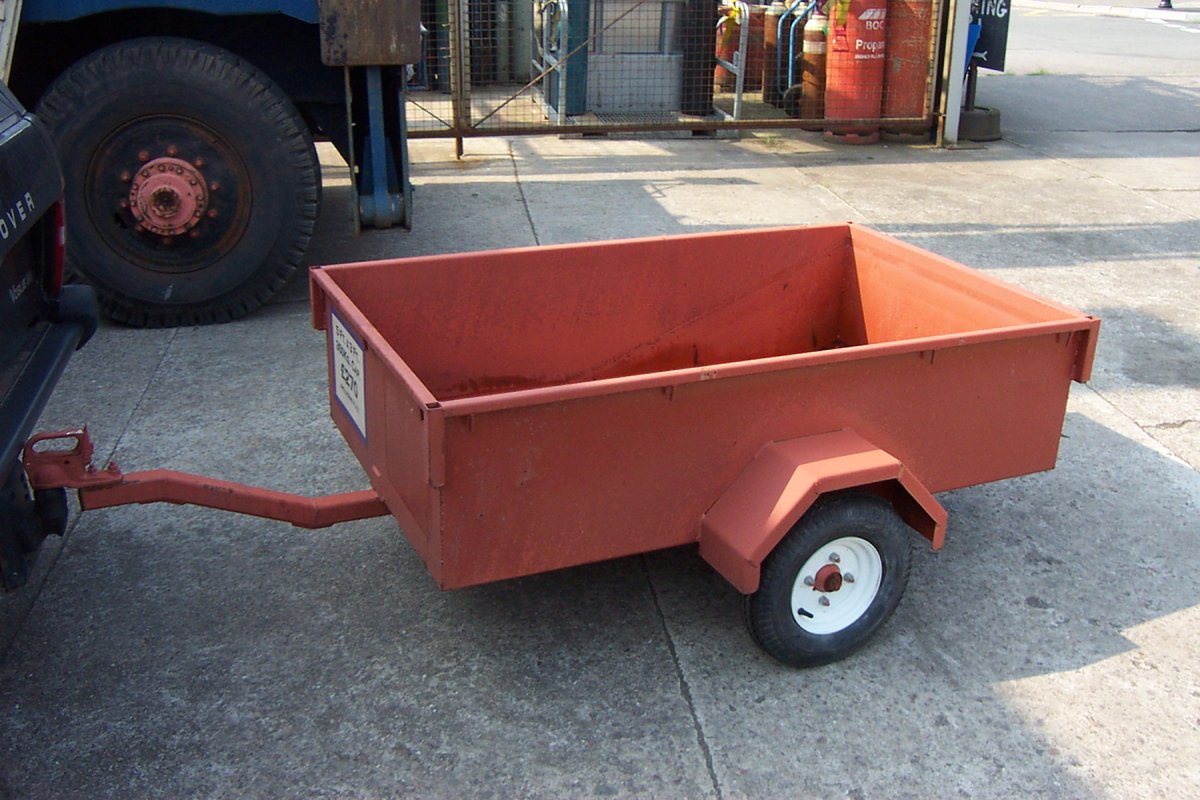

5 x 3 baby camping trailer - made dozens of 'em - very popular . totally monocoque in 2mm steel sheet - sockets on the corners for greedy boards/covers/whatever -- that price is 2003

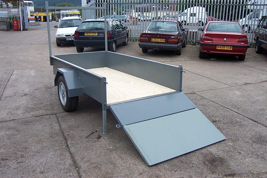

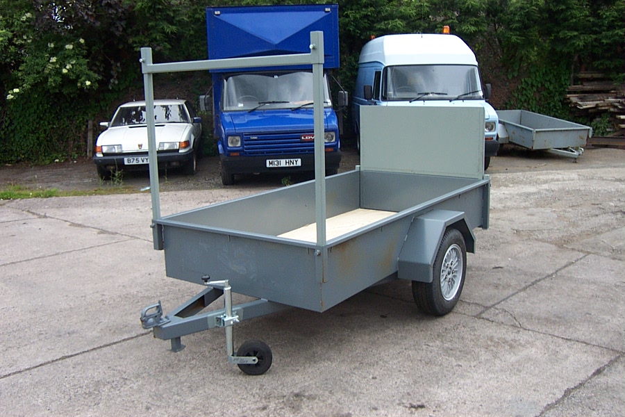

750 kg unbraked for a local gardener for his mower(s) - lift out tail ramp and ladder rack - much against my advice he insisted on a jockey wheel, rather than a prop stand .. too easy to get away from you loaded, on a jockey, with no brakes :oops:

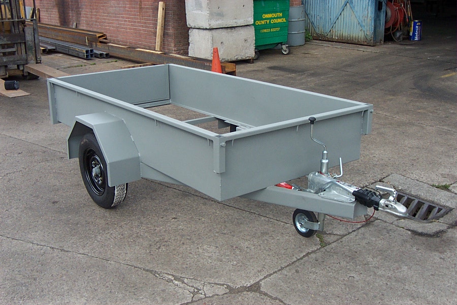

basic spec 900kg braked 8 x 4 trailer .. always made 'em 8' 1/2" by 4' 1/2" so you could carry 8x4 boards in 'em ... drop the tail and slide 'em out - sockets on all corners for greedy boards/cover frame ...jack legs in rear .. sockets in tailboard to enable the tail to be extended as a ramp, as above .. all 2mm formed semi-monocoque - 3mm A frame

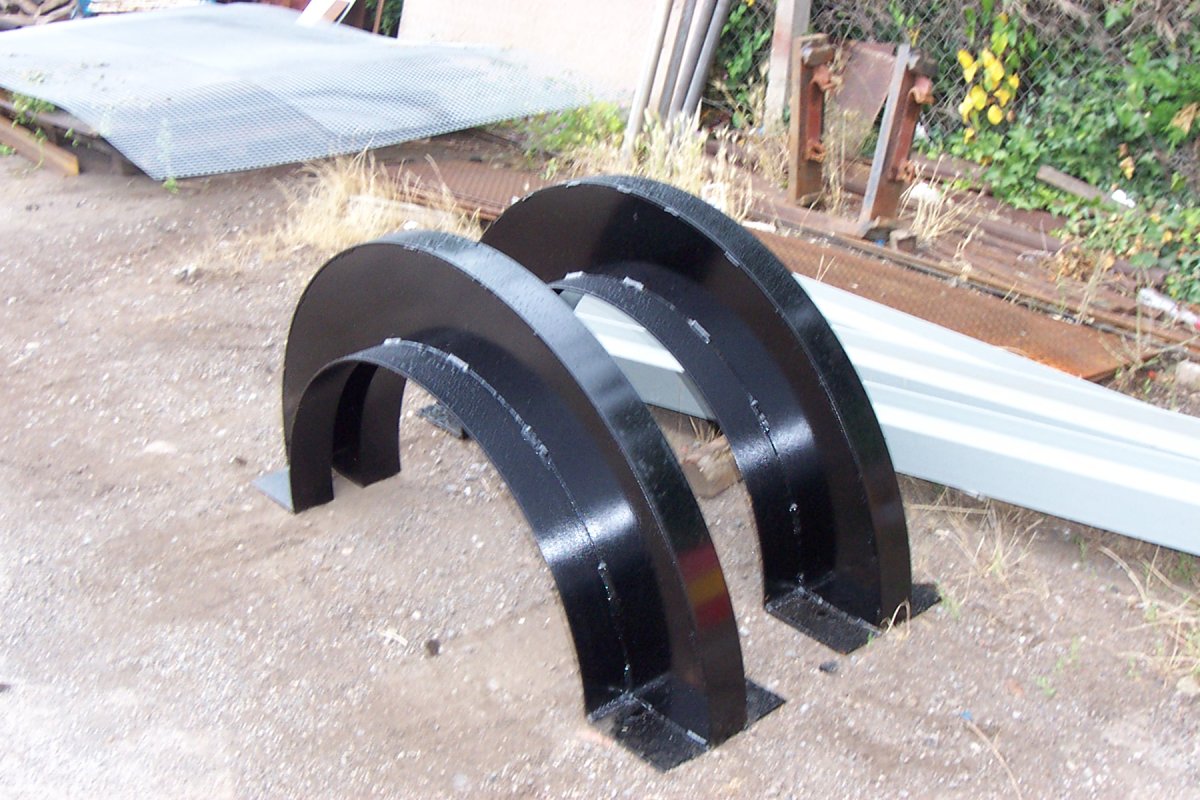

bit of a special .. bespoke 'catnic' type lintels for twwo arched windows in a resto job for a local Cadw specialist builder

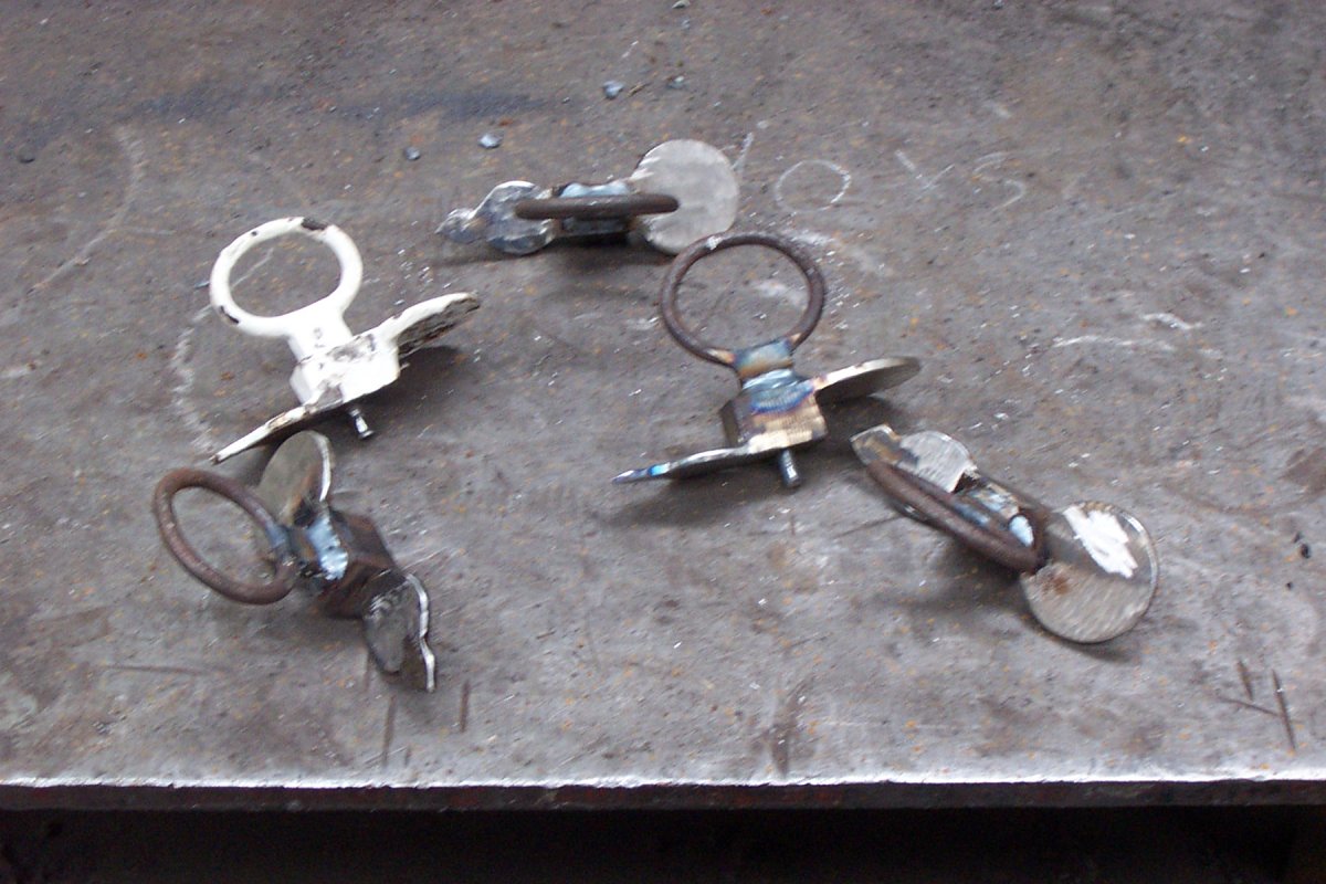

Same job ... copy some window catches - keep Cadw happy :rolleyes:

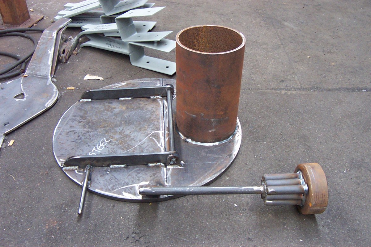

some thing different - incinerator lid for ??? can't recall

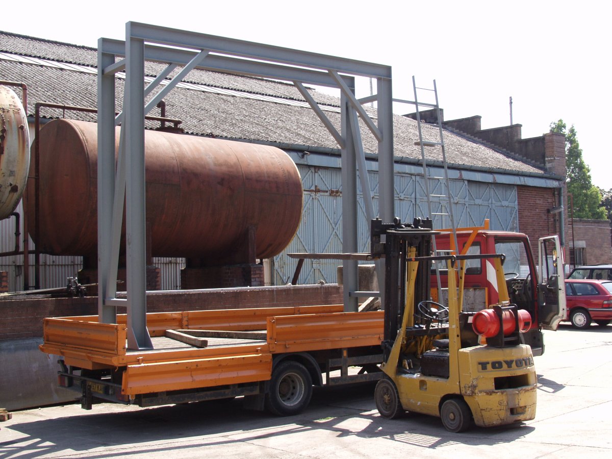

support structure for a milk tank at the local cheese factory to straddle two other tanks already in situ -- somewhere I'll have pix of the installation process, but not found 'em yet ... and yes it was a bit high -- chose the route to the other side of town carefully - and had a guy on the ladder to 'up' any really low ones (not many thankfully) :giggle:

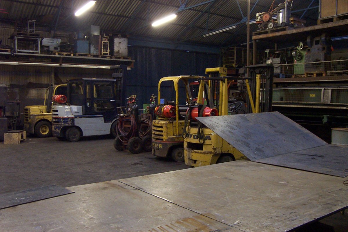

four of my five FLTs .. rare to see 'em all lined up like that :rolleyes: --- 2.5t Toyota, 2 t S40C Hyster, S150A Hyster 7t & 4t H80C Hyster .. little clarke 1t leccy probably tucked in its usual corner

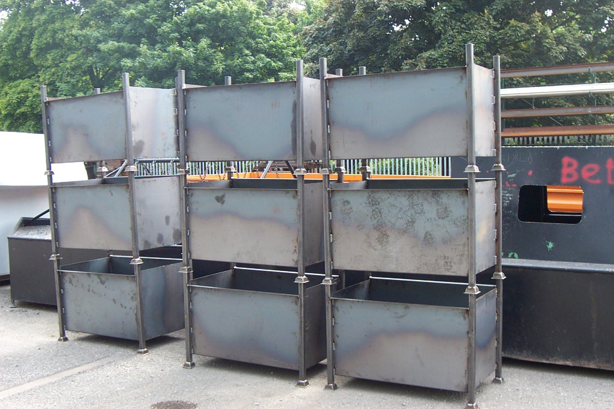

made dozens of these .... tooling racks for the press shop guys we did LOADS for -- tools were half a tonne plus each and they had hundreds - these racks were all over the factory around the perimeter walls and anywhere they could fit them .. did pressings for the automotive industry .... trim panels VAG/Ford/GM Vauxhaul/etc., etc. perfected a system of printing a woodgrain finish onto ali that you could not tell from the real thing - American outfit - great payers and they loved our work ethic of yeh, no prob.s, when do you want it?:giggle:...
have a lot of all sorts of pix of jobs for these guys - stuff we've made and kit we've shifted -
got to a point that it was easier to have us in for a day on a Sat. and move the presses around the lines in the shop for a rejig, than it was to move all the tooling around in the presses - we got bloody good at it and the appreciation showed in the remuneration and the speed it was made.
didn't paint the cross bearers - just oiled, not to contaminate the mate/datum faces on the tooling bases ;)(y)
