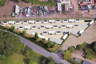

of course they did ..... the rubber stamp has been doled out to them to do as they like :mad::mad::mad:
looking at the pic it's hardly surprising their (local planners) reasons didn't hold water ... what we don't see is the power lines needed to connect said bank, straddling the countryside
