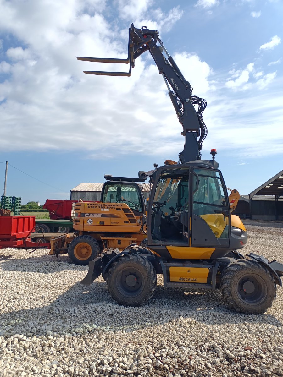

When it comes to handling with a wheeled excavator the Mecalac does take a lot of beating, its not so much about its outright lift capacity its about the geometry, the Mecalac boom geometry allows you to work with pallet forks a lot closer to the machine and lift vertically from there. As Tom mentioned you can overcome the bucket cylinder if you need to bring something down from height but depending on the height you are lifting to it can be worked around by altering the geometry of the boom sections.
They are an immensely capable machine but they do need an operator who is adaptable and able to understand how he can make it work for them rather than dismissing it right away because they don't operate quite like a traditional machine. Cost is certainly a factor too but if they can work for you then this becomes less relevant. There is an owner operator in Cornwall with a 9MWR who used to work solely for a local developer and did most work with that machine, so its certainly capable of what you are looking for.
