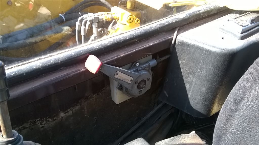

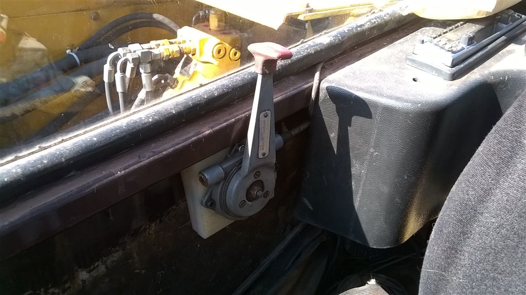

As for the fettling .... been trying me hand today :LOL:

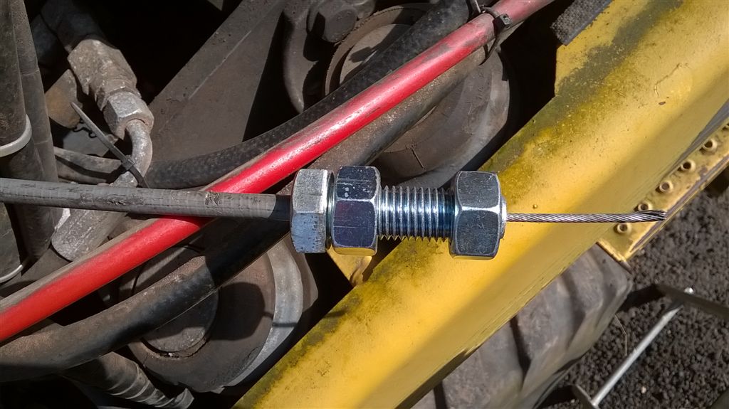

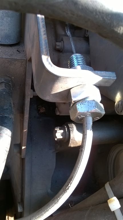

throttle lever persuaded into spot .. out the way ..
took some juggling into spot
Ajax got a bit of an airing

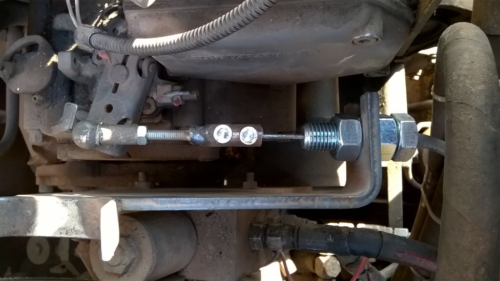

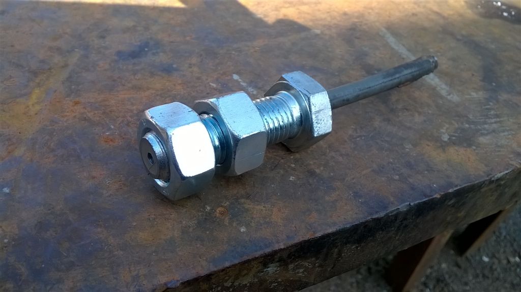

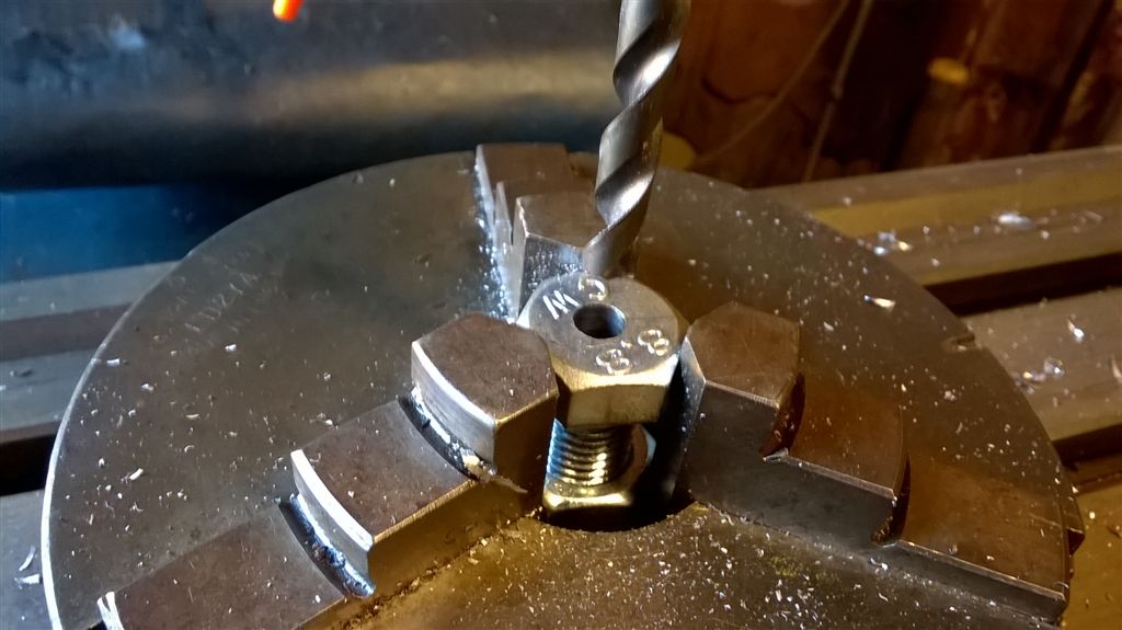

creating a capture / mount for the Bowden's outer .....
....... and inner

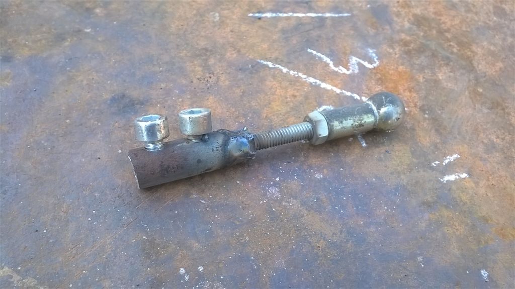

then it was time to create an end ...
bit of pisser, having to drag the Caddy out for a couple of quick flashes ...... but had to be done .... would've liked some grub screws, instead of the SHCS,s but didn't have/couldn't find any so these got lopped down and lightly drilled the end of the thread to grip the cable, like a grubby would ;)
getting the lengths right was a tad tedious, but got there and it got installed
believe it or not that is full travel .. plus about 6mm ... not a lot of movement at all ... can see how little the auto throttle's ram needs to move to give four differing settings AND tickover ...... must be one techy lil' actuator/ sensed ram !! :oops::unsure:
left its cable attached to it and secured the flying end in the engine bay, so's it can't get up to 'no good' :giggle: .... will extricate it from its hiding place when I'm feeling enthused [a] .. about looking at it and .. ..when I'm feeling enthused enough to get at the little sod ... it's not exactly easily gotten at :(:( .. engine bay belly plate off job, looks to be the easiest access :rolleyes:

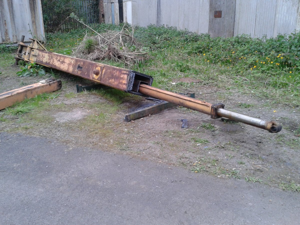

I'm sure you have a spare crane boom somewhere...
nah ...... I cut it up when I cleared the yard .... and would've needed SOOOOOME counterweight to accompany it ...... was 4 ton

I do however have the one tele ram out of it ... would give me at least 40ft extended ...... plenty ..
. now how do I stop it rotating and WTF do I use for extra counterweights :unsure::giggle::ROFLMAO::ROFLMAO:
