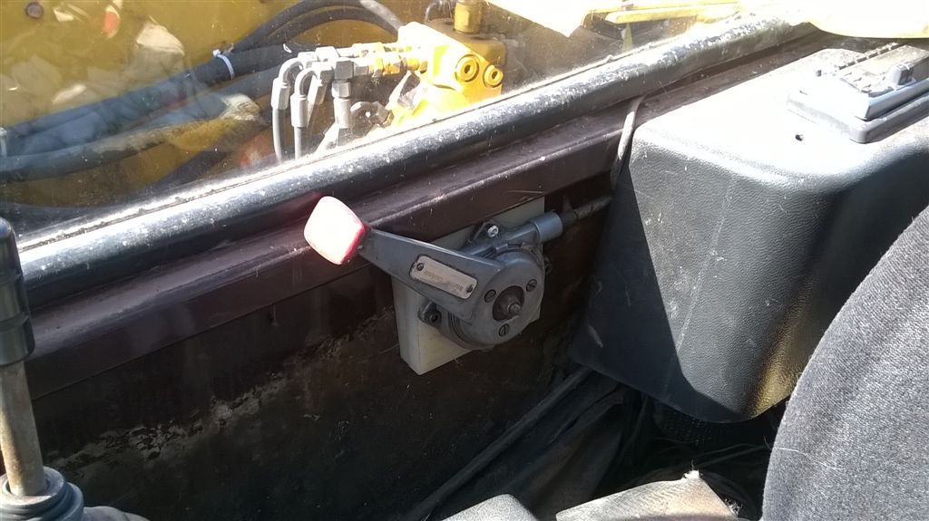

As for the fettling .... been trying me hand today

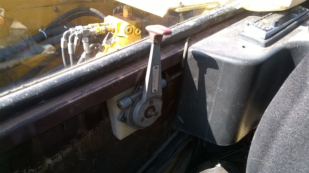

throttle lever persuaded into spot .. out the way ..
took some juggling into spot

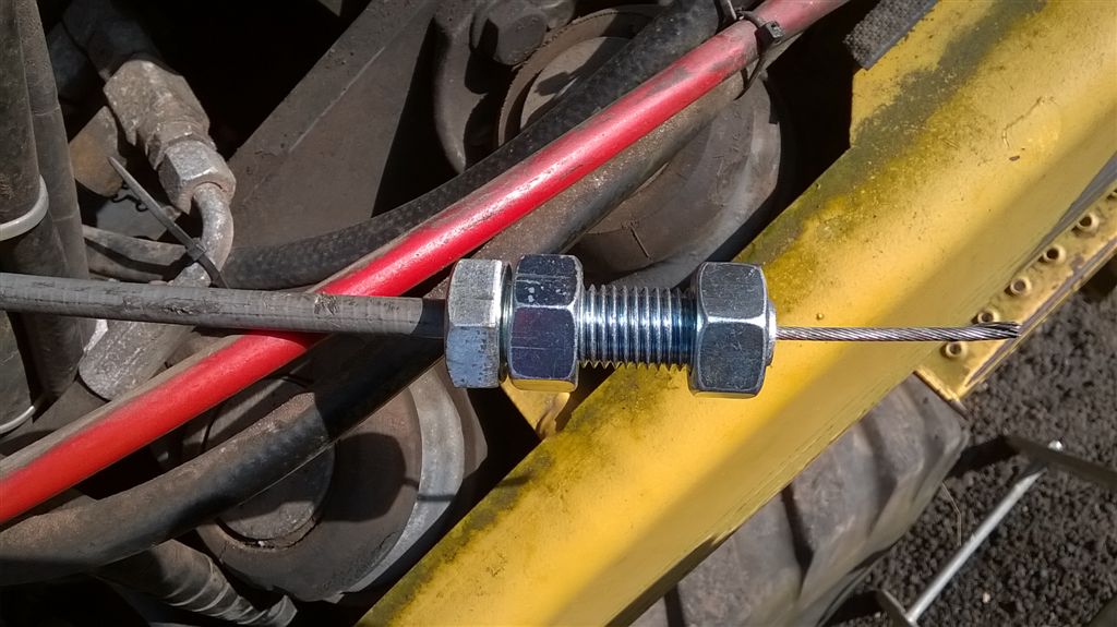

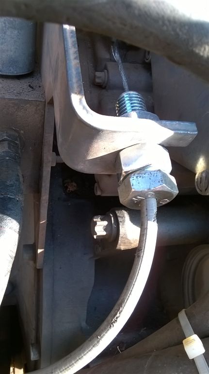

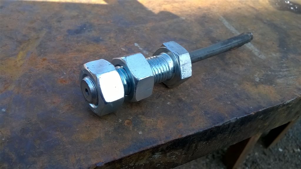

creating a capture / mount for the Bowden's outer .....
....... and inner

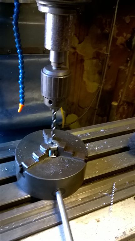

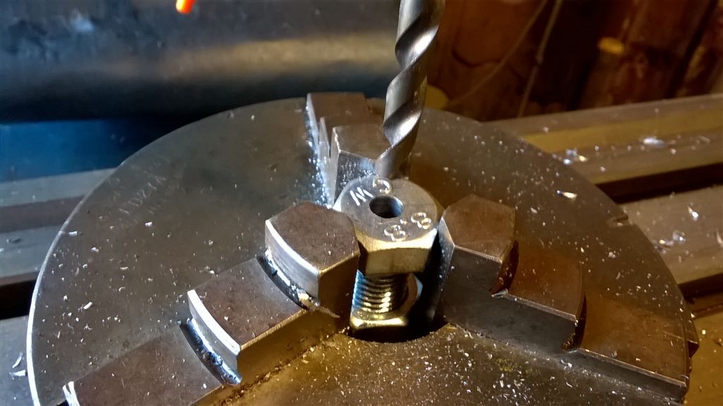

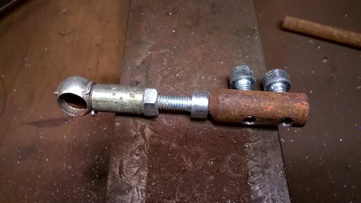

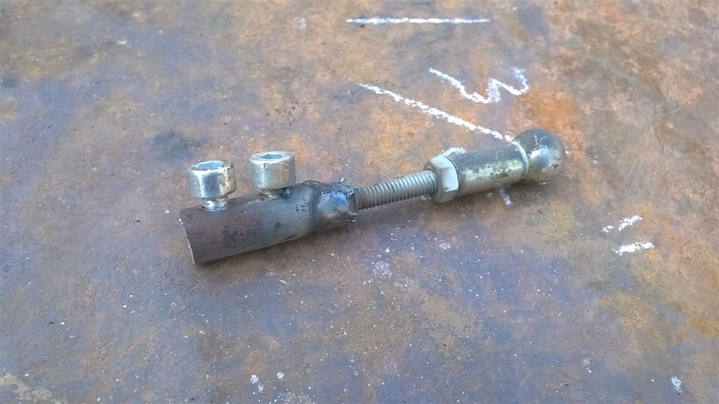

then it was time to create an end ...
bit of pisser, having to drag the Caddy out for a couple of quick flashes ...... but had to be done .... would've liked some grub screws, instead of the SHCS,s but didn't have/couldn't find any so these got lopped down and lightly drilled the end of the thread to grip the cable, like a grubby would

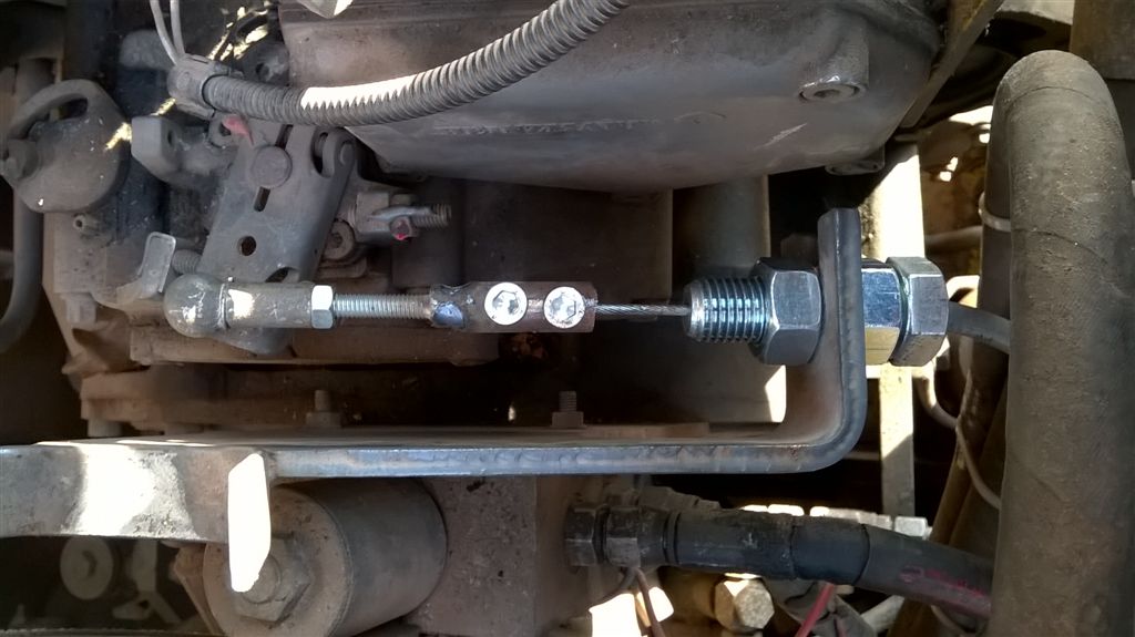

getting the lengths right was a tad tedious, but got there and it got installed
believe it or not that is full travel .. plus about 6mm ... not a lot of movement at all ... can see how little the auto throttle's ram needs to move to give four differing settings AND tickover ...... must be one techy lil' actuator/ sensed ram !!

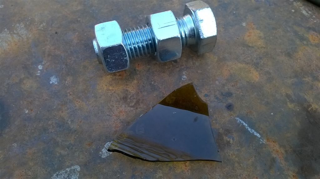

found this, this morning ....
on the floor 'bout 10 ft from the 'Drema's door .... sure as **** wasn't there last night when I packed up ... and have no 'kin idea WTF it has come from ? .. can only conclude we had unwanted visitors last night, but couldn't see anything out of place ??... apart from the appearance of the above ???
it's certainly nothing to do with me ... don't recognise it at all ... and I could not have missed it ... first thing I noticed this morning !!
May have to sleep with one eye open tonight
.......... an' a couple of barrels hanging out the bedroom window
... ALL my gates are locked and I've not sent out any invitations for nocturnal visitors .... so's they'm fair game as far as I'm concerned .... BANG!!
