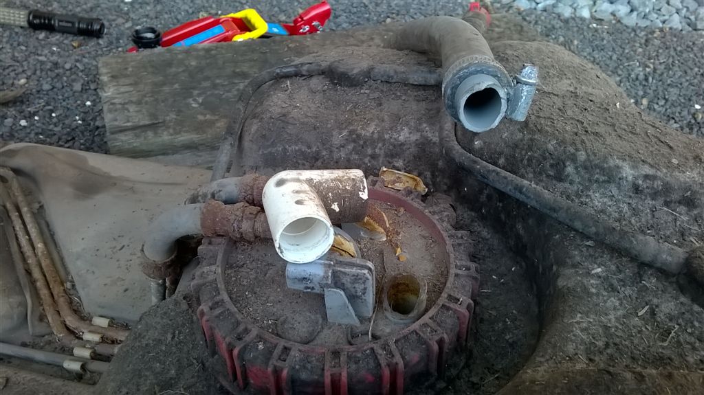

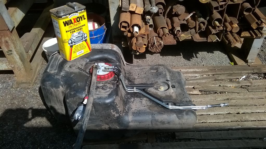

have had a hard afternoon :( .... doing battle with my 80 litre fuel tank. :oops:
I miss my 4 poster :cry: ..... that tank's a lump ....

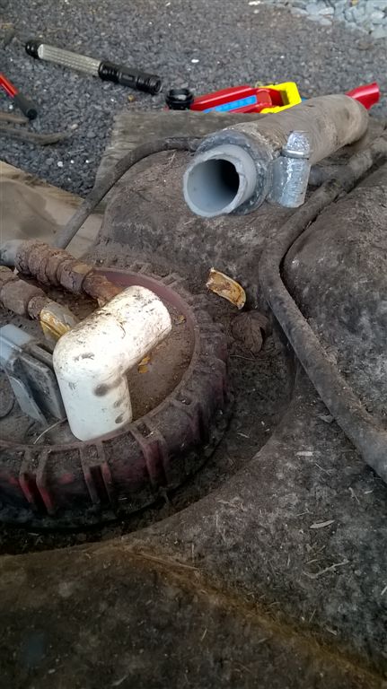

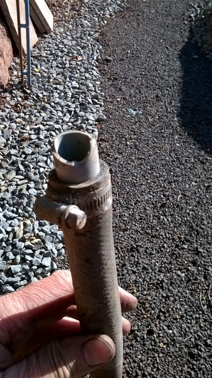

have had a suspicion of a leak for quite a while .... can smell fuel regularly and had an even stronger suspicion of where from after some ****ing cowboy spanner monkey had the tank off some time ago, one MOT time.
usually only take it to 'known' (and trusted) places ... but these ppl had taken over one of my 'trusted' places, unknownst to me :mad:
anyway ... long and short of it was ....
said tw*t had snapped the breather off the top of the pump unit .... and instead of owning up .... bodged it - in the worst possible style -
the white elbow was lying behind the sender ring nut, when I got it down ...
presumably it'd once been here ...
no bond .. nothing ... and like a d**k in a bucket:mad::mad: .... God knows how much crap is in the tank :mad:
it will be my mission to see he loses his ticket ... the cretin is not fit to be working on, let alone MOT-ing people's vehicles :mad::mad: absolute cowboy !!!!
that open to atmosphere breather port is a foot from a very hot exhaust and the other end of it is in the filler neck, which is able to have fuel fed down it as you fill up ...... I count myself lucky not to have had the old girl catch fire ... lucky it doesn't do a lot of miles these days:rolleyes:
I am absolutely ****ing steaming :mad:
either gonna have to get creative tomorrow ........ or buy a new in tank, pump unit :oops::( .... either way it's gonna have to come out, to see just how much crud has accumulated in the tank, for starters :rolleyes::unsure:
Yeh I know Stock :rolleyes: .... already have one sourced at 38 quid ;) ..... but it doesn't stop there :mad: ... will need 8 quidsworth of new seal, plus two new supply/return pipes (which I've failed to find so far on the 'net) and'll almost certainly be LR/OE only and knowing them will be 60 quid each minimum :oops:...... all because of one tosser's **** up/incompetence .......... plus all the grief :mad: .....
will be much easier if I can 'get creative' and disturb as little as possible.... but TBH, looking at it, it's gonna take some doing :(

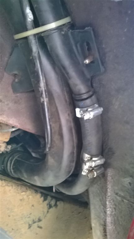

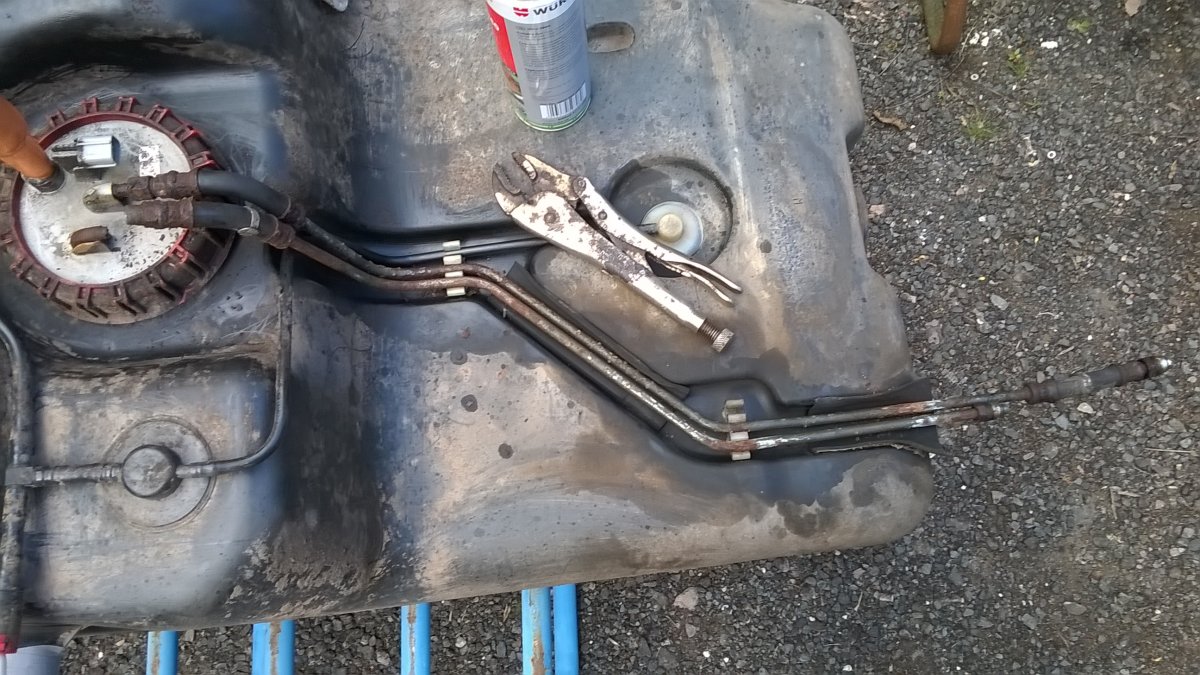

the inevitable occurred trying to remove the fuel lines this morning :rolleyes:... had to come off to get the ring nut undone ... and no way were those pipes going back up under the ol' girl :oops: ... way too past their sell buy dates for my liking:unsure: .... be waiting for one to go pop with 3.5 bar coursing through 'em o_O
an' before anyone comments on the scabby state of those Visegrips .... they're probably older than a lot of members :p and seen a LOT of action :rolleyes:... I do have shinier ones too :giggle::giggle:;) ...... so.......

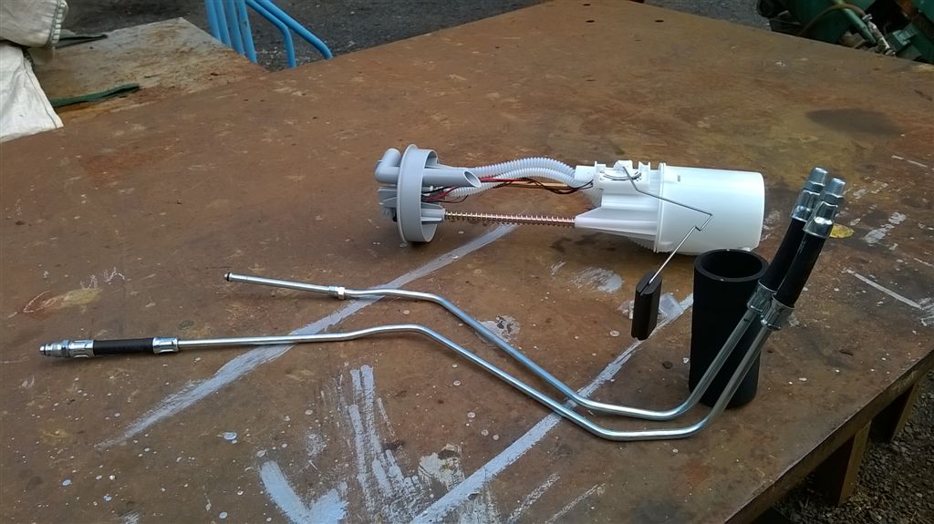

Just cost me 223 quid and an evening's searching for the fuel lines, filler neck rubber and a pump:rolleyes: .... Britpart from Island 4x 4 in Kent:) .. best deal I can find and the only ones who listed everything I want(y)(y):cool:
1 x Fuel Filler Rubber Neck To Tank P38 (Britpart) ESR3219 £16.00
1 x Fuel Pipe (Pump To Connector) V8 94-98 WJP106160 £70.00
1 x Fuel Pipe (Pump To Filter) V8 94-98 WJP106150 £69.99
1 x Fuel Pump Fittings (2 Nuts & 2 Olives) £1.67
1 x Fuel Pump V8 94-98 (Britpart) STC4344 ESR1073 ESR3931 £28.33
all plus the Vodka & Tonic of course :rolleyes:
if these last another 22 years .... and they're going to, with the amount of Waxoil that'll be adorning them when it goes back in,:giggle:;):cool:.. I'll be 84 before I have to get under there again :ROFLMAO::ROFLMAO: .......and past caring :ROFLMAO:

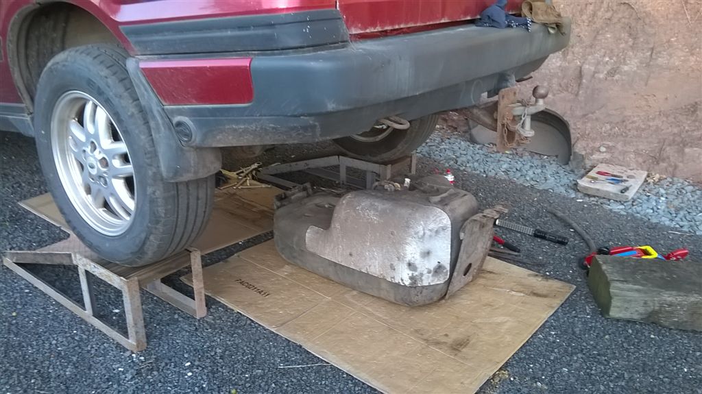

Sussed WTF the tank was so bloody heavy, coming off yesterday :oops: ... when I emptied 50 litres of motion lotion out of the damned thing this morning into jerry cans :rolleyes:o_O .... gauge claimed a couple of gallons at most ... so tha's fooked too BTLs:unsure: .....
Dry as a chip under there ATM, so blew as much crap as I could, out from under there, with 150psi, this afters .... I'm now wearing most of it :(... can't wait to dive in the shower in a minute or two :giggle::giggle:
would've Waxoil-ed under there too, but couldn't find me Wagner airless sprayer .. which is always full of the stuff and sealed in an airtight bag .. saves a lot of cleaning up :rolleyes: ..... still haven't remembered WTF I've put it though :unsure:... so might have to be a Schultz gun jobbie, but better throttle it down a bit :oops: with a smaller nozzle and some pressure reduction :giggle::giggle:............. 'tain't gonna be this dry again for a few months :rolleyes: ... and'll fill the waiting time for the bits to arrive :whistle: .... plus I don't plan on seeing the bits hidden by that tank again, in a loooooong time ;):)

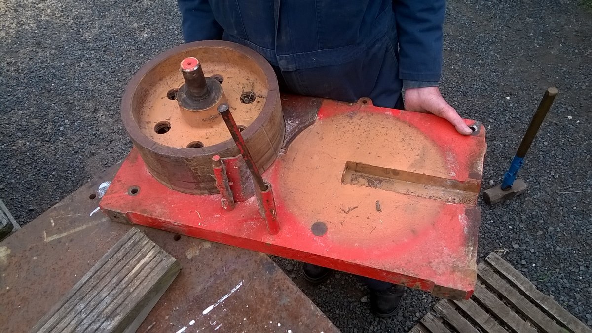

Simon turned up with this, about 4 oclock this afters ..... could I get it apart and push/press the spindle and bearings out of the idler wheel :unsure:
some sort of corn/seed cracking mill that they needed to have grooves machined into the wheel faces, as it wasn't feeding very well
have to be quick to catch him on camera ... he doesn't like having his piccy taken ... and I always manage to get him catching flies:ROFLMAO::ROFLMAO:

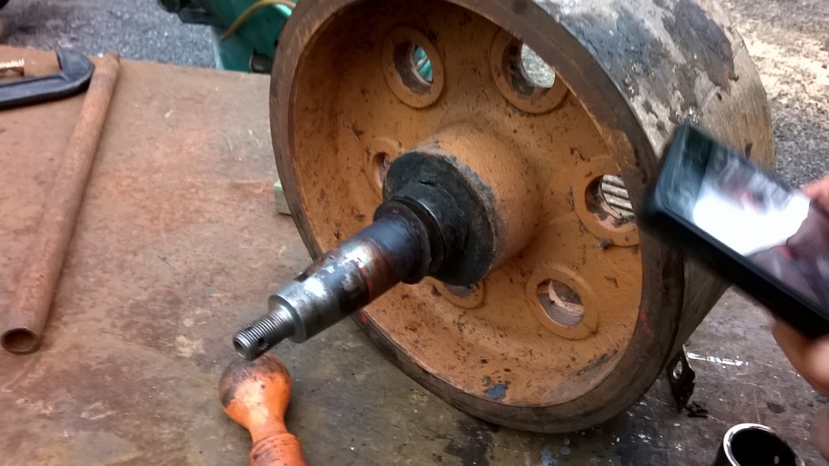

anyway, dragged @Delbouy 's lil' press out, that i bought off him a while ago ... and the spindle and bearings in the idler surrendered pretty easily :)
this 'un was hard fought :(
had to massacre the self centering flange mount bearing to get this one out of the side plate :rolleyes: ... trip to Antifriction tomorrow, for him to get a new bearing block ;) .... but at least he can get the wheels in for machining tomorrow .......needless to say .... tea was some bit late tonight :rolleyes::)
another half hour with the 18 x 5/8" UNF thread file on the end of that shaft ... where someone'd had a puller belling the end of it out and it was ready to head back to Monmouth ... and i could have me tea (and treatment - had already been a busy day 'fore he arrived) ..

well this lot arrived yesterday morning ..... I wasn't up to struggling with it all, after a bad night and most of the day - were too late with me 'hamster juice' Monday evening and no activity after it, to circulate it about .. so me spleen gave me hell to remind me :(

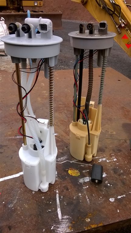

slightly different unit ...
but after a 're-assuring ' conversation along the lines of - "it's the only one we've sold in years" it went into the tank -- it'd better ****ing work !!

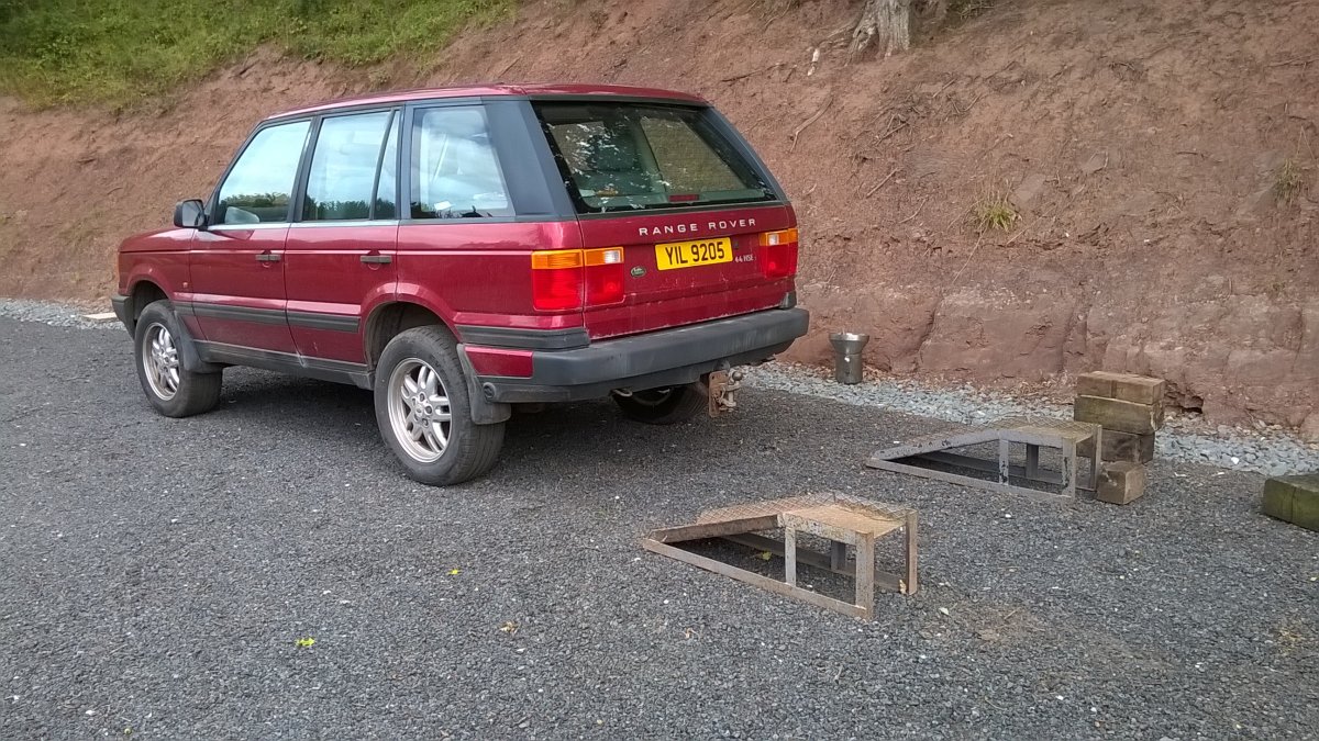

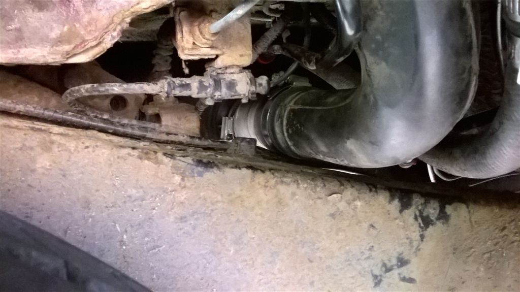

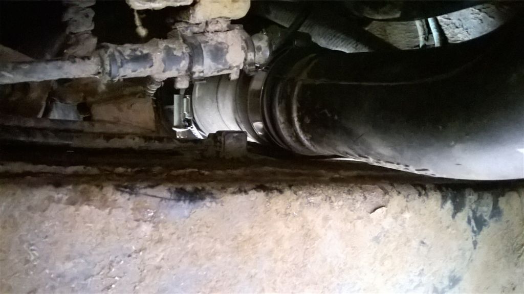

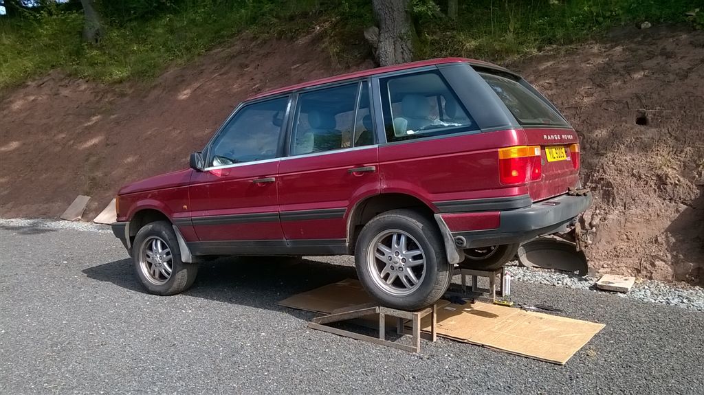

has been a tough afternoon getting that bloody great lump of a tank back in its home under the RR :( and even harder getting everything back into place and re-connected ... the filler pipe was a complete nightmare :cry: ... and took a good hour and a half to get back together ... no room for hands or tools :mad: ..... and left a lot of my skin under there in various locations :censored:
the breather that has caused all the issues had also appeared to have been shortened, by the looks of it ... I had to extend it to get it to reach, once I'd attached it to the tank end :mad:
no way was I going to go tugging at it to try to stretch it to fit :unsure::oops:
anyway ... it's all re-assembled and dogged up ... ready for some fuel tomorrow and a test for leaks .... which i hope there will be none of :unsure: ... ran out of time tonight ... had to go to meeting at 18.00

No leaks and went first flick :) ...... and no smell of fuel either (y) ...... could do with a wash :unsure::unsure:

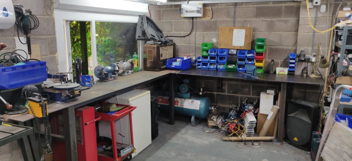

Spent this afternoon up the workshop tinkering, cleared off both my workbenches, filled the bin up and produced another pile of cardboard. I'd only emptied them on Thursday!
I decided to oil the workbench whilst I was at it, but stopped halfway through as I was starting to doubt myself. I used some waste 75w90 gear oil, and rubbed it in well. What do you guys normally use?
I've always used a good spray of WD40 on my vices & pillar drill bed, but the workbench is quite large.
I can’t see my workshop table top so dont even know what it is made from!!😱😱😱😱
Cyberprog
Cyberprog
Mines 10mm mild steel plate. I had it laser cut from a 8x4 sheet, with the right bits notched out so it fitted between the pillars!
trouble with gear oil is ..... the bloody smell of hypoid :oops::sick: .... I'd be favoring a much lighter oil TBH Alex, well scrubbed in if the carbon black is still on the plate ....... if it's a CR4 plate (bright, cold rolled) oil and kero mix very lightly applied with a rag - regularly ;)
WD is only a water dispersant and not a lubricant, so I'd give the rest the same treatment ;) ... as when it dries out it offers zero protection :( and does so fairly quickly
