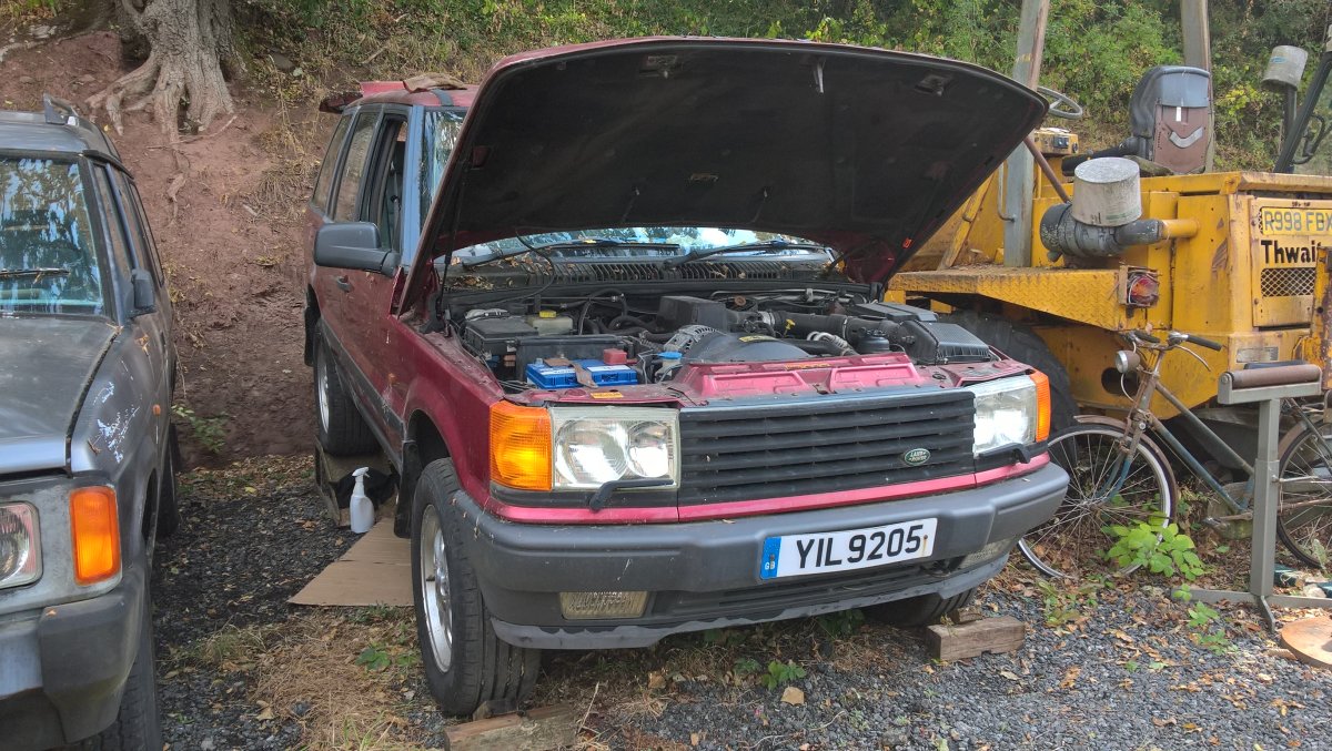

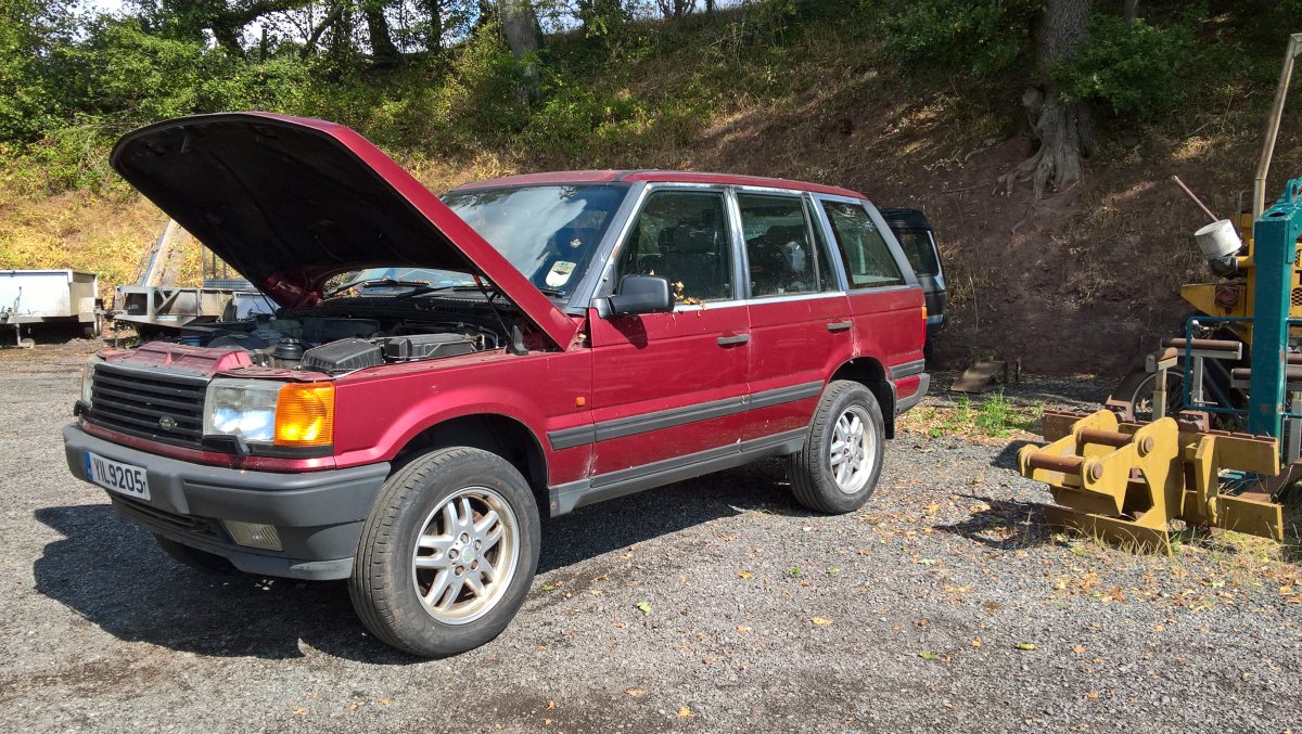

got these out today ....
and stuck the P38's bum in the air .... blocked the axle up (in case) and dropped the neg. off the battery
got some tools together after eyeballing the job and slid my bum under to do battle

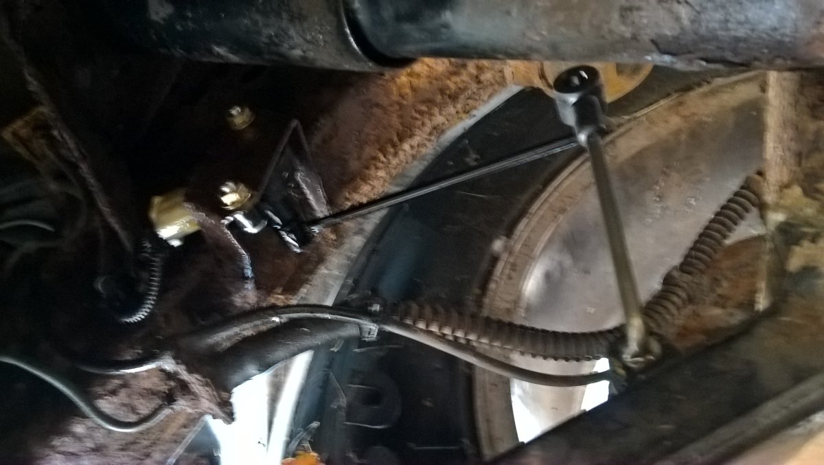

disc-ed the nuts off the O/S sensor and wrestled the actuator arm out of its rubber mount on the trailing arm, having given it a good soaking in lube ... came out quite well TBH
then persuaded the new sensor into place in its mount and persuaded the actuator arm onto the trail arm rubber
then turned my attention to the left (N/S) unit
apologies for the poor images, but not an easy thing to get shots of

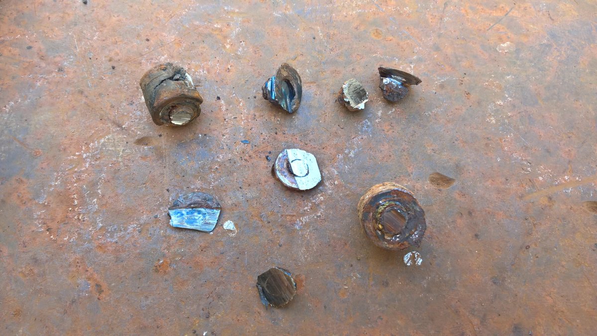

they were just a tad past their use by dates
as were what was keeping them in situ
