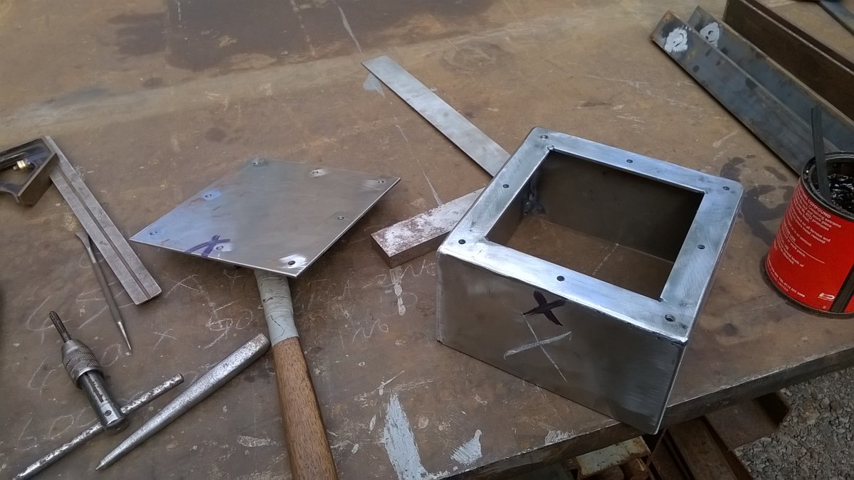

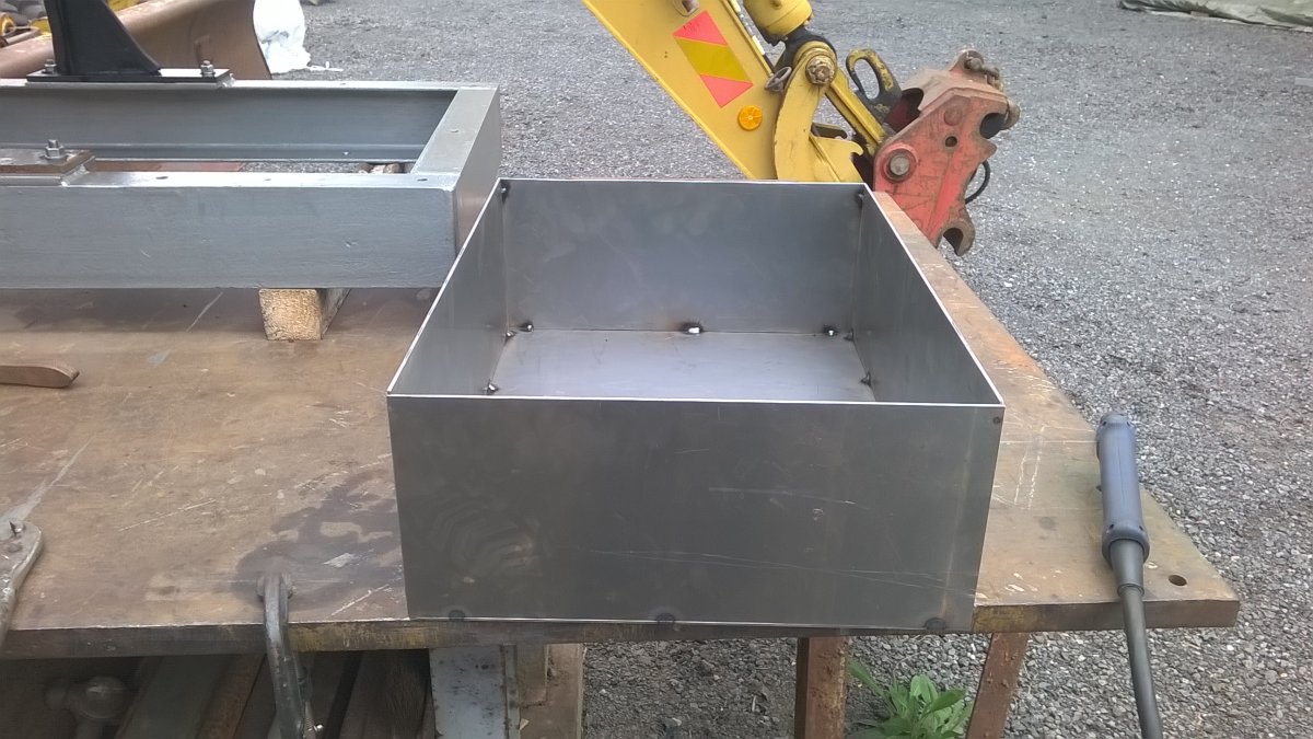

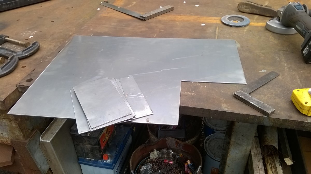

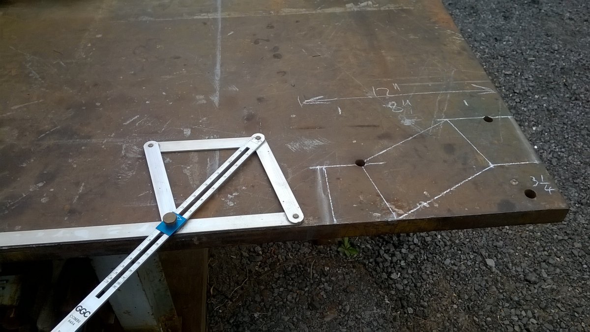

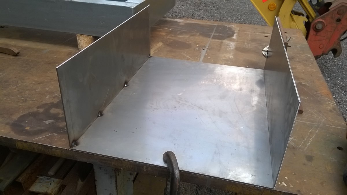

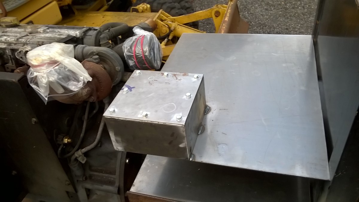

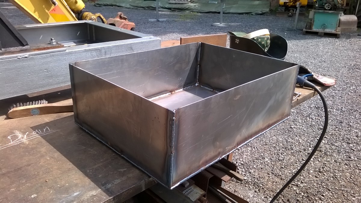

got the tank top out and knocked a corner out of it, after I'd sussed how much to remove,

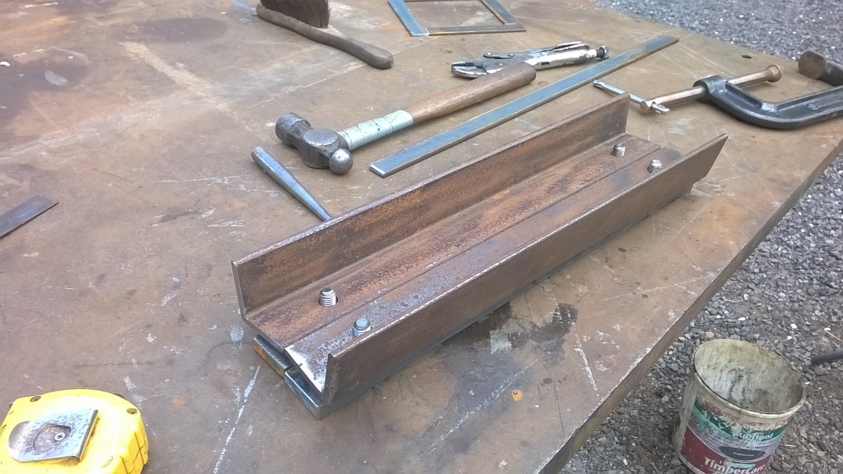

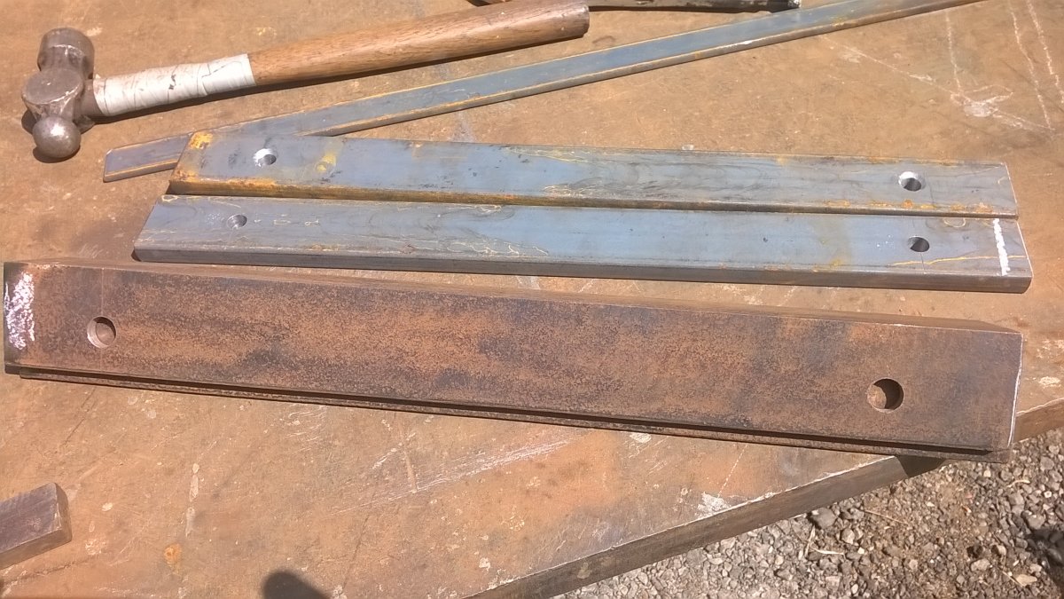

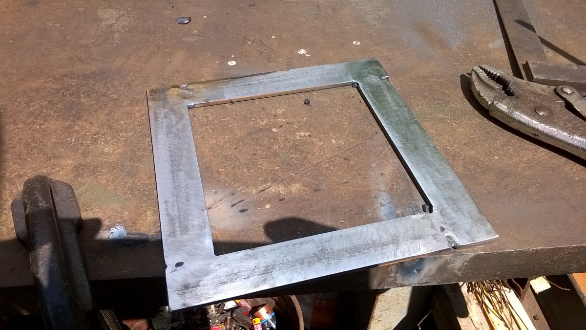

then cut some bits an' pieces for the next bit .. set 'em out and put some holes in 'em View attachment 35136

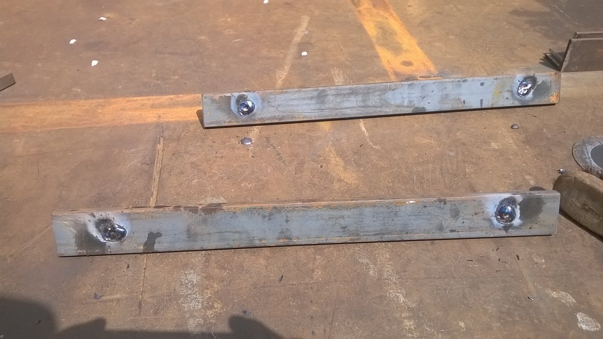

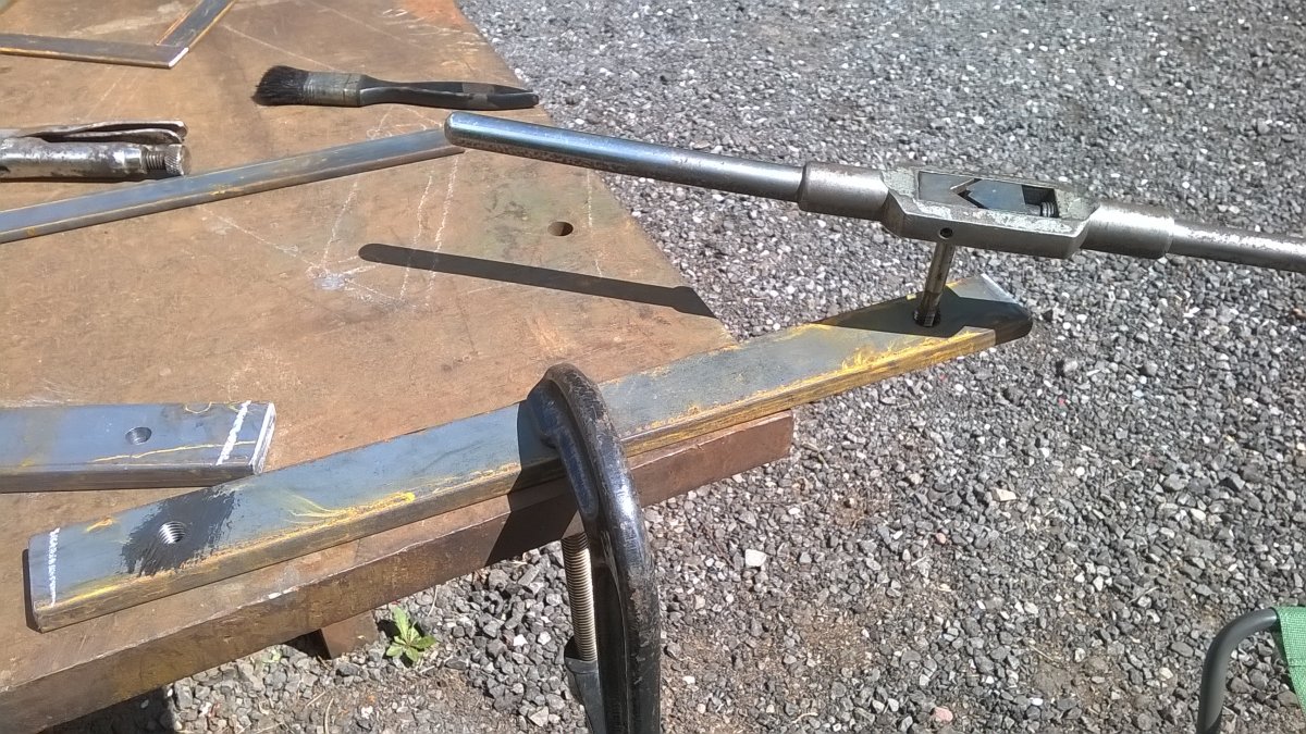

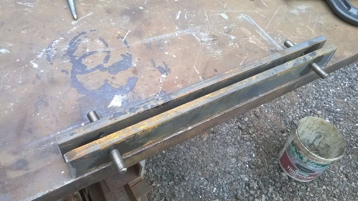

followed by a bit of thread tapping ...View attachment 35137
and some studs cut to suit View attachment 35138
all fitted fine ...

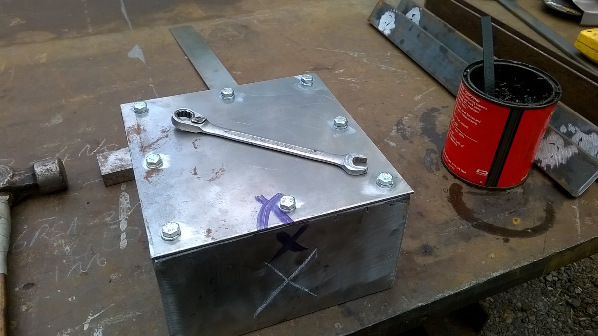

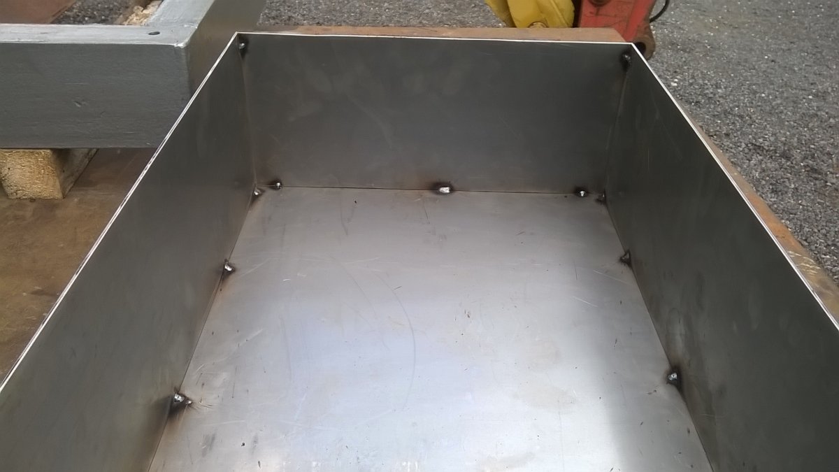

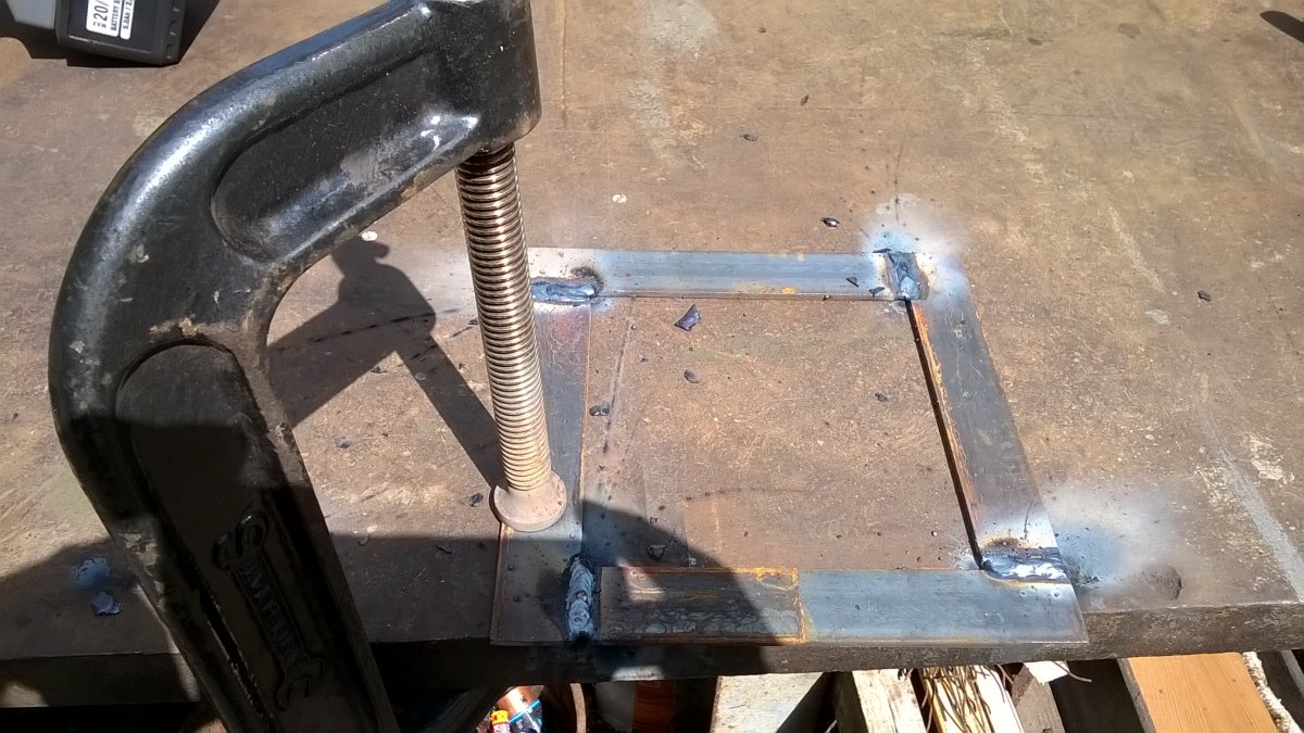

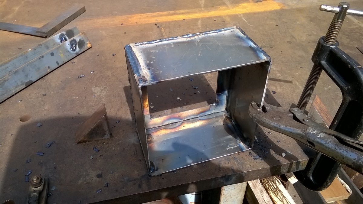

welded up a few more bits ...
View attachment 35141 View attachment 35140
and ground back to a finished flat ... consolidated the studs ..

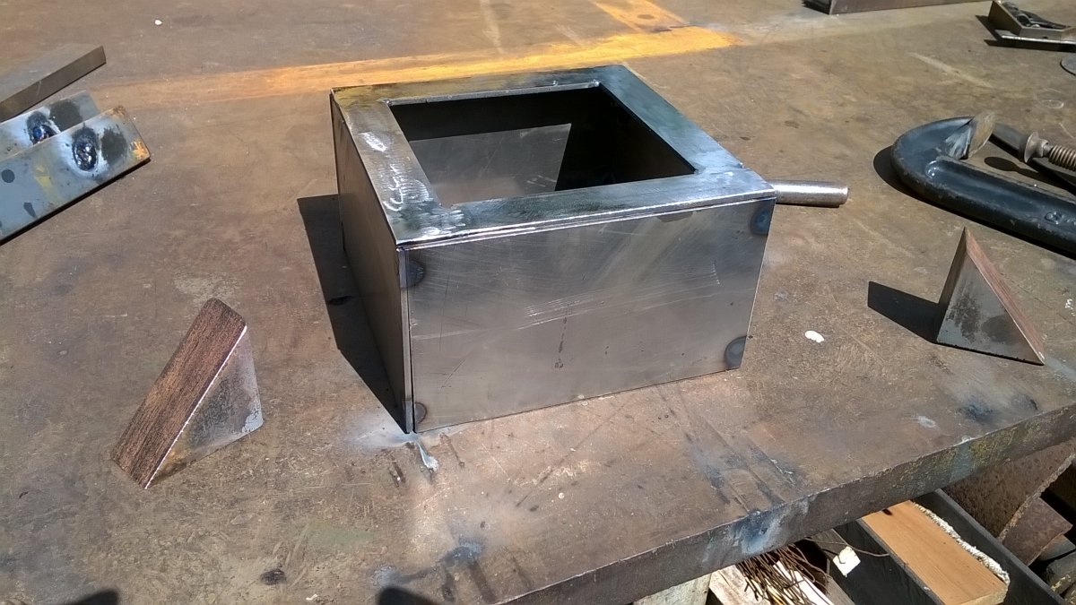

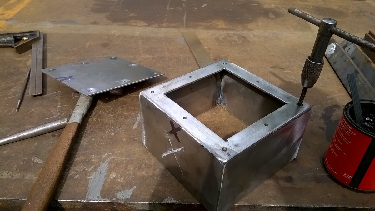

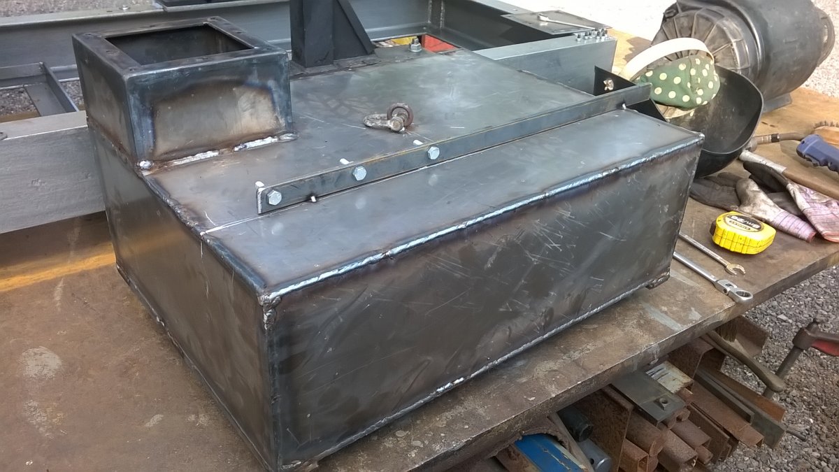

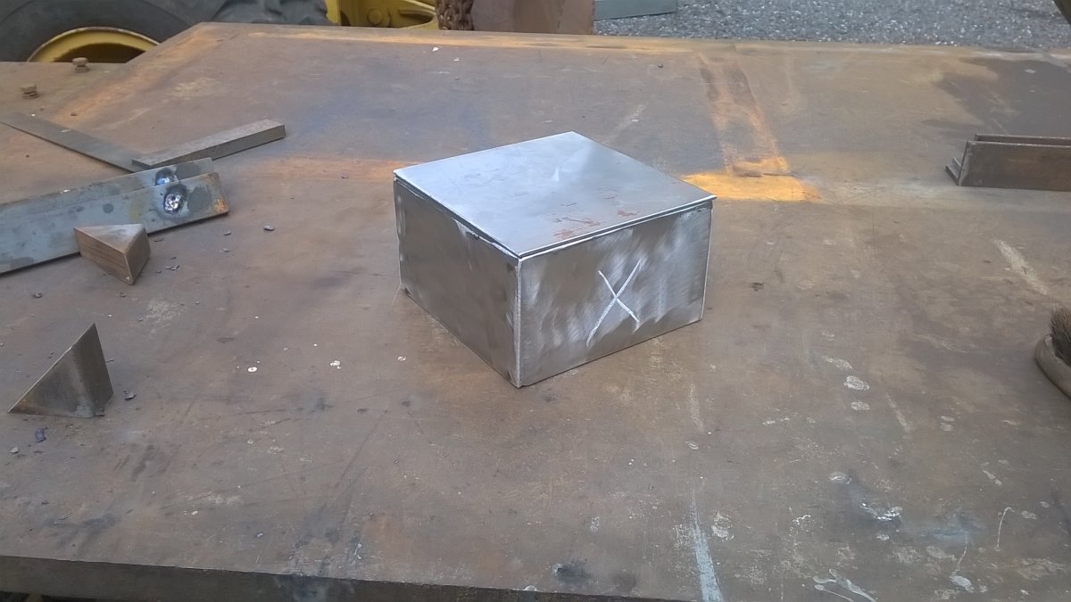

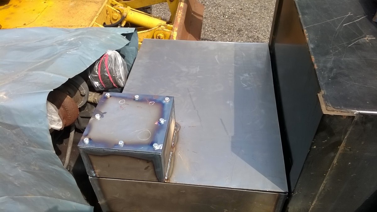

and on to the next bit ....a lid ... from the corner ;)
suitably drilled and tapped ...
ready for ...
Pam'd been busy ...

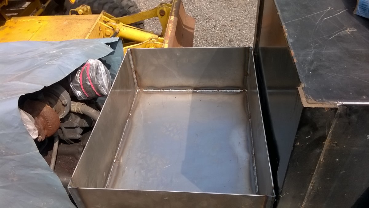

and I got it all back together for more sussing

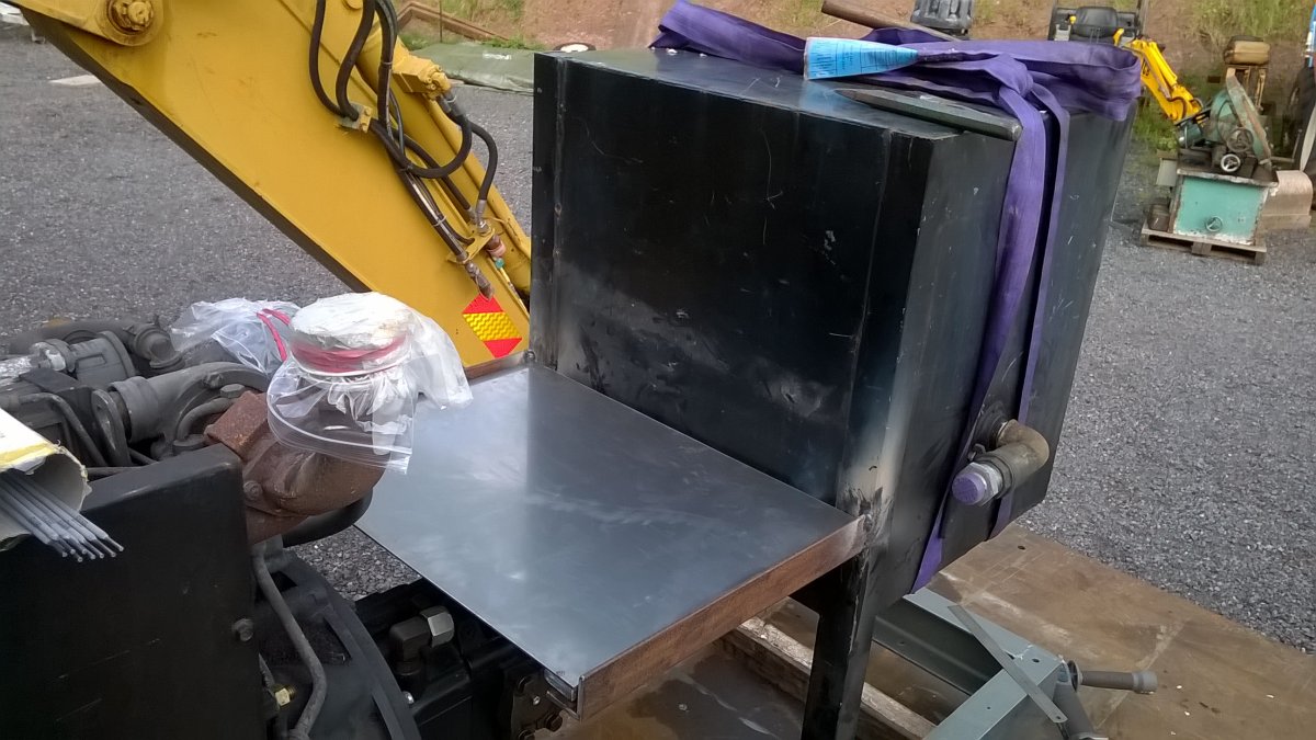

tea interrupted progress for half an hour .... then time for some bracket attachment ..
lovely fit ...

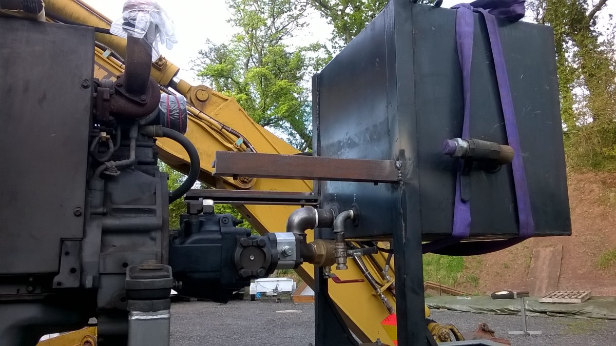

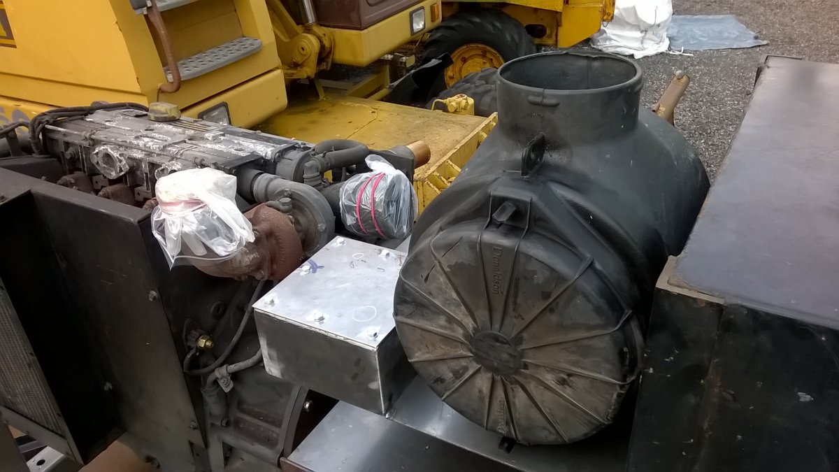

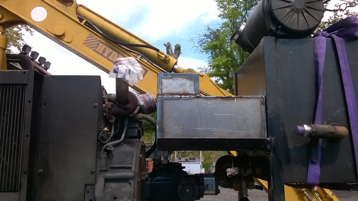

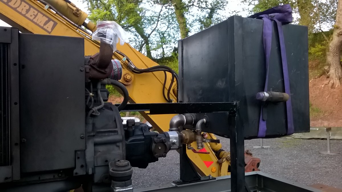

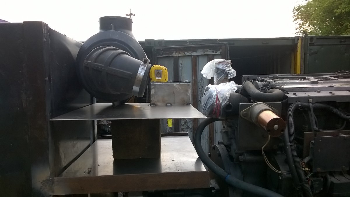

mocked up a position for the neck
and was fine ... enough clearance from the exhaust .... so got it stitched ...
and mocked again ...

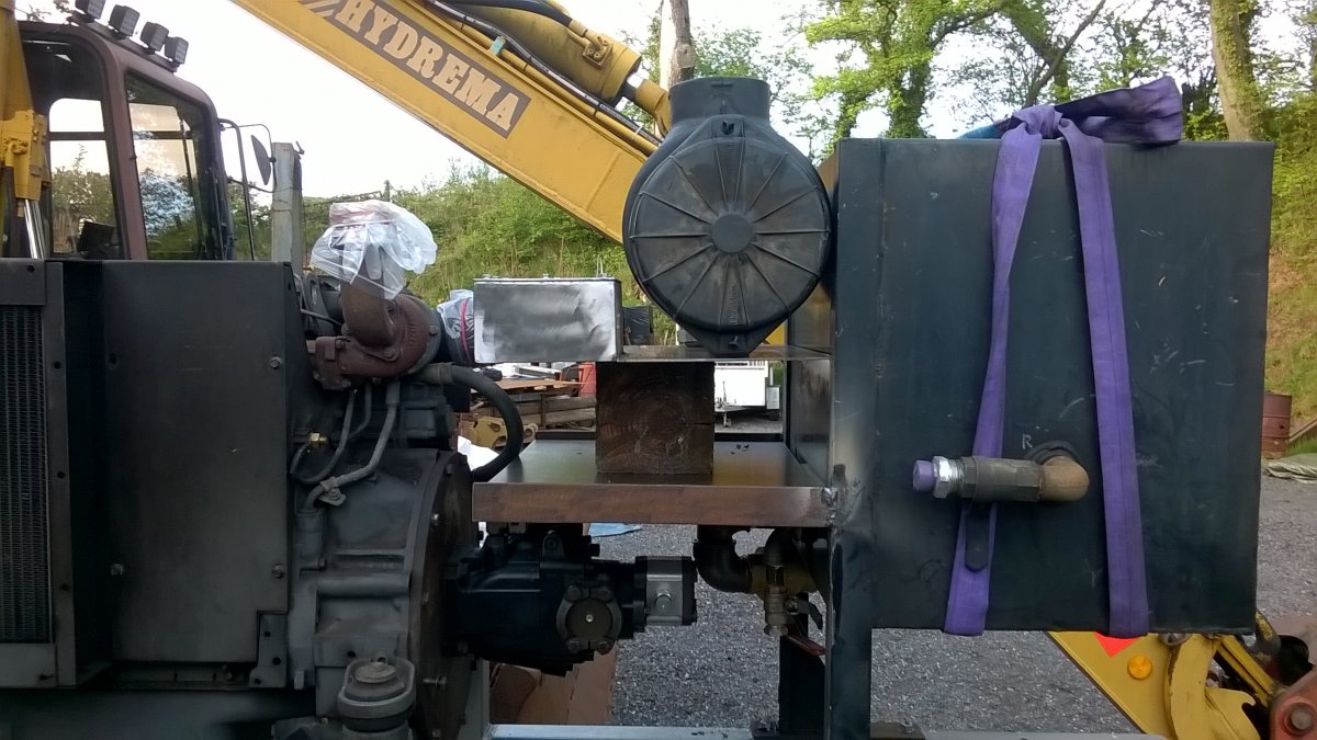

200mm deep tank will give me 54 lt.s ... plenty .. 'Drema uses 4.5 lt.s an hour digging.(y)
couldn't go too tall on yon tank .... got other stuff to juggle in ...
an' it's big :rolleyes:
will have to make up an intake duct to get this connected up
and it's gonna need about 4" of offset :( ... some cut and shut required .... don't 'spose you have the intake plumbing for the filter @Mogman :unsure::giggle:

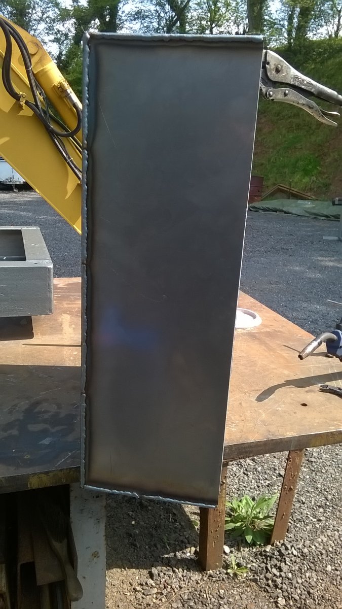

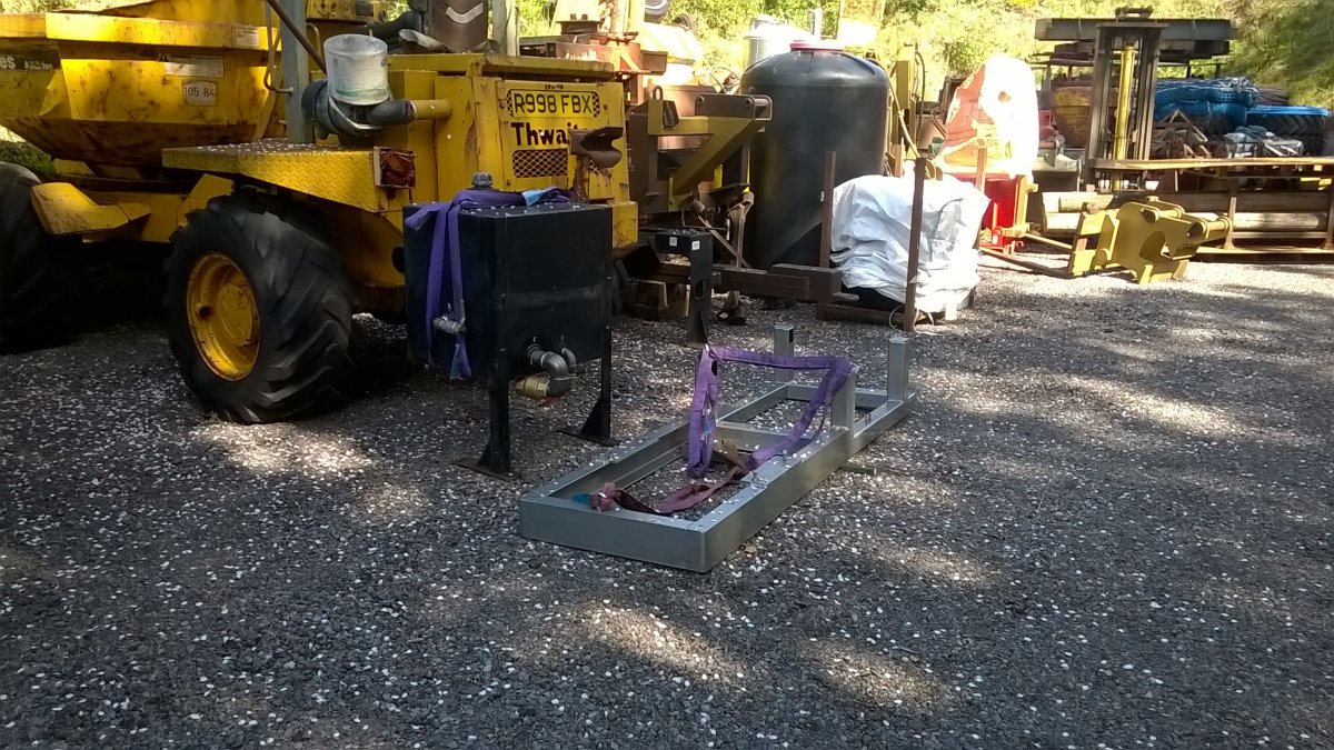

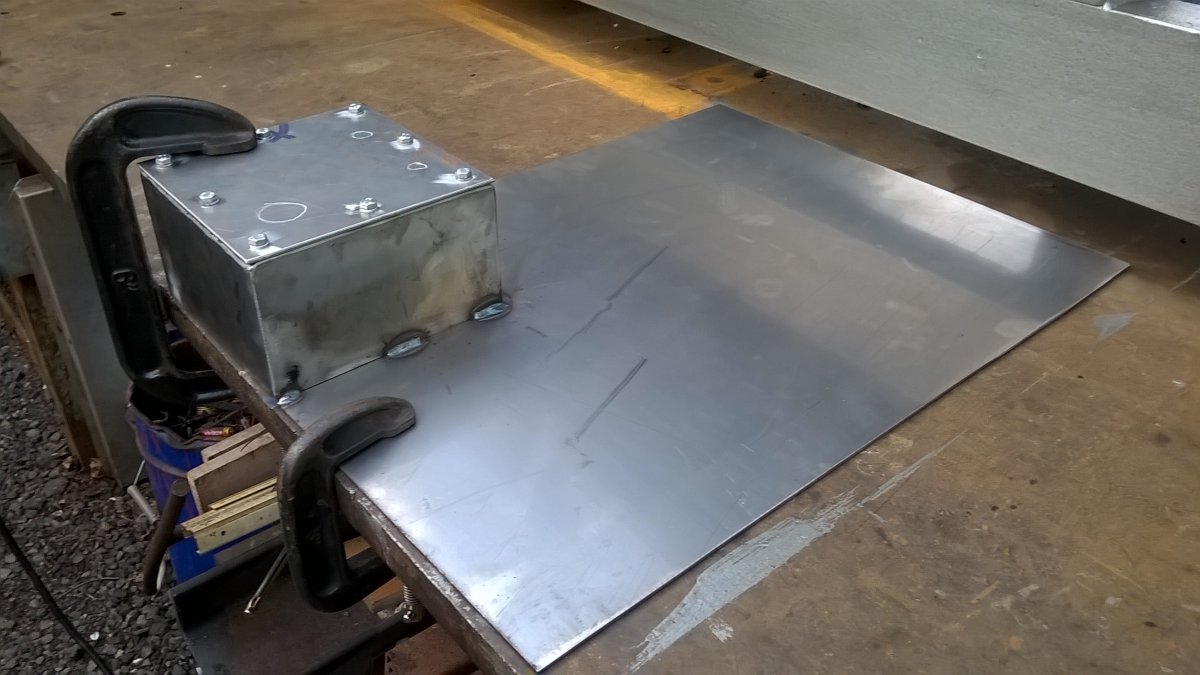

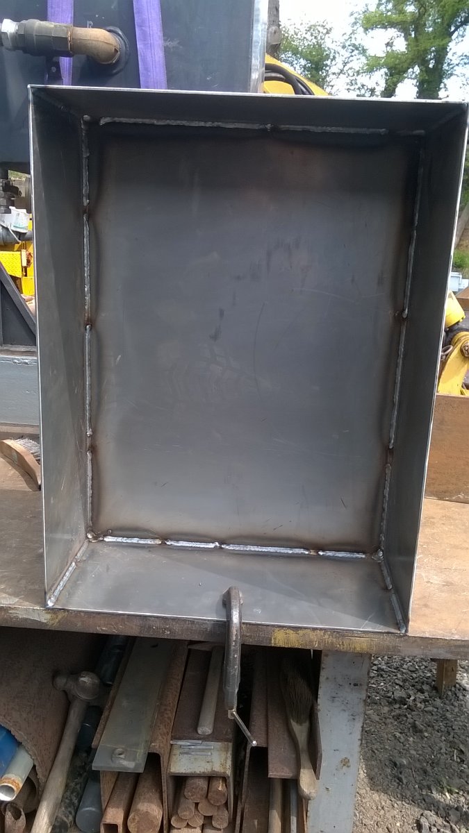

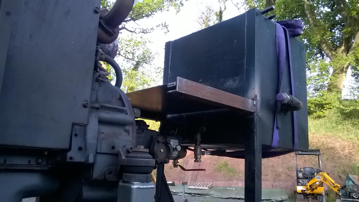

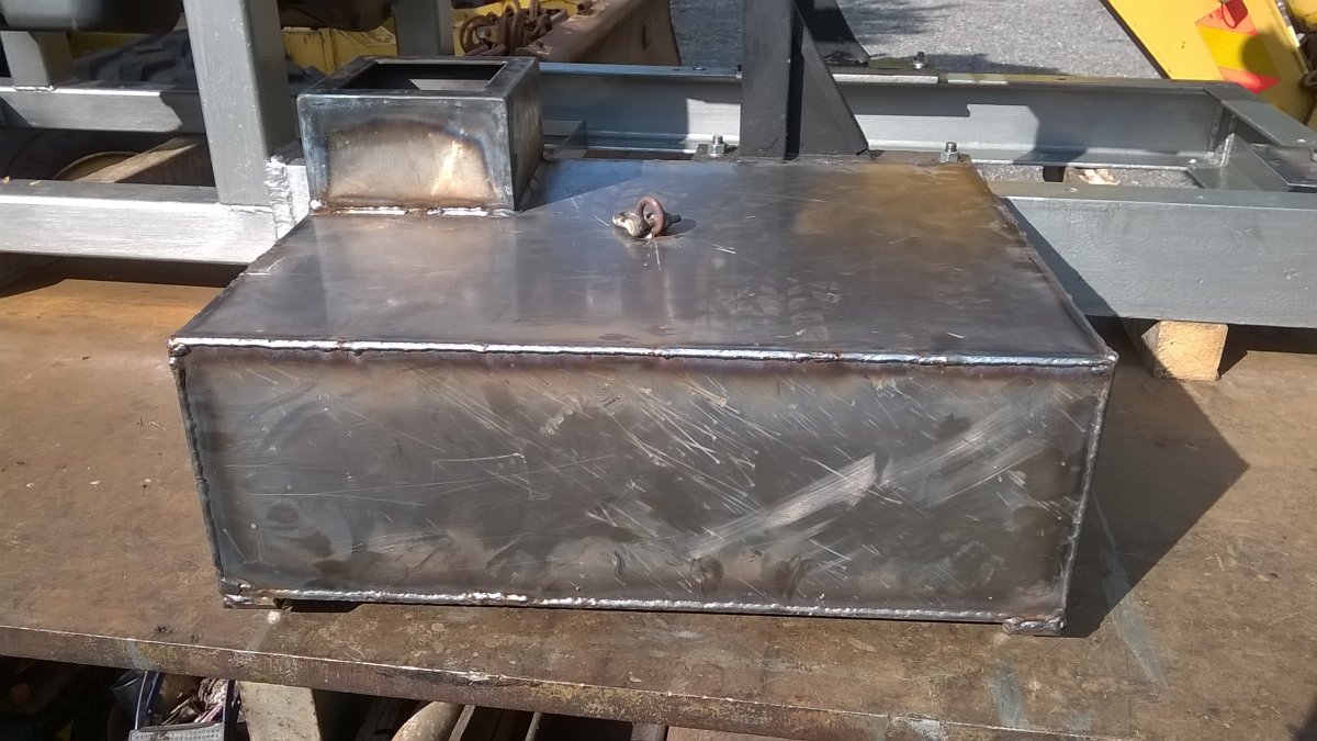

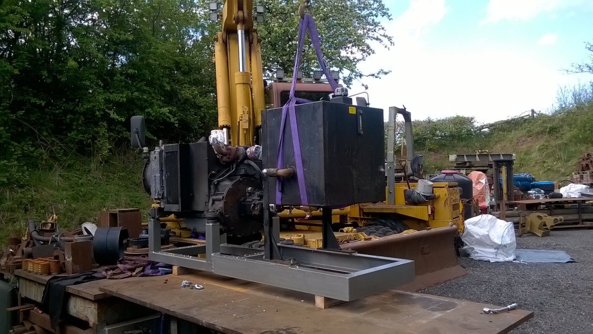

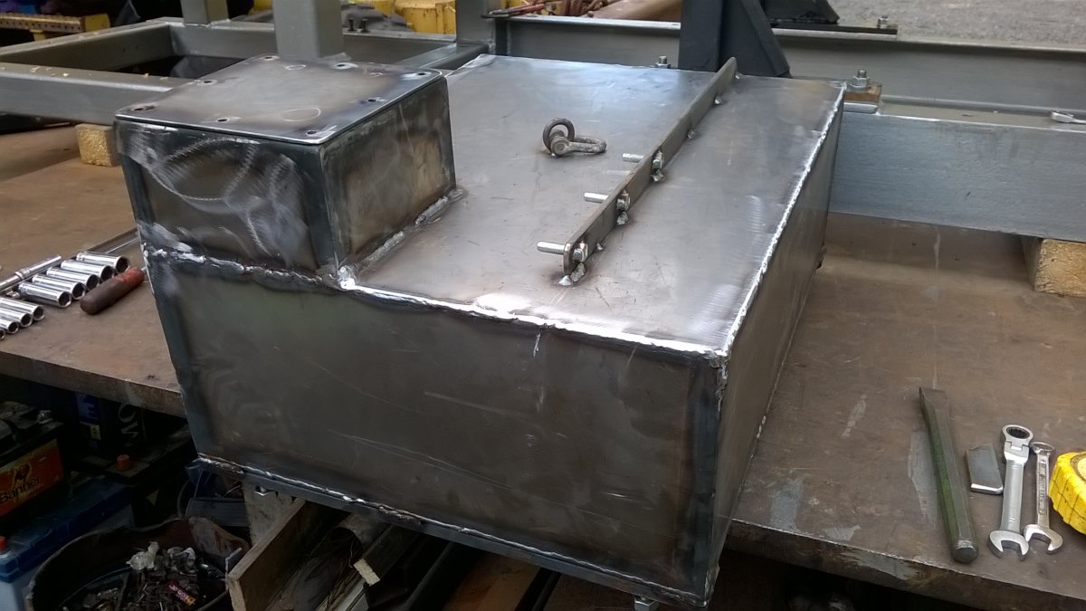

Sunday was a blue sky day and relatively calm ... :giggle::giggle: ... tank time ..

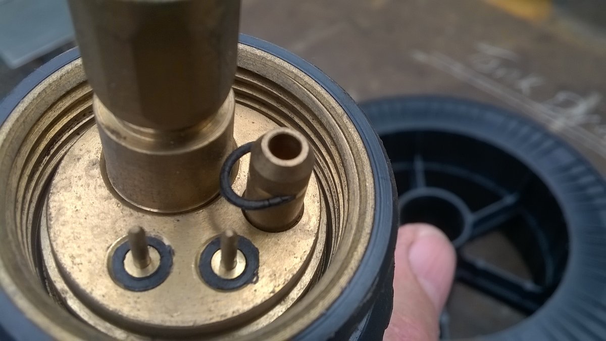

usual story ...

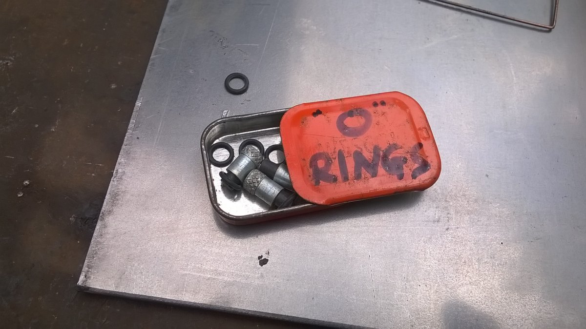

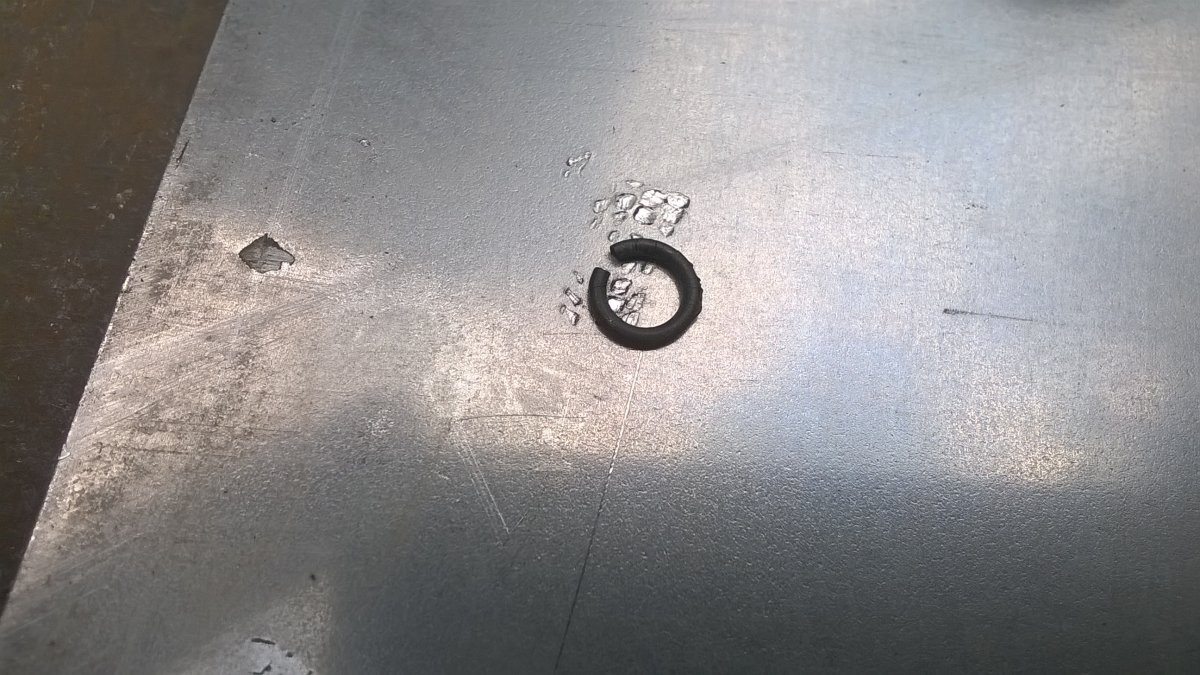

O ring bollo-ed :( .. 's the trouble with leaving the torch disconnected, sat on top of a cupboard :rolleyes:
new one required ... can never have enough stock ....(y)

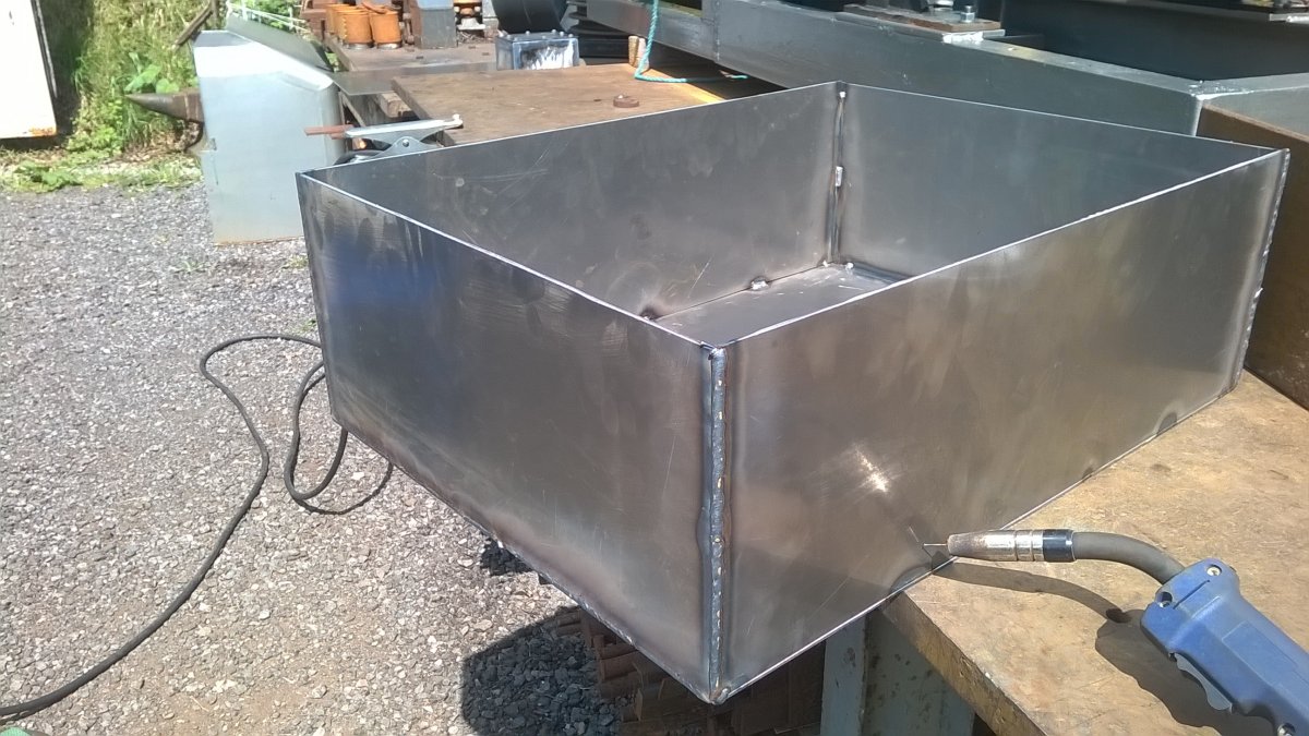

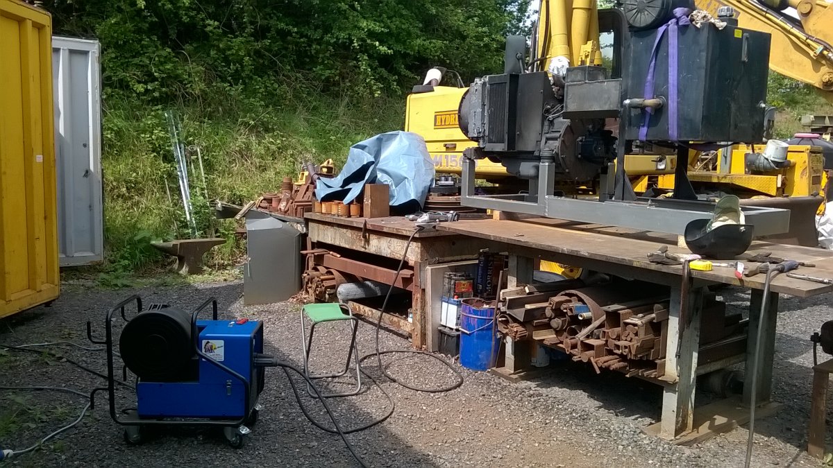

.... so .. MIG out and put together ready for some action ...

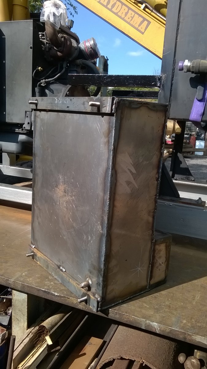

welded inside and out right up to the top ... gotta be pretty unlucky/inept to get a leak ... never had a tank leak yet 🤞🤞:giggle:

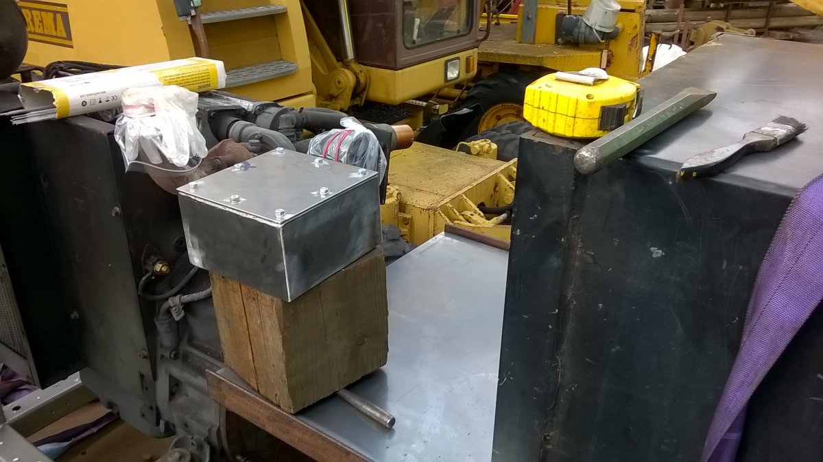

quick try to suss the mounts ..
and nailed together

mounts tacked ..
and a handling eye added for ease of fitting (and later extraction if needed ....

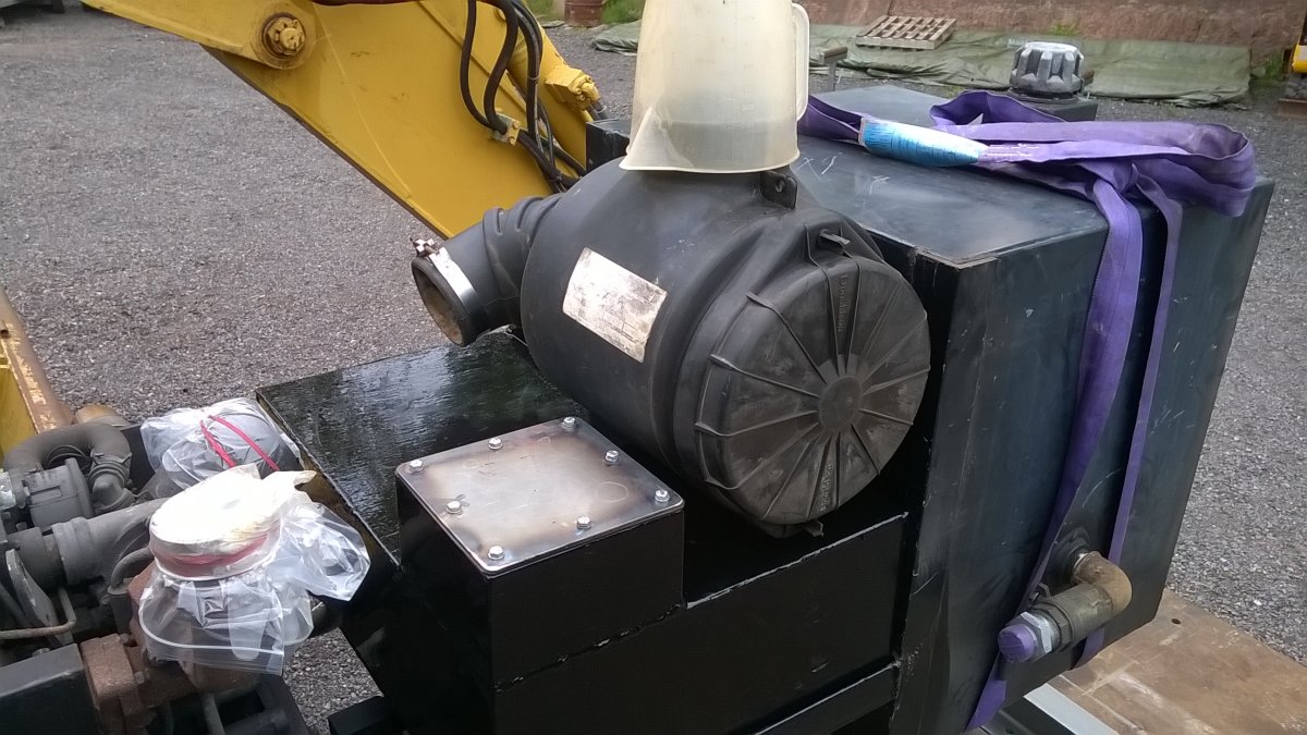

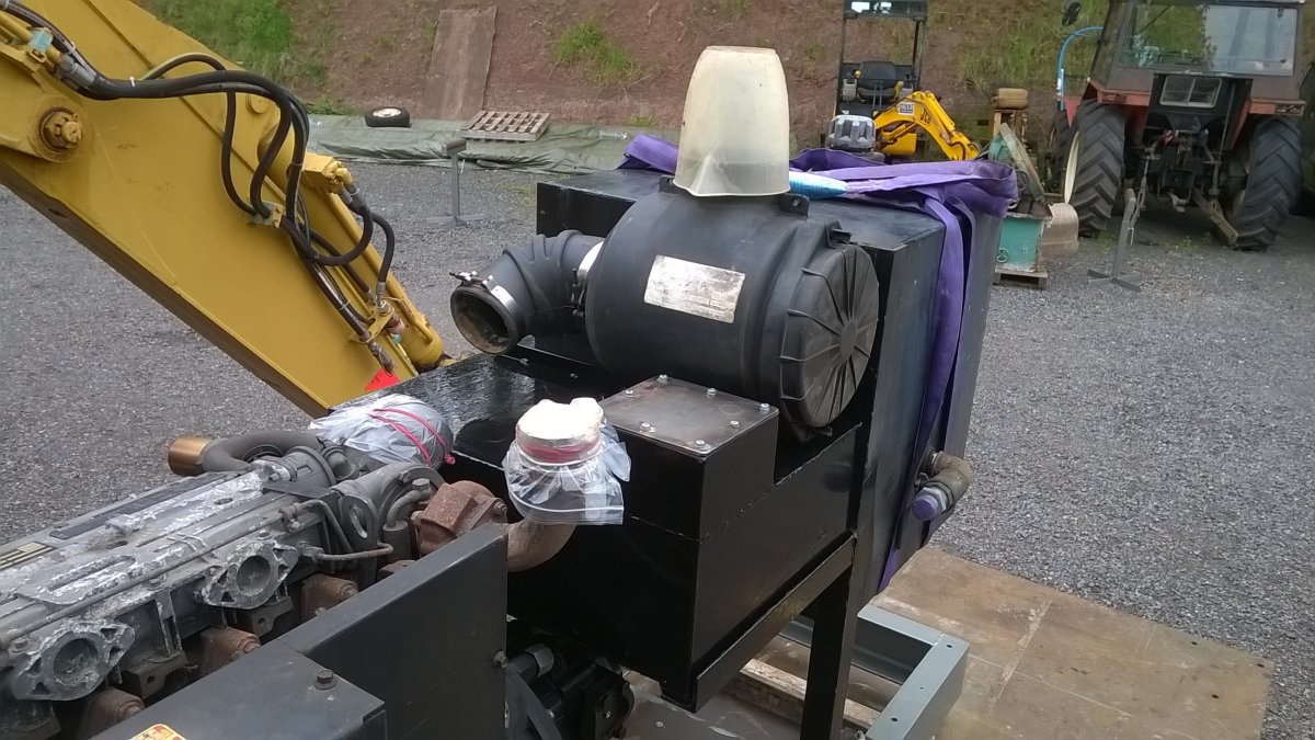

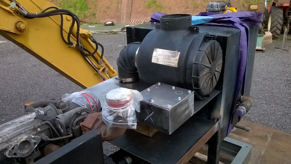

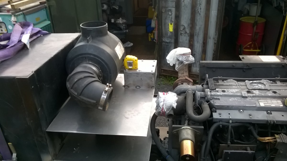

air filter mount sussed and tacked
trimmed and consolidated with bolts captured
tea time .... followed by .... :giggle::giggle:
Half expected to see it covered in crab apple blossom this morning, stuck to the wet paint :( ... but was fine so got it in spot on top of some rubber strips under the mounts
and filter attached .... nuts an' washers took some juggling in, as I guessed they would .. pretty tight

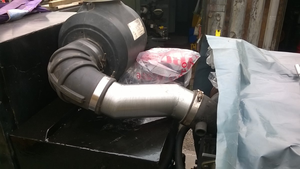

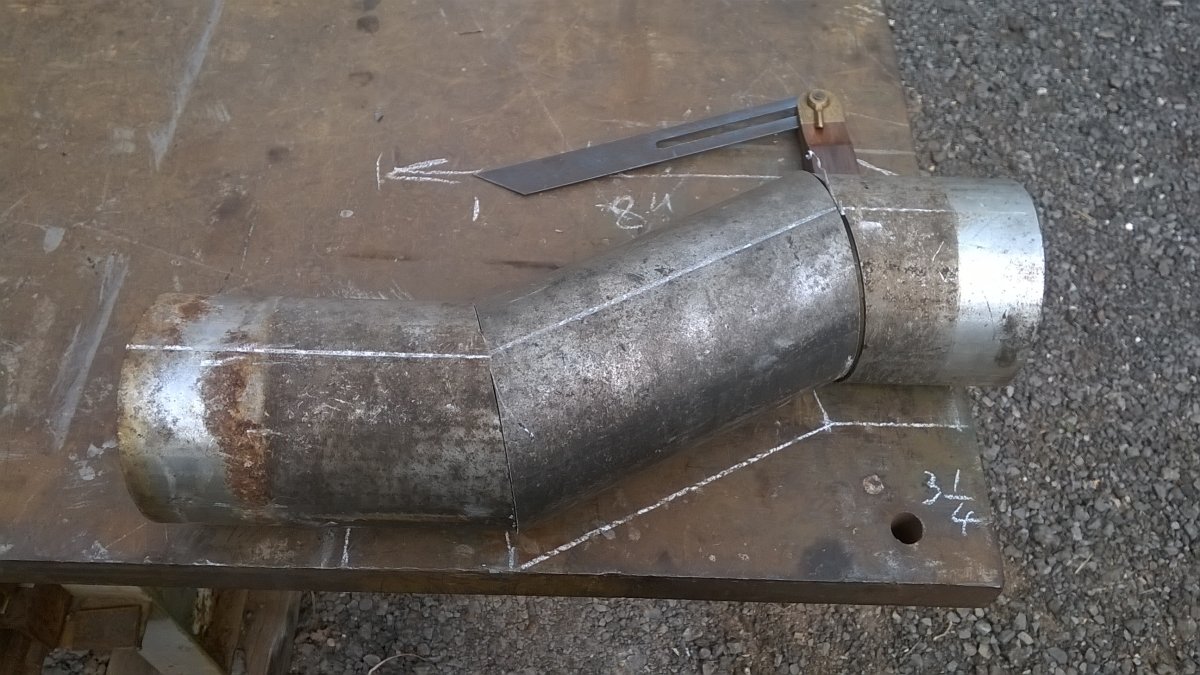

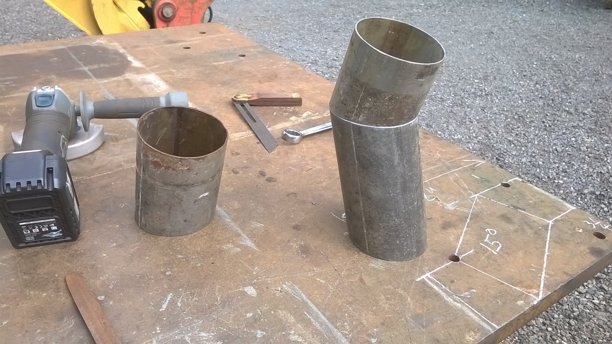

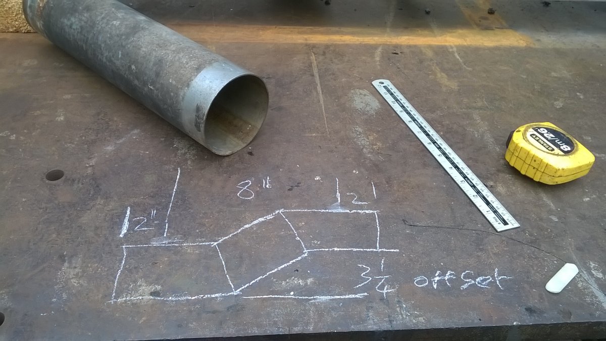

next issue today was creating an inlet tract
to align everything ....
haven't used this in a while

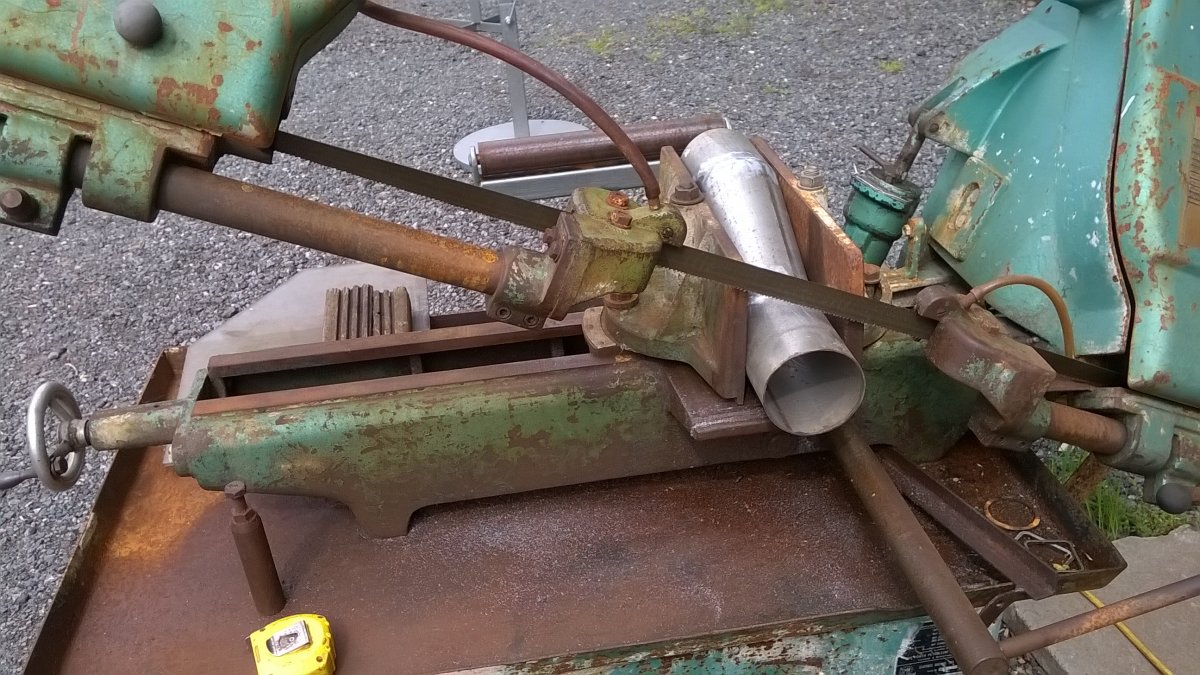

such a handy tool .... off set and 'going' sussed ..

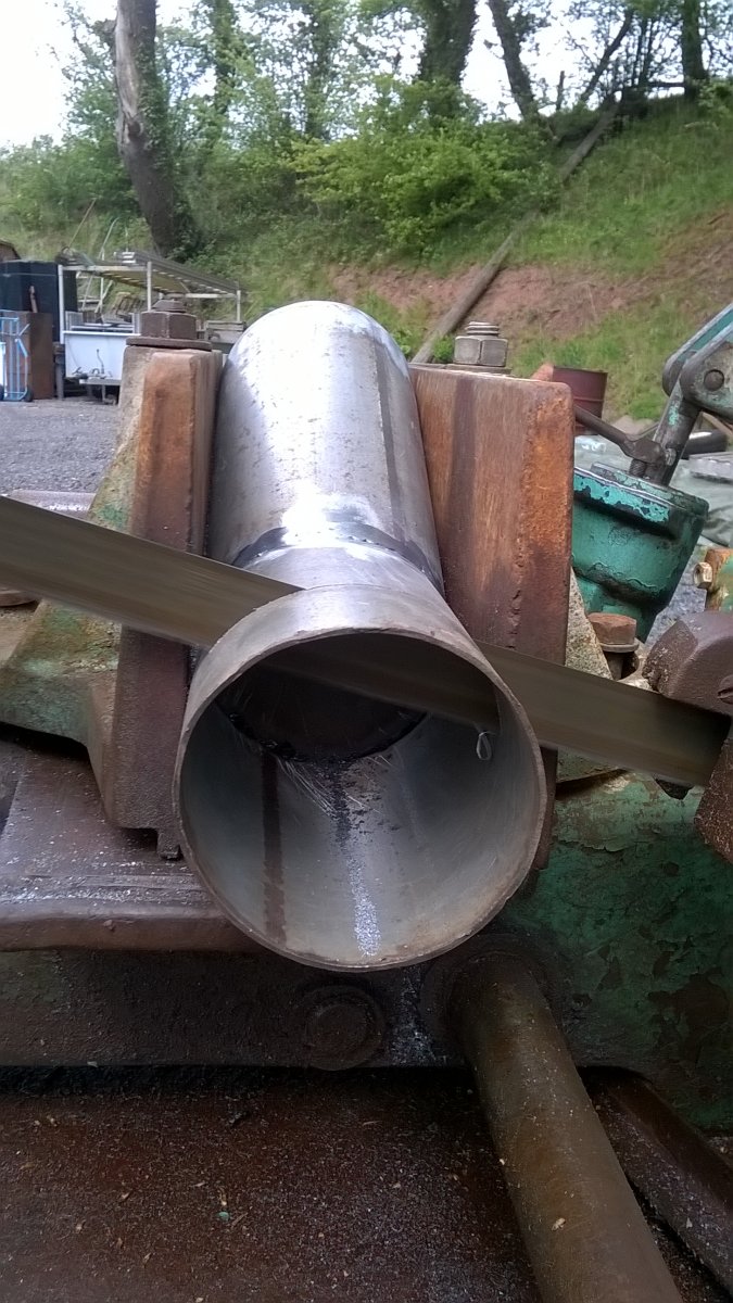

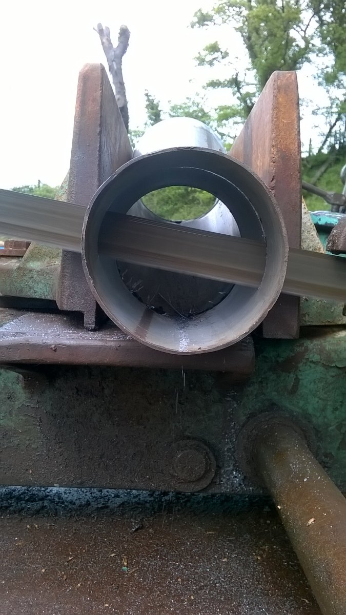

saw time ...
first bit looked good

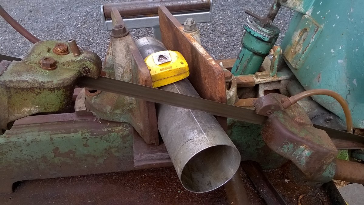

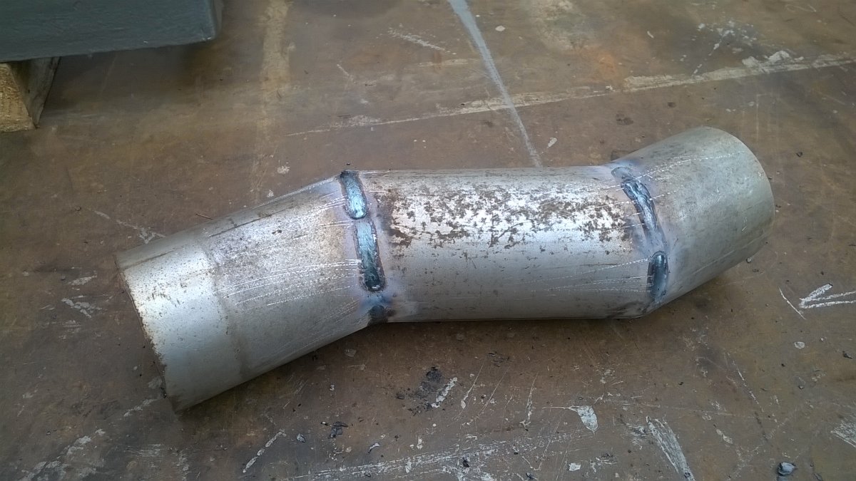

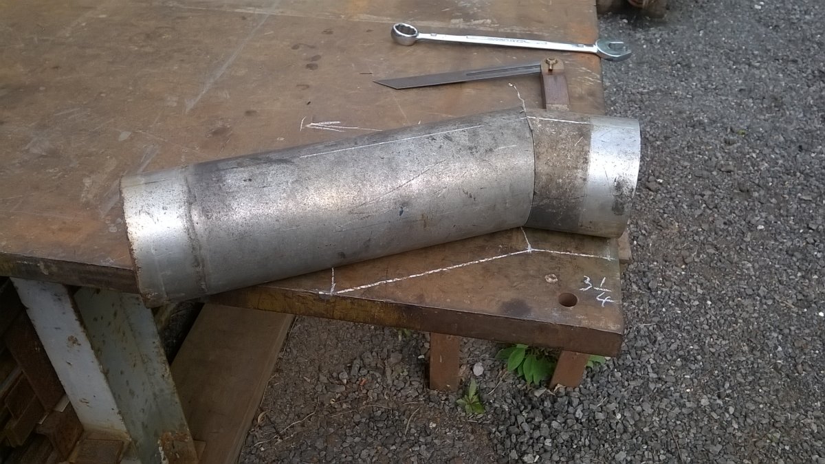

trick with cut and shutting a bend is remembering to put a centre line each side of the tube ..... so much easier to align the angles after (y)
cleaned up, de-burred and ready to sick together .....
couldn't be arsed to set the MIG up again so a few 1.6 rods later ...
and some fettling ... then into the saw to trim the final 2" of excess off

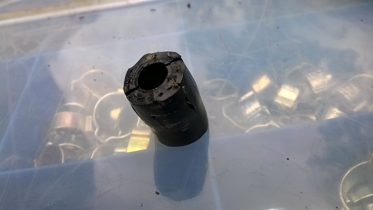

luckily I fitted an isolator on the genny, on top of the neg pole and having opened up to knock it off, noticed cherry on top of the tank (which it's all built on top of) ... on inspection the return line had split ....:(
nipped the end off it and re-attached, with an Oetiker to keep it in shape and in place (y) ... and mopped up the small amount of red creeping about in there ... :rolleyes:

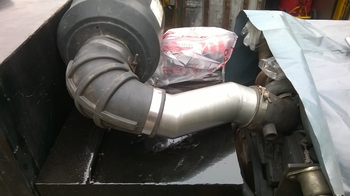

back to the fettling and then a trial fit .... ;)
" Perfick " :giggle:

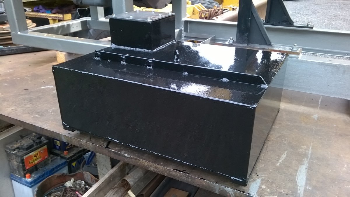

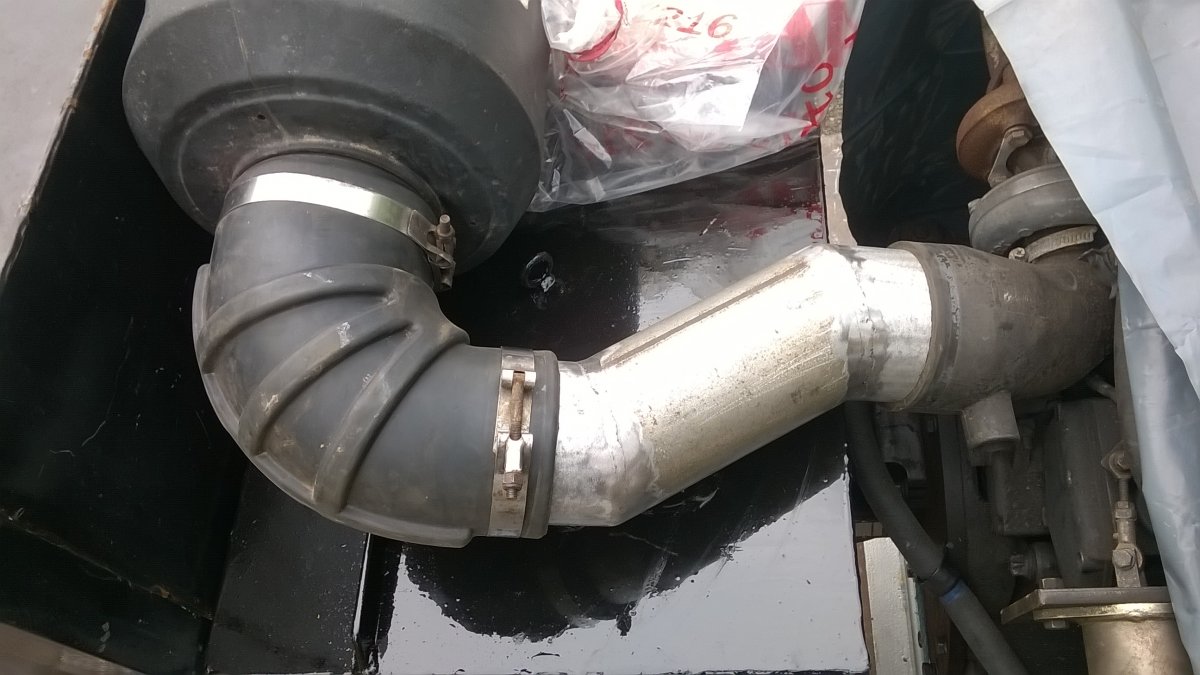

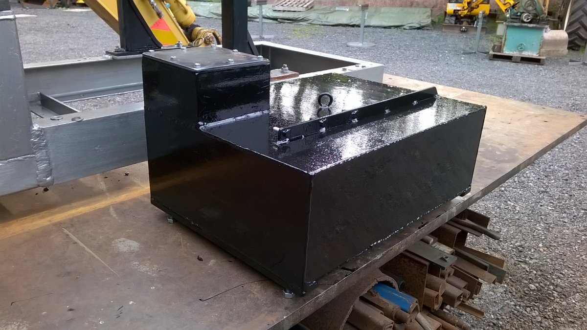

quick coat of shiny .. dug out a suitable hose clamp for the turbo rubber .... and installed, just before it started ....... to spit with rain :cry: ...

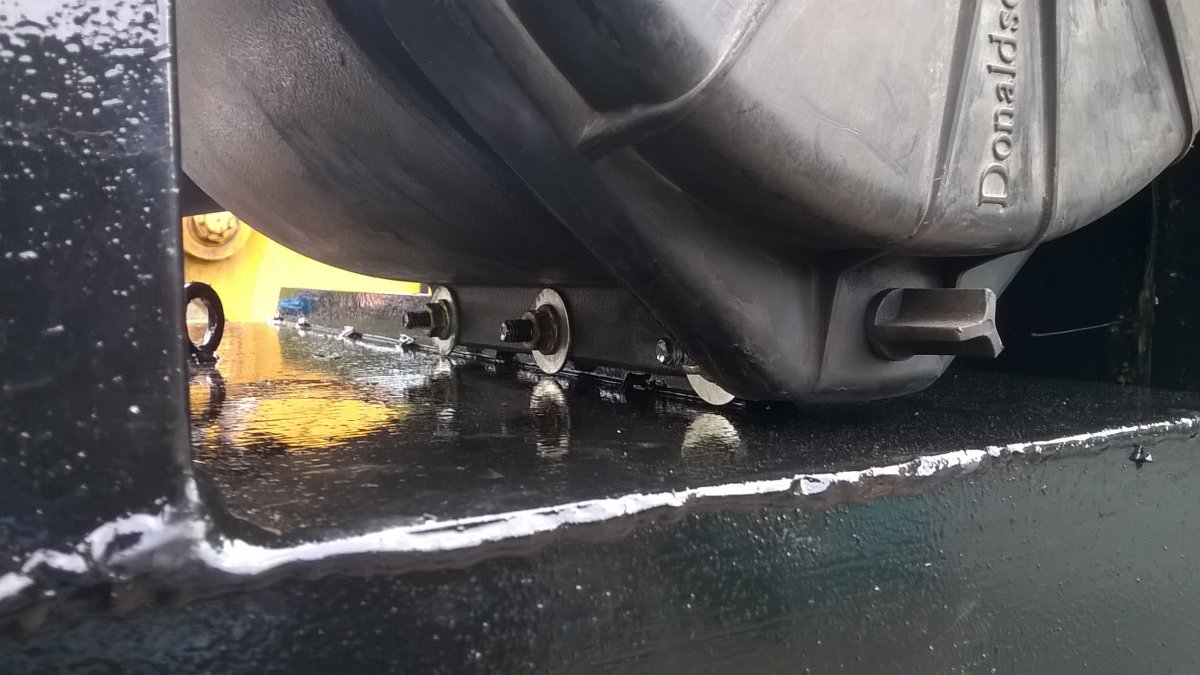

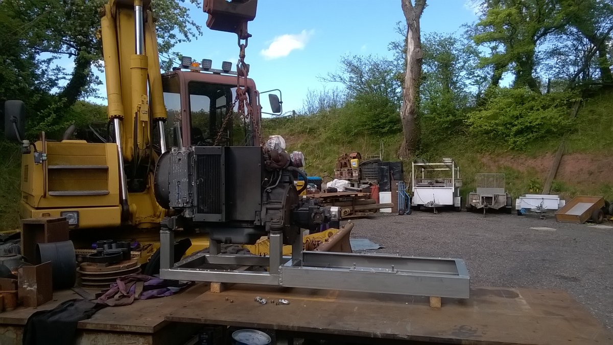

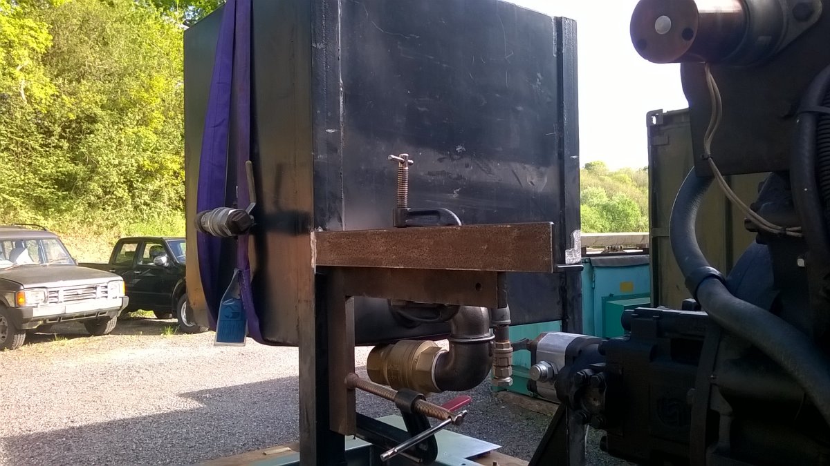

next up ..... oil cooler installation/mount ..... been pondering various possibilities for some time and 'jury's still out ', but think I may have a handle on it finally :)
