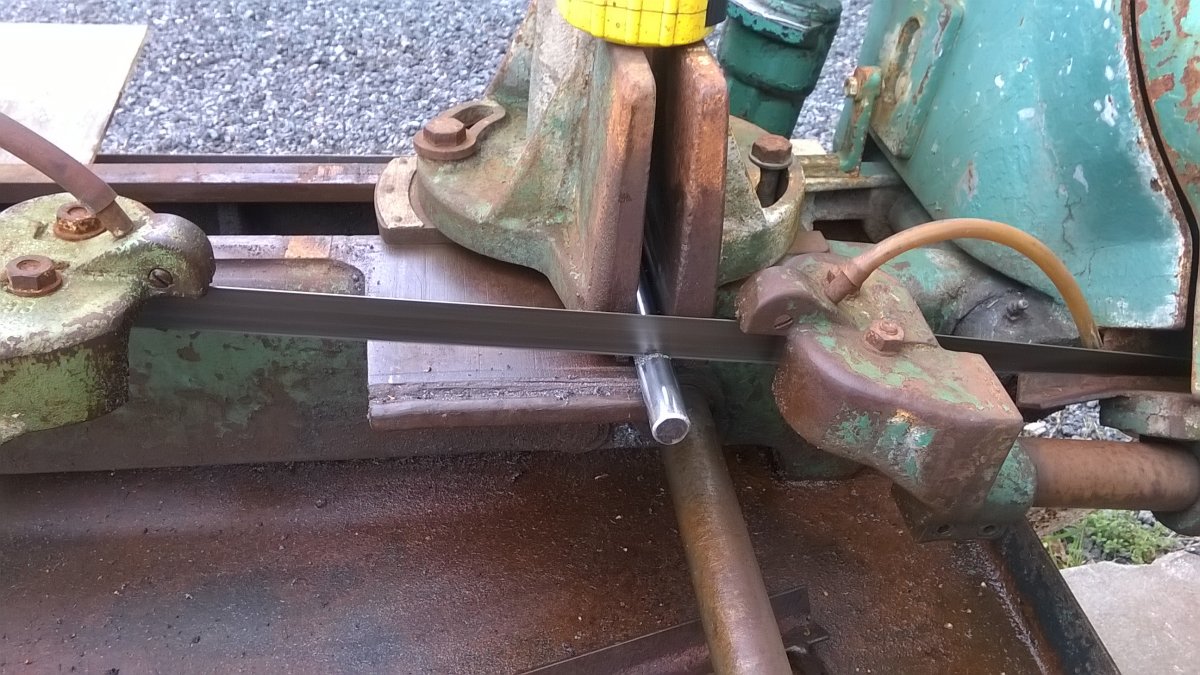

dragged 2/3 rds of a length of 60.3 x 5 CHS out from under a box and cut a couple of bits off it ... Got to say Mr Aldi's little 5" battery grinder gets used a lot more than I imagined it would and is a great little thing for this sort of thing ... :love:

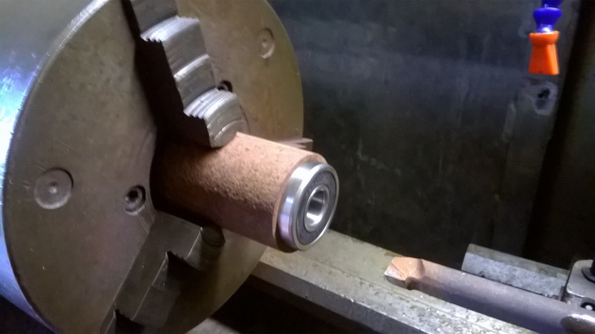

Wound up the genny, woke up the Harrison and stuck a piece in for some attention ....:giggle:

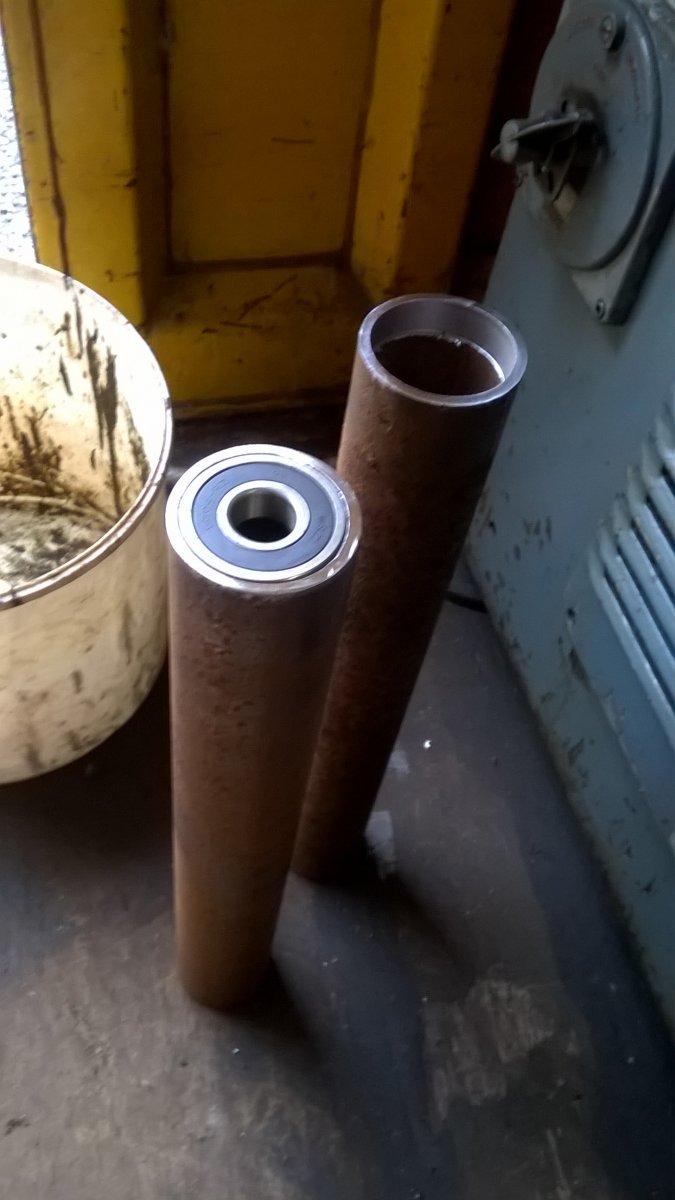

opened it up a bit for some of these
four ends later and ...
had a pair of these

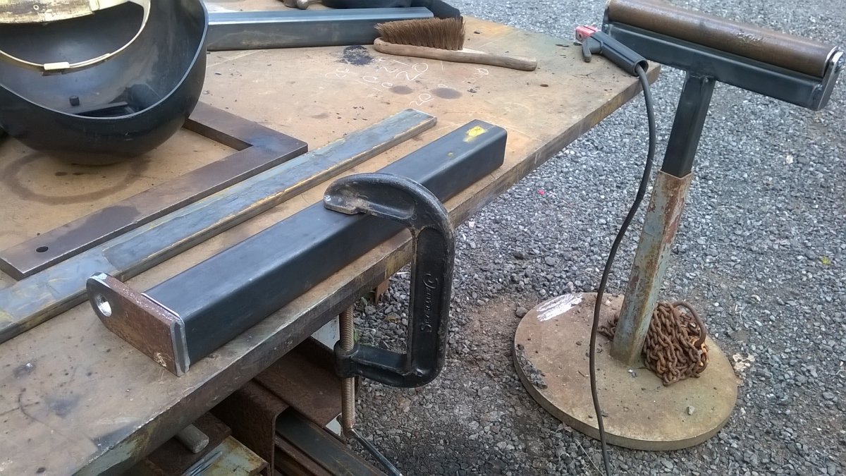

drilled some ears and lopped them up with a few other bits too ... :)
ready for some assembling ... belt grinder is such a great tool for shaping stuff up (y):cool:... time for some hot stick ... too bloody breezy for the MIG -- AGAIN :cry:

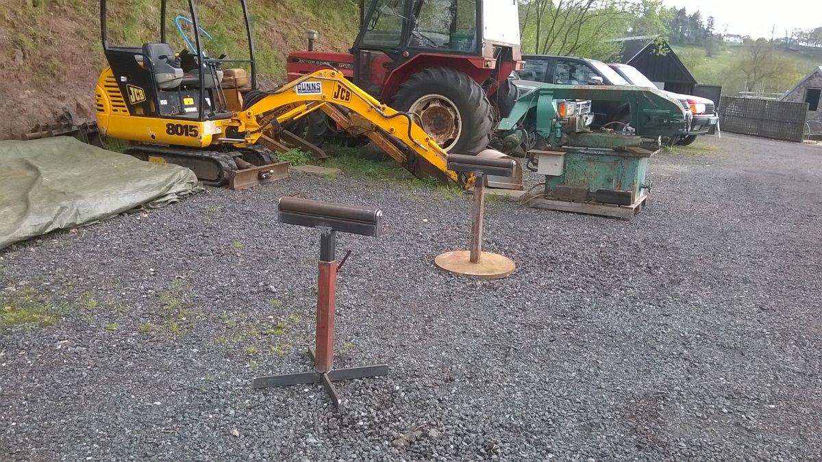

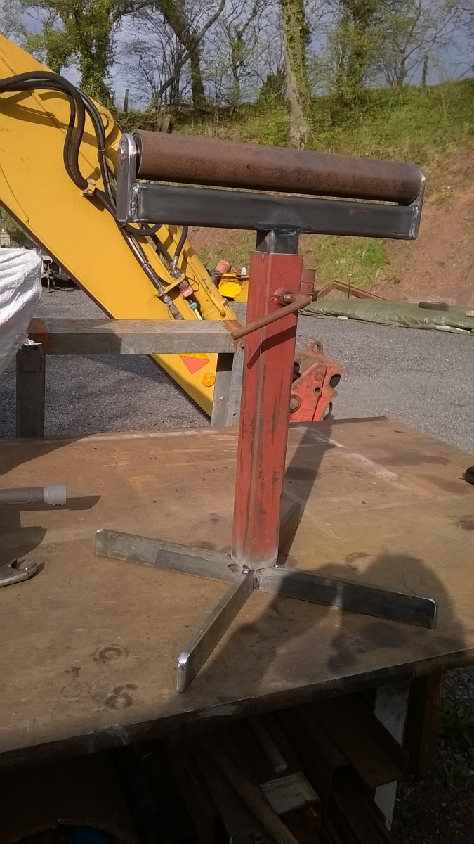

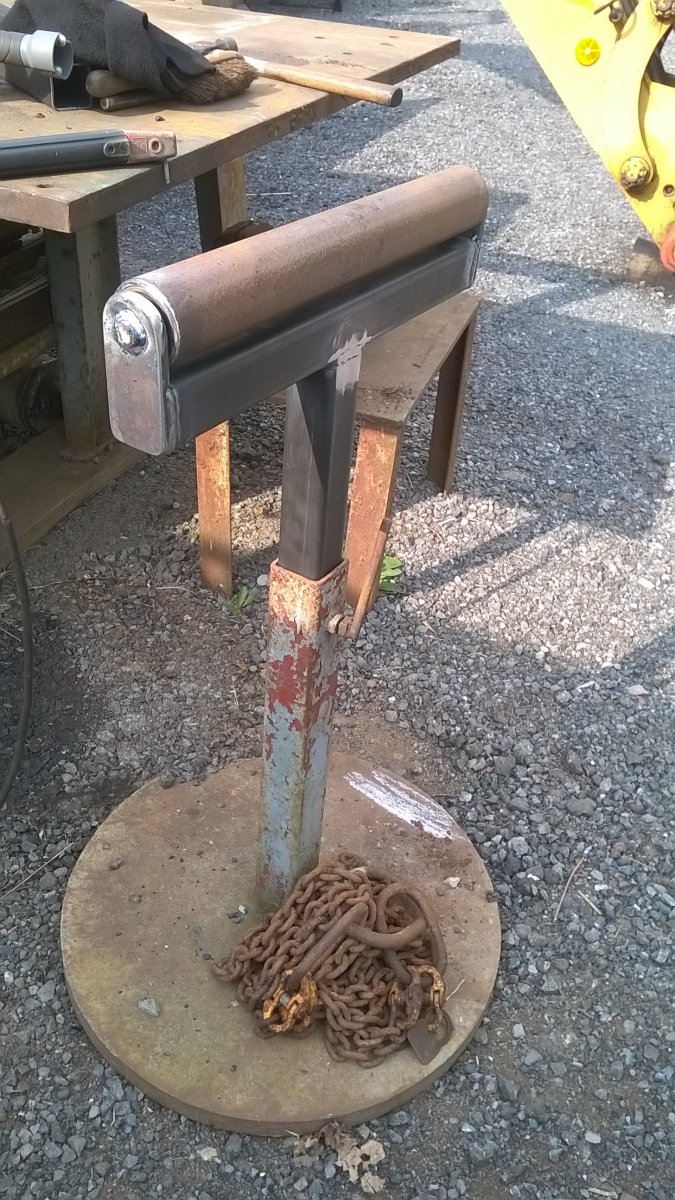

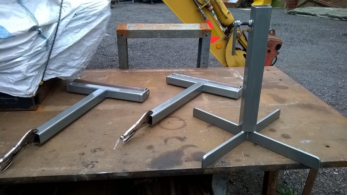

got a lot of stuff to lop up shortly for a couple of jobs for the BIL and without the rollers it is bloody hard work dealing with 25ft lengths of SHS/RHS :rolleyes:.... I usually make the ears on these taller to stop stuff exiting off the sides of the rollers, :( but decided to keep these below the roller height/surface, so I can use them for ply sheets, etc., on the bench, :)as they're taller than usual too, to reach the bench heights(y)
you know what's coming next ... after I'd had me tea :giggle::LOL:
couple of coats of shiny sh1t ... keep the red stuff at bay :ROFLMAO::ROFLMAO:

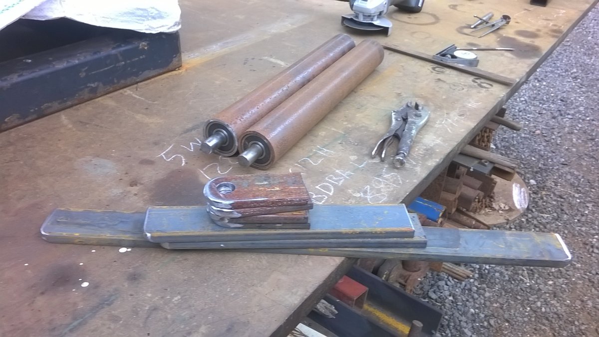

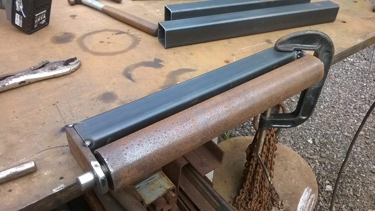

so .. bit warmer today in spite of the N Easterly we've had blowing all day :( ... been trying to get this little number done for ages and need to use them shortly ... got a lot to lop ....:rolleyes:

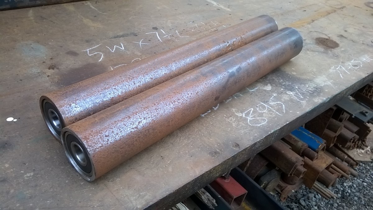

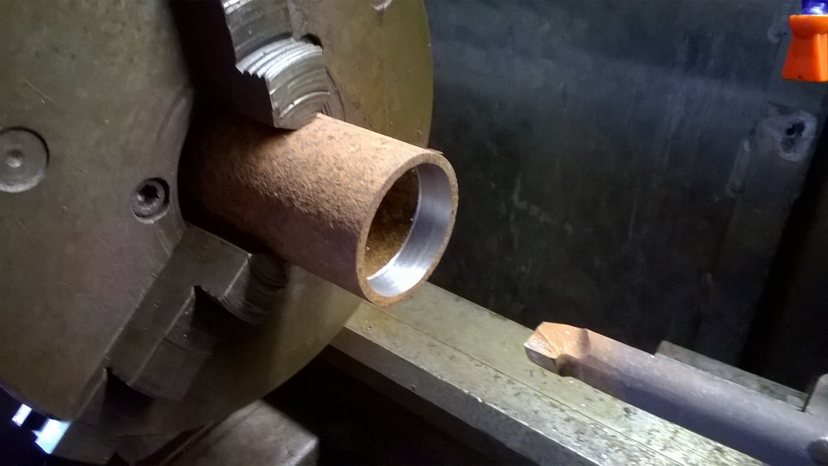

had a pair of these
living under the box had left this lot looking a tad s/hand .. got the worst off with some tape .... old belt grinder belts cut/tear up into great strips for this sort of thing ... never used to chuck 'em out unless they were 'bald' ... always got used up, but still have quite a few to use up yet :giggle: ... started life as 60 grit and have them in varying states of 'grit' :LOL:

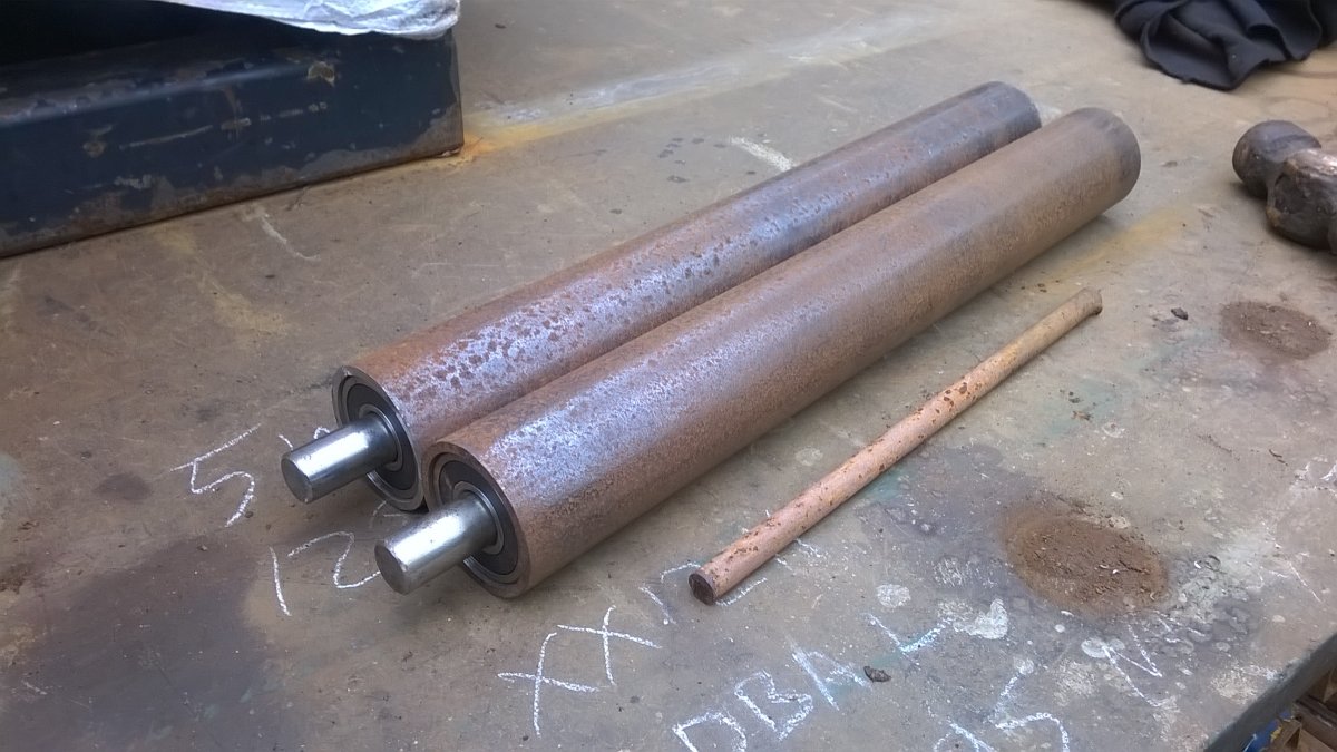

lopped a few axle bits .... after letting Mr Harrison clean up a bit of 20mm ...:giggle:
and tapped 'em into situ ;)(y)

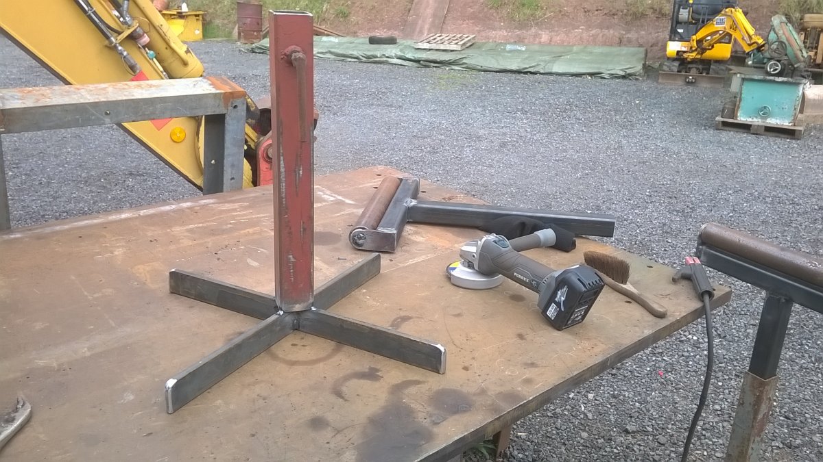

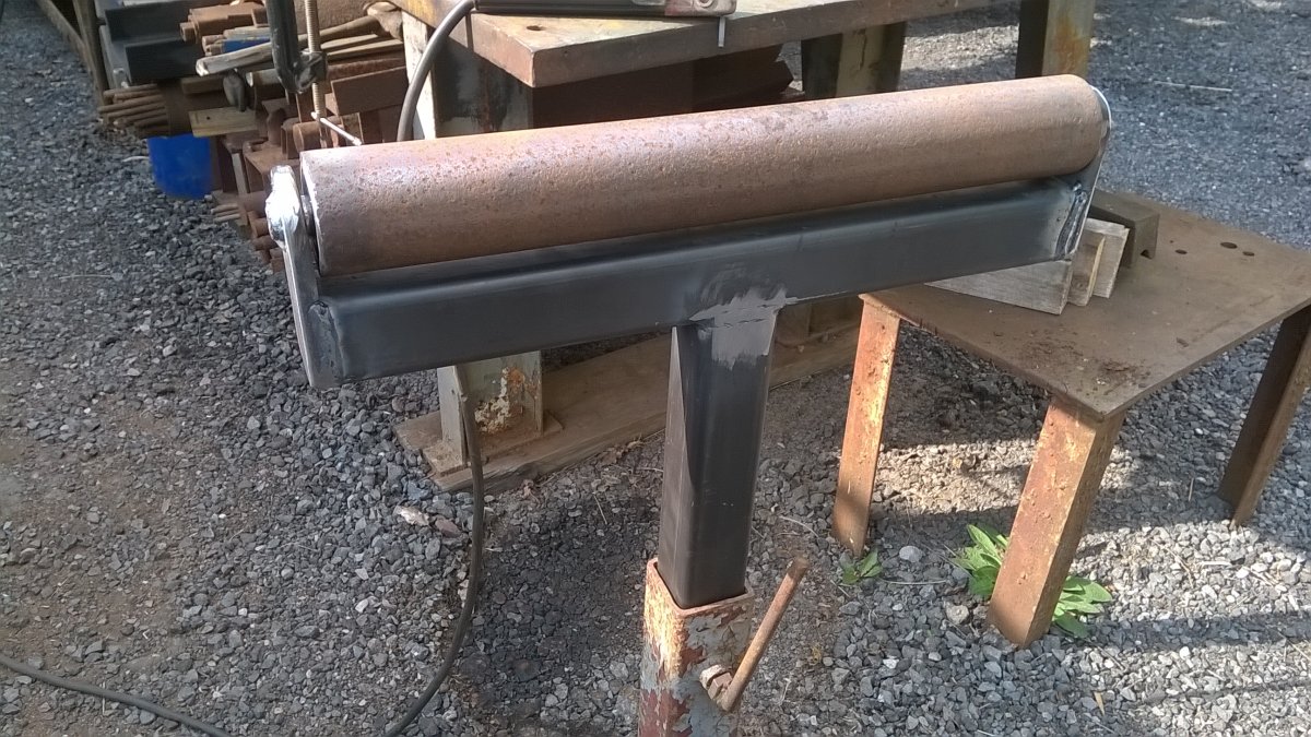

have you guessed what I'm at yet .....:unsure::whistle:

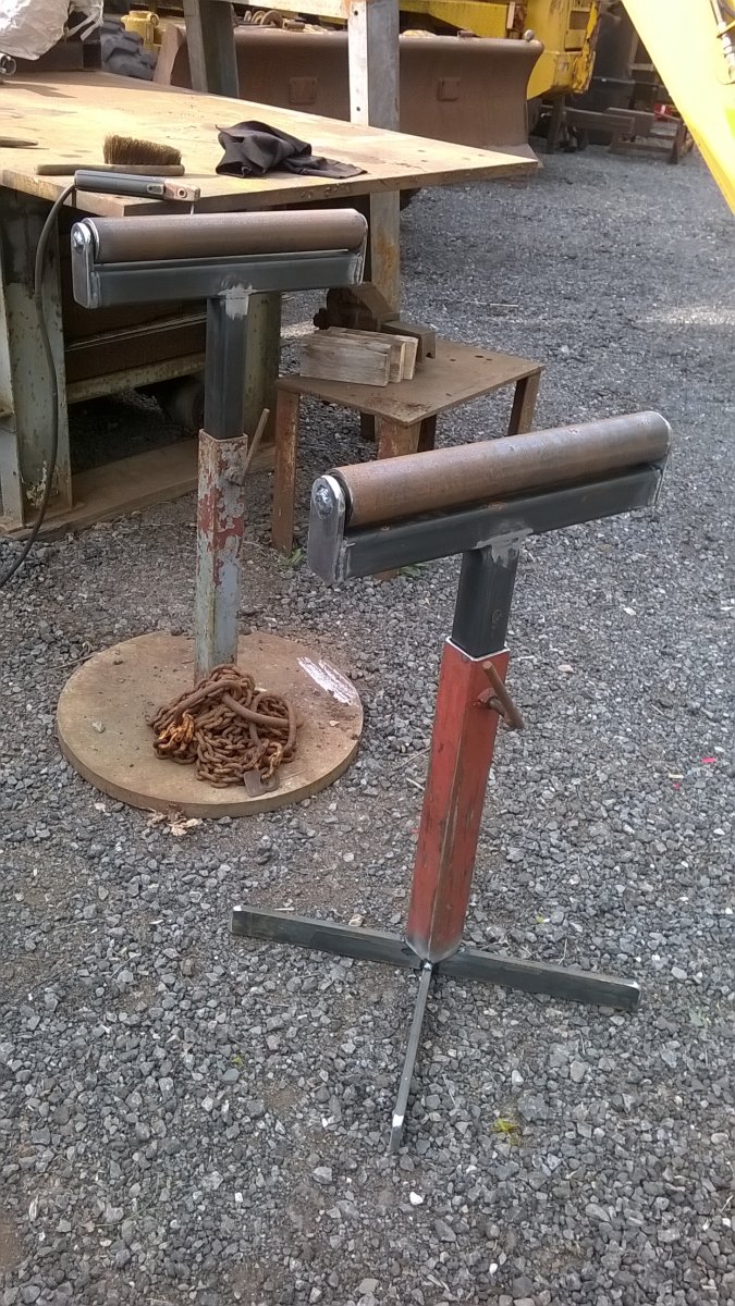

and on to the next one

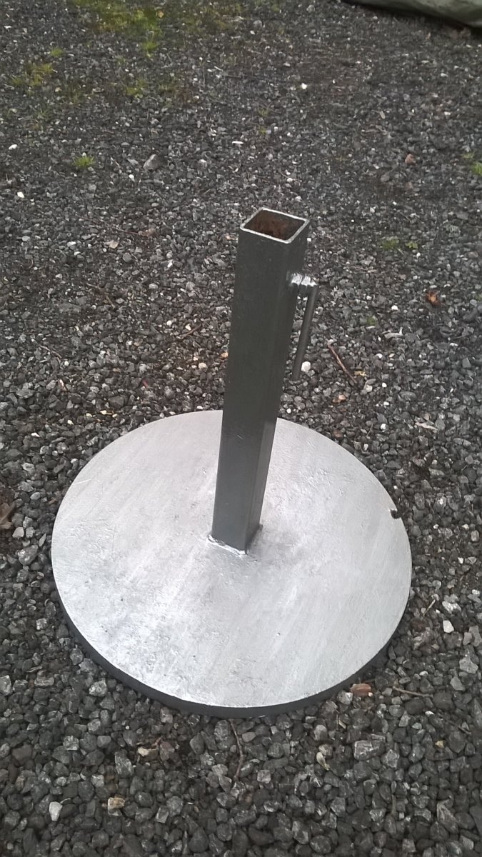

having had to re-purpose the gert flywheel that used to sit under this one, I needed a new base set up ....
View attachment 34703 View attachment 34701
worked out alright ... did consider some pad feet on the legs, bt think it sits firmer in the planings, without
