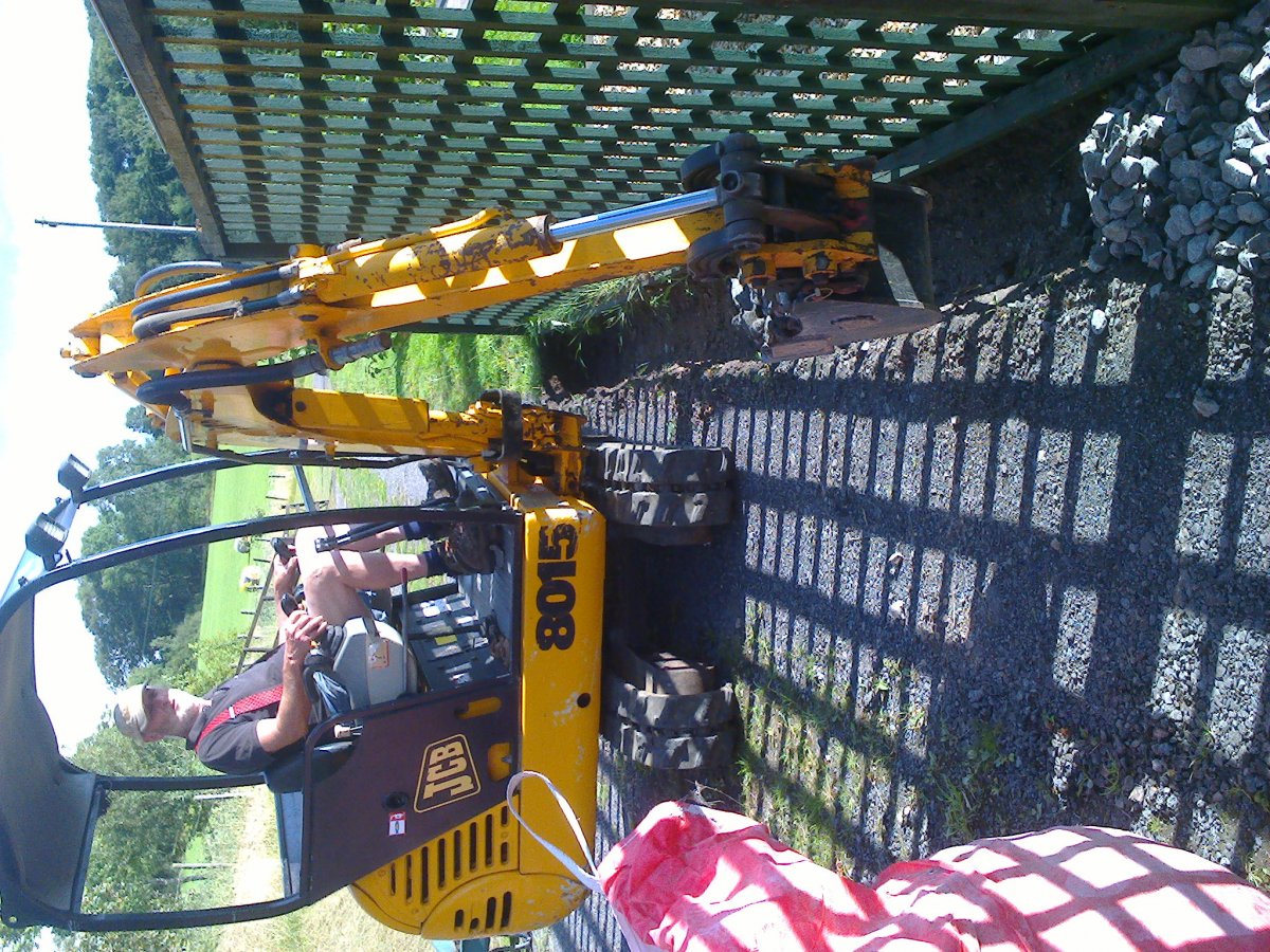

extending a drain/run off catch ...
in some bloody hard ground .... he did well ...
then I enlisted big bro's help with some bags of clean 40 mm ......
sorry 'bout the images 'lying down' ... Pam insists on taking pix portrait and I'm buggered if I can get them to rotate in here -- rotating and saving a copy doesn't work :(:mad: .... must check her phone and see if it's got orientation turned on

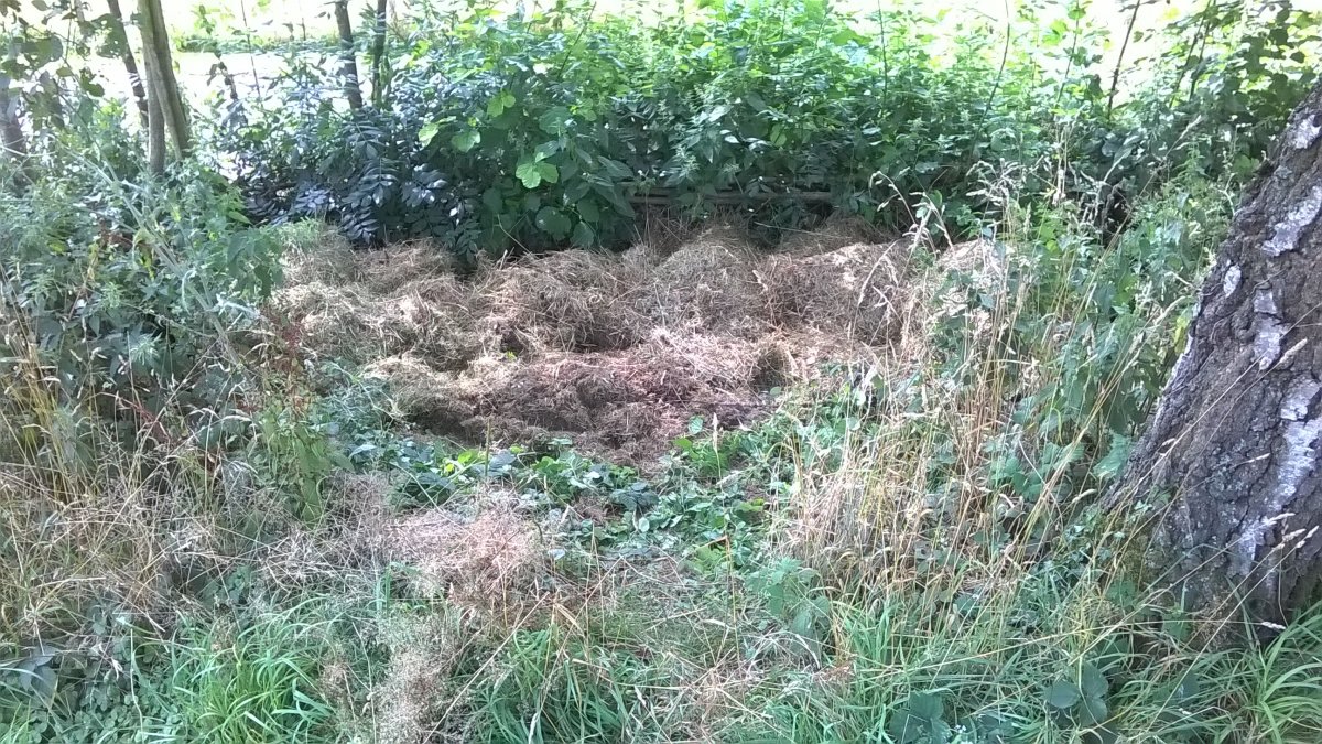

Job jobbed .... full bag .. and a couple of shovelfuls to finish off the far end

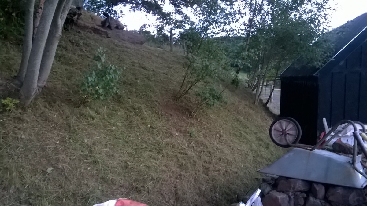

then I had to finish off strimming the bits of bank that she couldn't 'cope with' ('bout a quarter of it :( ) after I'd parked everything up and put the rest away
she loves knocking it down, (when the going's easy) ...... but hates the clean up operation :( raked and cleared 13 barrows of the stuff today ...
and trekked 'em down the drive to where the dead grass gets laid to rest ......
does look better for it ...... usually do it twice a year and let it grow between, but it's always 'an effort' and might be worth doing more regularly to cut down on the grief.
will soon green up with a bit of moisture ....... which looks like we'll get tonight ..... and tomorrow, big time :cry:

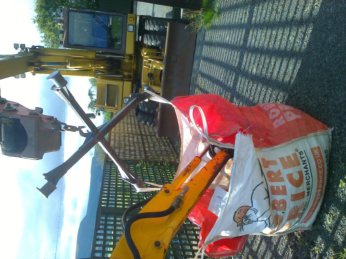

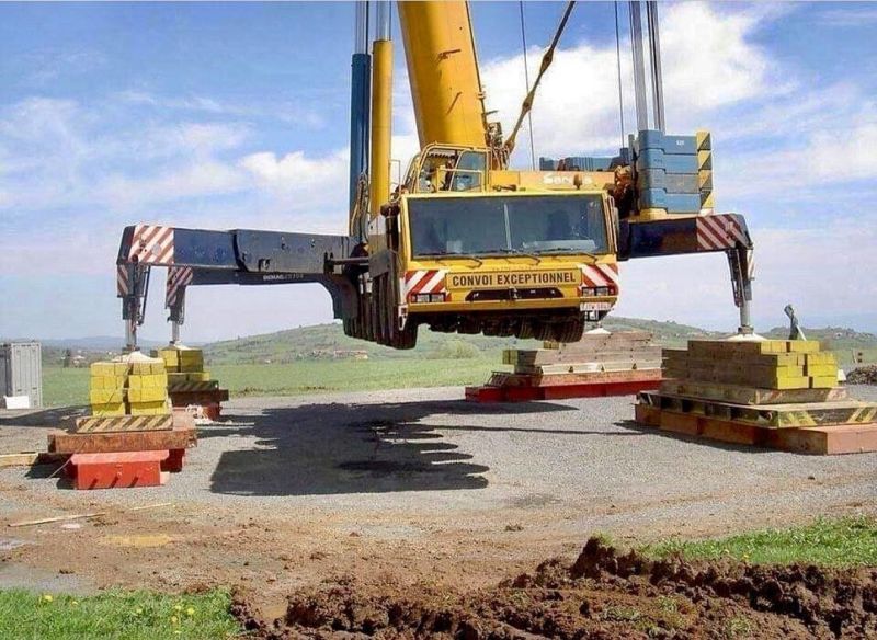

obviously not got enough height ...... 'kin drastic method of getting another 10ft of reach :oops::oops:
500 tonner BTLs, superlift and luffing fly rigged ..... must be going north of 200++ t sat on those 4 cylinders :oops::oops::oops:
Thinking that...not impossible for one to let go? Be a sudden descent 😳

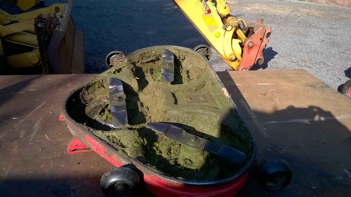

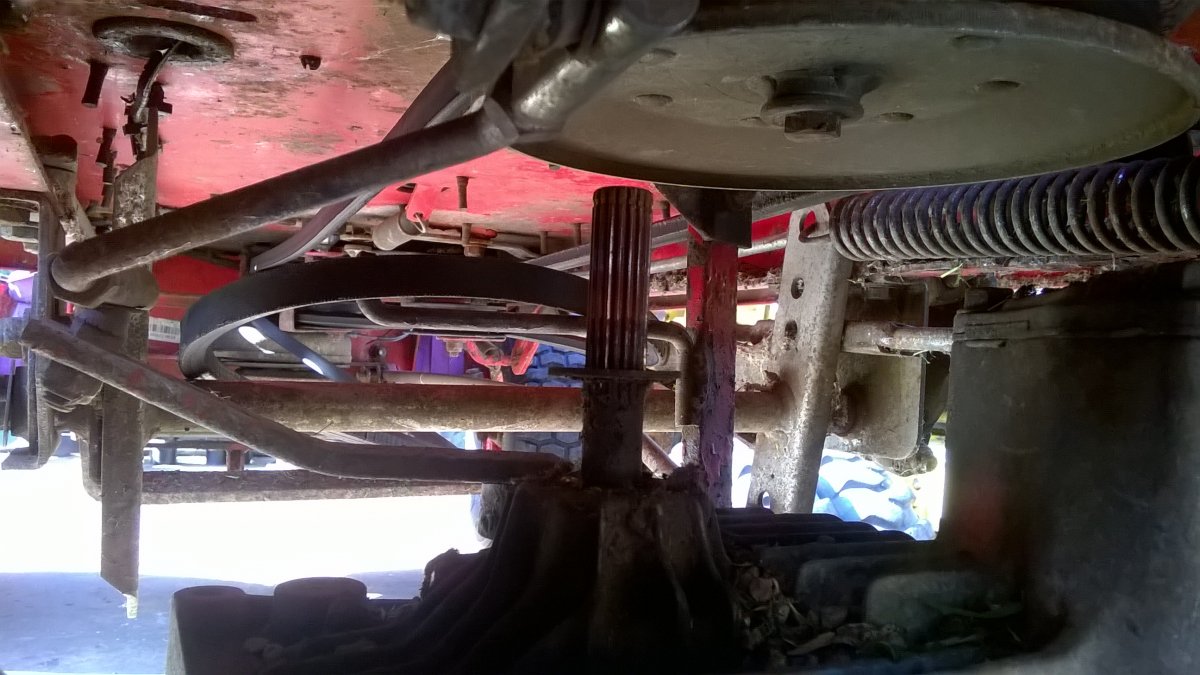

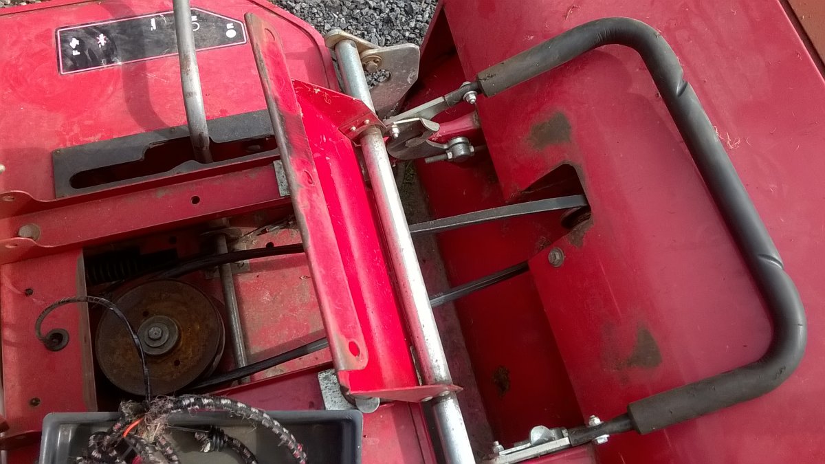

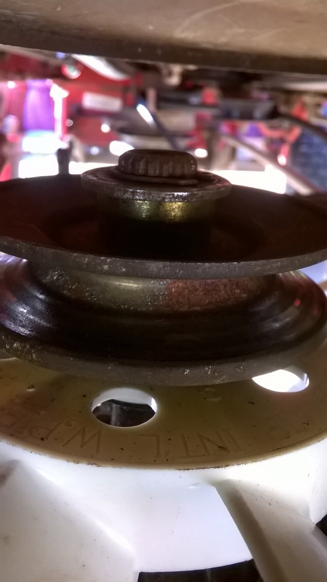

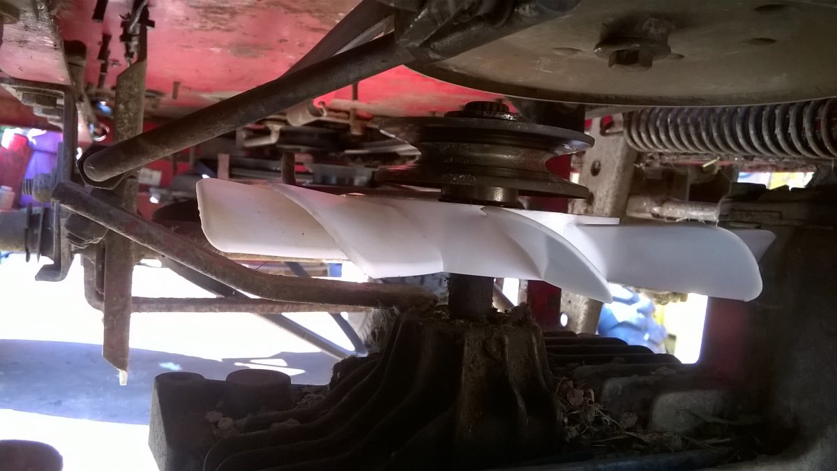

been yet more bitty days and lotsa 'Clara minding', so've only managed to do odds an' sods in spare time .... got all the green stuff massacred yet again Sunday after she'd gone home and then thought I ought to try and fit the new fan on the Countax, tha't been sat a while .... had to get the sweeper off first, which isn't a bad op. ... belt can be a bit of a bugger
WP_20210822_15_51_09_Pro.jpg but it separates easy enough after .... WP_20210822_15_54_54_Pro.jpg .. tried to get at the offending article from on the floor, but such an awkward position i gave up and stuck it on the bench WP_20210822_16_32_30_Pro.jpg the gap between the two drive pulleys is barely enough to get the one off and having a circlip holding it and the fan on was not very helpful WP_20210822_16_43_47_Pro.jpg .. eventually managed to get the clip, pulley and fan hub off, but had to loosen the axle mounts off on one side to get me enough extra clearance to just pop 'em off WP_20210822_16_43_59_Pro.jpg new fan ...WP_20210822_16_43_54_Pro.jpg
and on in place WP_20210822_17_03_46_Pro.jpg getting said circlip back on after re-shaping it was summat else ....
WP_20210822_17_03_53_Pro.jpg only way to check it was fully home and be sure the finger tips weren't missing anything was the camera on the phone WP_20210822_17_04_30_Pro.jpg that or take the whole back end off :( which i really wasn't keen on

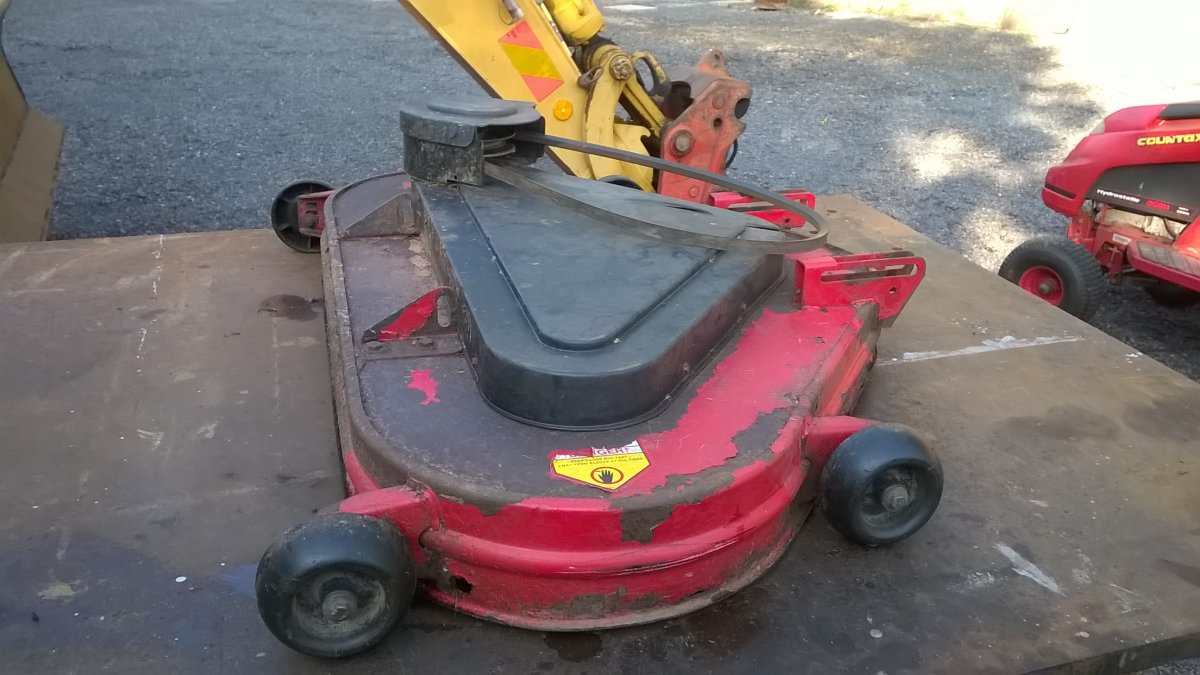

having taken the deck off it was a no brainer to give it one of its regular cleans ... it was in need WP_20210822_17_33_27_Pro.jpg :oops:
WP_20210822_18_09_45_Pro.jpg looking better and liberally oiled to try to make it harder for the green shite to adhere to it ... then stick it all back together WP_20210822_18_10_10_Pro.jpgWP_20210822_18_10_14_Pro.jpg and job done for a while again .... still none the wiser WTF the fan shed its blades in the first place :unsure:o_O

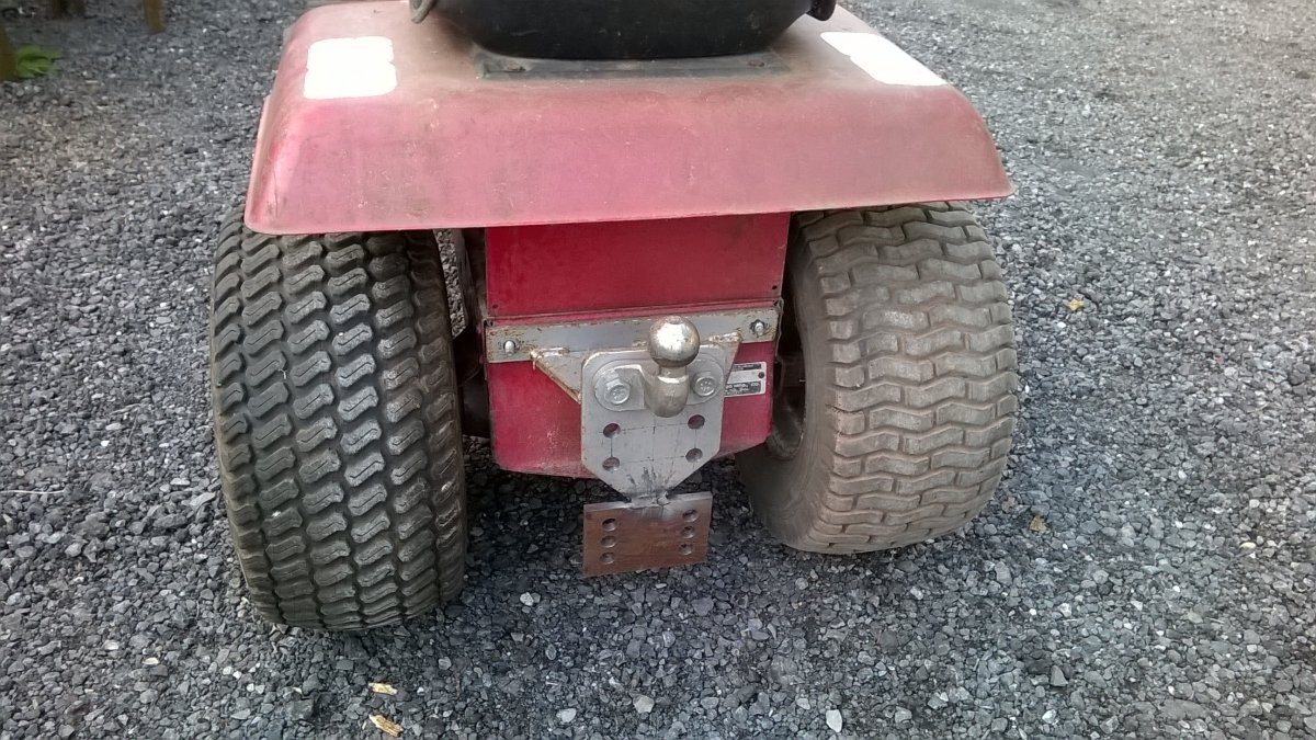

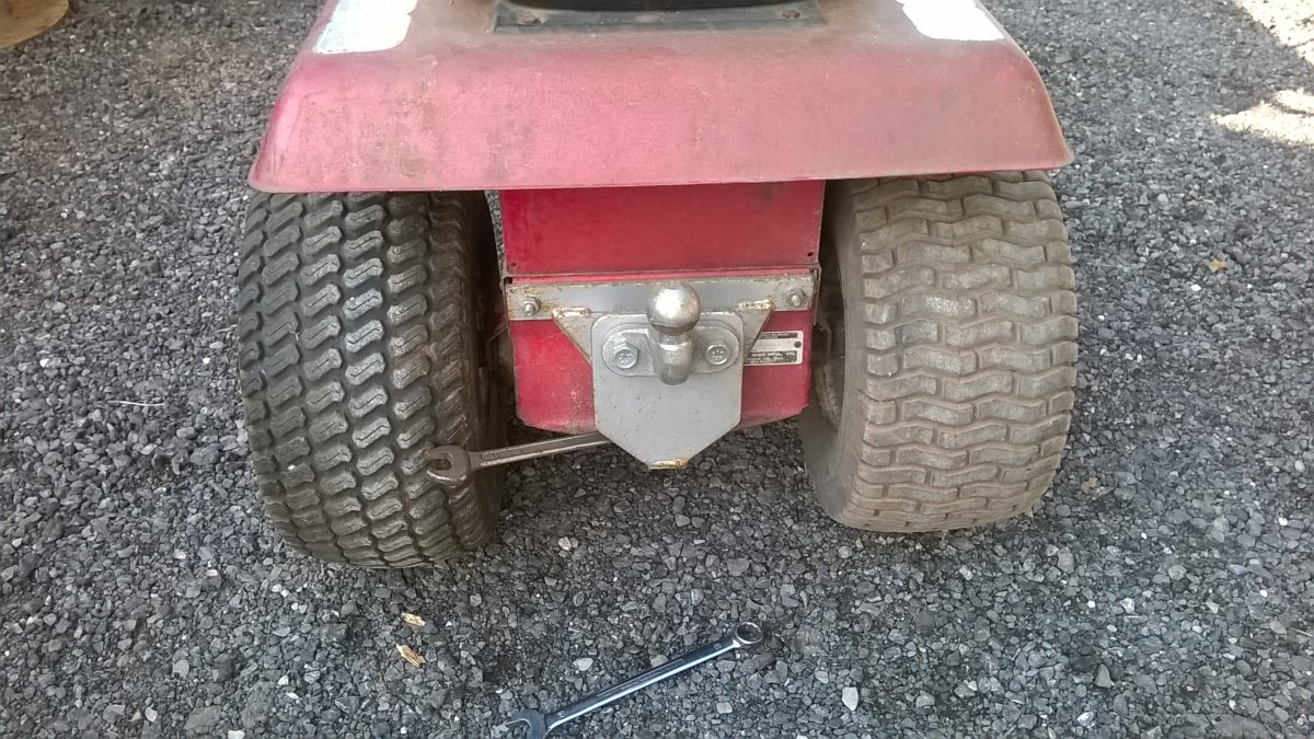

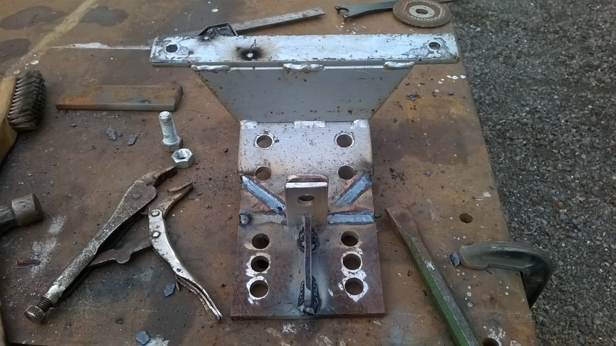

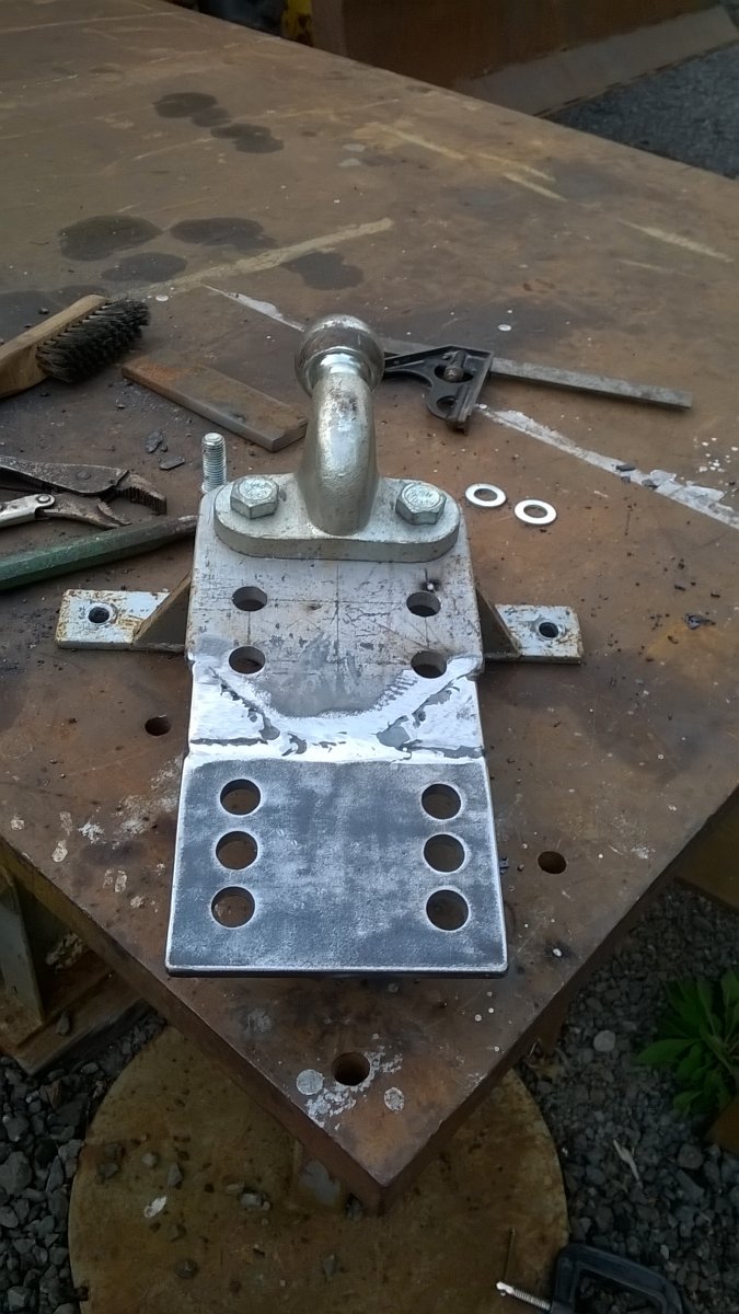

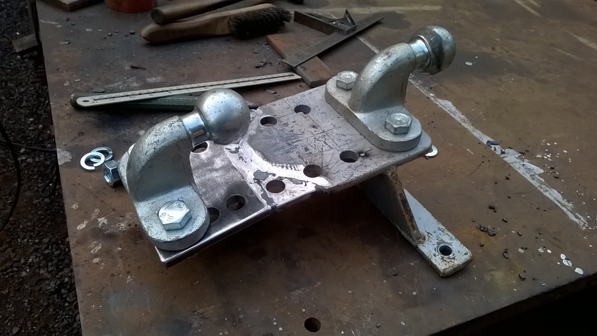

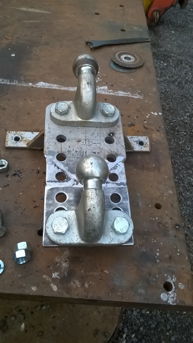

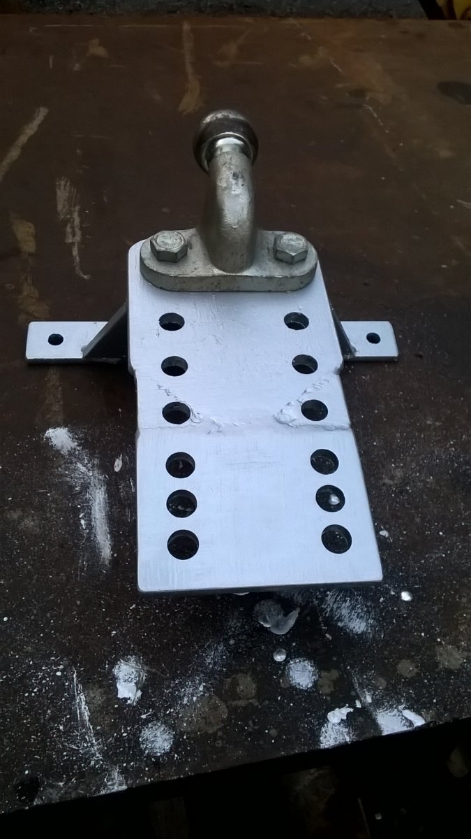

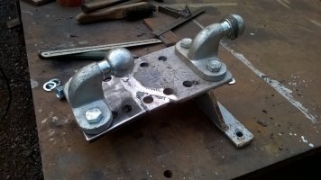

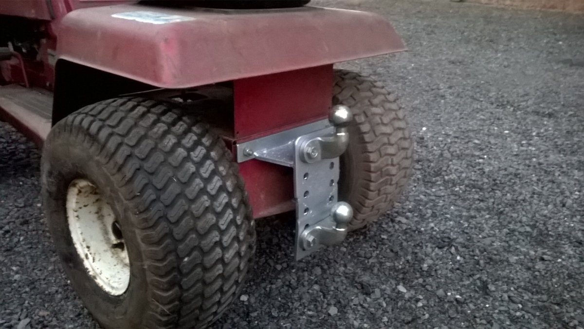

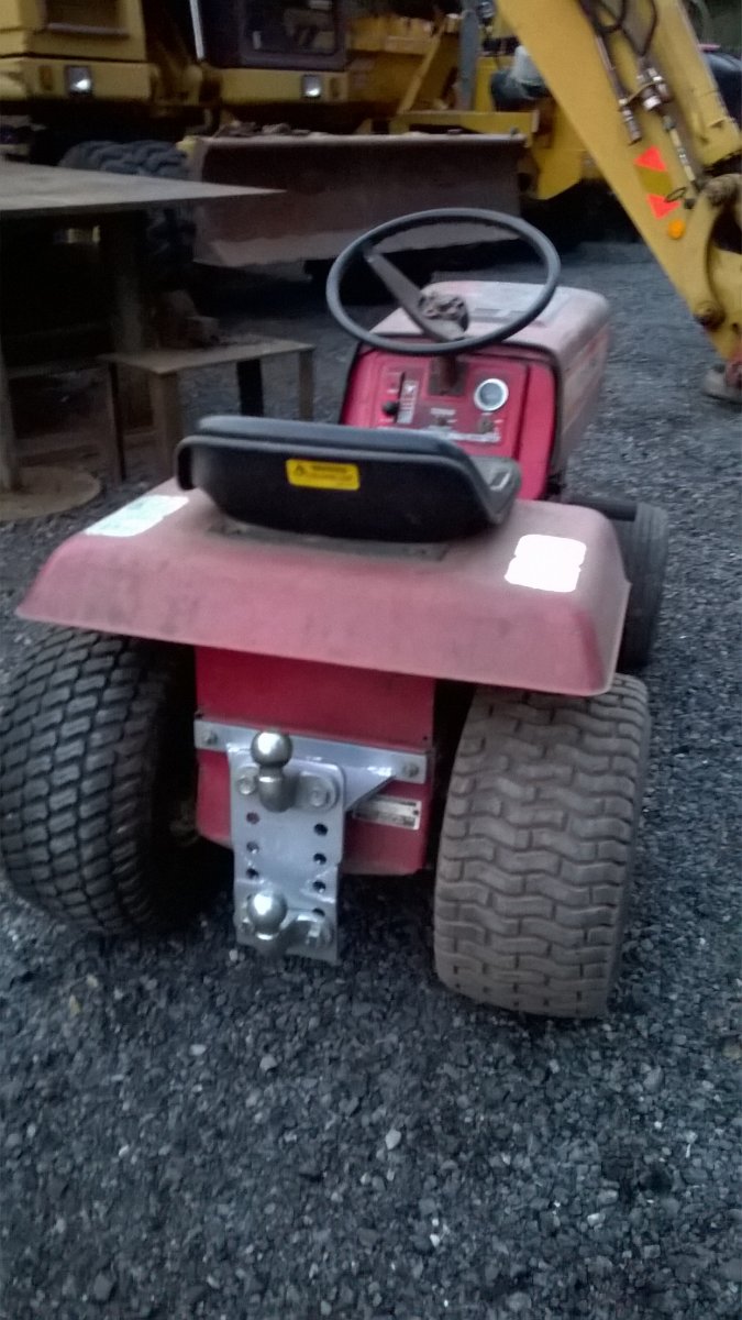

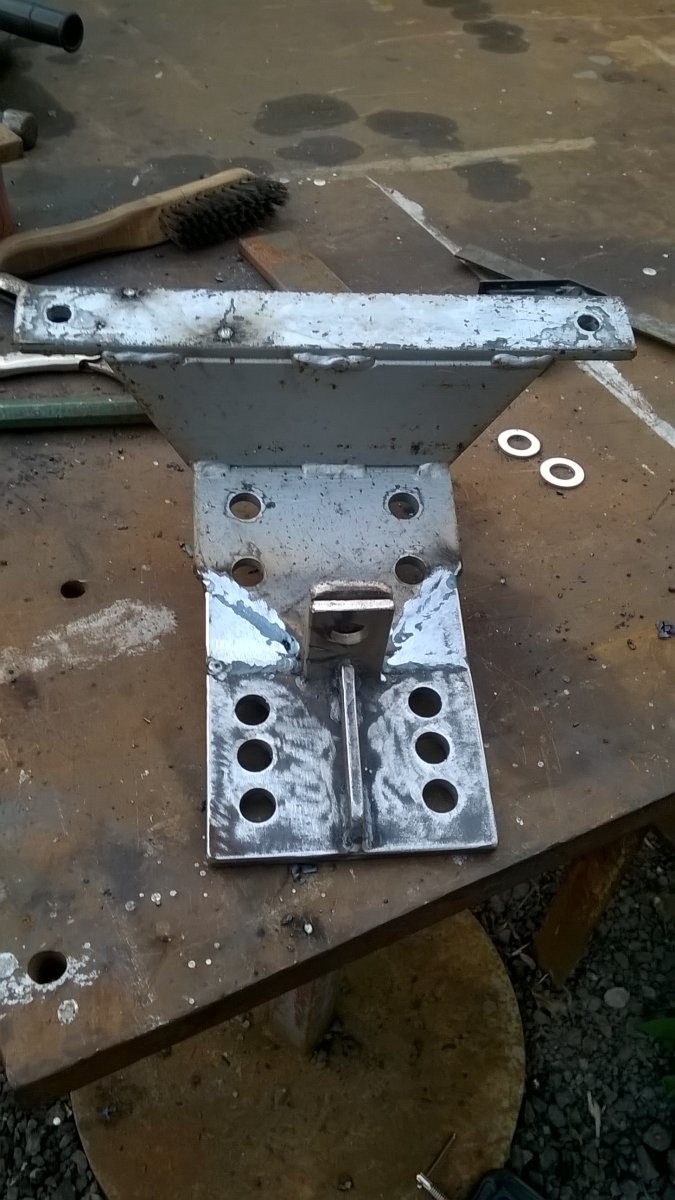

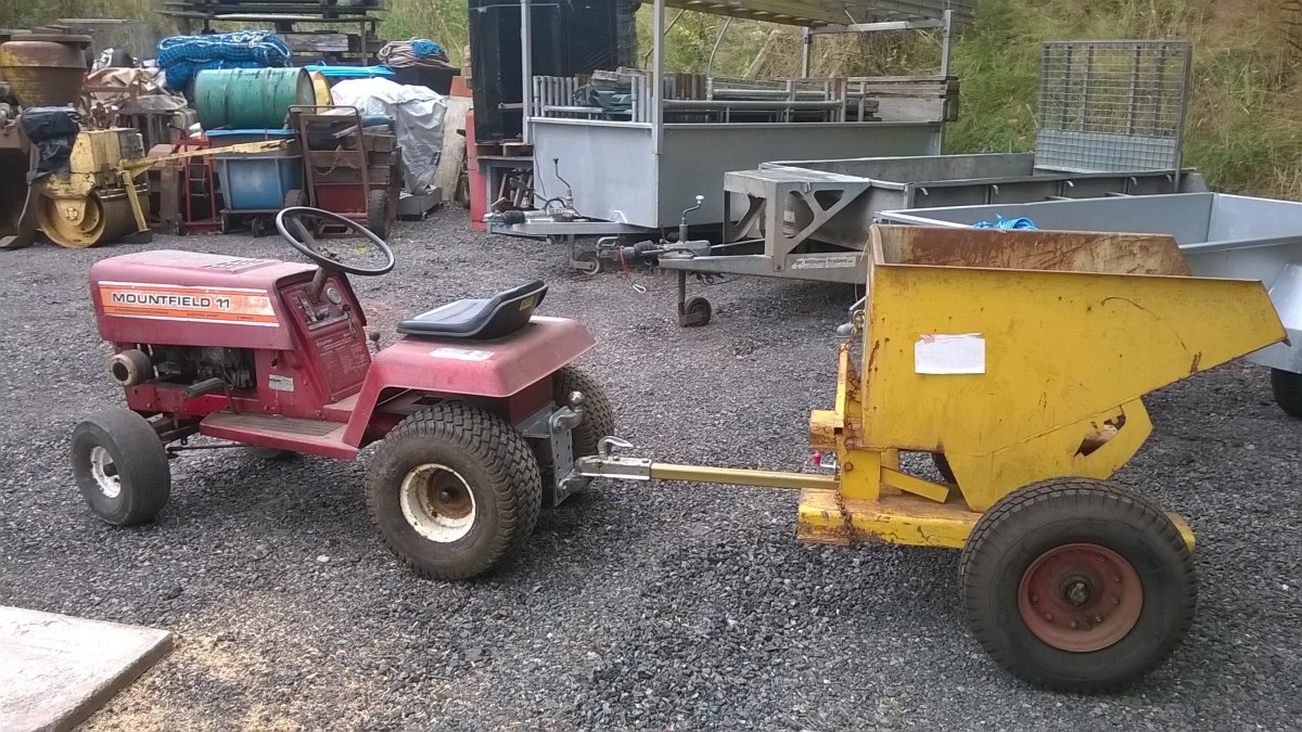

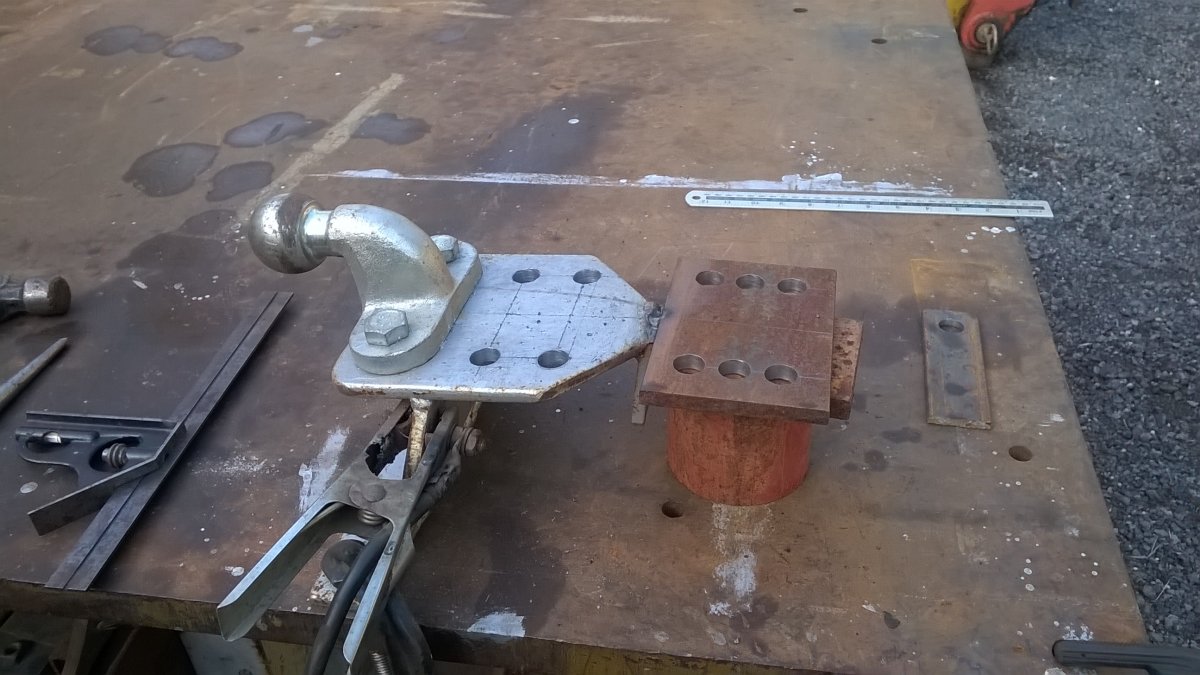

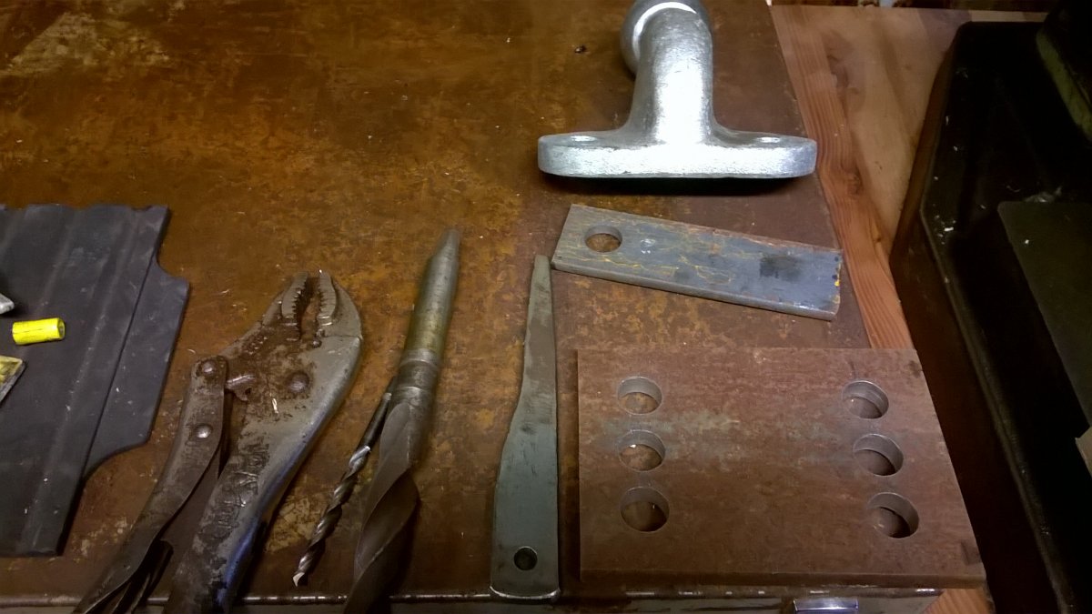

knocked this up a few nights ago from a couple of suitable bits WP_20210821_17_54_56_Pro.jpg and stitched it in place ..
before setting to, consolidating it

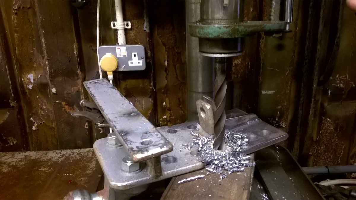

WP_20210823_19_16_24_Pro.jpg WP_20210823_19_29_19_Pro.jpgWP_20210823_19_29_29_Pro.jpg and a bit of fettling plus a couple of
extra holes WP_20210823_19_40_30_Pro.jpgWP_20210823_19_47_58_Pro.jpgWP_20210823_19_48_04_Pro.jpg

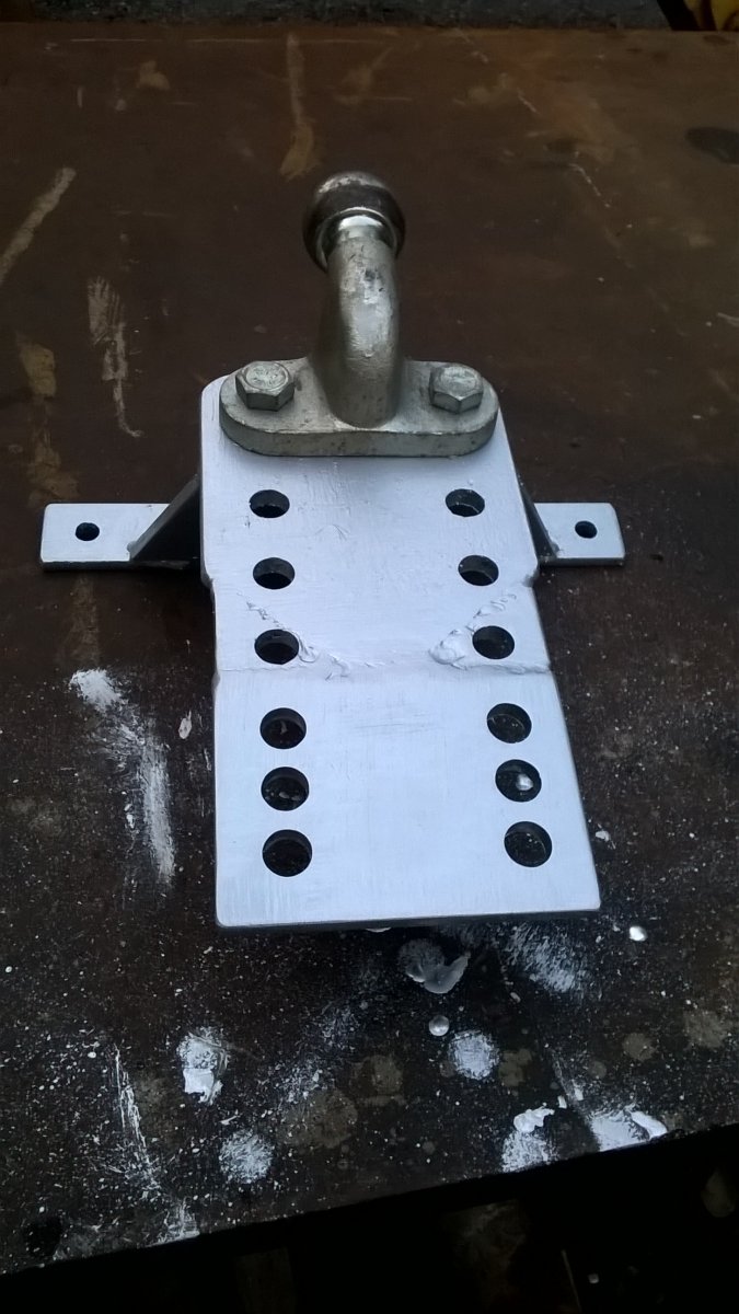

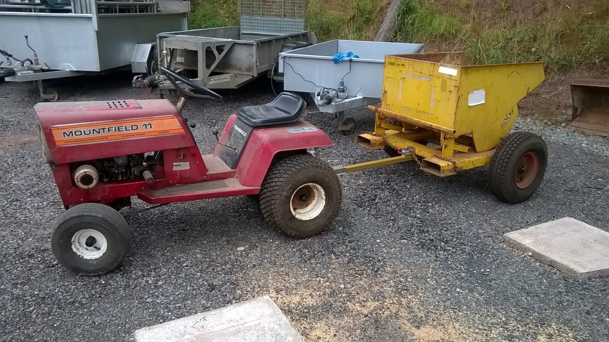

followed by a coat of shiny stuff WP_20210823_20_15_54_Pro.jpg the original coat'd been on there at least 10 years .... job did and now have a coupling height to suit the little skip trailer ...... or anything else at varying heights of a fair selection ..... might as well make it as flexi as possible, while I'm at it ;)
and yes they are deliberately at differing angles (y):giggle:

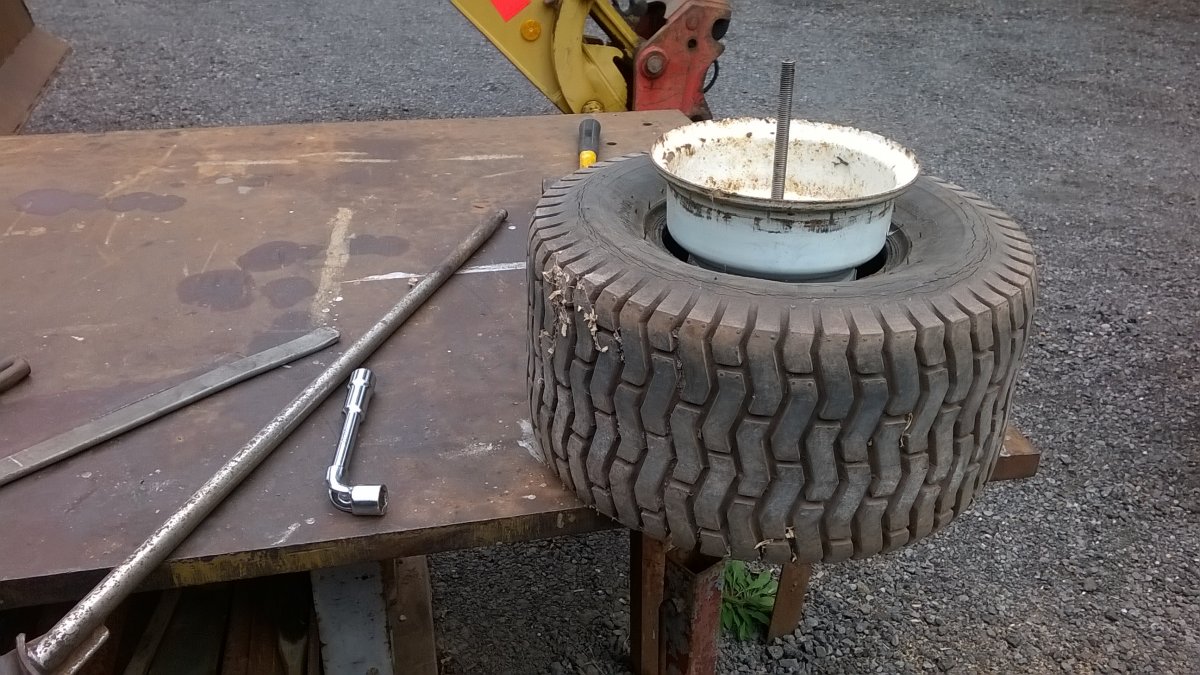

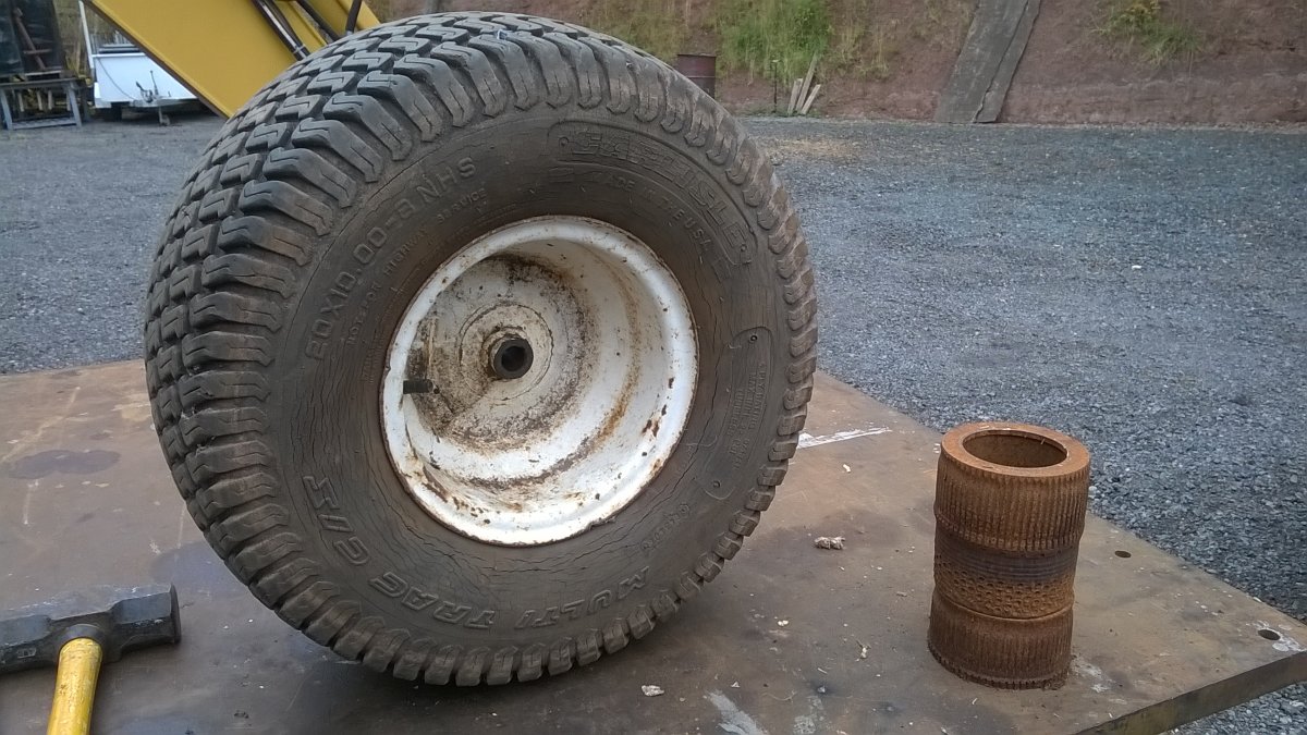

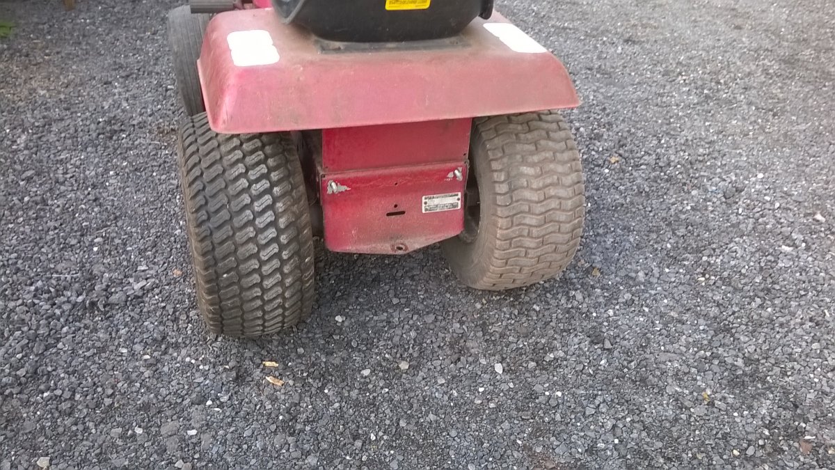

and yes I have two differing size wheels on there ATM .... been waiting for a tube to turn up for the butty to the LH wheel ..... won't hold air without one ....... one's 20x10.00-8 ... t'other is 18x9.50-8 .... oddly enough I have another pair just like these :rolleyes::unsure:o_O :ROFLMAO::ROFLMAO:
yesterday was equally disrupted ... hamster juice saw off a fair part of the morning, followed by a supermarket hit as we were in need ... so didn't get to do much 'til quite late .. wheeled this little fella out View attachment 27132 for some hitch alterations .. currently set at the std 16" for conventional trailer hitches ... been on there a long time ... View attachment 27133, but came off sweet as ...
knocked this up a few nights ago from a couple of suitable bits View attachment 27146 and stitched it in place ..
View attachment 27135 for a trial fit View attachment 27136
View attachment 27137 View attachment 27138View attachment 27139 and a bit of fettling plus a couple of
extra holes View attachment 27140View attachment 27142View attachment 27143
followed by a coat of shiny stuff View attachment 27144 the original coat'd been on there at least 10 years .... job did and now have a coupling height to suit the little skip trailer ...... or anything else at varying heights of a fair selection ..... might as well make it as flexi as possible, while I'm at it ;)
View attachment 27145View attachment 27147

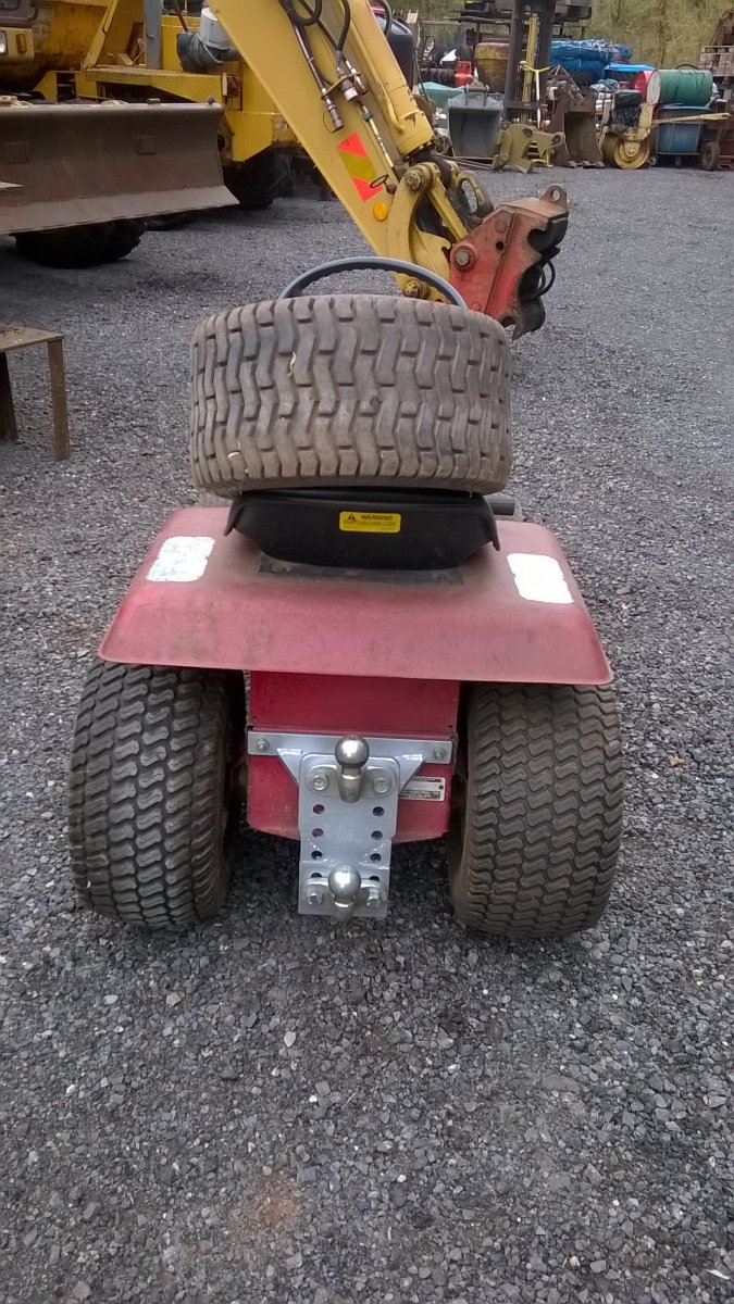

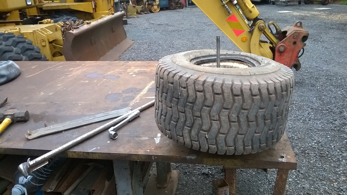

Tube turned up yesterday ... so swapped the tyre this morning
WP_20210825_12_51_59_Pro.jpg WP_20210825_12_55_07_Pro.jpg WP_20210825_13_05_00_Pro.jpg
and sussed the lil' skip trailer for a fit

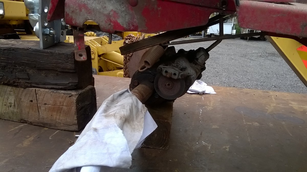

and discovered an issue with the brakes ..... which needed sorting .... bolt missing from the brake caliper ?? :unsure: which was damned near inaccessible .. so ...... enter lil' Jake
thought I'd need the bucket to get the height .. but could've gotten away with out it :rolleyes: .... picked it well
back axle off to get at the bloody caliper :mad:
**** knows how the bolt could've escaped ..... but it had :oops::( ........ 1-1/4" x 1/4" Whit took a bit of finding amongst me odds an' sods box ... but found one and got it back together :giggle:.... then juggled it back in ..
with a little help from 'the boss' on one end .... just could not get the bu**er on me own

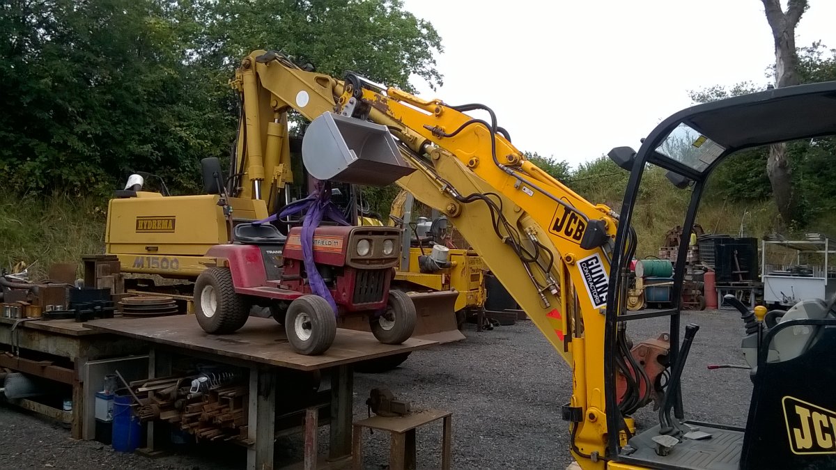

all back together, brake adjusted up and back on the floor for a 'test drive' ..... without the bucket for extra height .. no prob.s .... Lil' fella makes a decent bench crane

Hehe, just a thought, couldn't you have just cranked the arm for the trailer to fit the tractor?
absolutely ......... (y):giggle:
but if I did want to attach it to the lil' fella's blade at anytime, it'd be 'dragging its knuckles' :LOL: ....
's why I made the bar as long as it is ;) ... collision avoidance :sneaky::giggle:
plan ahead ...... :)(y)
will deffo be looking at 'how' it could be done, for the odd occasional use perhaps ?? :unsure:;)

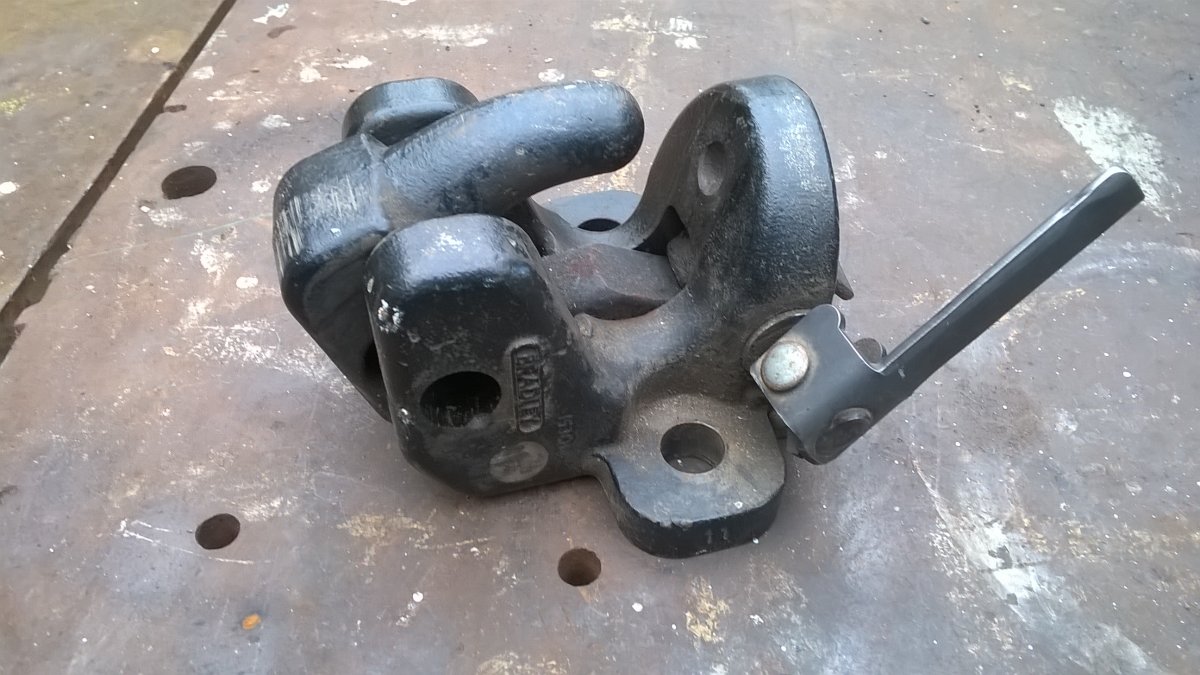

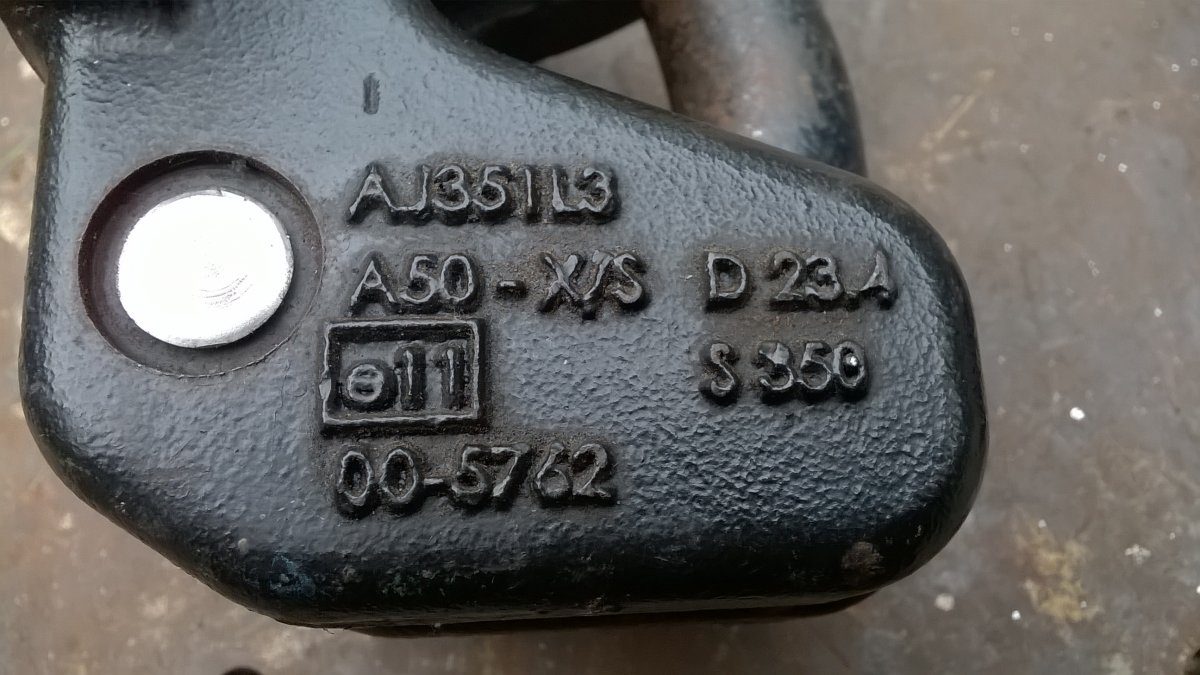

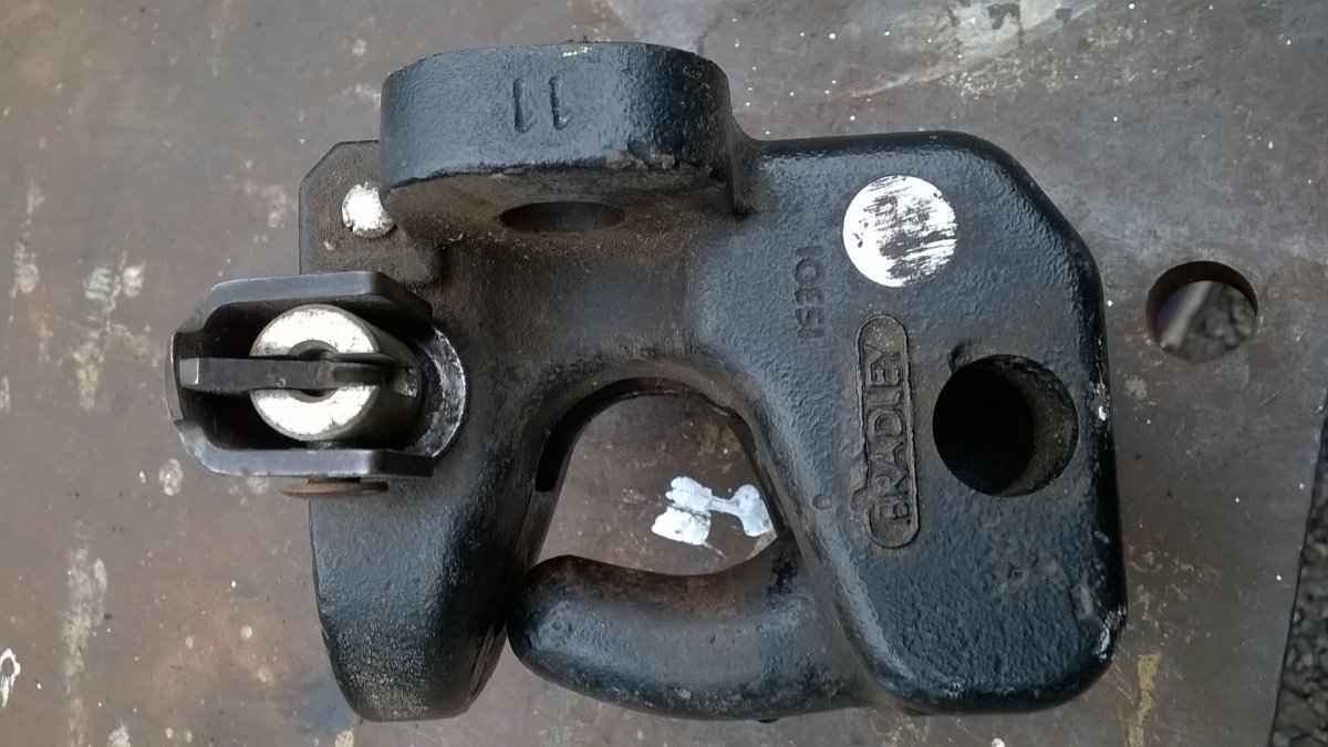

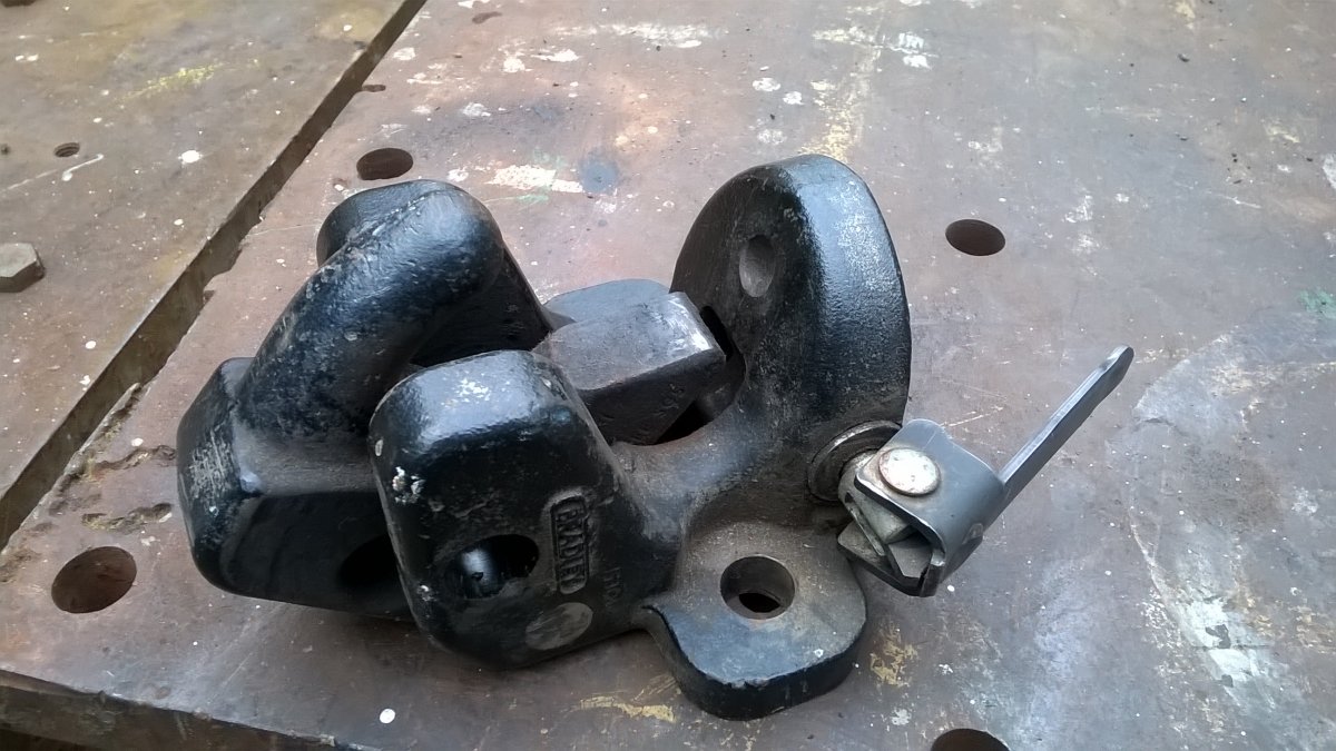

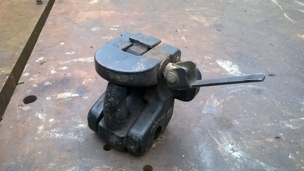

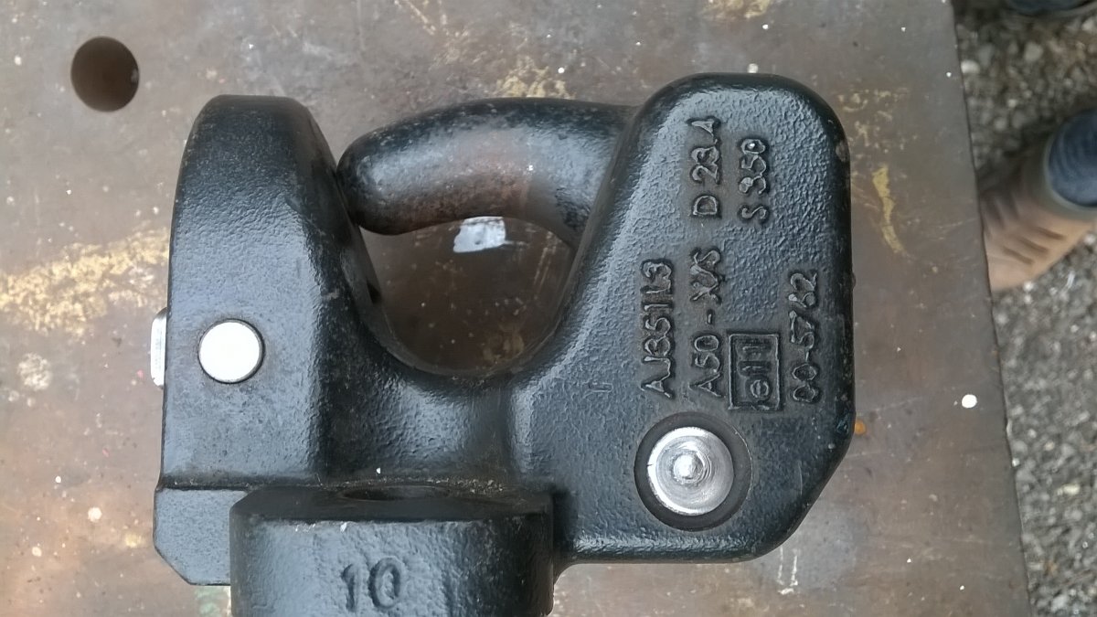

never seen one of these before :unsure: but looked interesting/ought to be had for a tenner ..... auto latching ring coupling by Bradley ... anyone else ever encountered one
WP_20210827_18_24_54_Pro.jpg.WP_20210827_18_25_14_Pro.jpg.WP_20210827_18_25_38_Pro.jpg.WP_20210827_18_25_58_Pro.jpg
.WP_20210827_18_27_55_Pro.jpg.WP_20210827_18_28_09_Pro.jpg.
open latch and reverse against the eye and it auto closes .. you then double lock it manually .... std 3.5"/90mm ctrs and I'd guess 3.5t cap.
In all my years of tow bar/trailer building I have never see one of these before .. a very clever design
just googled it and appears to be ..... out of stock
Bradley Trailer Auto Jaw Without Ball AJ35 L2 3500kg​
bet they ain't a tenner from Bradleys :oops::LOL:
I think I’ve seen them on utilities vans, where they have a big rear step fitted. They fit these underneath.
