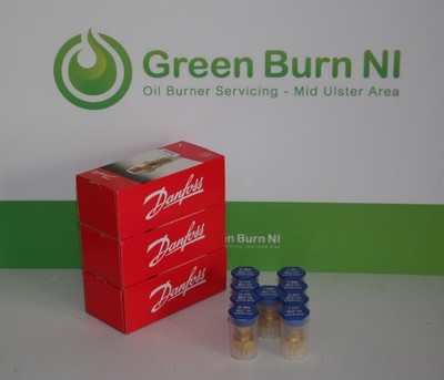

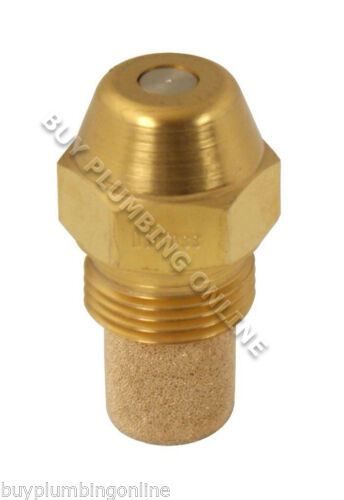

I’ve chucked 50l of red in mine to tide me over for a couple of days before now - seems to run fine but the exhaust stinks!!!
Yeah it has a legionella program every so often the immersion fires up think monthly?🤔
You'll be surprised how often immersion is on tbh its the only way ground/air source systems can respond fast that's the let down with them for me, brilliant for underfloor but but crap for hot water.
need a different nozzle to run red, but otherwise it'd run fine .... easily available and about a fiver for nozzles .... doesn't burn fully with a kero nozzle
