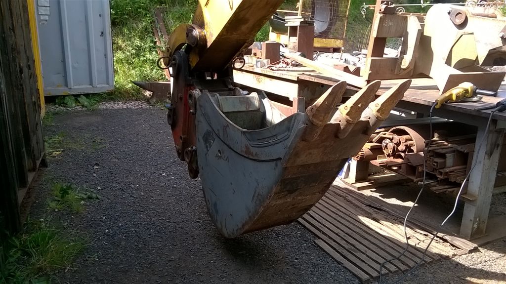

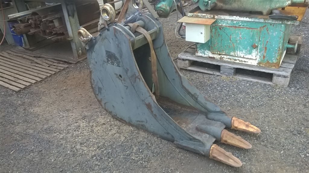

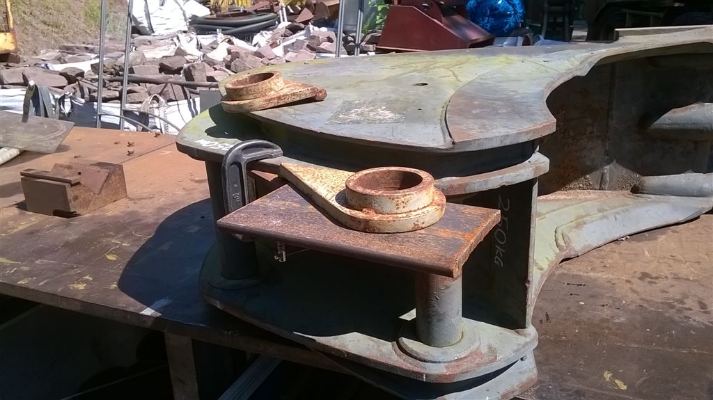

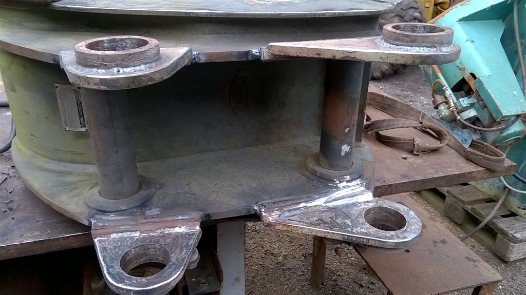

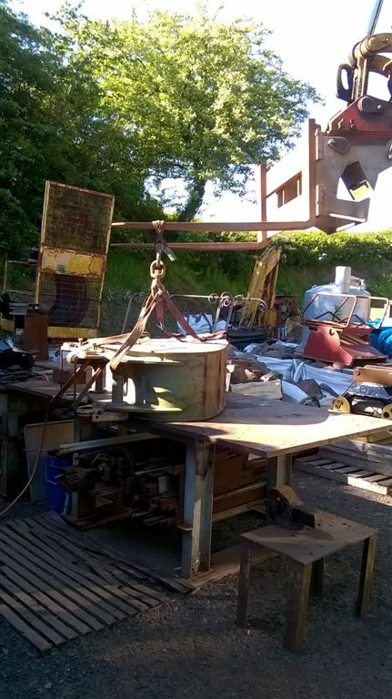

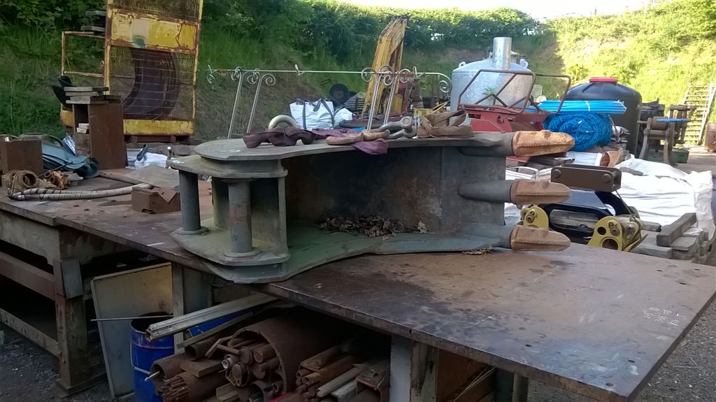

Miller Scoop I had off Rory's mate Roy a while ago .... been pondering a re-cheek for it for a while and had come up with a viable proposition the other evening, incorporating some bits I'd already got made up, which i'd used on the Hill, when I initially had it under the VA-r, some time ago .....
set up to flip it ..
handy 27mm holes in either side of it ..... (y):cool:
and over it went :giggle: ...... just in time 'fore tea got called ....
Va-r got dropped off in the corner, 'fore I picked the scoop .....
(looking a lot cleaner and tidier than it was, poor thing)
and stuck the forks on, 'cos I was by 'em, dropping the VA-r .... they could do with a spruce up too, but ought to fit the bosses I made for them months ago, before I get around to a clean off and re-paint ... that'll keep me 'gainfully employed, for an hour or two :);)
Mocked up the fit for the 70mm pick ups on the scoop after tea .... looking good (y)...... bit of fab.-ing coming up for all you fab.-starved individuals, in need of a fix :ROFLMAO::ROFLMAO:
watch this space, as they say :unsure:

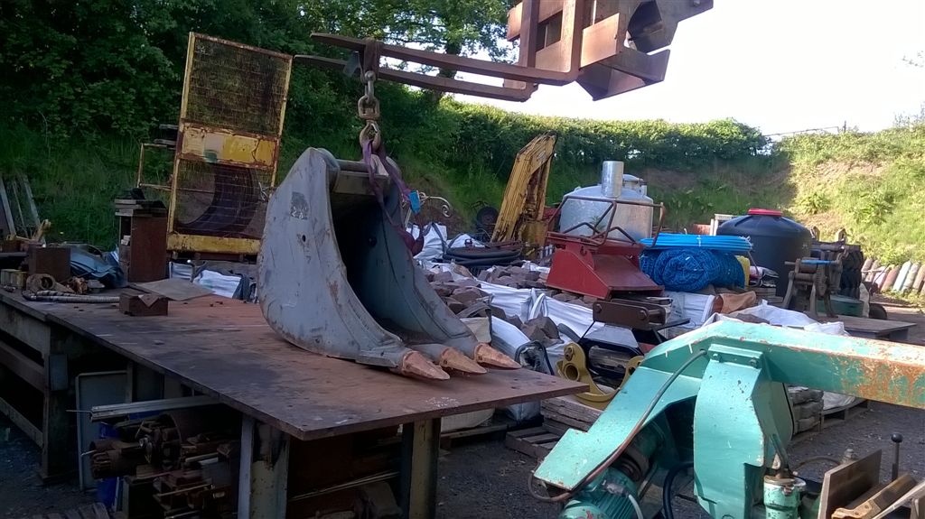

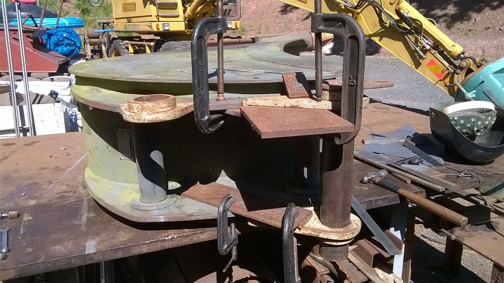

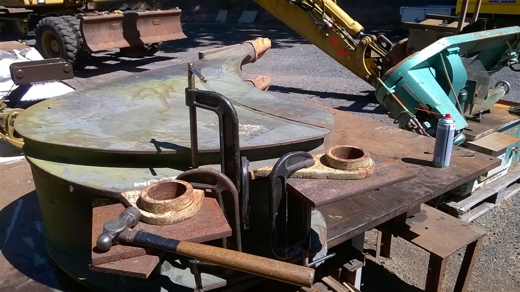

had these sat about which I'd made up for the Hill under the VA-r soooooome time ago .... 'fore it got fitted more permanently ..
and had been pondering whether I could utilise 'em for the Scoop I had off Roy
the off set on them worked out just about right to get me out to my required width for the Miller on the 'Drema's dipper
took a bit of sussing initially ... but worked out the best spot for 'em

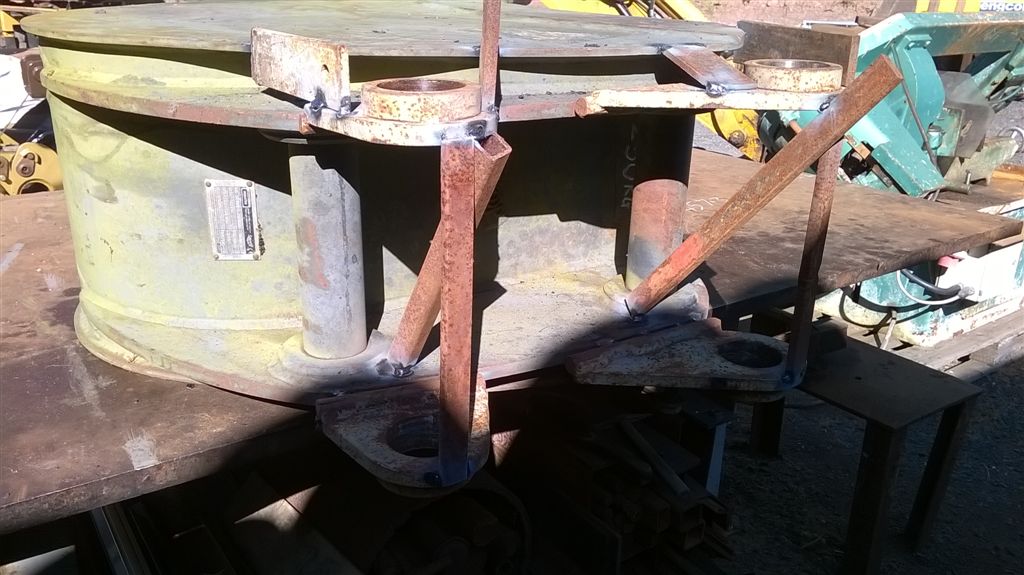

setting up the one side wasn't so bad once i'd decided how ..
getting 'tother side right was a bit more interesting.... liberated a pair of pins from me B20 adapter to get things lined up
and trusted that Miller had got their pins right, so paralleled off them ... they looked and measured as pretty fair
braced the first pair parallel with the existing cheeks
and set up the fourth eye
a LOT of careful measuring went into getting those pins right ... 400 centres, parallel and square to each other - parallel to the originals, etc. and that the pins'd slip in/out nicely .... then braced them to each other and the bucket

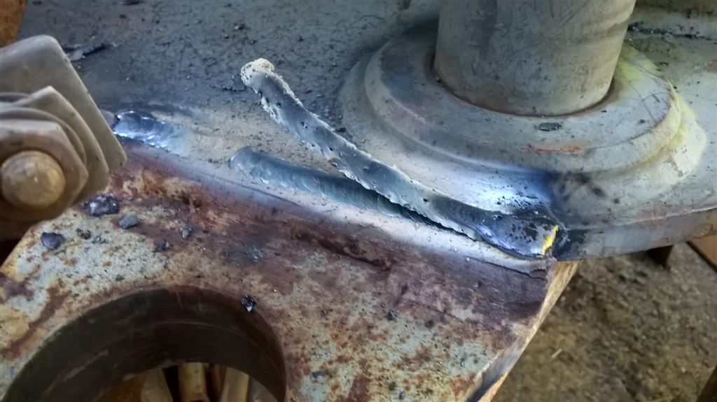

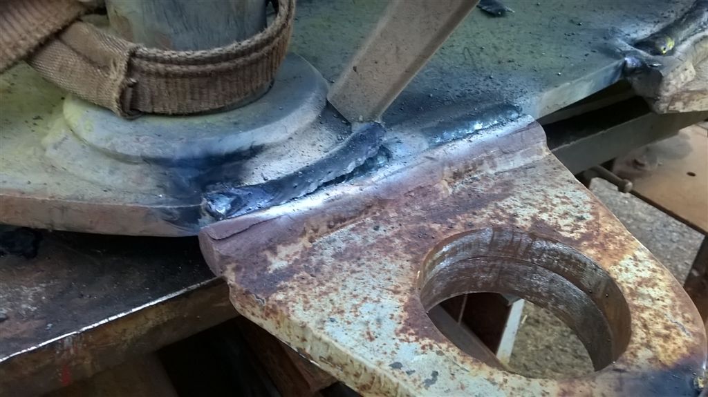

before setting about them with the Caddy ...... would've loved to have mig-ed 'em, but been a real blowy day here today ... good job or it'd have been baking ... been sweating cobs all day as it was ... been 27C here :oops:o_O
few decent stitches ... then rolled it
matched the stitches .... and rolled it
you get the idea ....... I rolled this a lot
and put a lot of this down
can see why it got seriously braced ...
anyway ...... it was all straight and true after I'd had me tea and it'd cooled down
so ... picked it down off the bench .......
knocked a few of the braces out with the cold chisel ....
and slid those big 70s into their holes

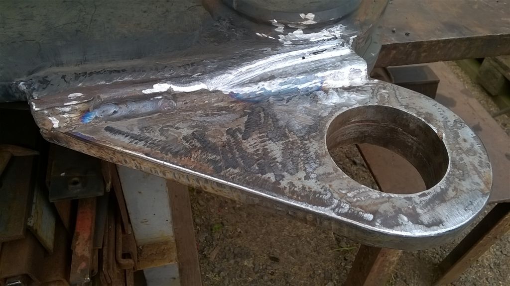

went in sweet as pie .. (y):giggle: .... i'll knock out the rest of the braces tomorrow and fettle off all the tacks holding 'em ..... then see how it looks in the Miller ...... wish I'd had this for rock ripping, when I was tearing out the various layers I took out leveling me patch .... it'd have been the kiddy
might add a few gussets, but I don't really think they'll be necessary ...... those cheeks are NOT coming off .......... without the gas axe or a thin disc.
easy enough to return this to it's originality if required ... it's a VERY nicely made bucket ... can see why Miller charge for 'em :rolleyes::unsure:

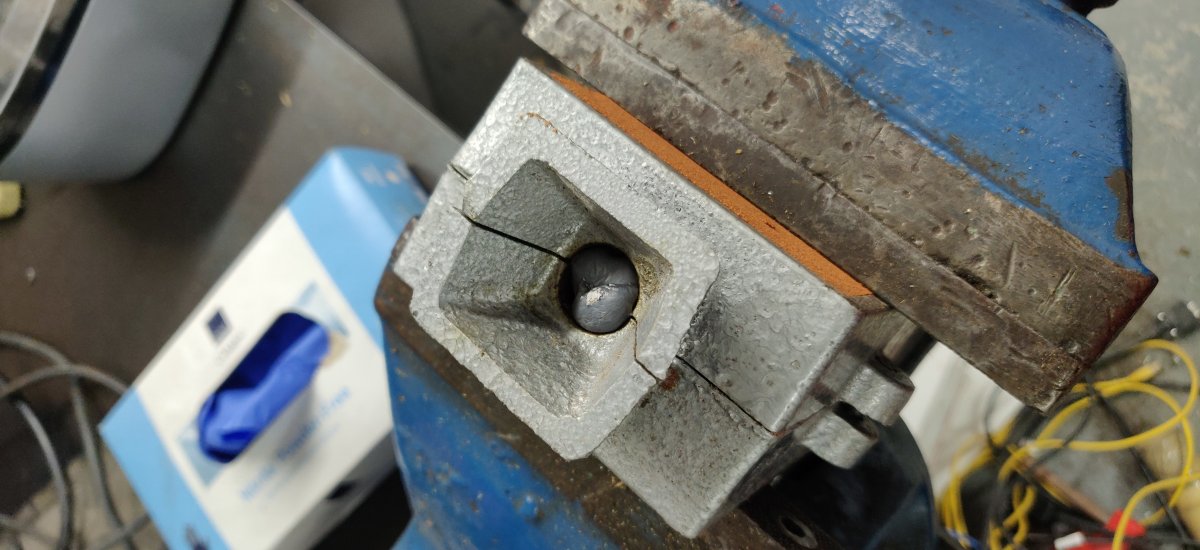

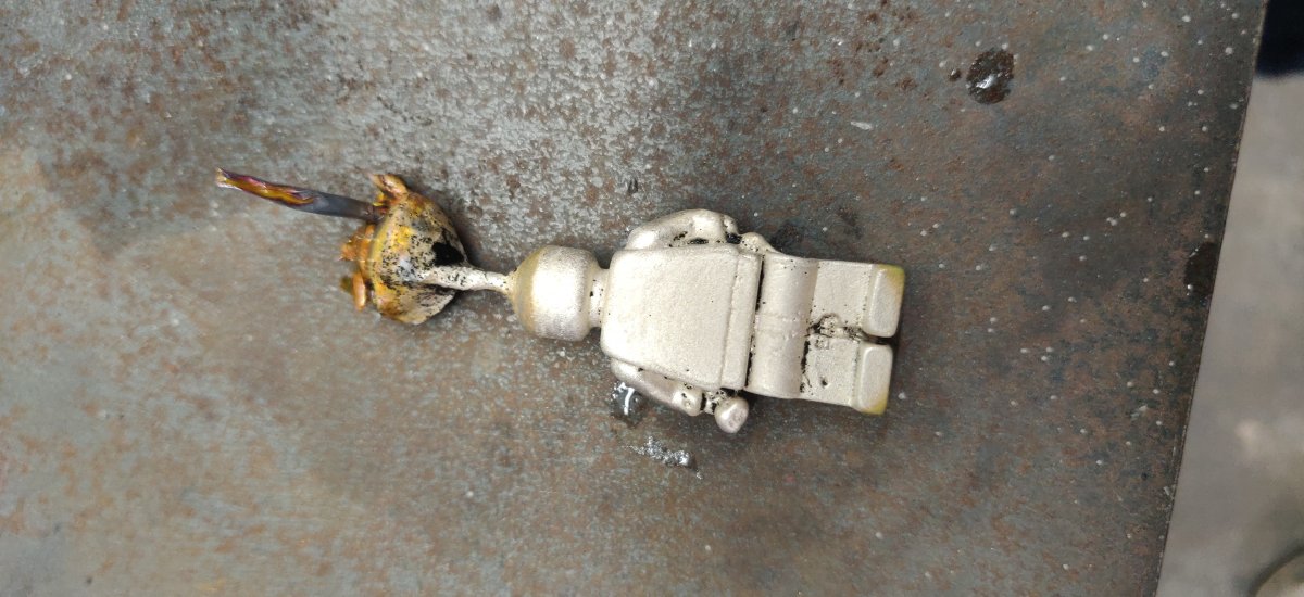

Was tinkering again this evening myself - made this lovely Lego head charm for Helen's bracelet.
Also tried to cast a minifig for a necklace but struggling to get it to flow right in the mould! Think I need more silver tbh.
might benefit from a de-gassing tablet (or a piece of one at least) ... and ... an air way from his hands scraped into the sand back to the upper main body, to allow air out of the 'pocket' ... you'll just have to cut the small sprue it creates, off

Yep. That's a good point, I could easily add that on its back. May have to experiment another evening.
there is an art to venting moulds, to ensure no gassing issues ... got to think like an air bubble :giggle::giggle:

Yep, I used a vent on the ring if I recall, will have a play. Think I just drilled a hole through the sand by hand.

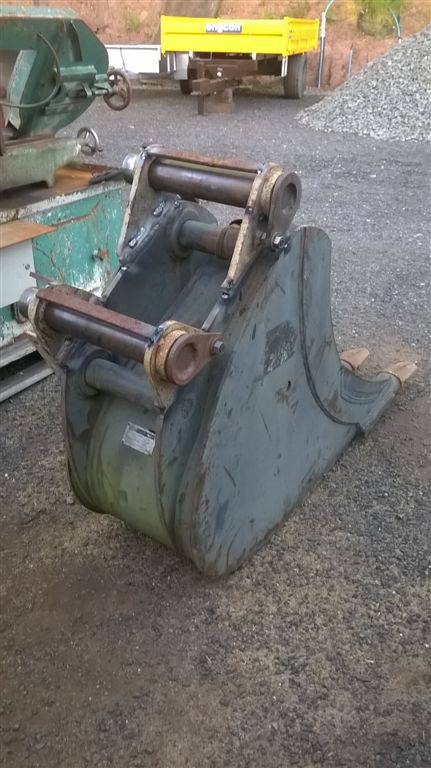

well I had it on the Miller yesterday .....
but only after a bit of tweaking with the Dewalt 5" ...... forgot that those cheeks had never been under the Miller .. they were originally made to pin the Hill to the pin on lugs originally fitted under the VA-r
but I got there with some judicious adjustments ... and a bit of extra welding here and there to make sure ;) and fully secured the bosses whilst I had it back on the bench
The front hook on that hitch is a beast of a thing :oops: ... but as said ... I triumphed (y):giggle::giggle:
