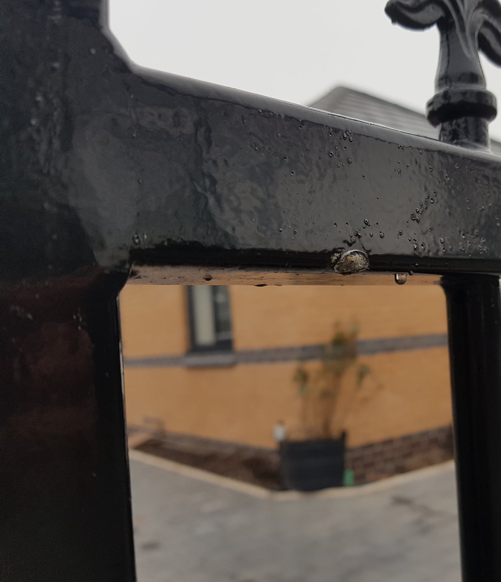

usually the galvers do the powder coat finish too ..... looks to have still been 'spelter' (galv dross) in places, which should have been fettled off before getting powder coated ..... if it was mine ..... it would be rejected as substandard .. end of

I agree, not acceptable an finish! That said, they should of probably mentioned before taking in the job that you won’t get a perfect finish with powder coat over galv.
Worse so is the chips!

That chip is a funny one. The gate came straight from the powder coating place to here, the guy went to fetch it. Is it a chip after paint or is the finish just that piss poor?
I'll have to tell him it needs a good looking at before any dollar is parted with. Is it sortable?

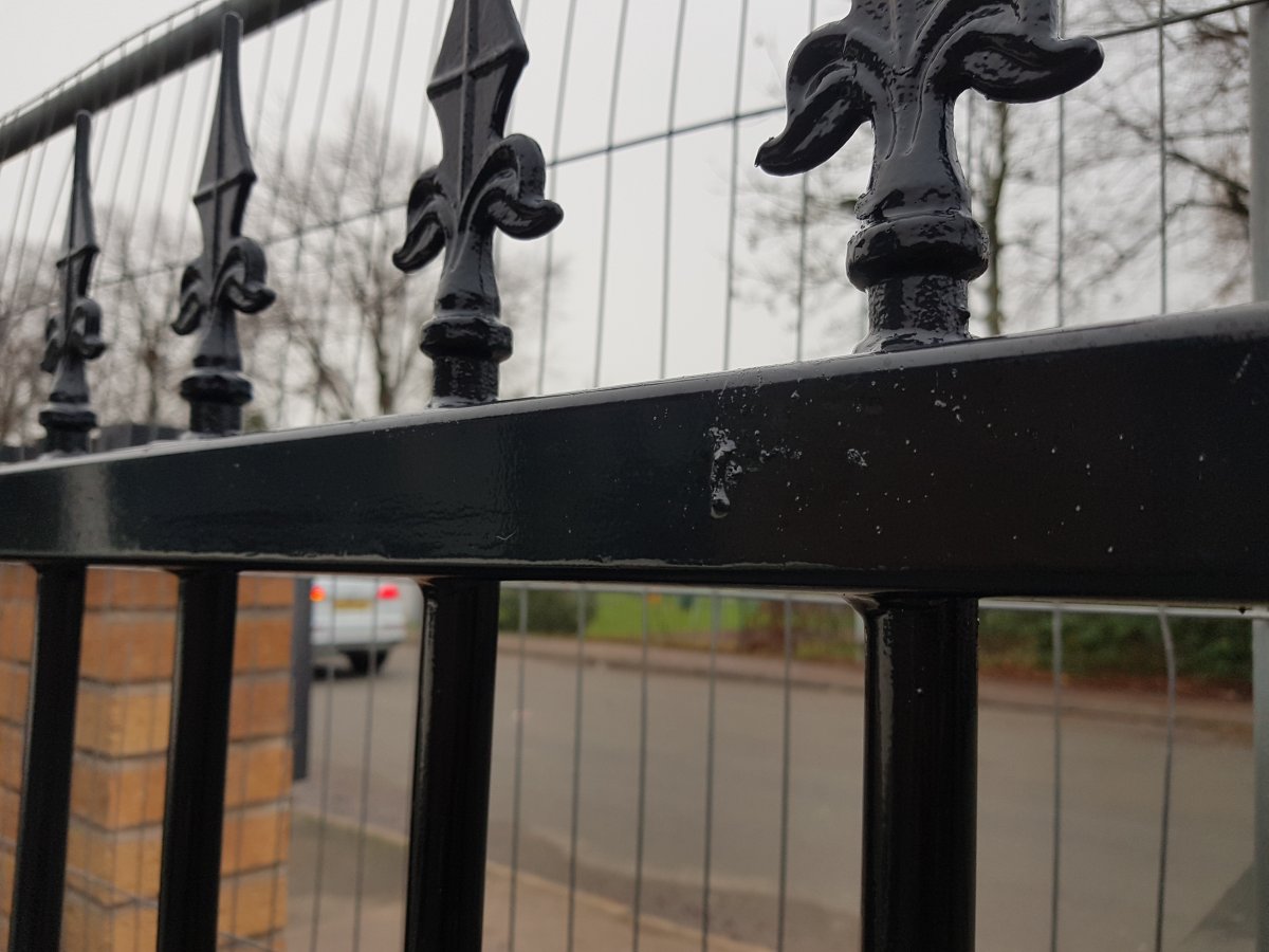

More pics. Same mark on front of gate as above
the 'chip' is almost certainly a lump of spelter, which has come away .. bare steel visible .. so no galv there at all BTLs ... it will forever give problems.
rectifying it all is not going to be an easy fix :(
not good .. hasn't even ground the tube joint welds off tidily in the first place :(:cry: ...
the galvers would be at fault here really, with the surface finish .. as said the galvers and the powder coaters are usually one and the same ... their fettlers have not done their job and neither have the tank guys, allowing spelter to be 'included' in the surface finish .... TBH wants completely re-doing and should be at the galver's / powder coater's expense

Cheers druid for the advice. They're here now cracking on with it. Nothing that can be done about it yet so I'll let them get finished so I have a working gate first. Will there deffo be no galv on those chips?

looks to be bare steel here ..... and rusty at that

If it weren't for the issues, I'd say you've had a fair deal TBH .. lot of work for the money .... just a pity the coaters have made such a balls of their part in the story ... there is regulatory body for them ;) that'd be worth consulting with ... take some good clear pix of all of your concerns and email them through for an opinion

Don't think I'll be "making peace" if I grass them up ha! Better see what the man thinks about it before I go sending emails. It's not him that galvs or coats so he may be not to bothered about throwing it back to them!? Will those spots always give problems flaking etc?
