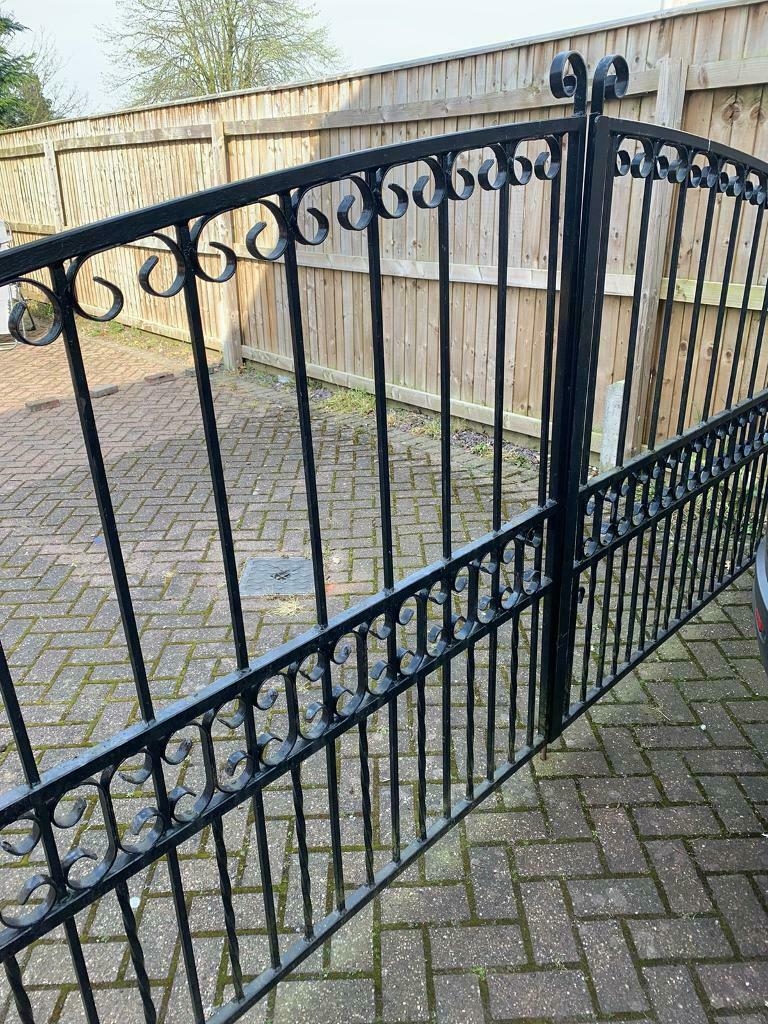

I think i've decided on a pair of second hand iron gates at around 12ft opening, with a side pedestrian gate at 3ft. I've already got the pedestrian gate and have spotted a few options for some matching 'ish' driveway gates online. then just get the posts made up to suit. Ideally i'd have liked to be able to automate the lock on just the pedestrian gate with intercom so I can let someone in but it seems a bit of a pain with the gate not having any box section and my zero welding ability.

It doesn't put too much weight on one pin if I do that then? Driveway gates approx 1750 x 1200
Like these
