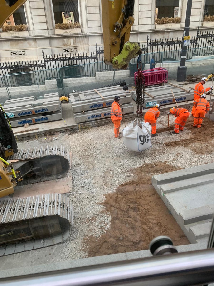

2 ton of chains to lift a 800kg bag. full health and safety!

whoever slung it wants his arse kicked anyway -- all loops on one hook - asking for a collapse
good bloke could 4 leg that --- even with a 2 leg set :rolleyes:

Particularly as it should be done with a bag lifter these days,quick hitch position?

Would it not be ok with a leg of the 4 leggers on each hoop?
Not really,length of chains to get correct angle is an issue,plus increased swing,bag lifter on short drop chain solves carrying with arm raised and as hsqe is such a big thing,plays them at their own game,can't see a lift plan written do job as in photo?

In all seriousness you me and nextdoors dog all agree that a dumpy bag can be lifted with a set of short 4 leg chains.
But I fully agree with Lynchy..... They are flat out pedantic, let them have there own antics back.

the 36 ton CAT and 6 blokes needed replacing with a 5 tonner with tilty and grading beam. Behind the photo you cant see 4 of those reversible steering dumpers each with a bloke in on the phone not moving. Walked past at 10, came back through at 2 and they hadn't moved. Time and a half on a sat. easy money when the taxpayer is paying!

It does make you wonder if half a dozen small firms were given the job they would smash it out for half the price and still make a very good wedge out of it.
Instead the cost plus outfit fit as many machines into a 2 lane road as possible to milk it.

better than what it is there ... they're only 2 leg set BTL,s but could still be slung as a 4 leg drop and at least get the 4 loops at a way better angle than they are there :mad:

Think the 5 tonner would lift those precasts....?
would have thought so the photo doesn't do justice they are short. but could push the boat out to a 13 tonner even and still be a quarter the cost.
