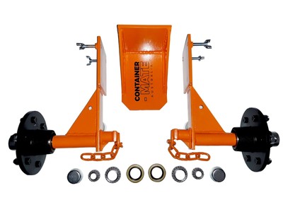

Just bought a set as I have 5 containers to move about the yard and no time to fanny about making them. Will let you know what they are like.
Looks like a new hire Co could be starting up!!
:cool::giggle: ...... they might regret the free shipping though :ROFLMAO:
Thankfully i'm right next to Bruv's scrap yard, there has to be a set in there that fits.
nice link Boyo .. or make some ... 15mm thick discs and some 8" wide rims/tyres either rolled or a suitable lump of large dia tube ... no need to worry about punctures or being a bit flat at the bottom .... could always glue some conveyor belt/rubber mat around the rims if you wanted a 'softer' bearing

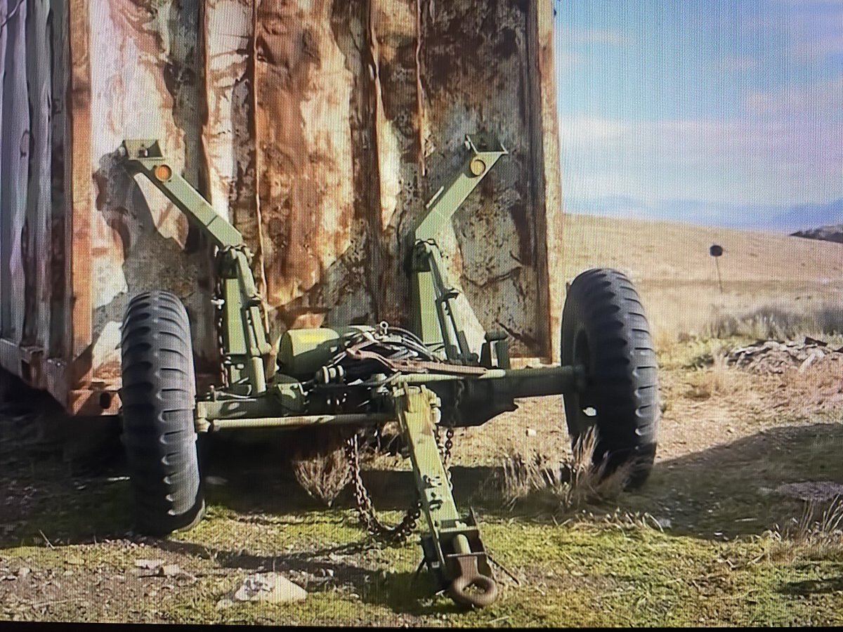

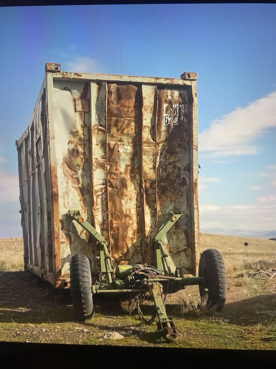

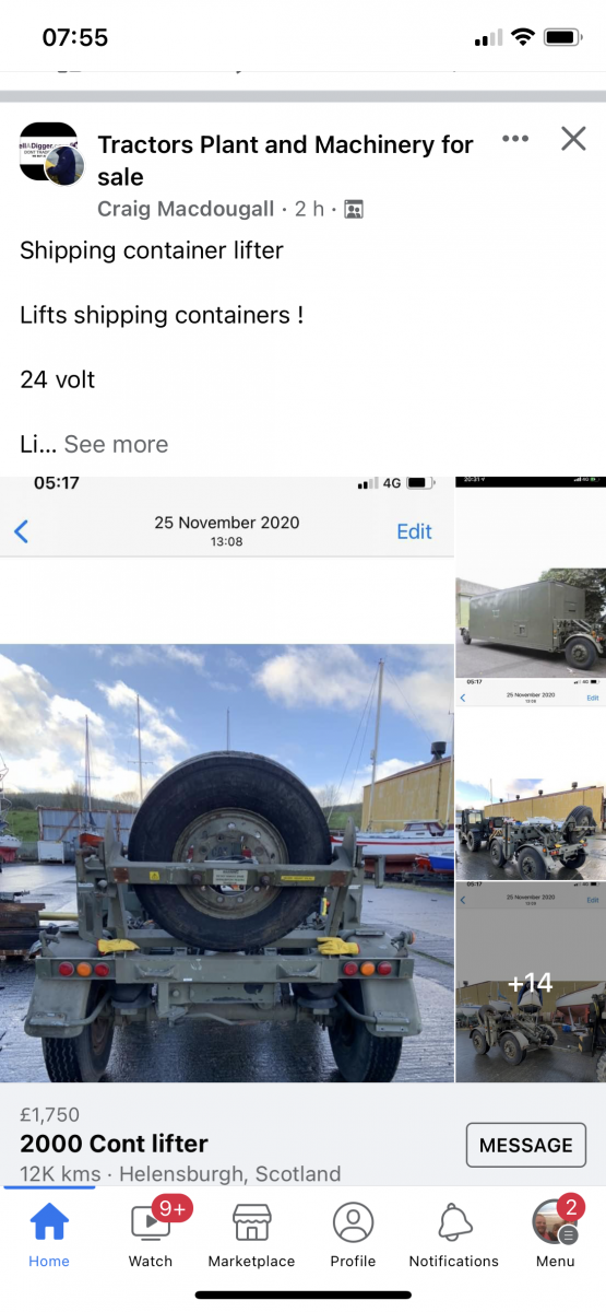

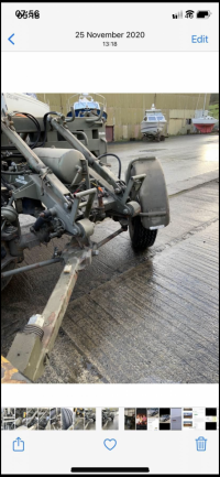

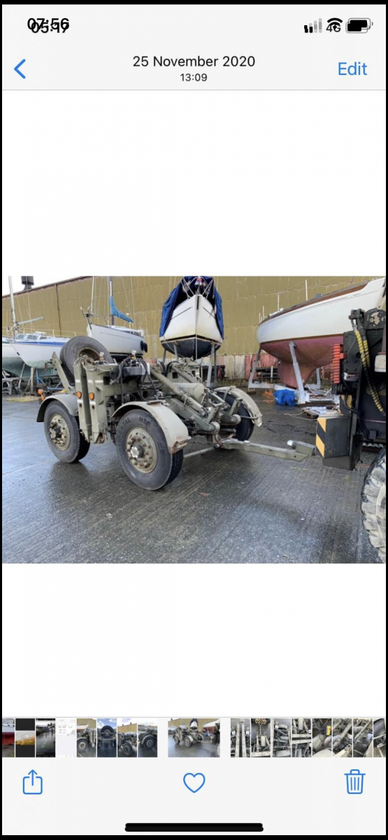

just seen this on you tube video, USA military mover

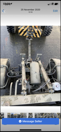

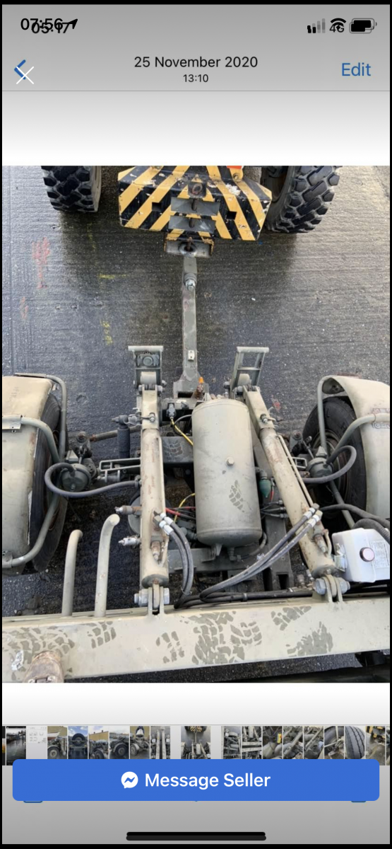

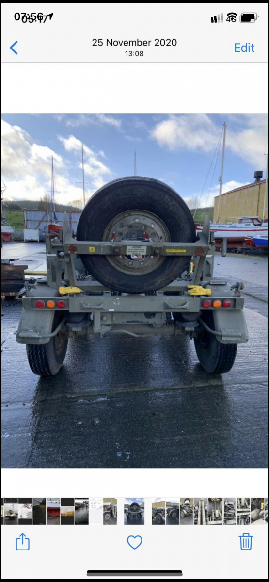

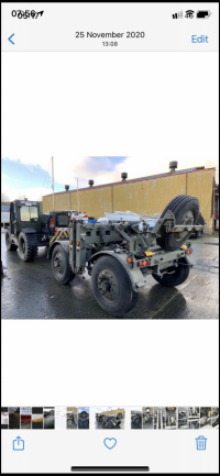

has been a few variations on the theme on ebay over the years ... never cheap though :(
Looks a good bit of kit if you had a few to move around a big place.
cheapest one of them I've seen .... jacksons are usually punting them about, but as said .... need a LOT of room
Shovelhands
Shovelhands
If you had two sets and put a steering axle on both ends then I think it could be quite manoeuvrable.
For the money they are asking there’s a LOT of components in that.

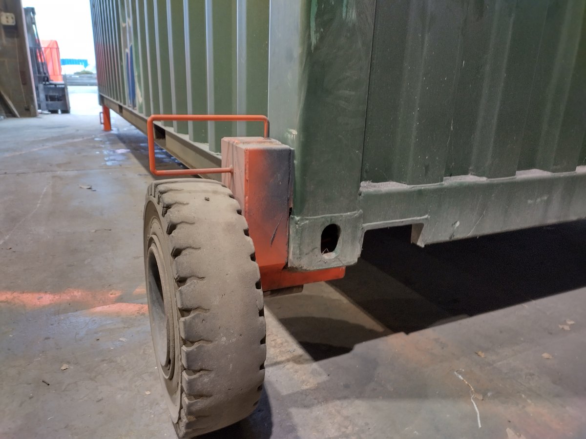

A local place that make self contained shot blasters in shipping containers, that I deliver for them, have have dollies they use to move them around in the workshop. A L shape bracket under the twist lock block with a stub alxe underneath and a spigot to go into the twist lock hole, then pick the other end up with the forks. I`m moving one for them next week when they go back. I`ll try and get a photo if you want.
