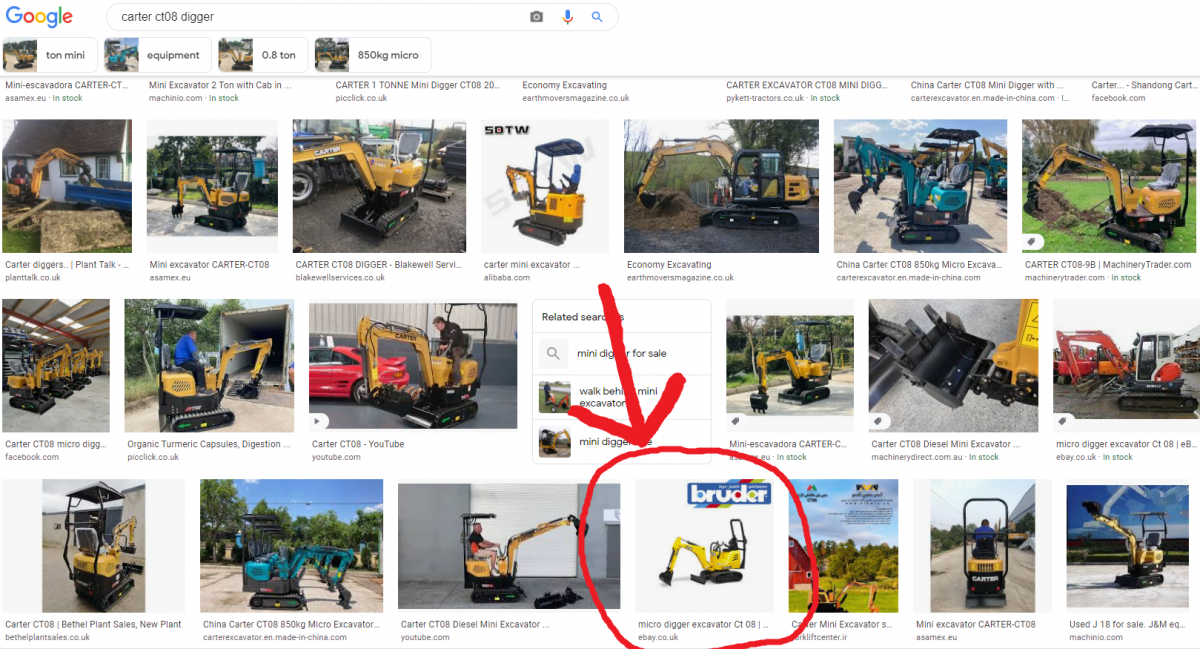

I was just on the phone to Rory about these Carter machines and thought I'd google to see what one actually looked like. As you can see they are listed with other toy diggers 😆
