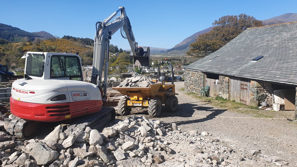

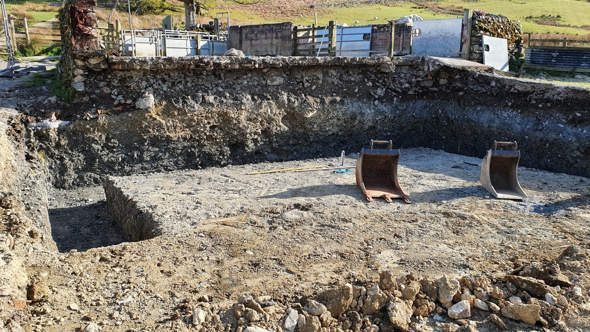

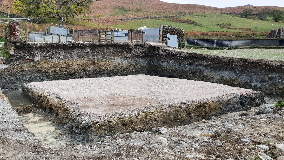

Well I've had a week back at work, there's only so much time you can spend at home. Got a fair few jobs with no human contact so it's ideal and if i don't do anything the backlog when all this end will be unreal.
Started a job demolishing an old unused farm building to build a joinery workshop. Bad at taking pics didn't get any of the building before i started.
Stone all saved as new building is to stone face. Founds nearly in should get finished tomorrow on the dig. Handy tip for spoil just at bottom of field.

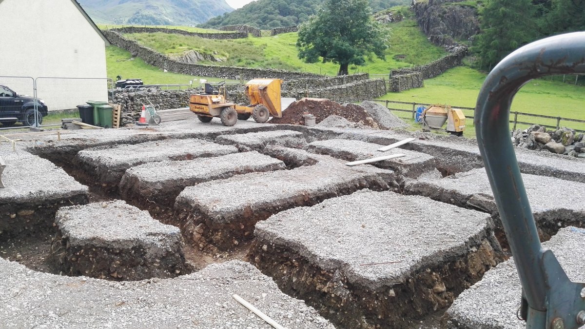

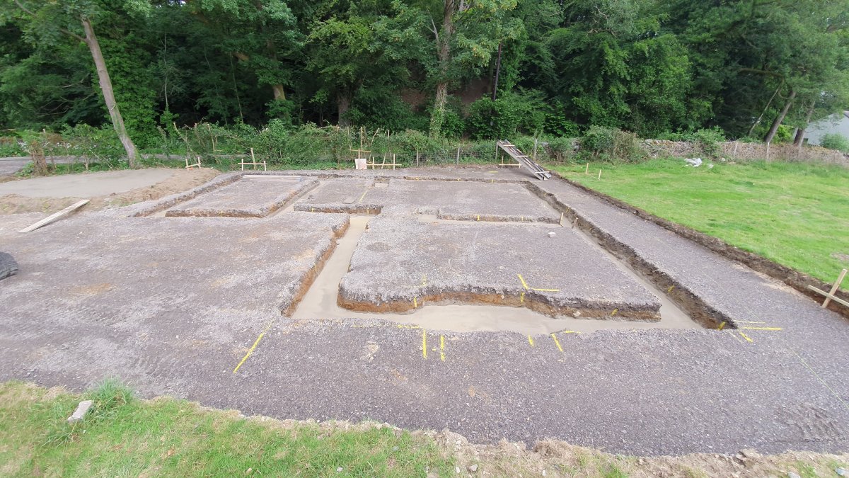

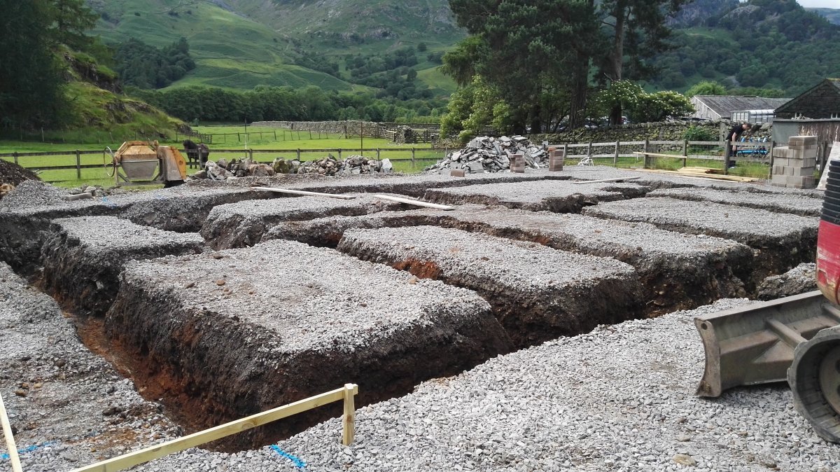

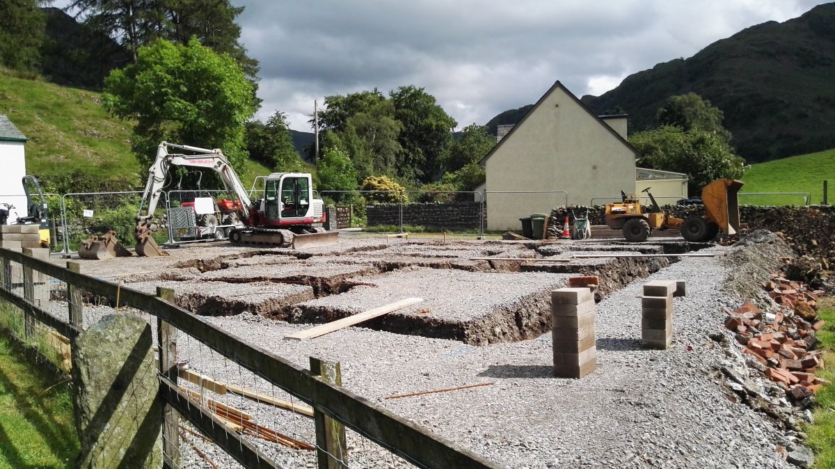

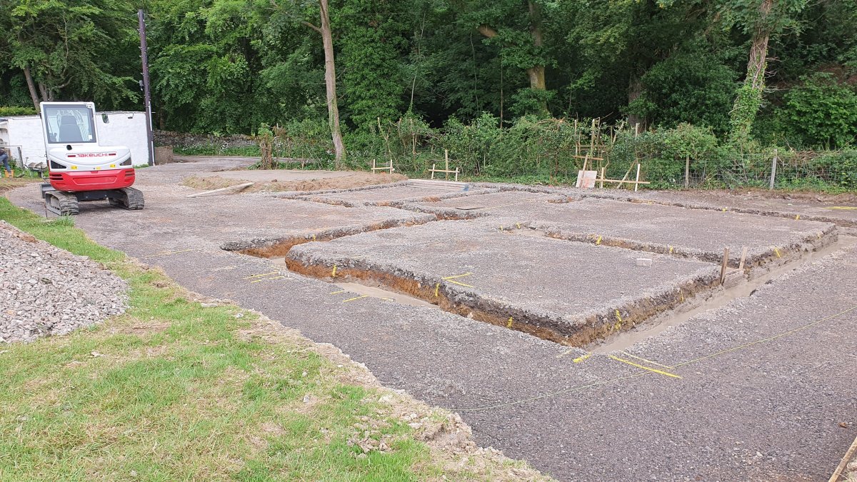

One from a while back old bungalow was demolished by someone else (was mainly wood and left a complete tip behind) levels were to build up a bit and some rubble to lose on site. Rubble was lost under where patio was to go then 100 ton subbase in to raise level up to near enough floor height. Lot easier grading a rolling that quantity with 7.5 tonner and bomag 120 than doing it when walls are in way. Then dig through for founds. Always like to hardcore sites as soon as possible we don't have lakes up here for no reason. View attachment 13663View attachment 13664View attachment 13665

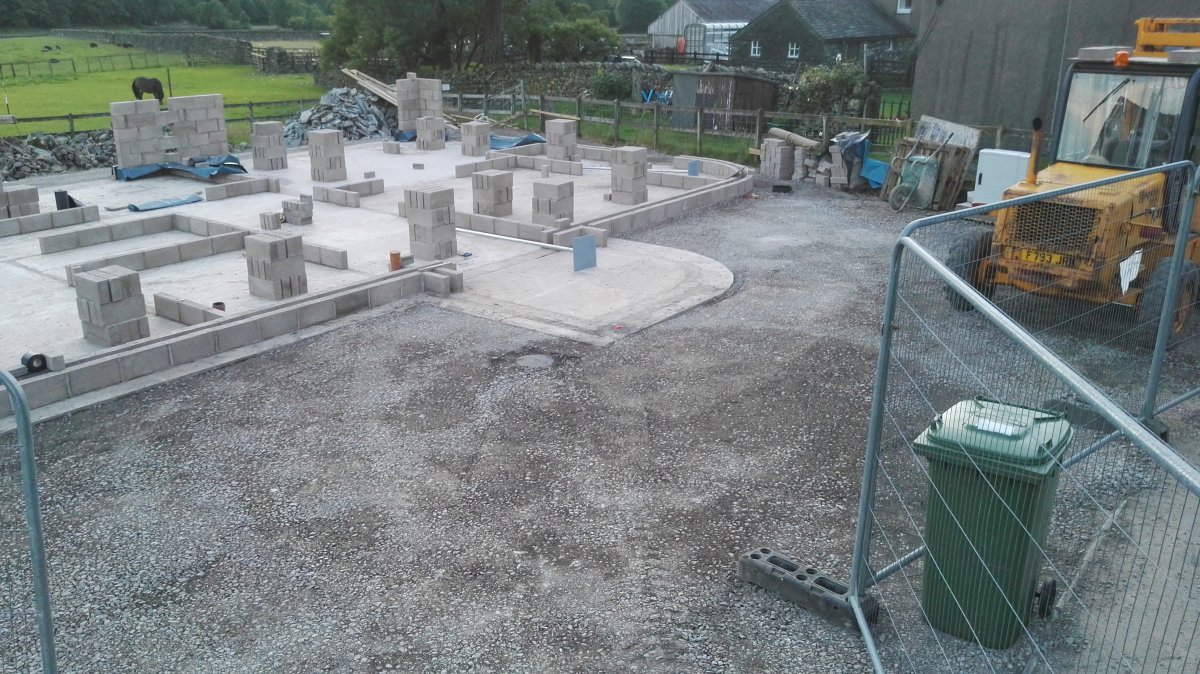

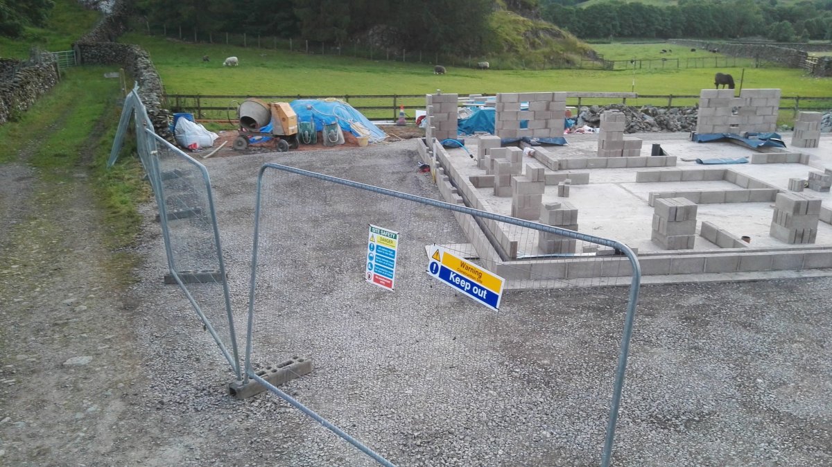

Then back at dpc to fill round. Also got all services and drains sorted at this point which is rare but due to the fact there had been a bungalow here before they were all on site so were redirected and connected. View attachment 13666View attachment 13667
That's a good idea levelling the hardcore before breaking ground for strip foundations, might try that on the house im starting in a few weeks.
Also that blockwork looks neat, im a bricklayer to trade so always like to see a neat foundation.
Can't take the credit for the blockwork not my department but i always either hardcore before founds and dig thru or if its a small area throw a bit on after before conc goes in found. At the end of the day it's easier working with clean feet.

View attachment 14187Stone all saved as new building is to stone face. Founds nearly in should get finished tomorrow on the dig. Handy tip for spoil just at bottom of field.
Nice looking machine that 290 - I had a TB180FR for a while many years ago and it put me right off them :LOL: but dont suppose its got much in common ;)
No very little the fr's don't do it for me either. For the job they are designed there's nothing better but too many compromises to be an all rounder. You should have had a tb175 you'd probably still have a takeuchi.

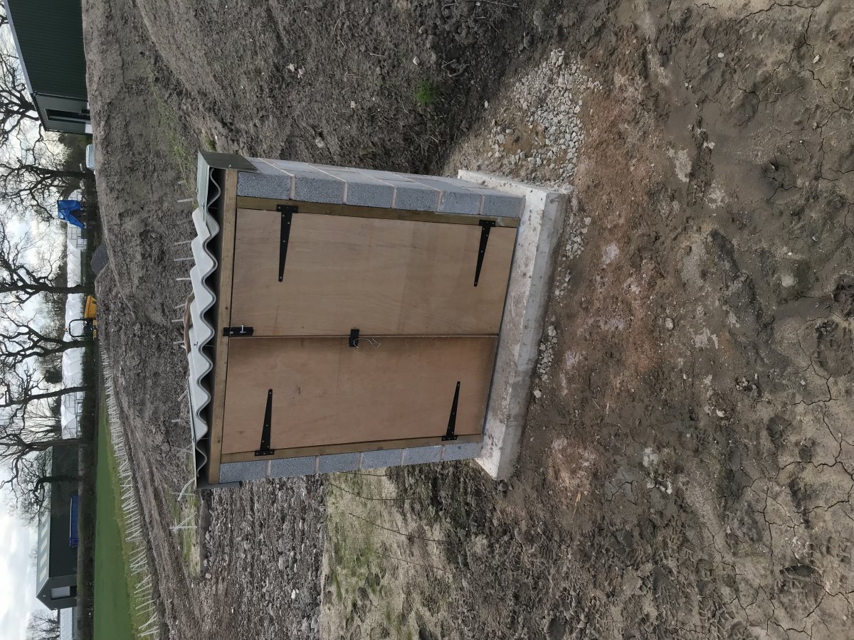

Western power take a while to get sorted down here but they will allow one of those build in boxes to be mounted to a couple of posts as a temp site supply till house is ready for it

like others said, western power are happy with recessed meter box screwed to a stake, has to be earthed though. Sometimes get lucky and screw then direct to the pole.
