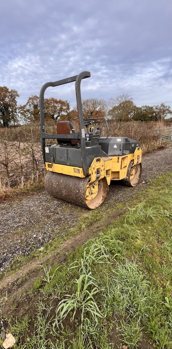

We have a benford tv 800 -1
Has been handy over the years but loads of niggles and electrical gremlins had it from near new but its50/50 if it’ll work for you when you get it out the yard. Does live outside though, they’re horrible to drive over rough lane or yard etc and compaction is not what you’d think but can cover a big area with them. Sunk it a few times though in over thick wet mot and you end up with a soft spot, but that can be sorted with tighter layers and dry stone. Every time do a bit of asphalt it’s a 30 min faf with airline trying to get water to drums working.
