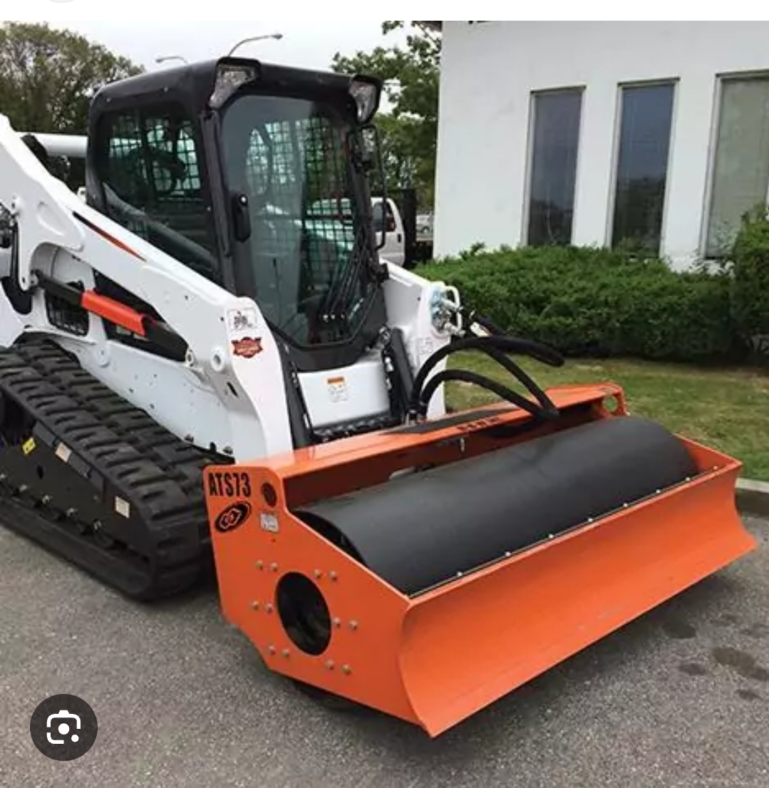

I tried to find a roller attachment that would maybe fit on the Avant. It must be doable it'll lift nearly 2 ton so a roller being pushed with a hydraulically driven vibrating drum should be possible. Mind you I know nothing 😆

Ah I see. Yeah lovely but not towable!
They do smaller ones. A site locally had an 80 version on it. Looked like a kids toy and the operator was enormous, literally spilling out the cab, must have near doubled the compaction. Just can't remember what make it was, I think it was like Makita blue in colour.
