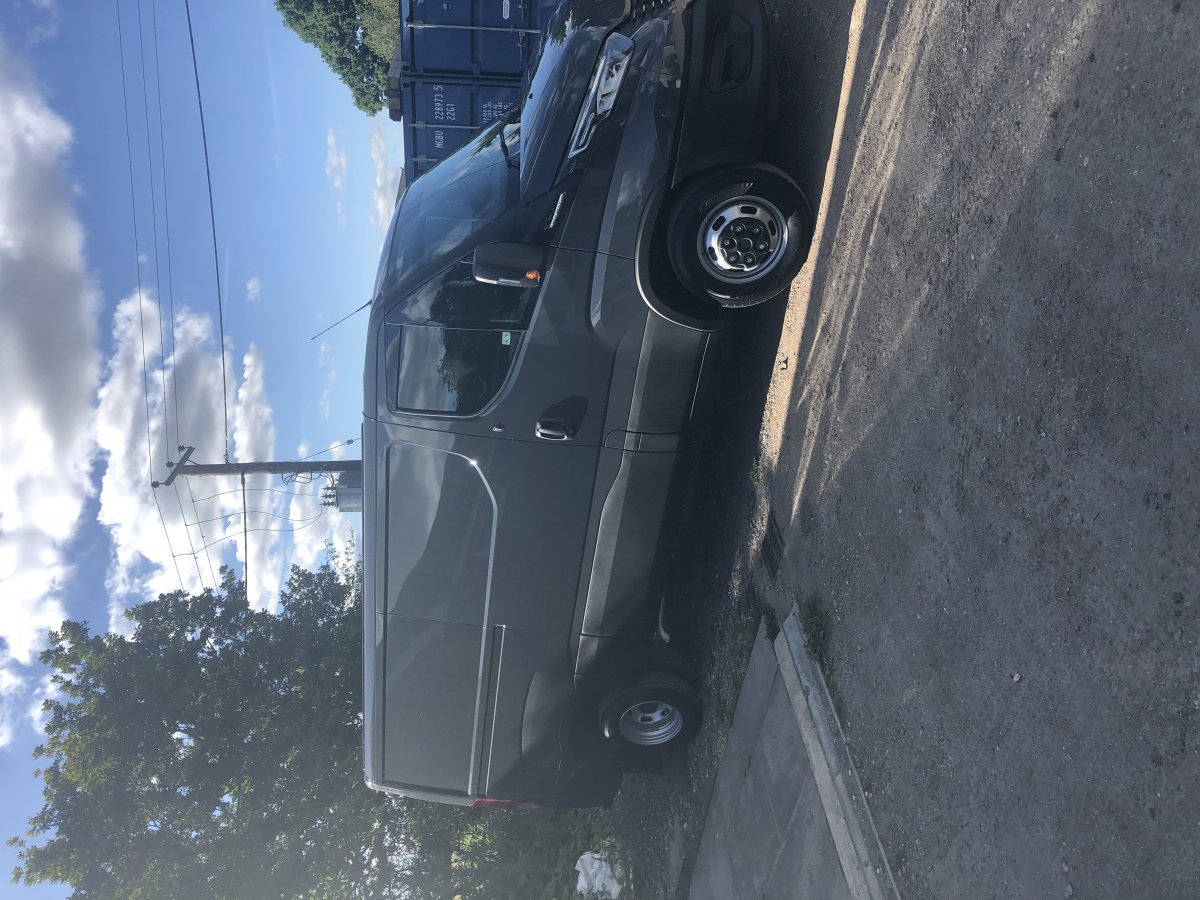

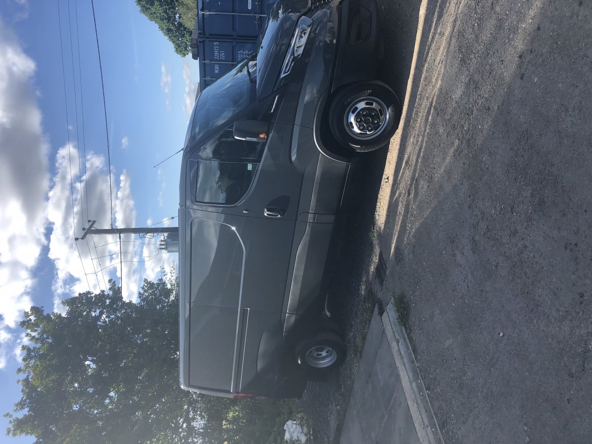

Yes, it is a van version. Twin back wheels to aid towing and off road.
That’s an ace looking van. Please tell me you look like BA?!
Looks good, i darent have a van round our way otherwise itll be emptied within 5mins.

I looked for a long time for a good second hand one, but they are few and far between and the ones I saw were well over priced, often more than I could get a new one for.Looks good, i darent have a van round our way otherwise itll be emptied within 5mins.
How much was it? And more to the point how much discount did you get?

Can’t remember off the top of my head, but 7 tonne train weight, so I can tow a full trailer.Looks tidy!
What's payload?
I need to investigate..been wondering about a MAN but think I'll check Iveco out now.Can’t remember off the top of my head, but 7 tonne train weight, so I can tow a full trailer.
I looked at a Man. All the write ups were good, but really wanted a three litre engine as it will have a hard life and wringing high power out of a little engine seems a recipe for not lasting long.I need to investigate..been wondering about a MAN but think I'll check Iveco out now.
