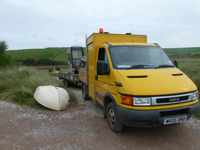

Best bet in all honesty is a 05 plate Iveco tipper if your going down this route. Newer ones give electrical trouble from what I gather and your better off buying one as a second wagon to use just for towing the digger, because the fuel economy is f****ng horrific. Brilliant trucks those however.... for what you want you could get a downrated 5t Iveco with the bigger engine! that would be the route i'd take and just ballast the van with the digger buckets and away you go.
You will get stuck on steep hills, slippery roads, soft ground..... I know because I ran this combo for several years.

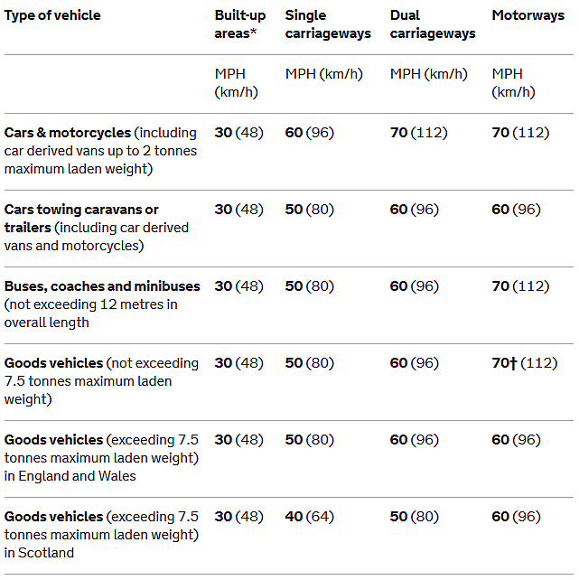

They are also restricted to 60mph on the motorway due to there weight
