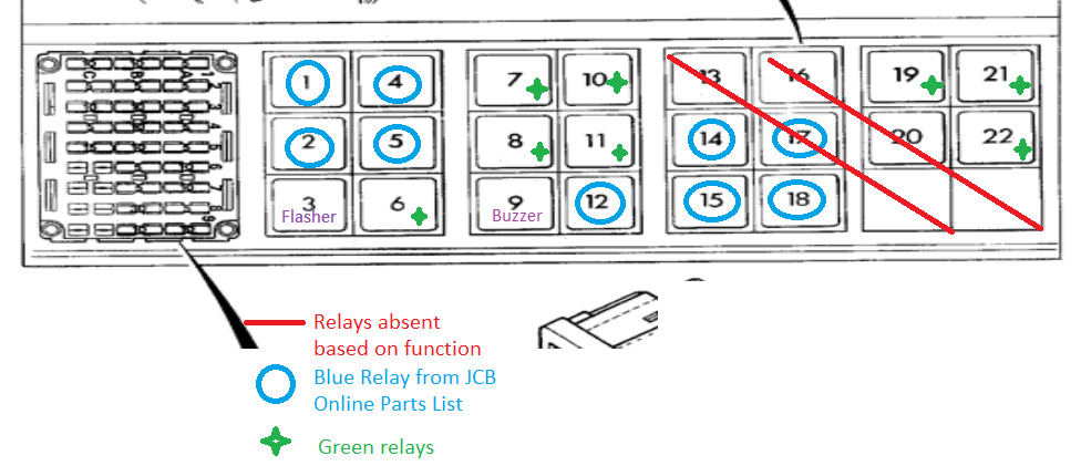

I'm wondering if I put the replays back in the correct sequence as I now can't get it to turn over.
If someone with a P8 could take a pic of their fuse/relay box, it would serve as great reality check
Working through the part numbers on JCB's online parts list, the relays 'should look like this:
One of the relays (5) didn't switch properly, but measured correctly after cleaning the contacts (didn't help)
One relay was found to be a green (change over) type where a blue is spec'd, but that's ok - a green will work fine in place of a blue (but not the other way around).

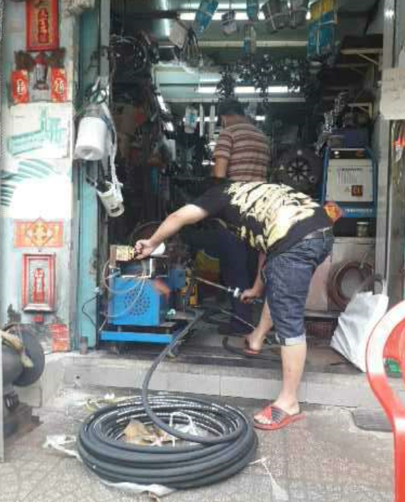

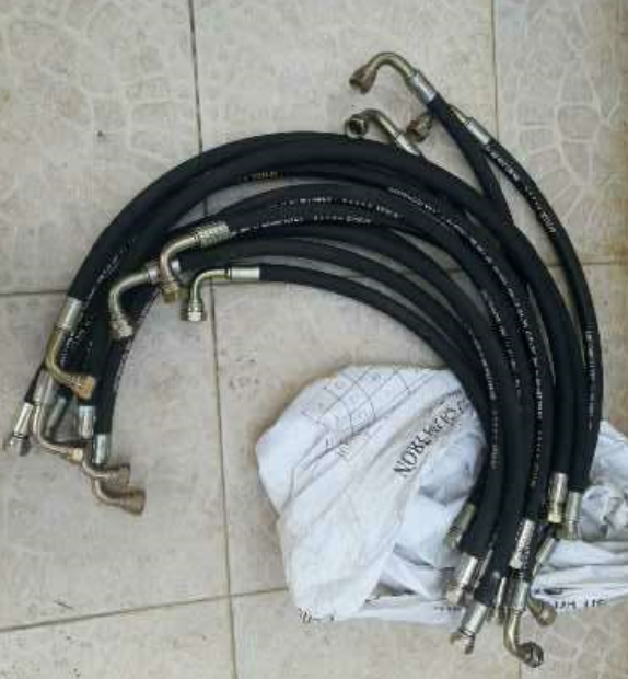

Yesterday I had some spare time, so went shopping - including my local hose shop
£80 bought 12 hoses

.. as long as they hold together .
Yeah, that's been my concern.
I started with a set for the stabiliser legs (figuring a burst wouldn't be catastrophic) - so far, they've been fine.
I'm not a good enough operator to let anyone near where I'm working, so a burst hose shouldn't put anyone at risk.
