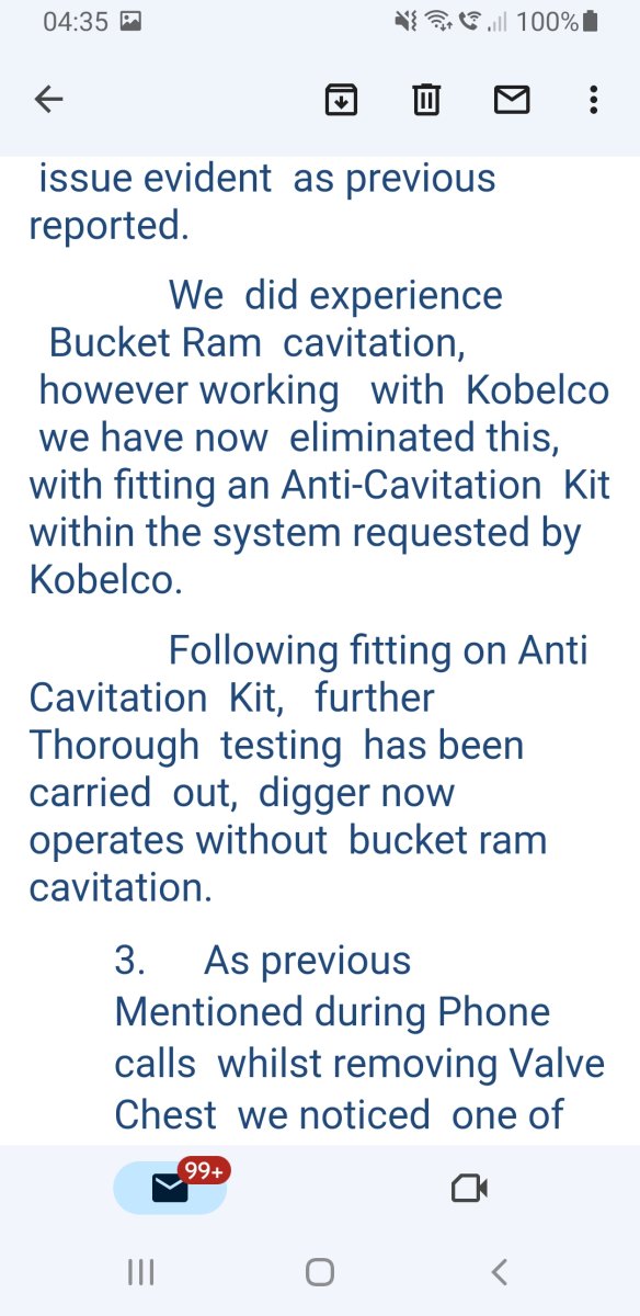

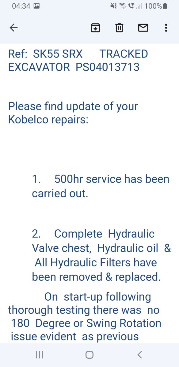

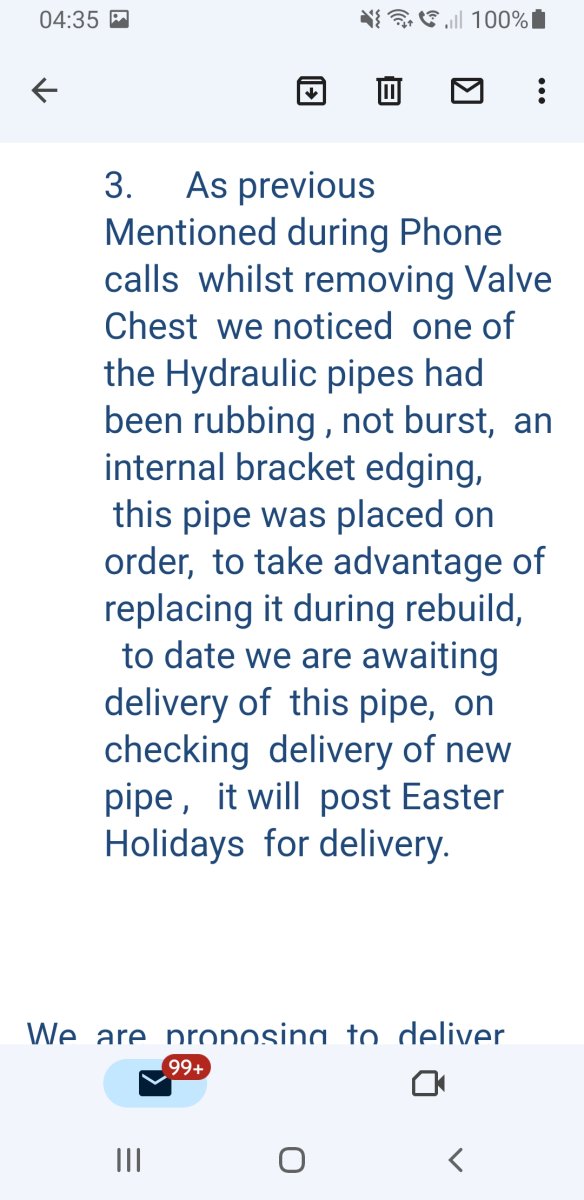

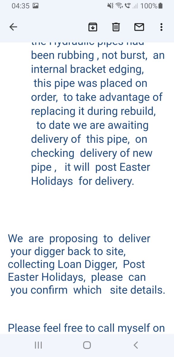

Get the anti-cavitation system fitment admission in an email if you can. Get it back, if not fixed then reject it as not fit for purpose and demand a refund.
