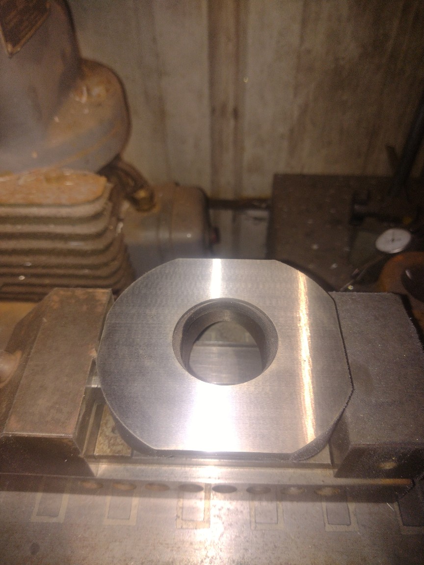

Found the fault don't know if you can see it but there is a groove where my nail is

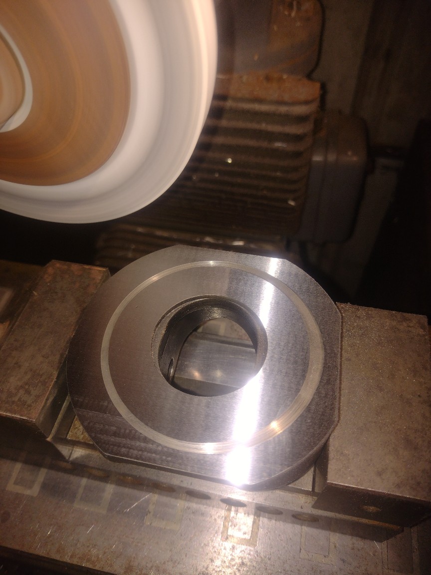

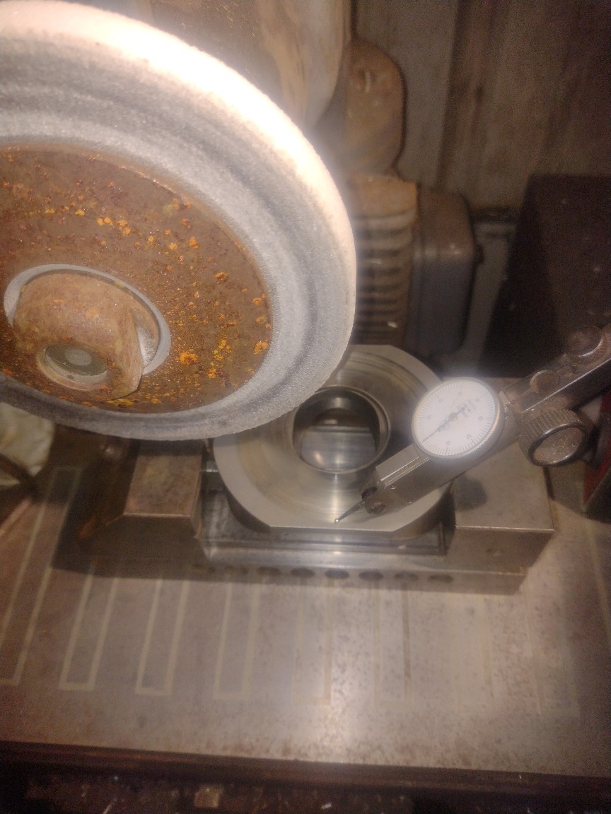

Next comes the repair clocking the piece up ready to grind luckily I have a decent amount of machine tools in the shed I will take off a set amount and shim the carrier up the same amount

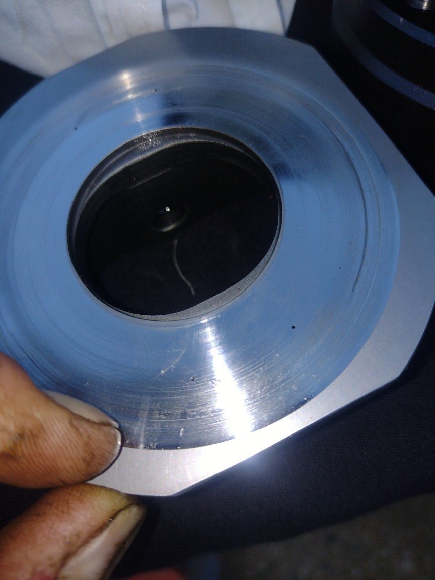

Here it's easier to see the damage and after I ground it next I will lap it with some carborundum paste and a bit of glass to get it proper smooth

Well done that man👆 dive in and get it done💪💪 refurbed a few hydraulic pumps the biggest was a set of four on a static scrap shear, the part you have there was 10” across on the set of four I did😳

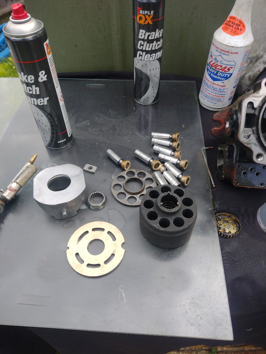

A kit of parts all lapped using carborundum paste and a piece of glass

I just put it together I can't see how it's timed the part I ground goes in first then the part with the pistons then the thin flat plate with the valve cutouts but that's keyed so it only goes one way
Proof in the pudding I suppose, if it drives it drives!
just had recollections of Trax saying in CEF a long time ago that these things needed timing, but suppose if it's keyed, rather than splined it has to go back together right :rolleyes:
They’re not timed👍
