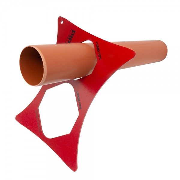

I use this , great tool. If you don’t happen to cut the pipe square it takes it back untill it is 👌🏻
That looks good reasonable price too
been looking at these how long do they take to cut the pipe? ive got a rigid cutter and it takes ages to cut it so much that don't use it, use battery recipes saw, then chamfer in drill got 2 different ones. fast enough and works well. was going to make a jig/guide for recip to get truer 90 degree cuts.

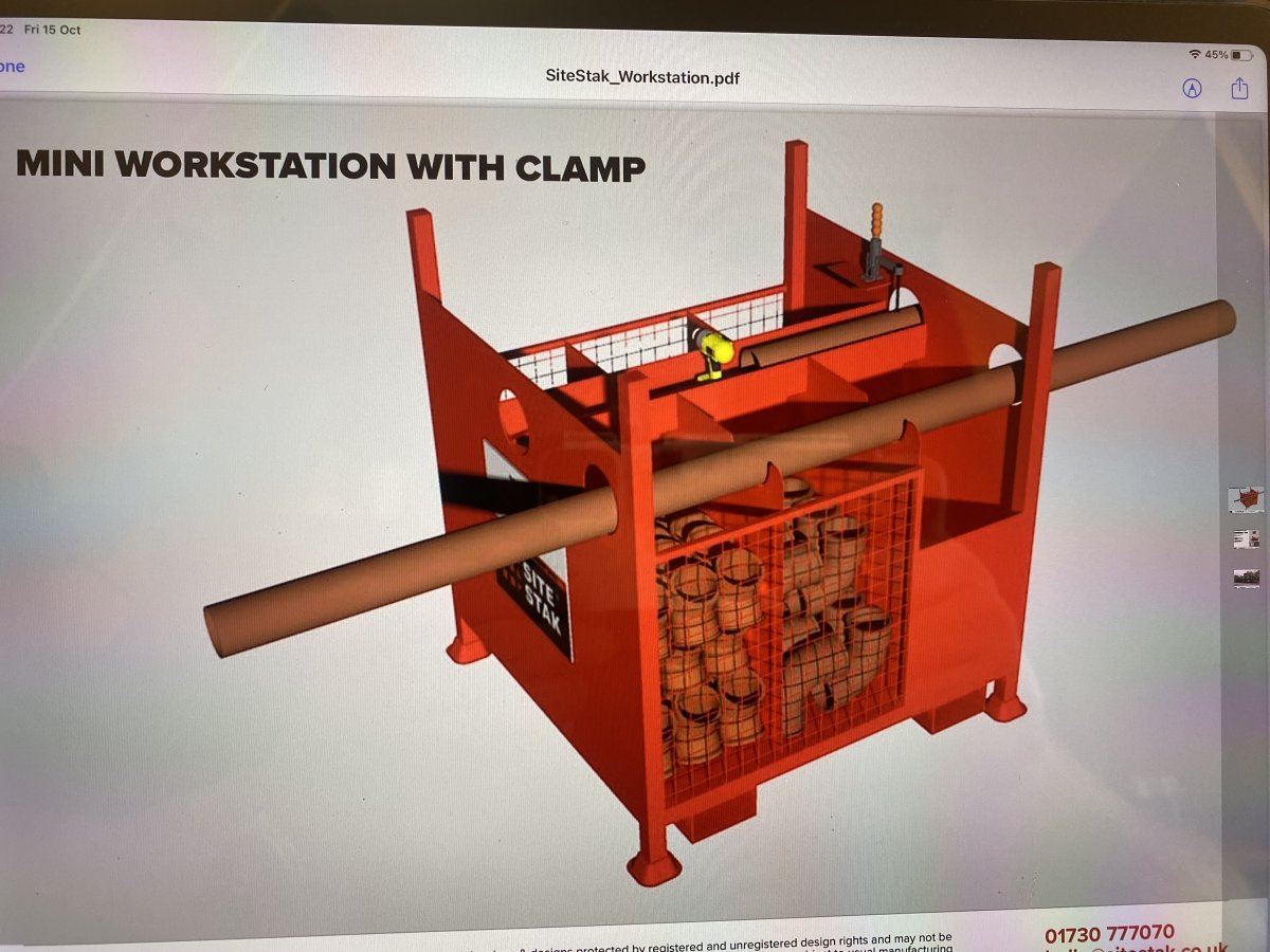

also asked for a price from site stack for there mini drainage station thing looks handy
What blade are you using in your recip I have the standard long hss blades but they tend to wonder on the cut, was thinking of trying the taller blades as might help it stay square

wouldn't take a lot of knocking out that :cool:
lacks a squaring guide though .... it leans and grips the pipe ... a suitable pair of fingers'd help a lot for keeping cuts square

Ts420 cut straight through the pipe then chamfer with the side of the blade I've not had any luck using much else as it either gets run over or living in the s**t kills it I did have a chamfer tool for the drill but after it killed the drill I gave up on it
Same as that Tom , nothing will beat the 14 inch blade on the still ts420 saw for speed and you can chamfer the pipe in 2 swipes when you get good at it . I know officially we shouldn’t be doing it so having the battery grinder out at the same time is probably wise . 😉

I’ll have a smaller variant.. I’m sure a mesh case stillage with some extra compartments in it plus pipe holder add on could be made up reasonably easy?
Yeah rekon you could make something up quite easily. Doesn't have to be perfect if it's for your own use
Biggest thing when cutting pipes especially when it's colder unless there's somebody holding the offcut you want pipe supported in 3 places along its length so it doesn't break off before you've cut through it and split the pipe down it's length. None of these cutting aids or pipe stations address this
