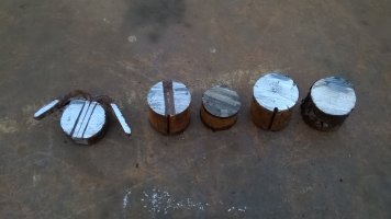

the washer is bigger than the pin to stop it pulling back through when the nut is done up ... cut 'em both off flush and as said cut either side of the rod eye .... you then only have the pin lengths in the bosses to contend with and if the flange end IS moving then you can belt that into the void left by the removal of the rod end. Can then also get a drift in and at the nut side .. again as said, if all else fails slit the plate and boss to open it up and release its grip.
was the only way this was coming out ... had good access to belt it/jack it out .. would NOT move
WP_20200411_17_12_23_Pro.jpg WP_20200411_17_12_28_Pro.jpg cut off flush to lugs WP_20200412_14_47_29_Pro.jpg WP_20200412_19_25_16_Pro.jpg
slit the bosses WP_20200412_14_49_05_Pro.jpg and ..WP_20200412_14_49_50_Pro.jpg tapped out with a 1lb hammer after it was slit (y)

Thanks (y) I see what you mean now, will treat that as a last resort. I note you said jack, I did realise this aft I could get a bottle jack in there and try that.
