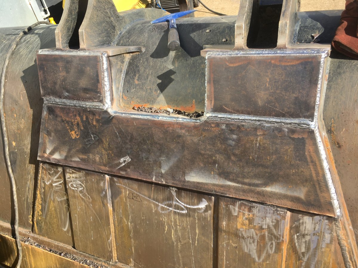

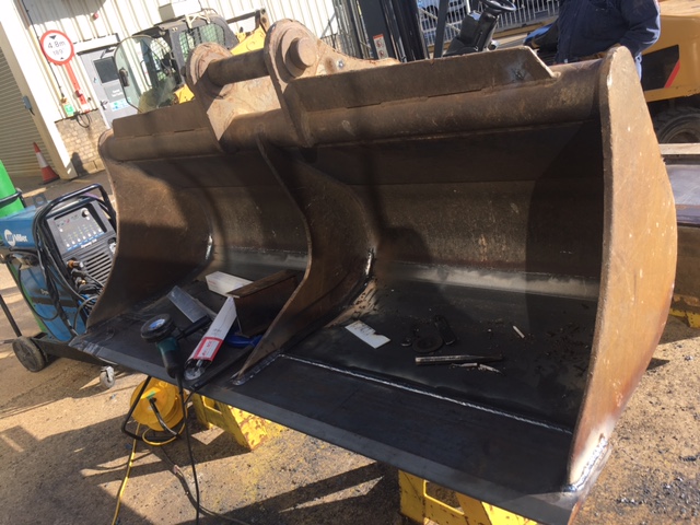

Had the 7024’s out today. Whenever I get a job like this it always seems to be a hot day. Mind you, saves pre-heat, as the bucket was getting fairly warm just standing in the sunshine. Managed to keep it straight, Gra.

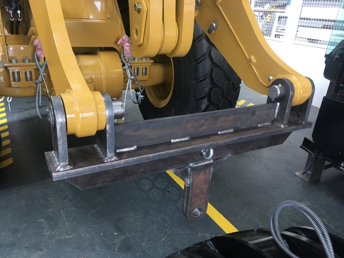

Push-me-pull-you bar made for a one-off job moving a shovel with no engine. not allowed to damage the paint.

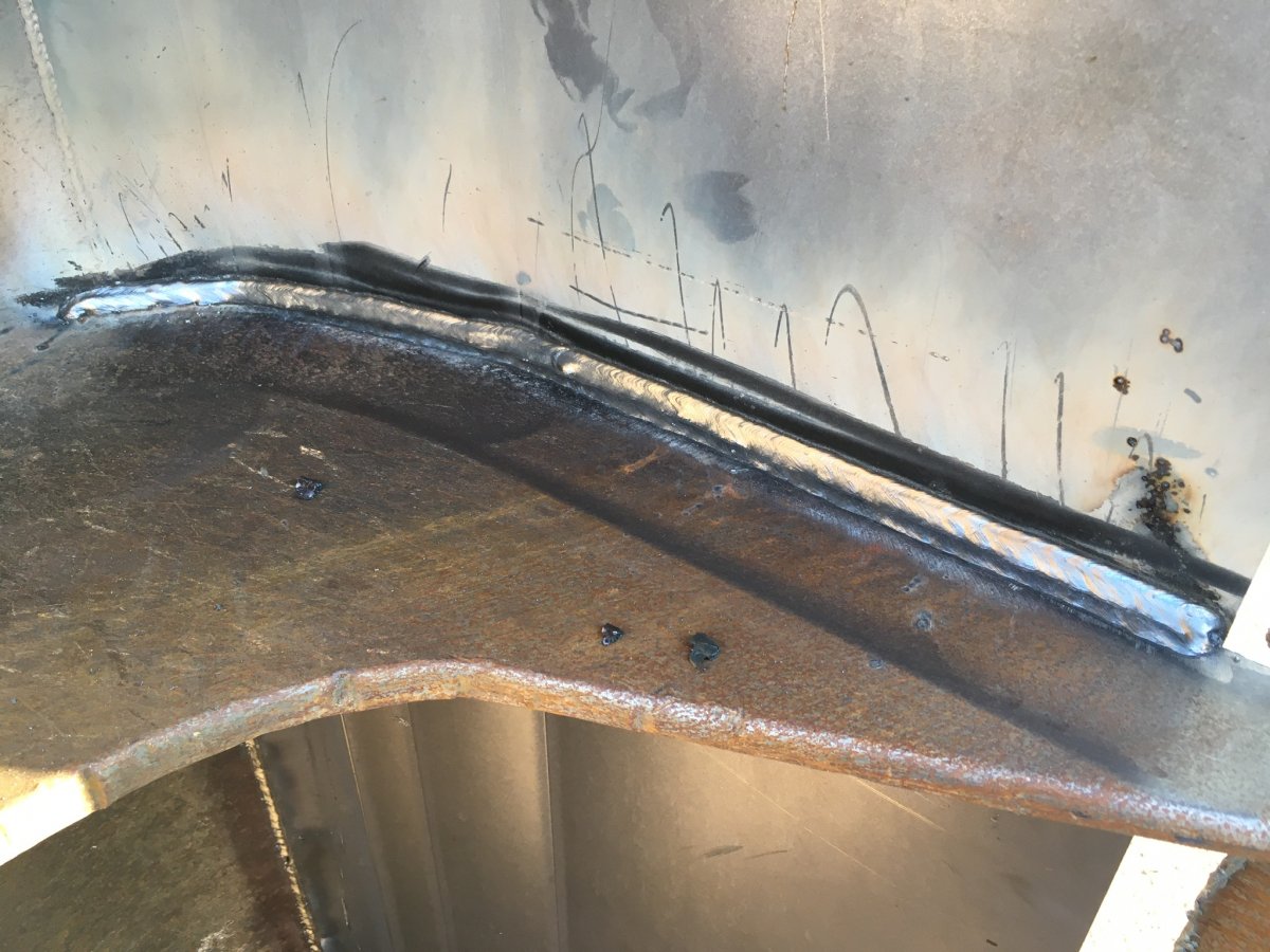

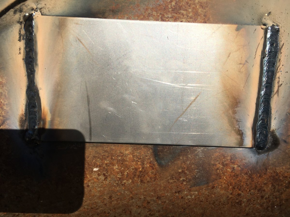

I doubt this will interest anyone but Gra, downhill weld with 3.2 6013’s, just to see if I could. Bohler Phoenix Blau. Not worth the effort on anything but thin plate, this was 3mm to 10 mm.
I doubt this will interest anyone but Gra, downhill weld with 3.2 6013’s, just to see if I could. Bohler Phoenix BlauView attachment 37191
what sort of current Bri ... that's a very tidy down run :cool:(y)
how do you steer the shovel ?? :unsure:..... that's a very expensive bar :rolleyes::oops:
140 amps, and shifting. You’ll know this from experience, get slag in the first run and it’s a pig to get rid of. Wouldn’t pass x-ray.
Auxilliary steering circuit, off the battery. It wouldn’t have been so expensive if the fab shop hadn’t cocked all five bores and we had an afternoon putting a boring bar through. All the steel was offcuts from another job. I did the welding, mostly mig which goes against my religion but I needed it done fast.
I always considered a down run of weld as a ‘wash’ weld with very little penetration🤔 looks neat though👍👍
You’re exactly right, sod all penetration - unless it’s done with 6010 or 6011’s, like many thousands of miles of pipelines.
