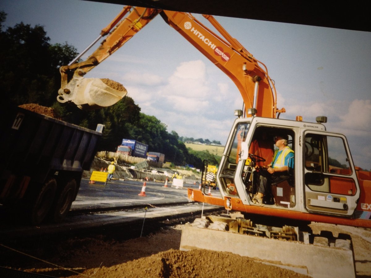

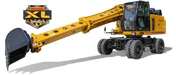

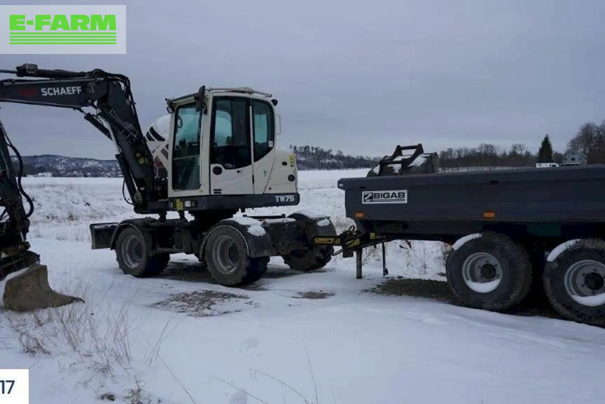

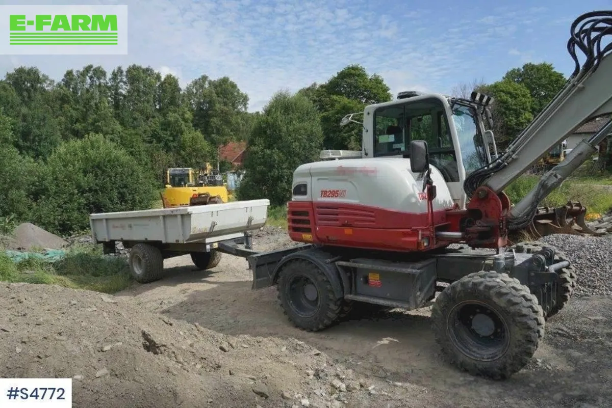

View attachment 42960View attachment 42961
that last one is a really old pic.

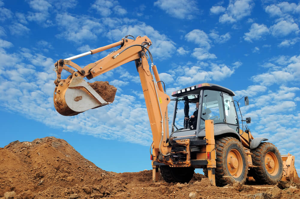

thanks for your intervention I think that on the farm and in the countryside as a wheeled backhoe with a rigid frame tractor type with large rear and small wheels forward is very suitable, I think it has more traction and stability than the wheeled excavator, am I wrong? thank you.
backhoe is better in the farm job country??

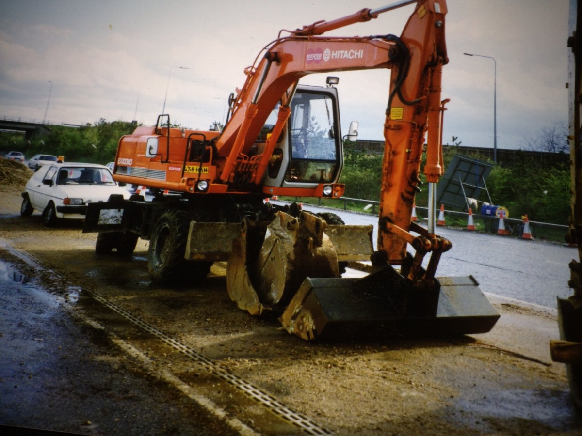

Hitachi ex100wd in its time a game changer , it would still be better than a lot of wheeled machines built new today .
That looks like a really well thought out machine and will probably compete really well but it’s based on a smaller machine where as the ex100wd was based on a bigger machine . It had the lowest centre of gravity I’d ever seen on a duck , it was fast powerful and reliable . This was my one . It was a 1991 that was it working on the M25 View attachment 56471View attachment 56472

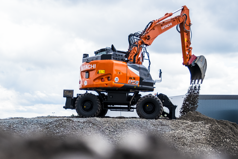

I haven't seen an ex100 but hitachis 85's that the new duck is based on are big machines by comparison to others in the same weight class. I think it's reduced tailswing might make it look deceptively small. Obviously the full tailswing would win but would be interesting to see it in person. I would like to have a go in the tracked version. As the outgoing 85's cab is appalling

I think the class they are in is the main difference .
That’s a zero swing king post machine , a derivative from king post machines that have come from 3 tonne minis to the current 10 tonne plus offerings .
The ex100wd was built like a conventional side boom machine . It was in the 12- 13 tonne class and took the same buckets . It was lightweight for a big duck which made it really nimble .
The ZX95w is a mecalac.
They have a new zx135w which could be pretty close to the ex100wd
I like that .... 4 wheel steer, VA boom and a king post ... not much you couldn't get at with that little beast .... looks pretty stable too ... would love an hour or two in that :cool: :cool:
