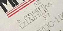

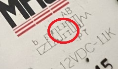

Generator works, lights work not tried night heater yet might get an updated control for it more like the Chinese ones with screen. This one just has switch on roof above counter.I can’t see it being a fuse if it’s working fine in one direction . Can you look at the wiring in the remote and see the colours to retract the legs then short the same colours at the pump to see if that’ll work .
