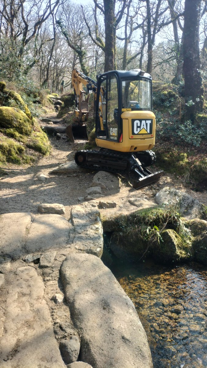

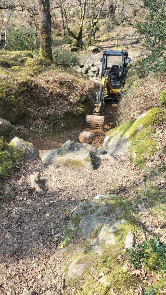

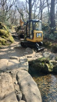

I dunno my dad's cat is basically just this. 3 ton undercarriage with the upperstructure 2t size. But I have to say it will dig more like a 3 tonner, Its probably a bit niche but for those who want a very comfortably towable machine with attachments but not so much need for expanding tracks (rural work) I think there is quite a bit of appeal. Like in this photo I had to do some work going up the path ahead of the digger and even though the 3 tonner would have fitted up there just it would have been a really squeeze to do anything useful due to the bulk of the upper body against the banks- the cat was perfect for this. Ive barely even put the tracks in on my Wacker but maytimes I've cursed the ground clearance!

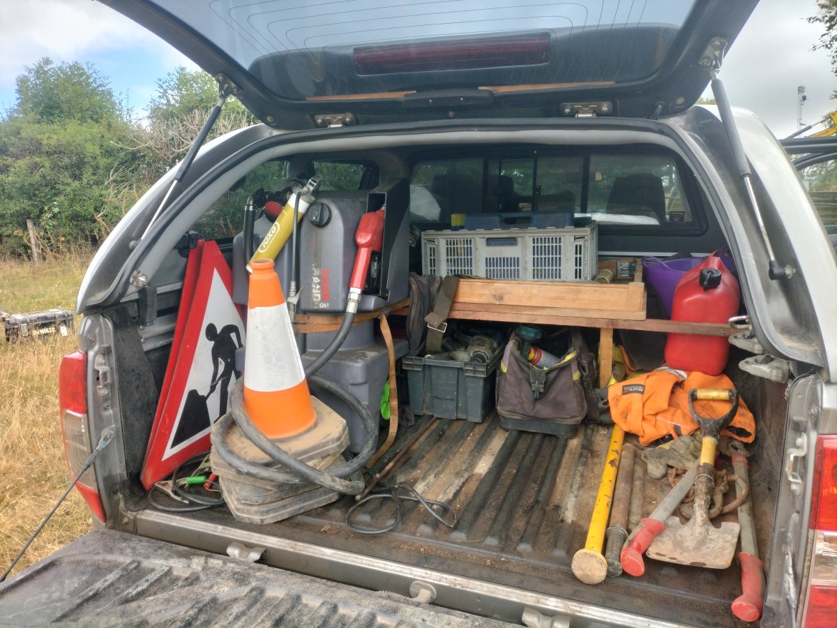

I wouldnt be without my parker 60l tank now. No messing with cans and generally ties nicely with when I fill the truck up. Doesn't take a lot of space up either compared to the same quantity in jerrys
