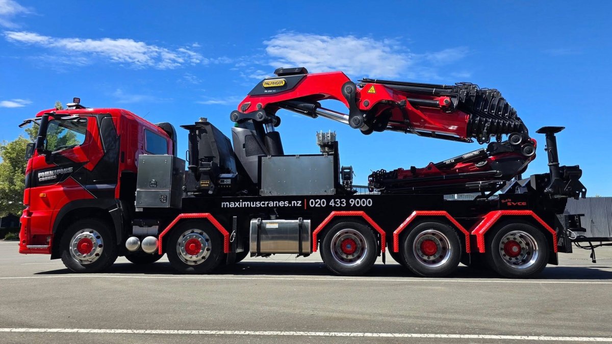

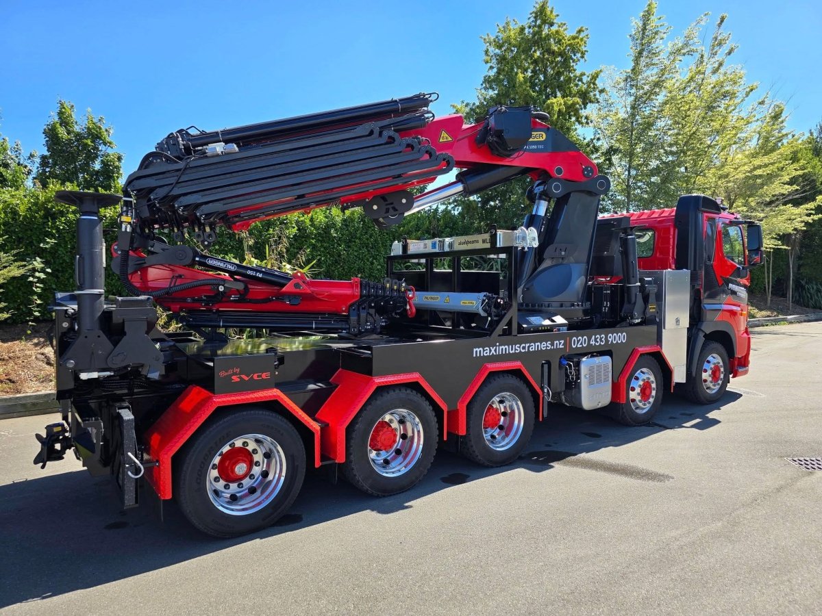

Quite a good picture!
look at the side loading on that boom :oops::oops: something very wrong with the rigging on that .. could only end one way with that level of lateral loading -- monster set of ballast weights on that too :oops:

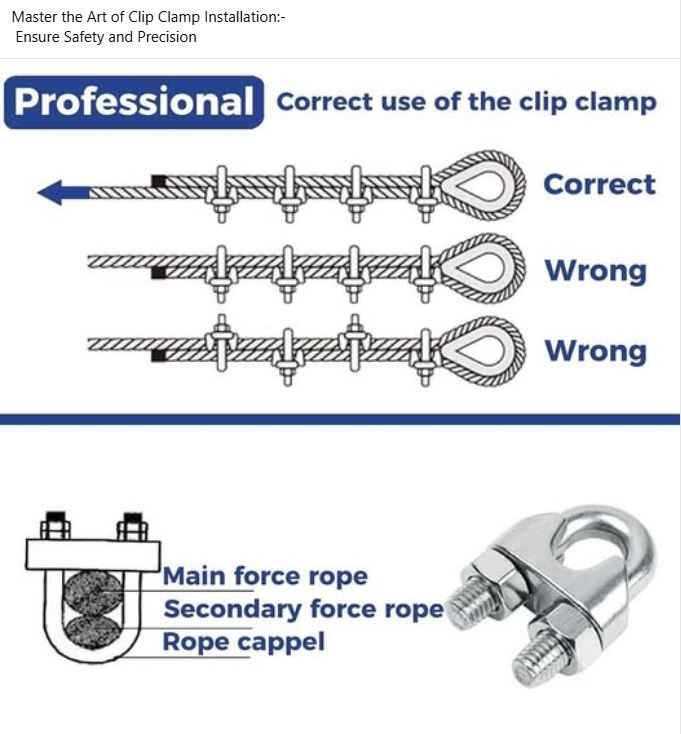

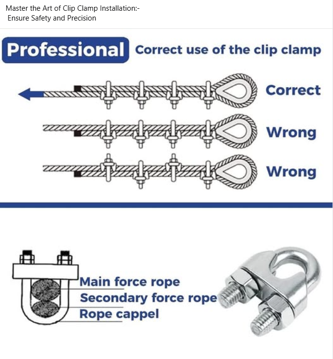

Ok..ill bite
Be interesting to see a destructive test on line 1 and 2. Surely if both the u and socket are rounded correctly it's not hugely different?
the clamp is always parallel - never shaped, other than some have 'ply guides' in bigger sizes .... the U bolt bites into the free end cable to prevent slippage through it
