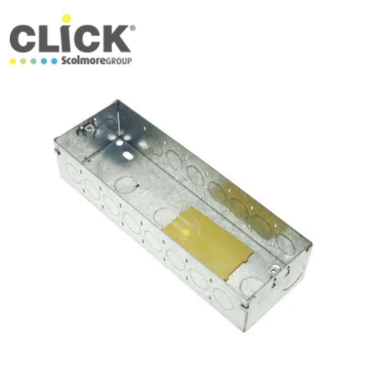

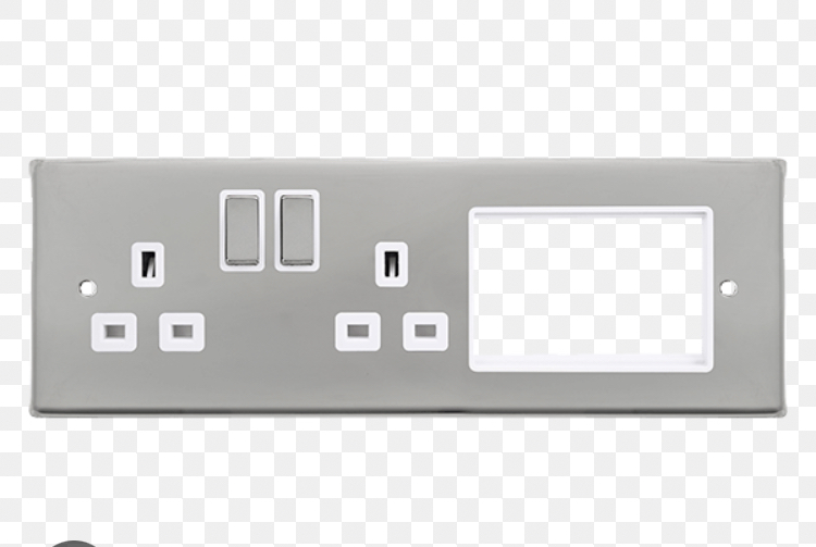

For normal usb doubles then 35mm should be fine, I think 25mm are too shallow for some because of the electrical kit on back of the socket. In certain areas I fitted these ones that used a specific 47mm back box, and have blanks where I added usb point/cat6 and tv aerial points. Went a bit mad with cable ducts too with the idea of future proofing should anything new come along…..then sold the house!
