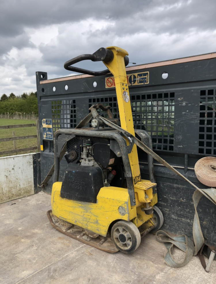

I've got a wacker WP1540 petrol and a forward and reversible wacker dp2540 diesel and i favour the diesel every time yes it is 160kg but its on wheels and always have a machine with me to lift it on and off it pounds it in so hard @ £3.85 m2 they soon earn there keep :cool:

Reversible diesels are a big step up from what he's got 👍🏻

But with taking on bigger work, you need bigger kit quicker you do the work the more profitable you can be

I like yourself have little petrol plate and dpu2540 reversible and the only time petrol gets used is if someone borrows it from me or its monsoon season and big un wants to be a submarine. Get a reversible derv and you'll realise you've never wacked anything down before.
I've got one of the 80kg belle ones it's ok but about the limit what I can throw into the back of the pickup,also got the big diesel one but unfortunately for me it's just too big, don't get me it's an absolute animal with the compaction chart similar to a 3t roller but at around 485kg it's just not suitable.
So looks like it's going and possibly replace with a 170kg one

Bought a reversible diesel last year. Certainly put the type 1 down on my driveway, trouble is at the moment with so many levels it’s a pain to get out of the shed to use. If you’ve got a machine to lift them about then no problem!

Same as mine and thats the reason despite being tempted I've never bought a bigger plate as they are on the limit of what is realistically man handle able

my only concern is not every job has a machine on so it’d need to be a manageable weight. Might just hire in some bits and see how we get on this year . As ever the wish list gets longer never shorter 🤣

my thoughts are is the extra 50/100mm width worth spending on when I’ve already got an excellent plate and other things to buy and then if we upsize it’ll be a hassle moving it about without a machine as id have nothing to unload it with back at the ranch

It's not the width that's the benefit though as much as the fact that two passes over hardcore will put it down further than spending all day with what you've got.

You can wheel it on a trailer by your self? Same with unloading with the wheels they are quite manageable
